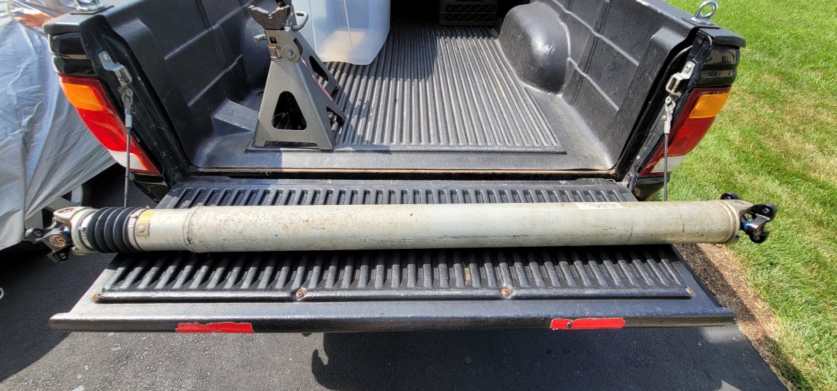

Looks like the rear flange lines up great to my old driveshaft. The mounting bolts fit right in.

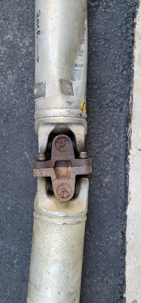

Wire brushed down the flanges and old rear U-Joint.
The rear U-Joint appears to be a Spicer 539.
There was an interesting difference in the quality of the flanges. The small one has a Ford logo, and has a much better casting and finish. Very little rust on the Ford one in comparison with the rear flange, made by Spicer. The Spicer groove for the circlip is suspect. I hope it holds! Will try before installing the new U-Joint.

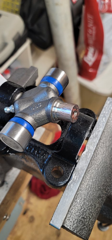

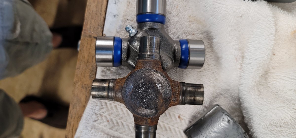

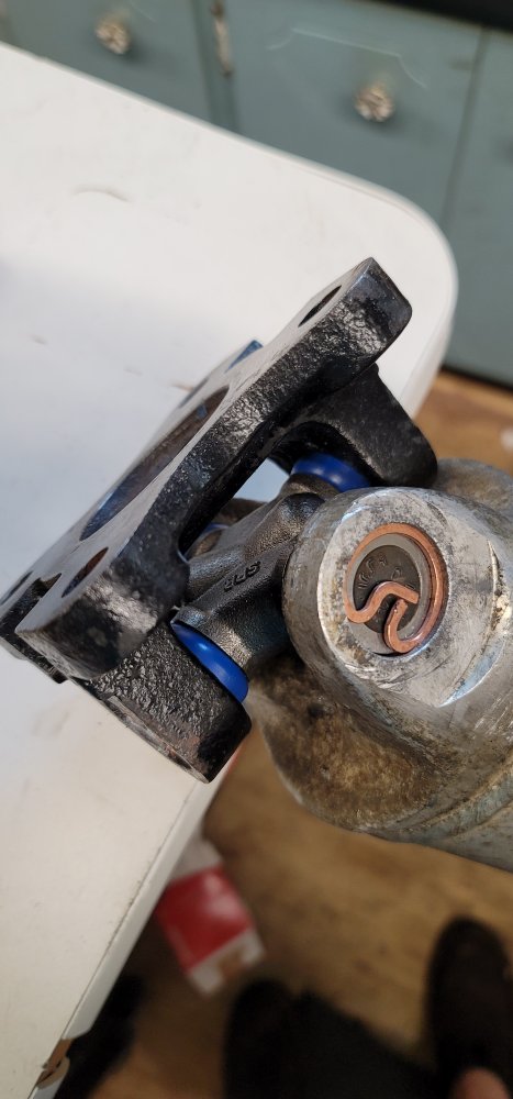

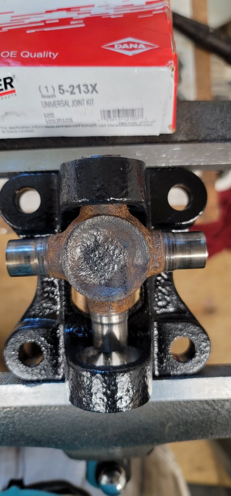

Well crap. Bought a new Spicer 5-213X U-Joint for the rear of the driveshaft and it won't fit because the shoulder diameter is too large.
What to do in this situation?
I can't find a Spicer cross reference for exact fit replacement for the original Spicer 539.
Grind down the shoulder?
Or?

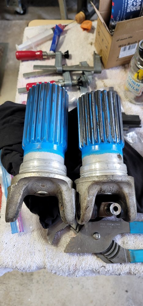

Thanks to all that helped, the driveshaft is re-installed and working beautifully. Replaced front and rear u-joints. Lubricated the splines. No vibrations. Transfer case, front and rear differentials fluids are all changed.
It was a challenge getting the correct driveshaft.
Thanks to you, I learned about the difference between 2 wheel drive and 4 wheel drive drive shafts. And that it's easy to use a driveshaft with a different U-joint size simply by buying a combination u-joint with the correct sizes for the shaft and flange.
Greatly appreciate the advice! Russ
