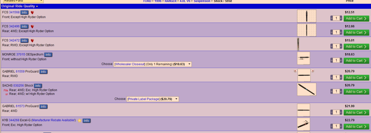

I have a 4x4 that is stock rear ride height and it has leveling springs in the front. What is this hi-ryder option I see on rock auto?
1996 4x4 XLT shakes excessively on bumpy roads
Hyrider is a factory lift option for some years.
