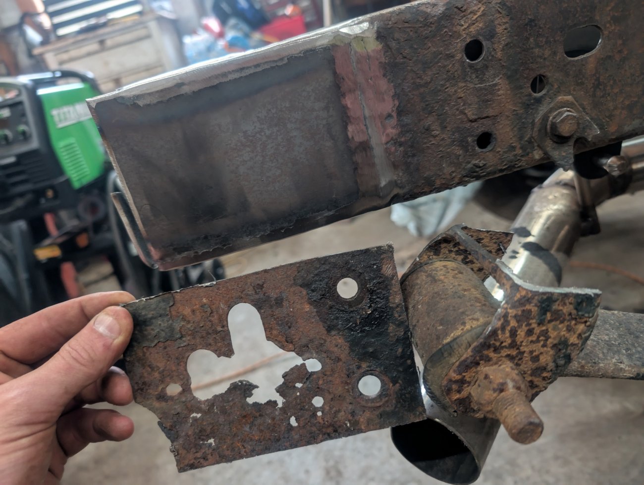

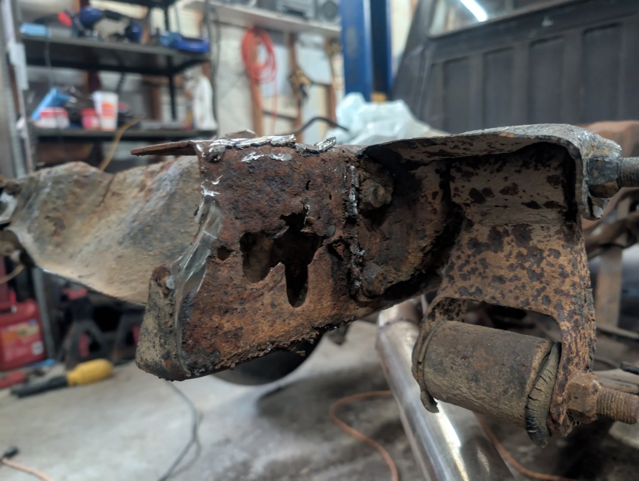

Previous owner meatballed a couple pieces of 3/16 strap over the crummy part of the frame. I took a flap wheel to their crap weld along the top until I could sneak my air chisel in and then just peeled the rest of it off like the top of a spam can.
1996 2 door flareside TRX KILLER!
Yeah, pooched. A bit further forward than I hoped too.. I was hoping I could leave the rearmost shackle hanger holes but it was just too thin.

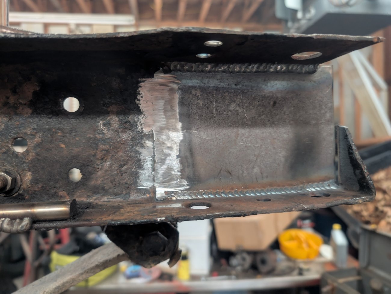

Ground the vertical weld down on the inside so an overlapping plate can be welded on nice and flat..
Flap wheeled it as smooth as is needed.. MUCH BETTER!

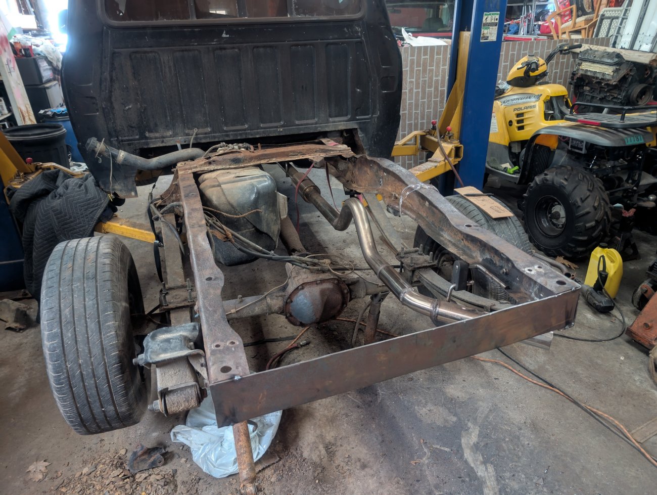

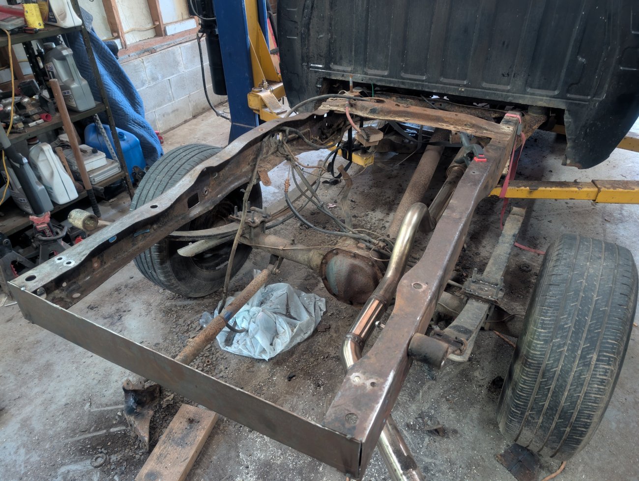

Tinkered with the truck for a few hours on Saturday.
Back of the frame has been cut square with the top of the rail and a temporary crossmember got tacked in..
Also busted the shock mounts off the frame.. removed the 2nd from the rear crossmember.. got my 2 shackle hanger holes drilled in the patch from the previous weekend and marked where the shackle hanger holes need to be in the fishplate.

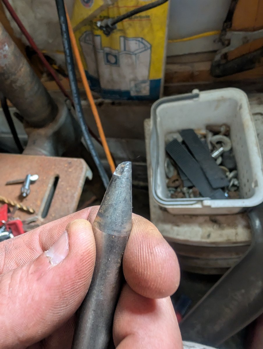

Broke one of the HF air hammer bits too somehow.. disappointing considering the material I was using it on is MUCH softer than itself..
Oh well.. sharpened it up real good in the bench grinder and it made a good center punch for the holes I drilled lol.
It's crazy how flimsy the frames are on these.
Before I tacked that piece of flat across the back of the frame my passenger side rail was "unsupported" from the very back until the front spring hanger.. and I could twist the frame around back and forth nearly an inch and a half lol.
Gonna try and patch up the thin spot behind the driver's side shock mount next weekend..

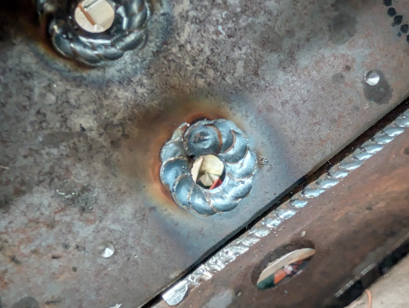

Whelp, ranger Sunday was mostly a bust.. again 😑 thanks to an empty bottle of shielding gas. Goddamn tanks always seem to run dry when your most in the mood to frizzle fry some metal together don't they? Gah.
I did manage to get a whopping 4 welds done at least..

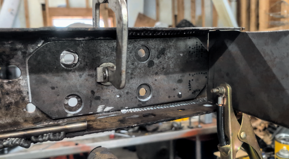

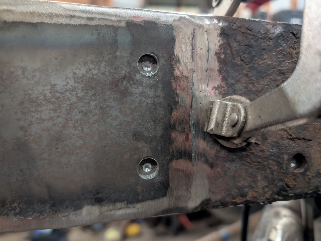

My solution to getting a full perimeter weld on the fishplate was to make the holes in the plate pretty much 2x as large as the holes in the frame.. that way I could weld the inside diameter of the plate and still have room for a bolt to slide through easy peasy.
I'm pretty heckin happy with how it's turned out. I'll flap wheel the welds flat and then double up on some XL washers when it's time to bolt the hanger back on.

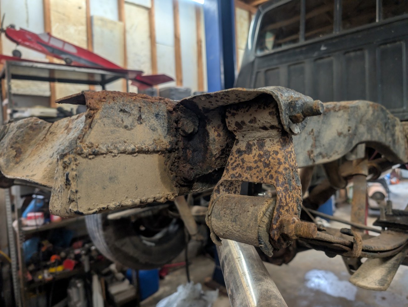

Fuel tank has been removed, the remainder of the leaf spring related brackets have been removed from the frame, and the leaf spring bushings have been exorcized.

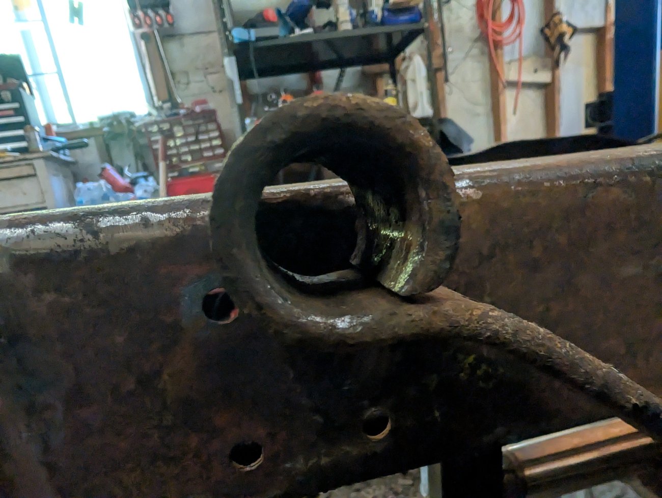

Oddly (but thankfully) none of the leaf spring bushings had the annoying outer sleeve. Just rubber and the inner sleeve shoved into the leaf..
The insides of the eyes are kinda lumpy bumpy and need to be hit with a flap wheel to fix em back to round but I'm relatively sure I have a bag of them kicking around somewhere that are close enough to the right diameter to work. Everything will be replaced with poly.

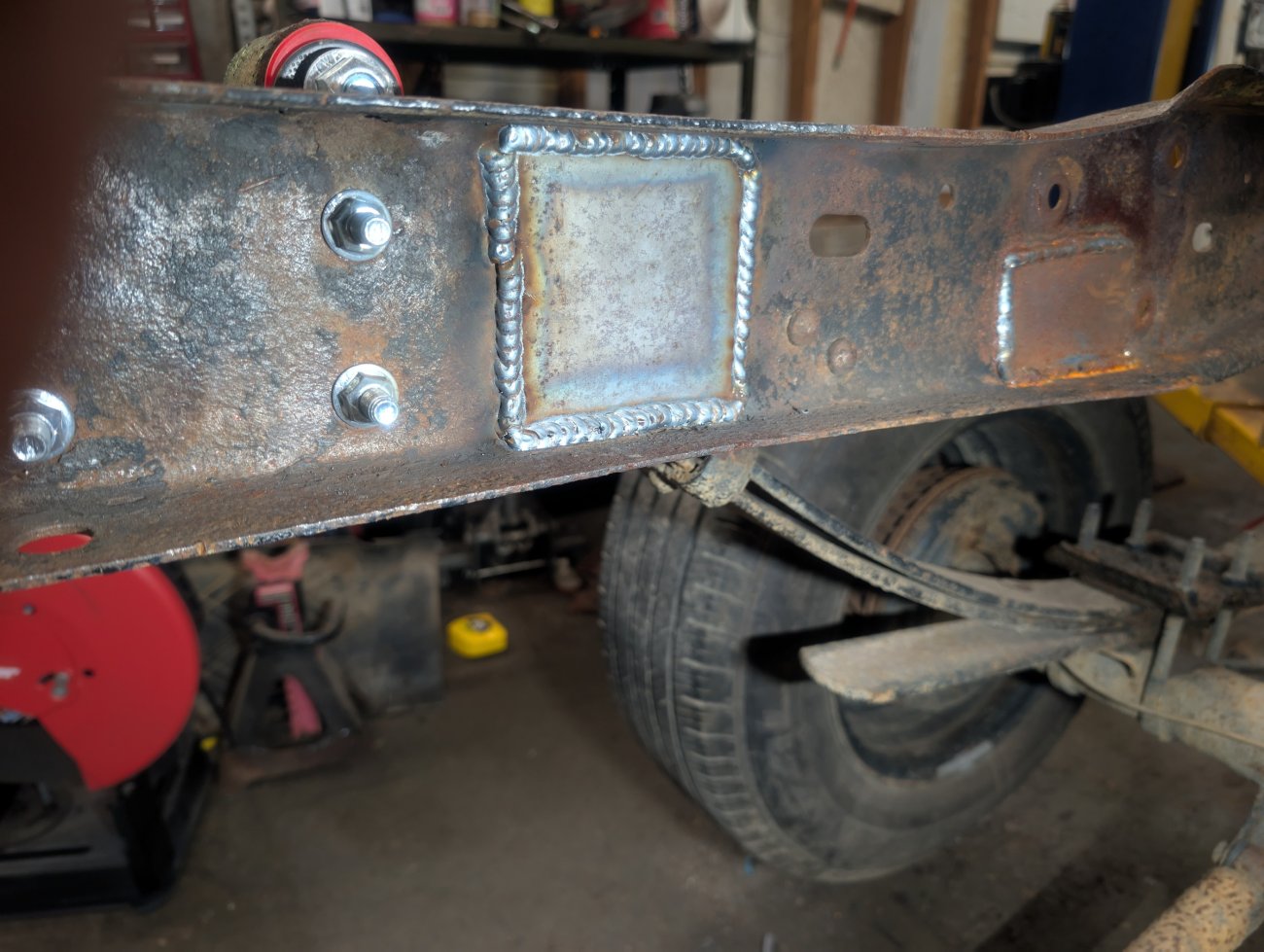

The rear suspension has all the poly bushes in it now, the thin spot by the driver's side shock mount has been patched & plated (shoulda plated the outside rather than the inside... Oh well) and I finally got started making it new crossmembers today.
4x4" pieces of 1/8" welded to the frame so far, will be welding some 2.5" round tube between them next weekend. I forget how thick the tube I bought is.. I believe it's 14ga.. either way.. these are gonna stiffen up the frame greatly AND weigh less than the junk ones I ripped out of it 👍🏻 hell yeah.

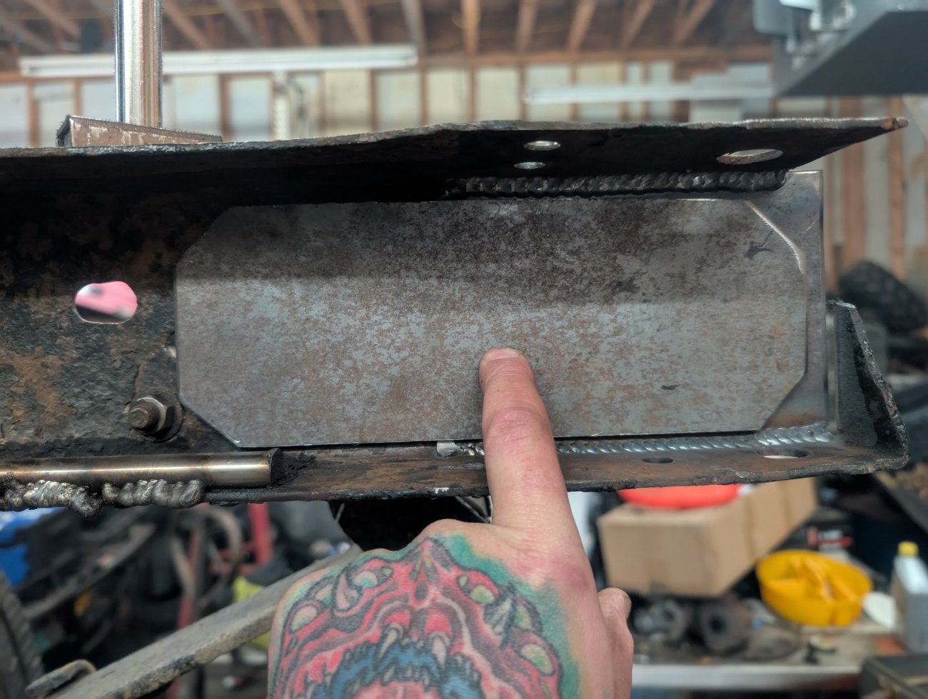

Next time you make plates round the corners. Sharp corners are stress risers and can propagate cracks.
I totally meant to.. dunno what happened to that train of thought between the time I was cutting them out and welding them on though lol.. d'oh!
A few posts up you'll see that I cut the corners of the plate I put behind the passengers shackle hanger at 45°s.... Is that kosher enough? or are real deal ROUND corners really the way to go?
perfect circle is the perfect distribution of the stress load. The second you start making it oblong, or if you have any kind of sharp corners, even if it’s a very wide angle, that will be more of a stress point.
Thanks gents! Duly noted.. will be making things as round as I can from here on.
Generally the expectation is that the patch plate will be the same thickness of the frame, then you fish plate both the inside and outside of the patch plate.
Round the corners as much as possible, and where you do have a point, run the welds out 3/4 or 1” out past where you normally would.
