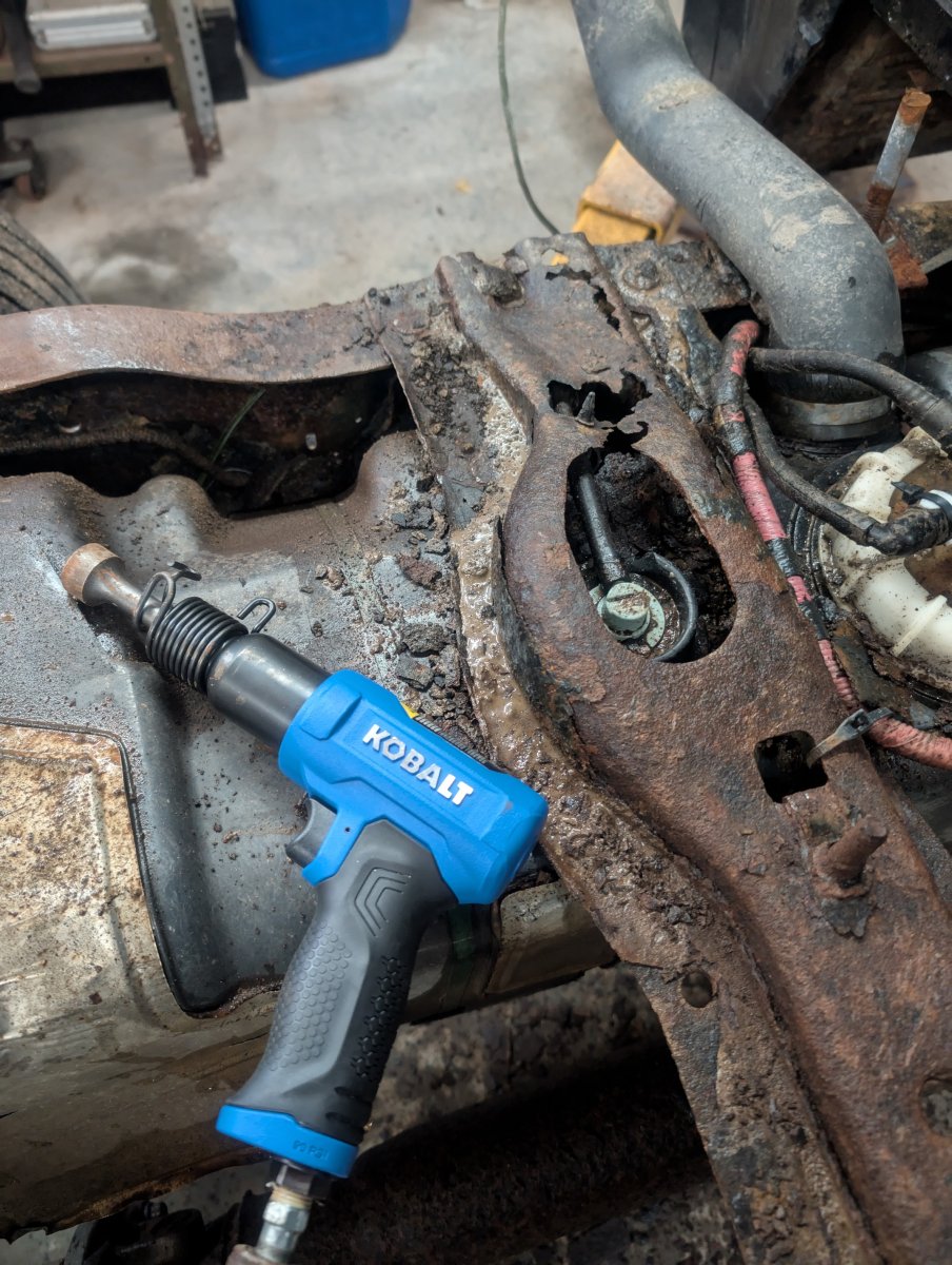

Official update I suppose..
Bed is off the truck and the process of prepping the back half of the frame for repair & paint is well underway.

P.O.R.-15, not sure if your familiar with it. Darn good coating to use in this situation. They aint kidding about wearing gloves. That stuff has to wear off of you if you get it on. Its pricey, needs proper prep like anything else. (this aint rickoleum) eastwood products makes something similar but Ive never tried it.
My buddy POR'd his f150 years back and neither of us were too impressed with the stuff considering the cost & how long it took him. He followed the directions perfectly and it really didn't hold up much longer than a RickOleum© spray bomb job.. started flaking off like a bad sunburn after a couple years.
My plan is to use Corroseal (rust converter & encapsulator) and then hit it with some tractor paint. The tractor paint may get brushed on.. or it might get mixed with some hardener and sprayed on.. not sure yet.
For the record, it’s RickOleum(R), not (c).
And from a chemical engineering perspective, conversion and then encapsulation will always be the best thing if you can’t literally physically remove every bit of rust which would also involve disconnecting whatever pieces and members. If there are void spaces, use a coat hanger and a little bit of a rag, and dip it and then work it all around the inside.
That should be done first, and I’ve said it before, mix your RickOleum(R) 50-50 with mineral spirits, and splash it on with a long hair brush. The thin mixture will penetrate everywhere. Within 24 hours, before it totally cures, do a full strength second coat.
