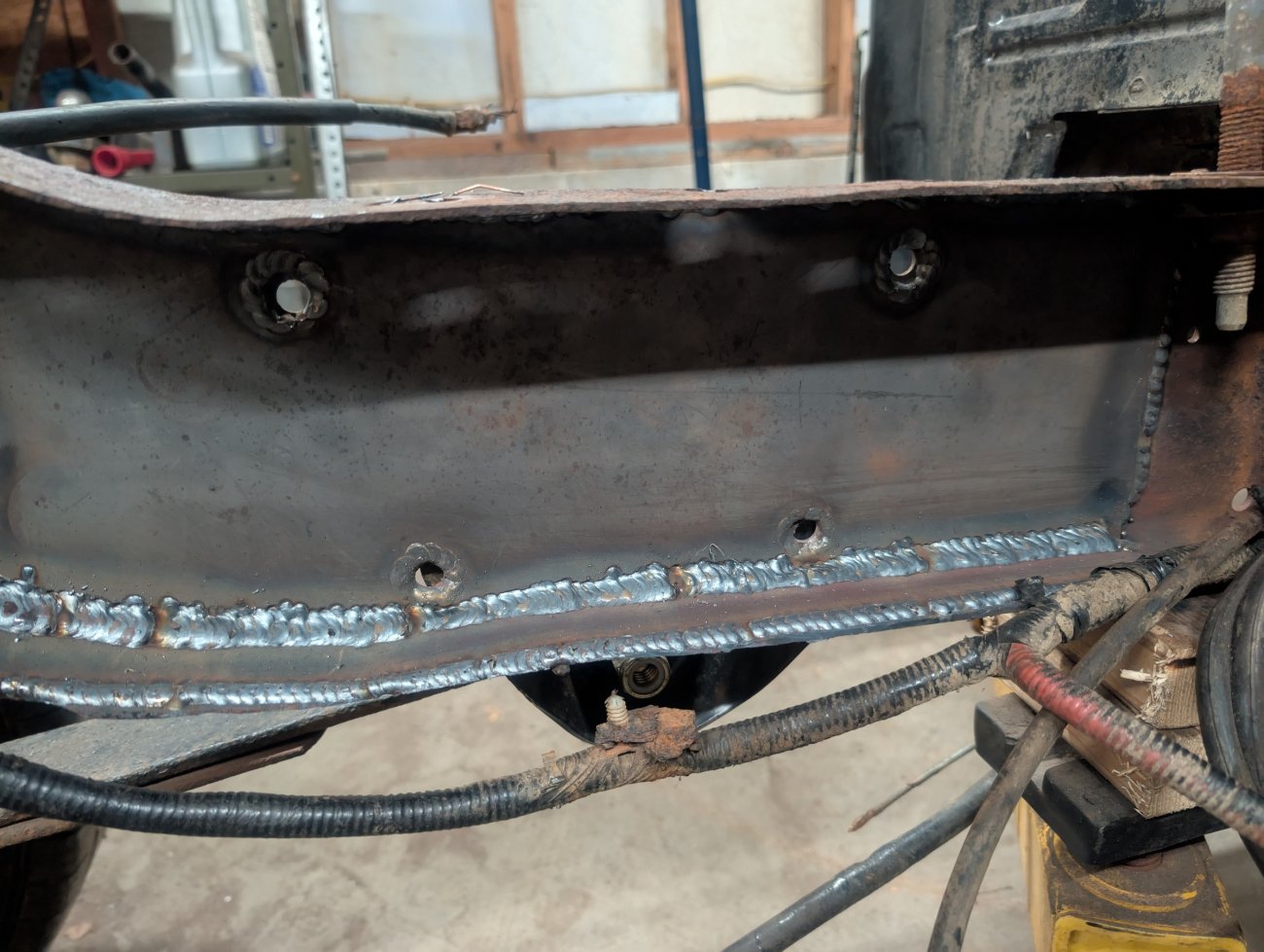

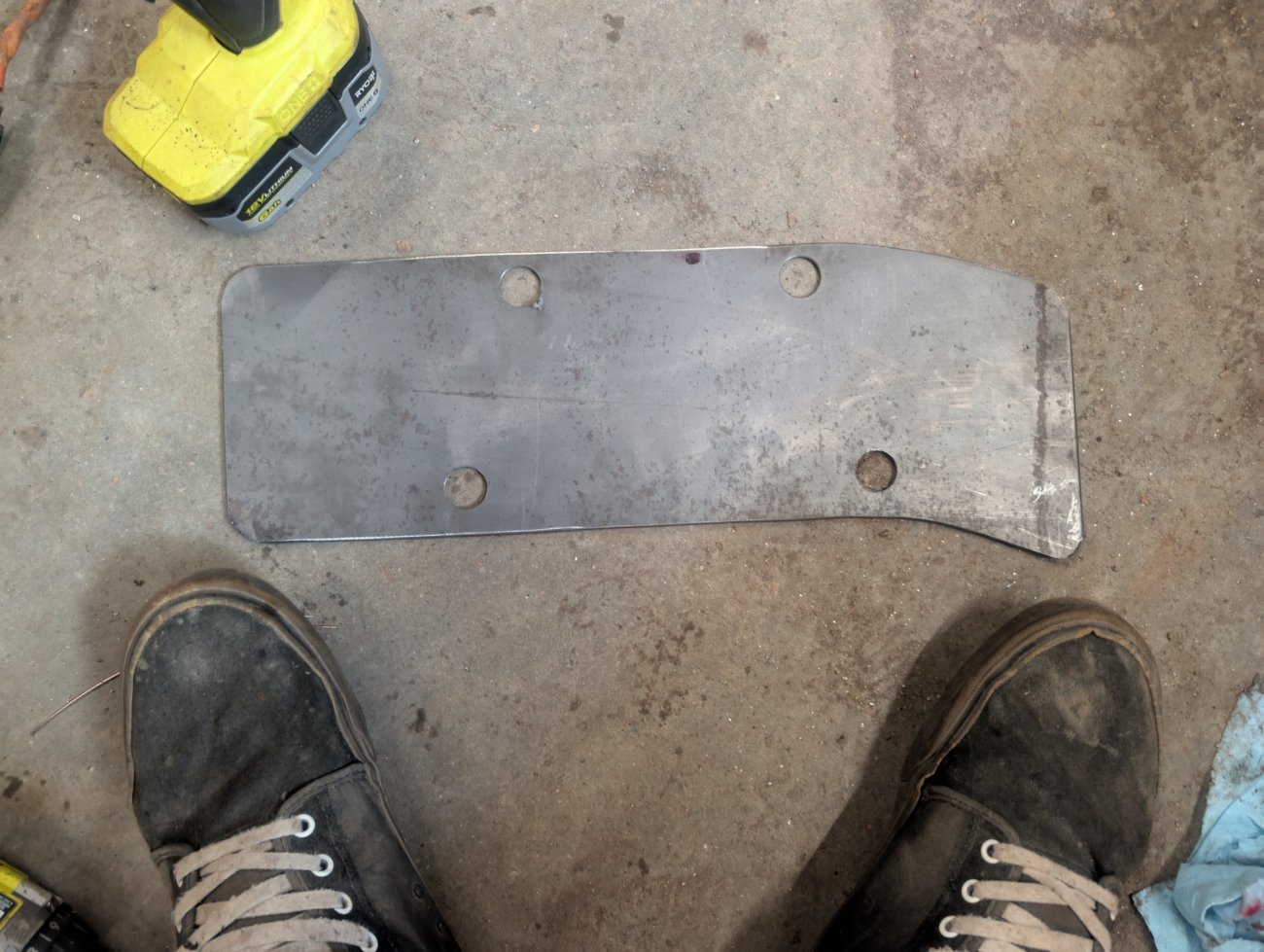

Finally got my big fishplate welded on (I radiused the corners 😎)
I cut it slightly undersized height-wise so when I welded the top&bottom the bead would hitting both the web and flanges of the frame. Also got the extra strip welded on the bottom flange because it was starting to get thin in spots and I figured it this whole area could use as much reinforcement as possible. Did two passes along the 'crotch' of the fishplate & bottom strip for the same reason.. whether or not the extra pass will make any real difference or not I have no idea 🤷🏻‍♀️ sounded like a good idea though.

Nice work !

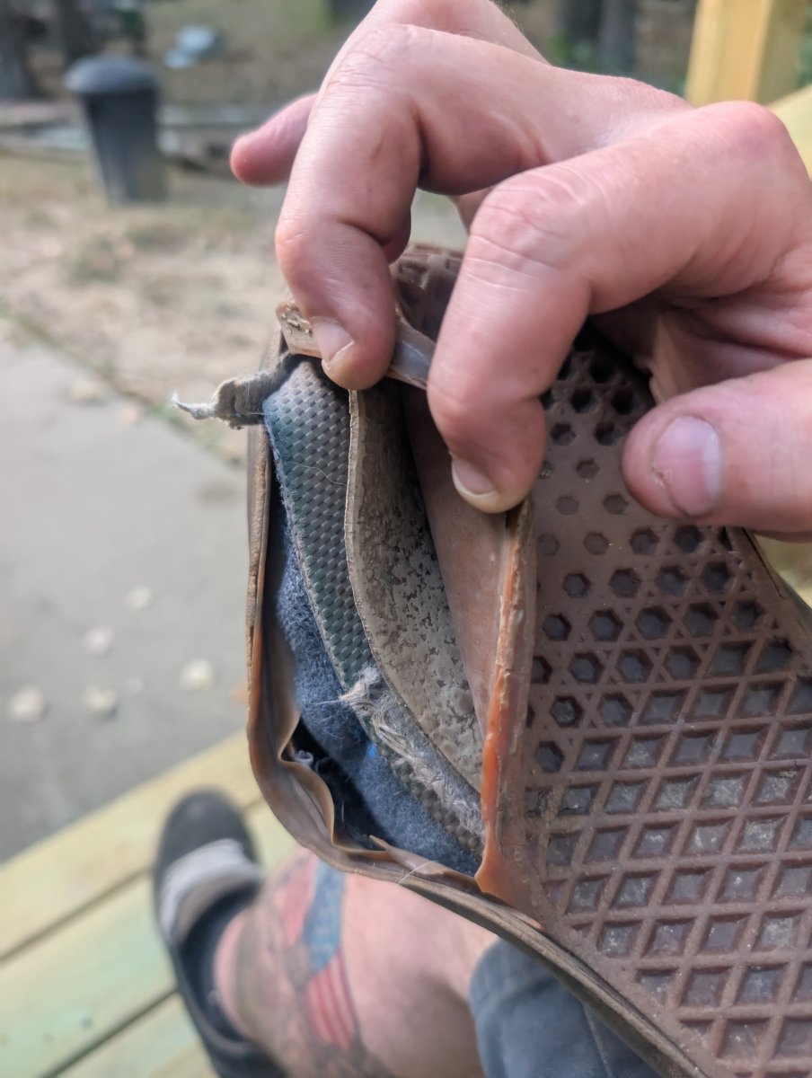

Sneakers...not so much.
Nice work !
Thank you! It's my first time really doing this caliber of frame repair.. learning a lot and enjoying myself (for the most part lol)
Ha.. yeah.. not only sneakers but sneakers that are well past their experation date 😋
They've been relegated to only being worn on days that are nice and dry lol. It was definitely a mistake wearing them in the garage though.. absolutely no support. My legs were killing me at the end of the day.
I'd buy a new pair but... They cost the same amount as the fuel cell I'm gonna buy so... Priorities! (Lil bit of cheap Yankee too honestly)
I DO wear real boots whenever there's risk of dropping something heavy on my feet though.

E6000/GOOP Can fix those.
And then mix up some 50-50 brown rust, oleum, and mineral spirits, and just lightly dashed them with a cheap brush.
They’ll be like new

I e6000'd them a couple years ago lol.. suppose I could try another application though.

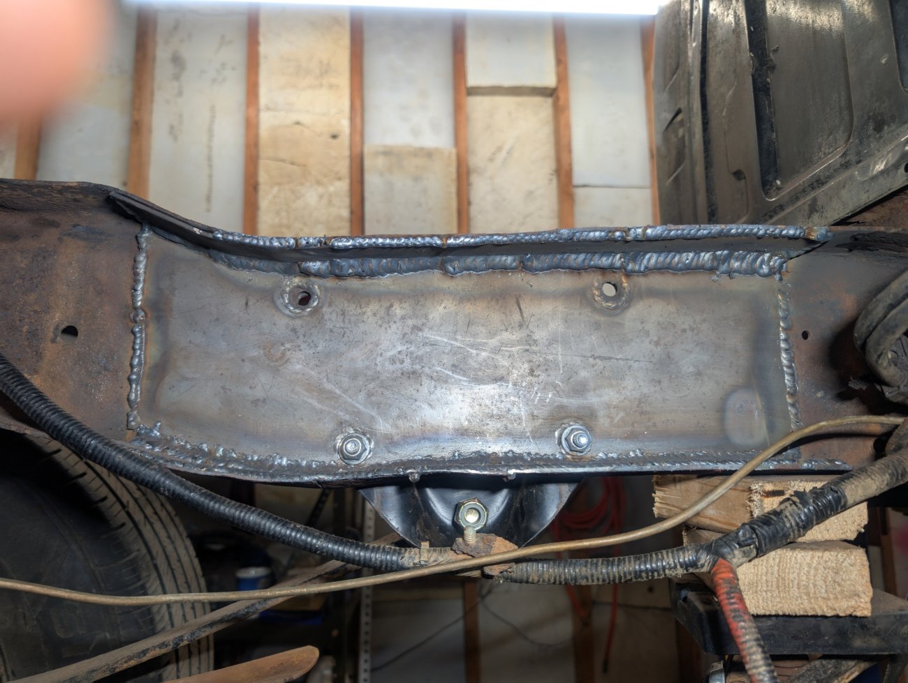

Anyhow.. essentially done with the driver's side spring hanger frame repair, and dangerously close to being done with the crossmember.
I got the strip to reinforce the top flange of the frame cut, bent, and 99% welded on. Much like I did with the strip along the bottom flange.. I made an initial pass with the welder to melt the strip to the fishplate and then made a heavy 2nd pass over the first. Idk if that's gonna make anything truthfully stronger or not but... Sounded like a good idea!
I'm not happy with the vertical weld on the left side of the fishplate.. the frame wasn't really clean enough and I tried running the puddle uphill.. didn't really work. It may be good enough but.. it looks like crap and I don't like it. I'll flatten that ugly SOB and go over it again for both peace of mind and for the sake of useless vanity lol.

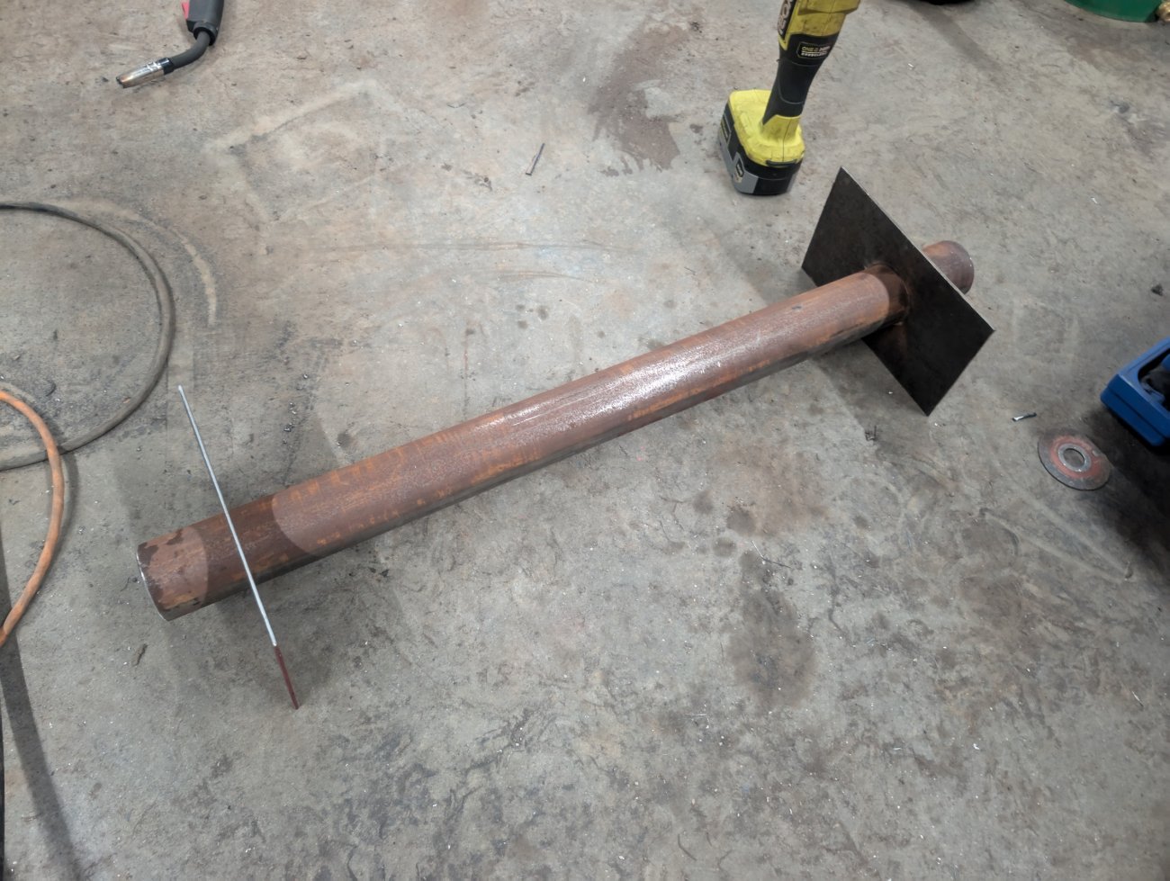

NICELY RADIUS'D plate to weld the crossmember to (passenger side obv)
The crossmember with the bits of steel I broke in my drill press punching holes in.. they fit like a glove 👍🏻 I fking love drill presses!!

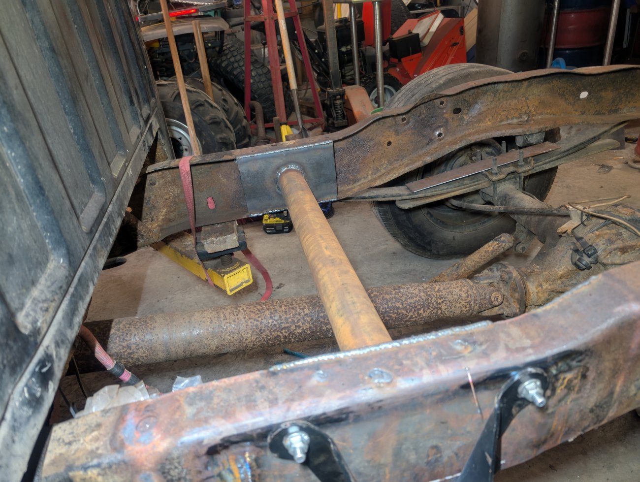

Crossmember tacked Into place..
And pretty much what it'll look like once it's done.
The fishplate may have been enough.. but i like the peace of mind that the slight boxing will provide me. Once I'm done welding the crossmember to the frame I'll be welding those plates to the frame and then welding the seam between the crossmember and the boxing plates. Should be plenty strong enough for where we're going.

The only issue I have with boxing a frame is that it will hold dirt/moisture better & then create (another) rust issue. Granted it has more days behind it than in front of it . Your patch looks well done, the pipe crossmember going to allow the fuel tank to fit? just looks low to me. I need another ranger project once I have the tractor finished. Having a shoulder issue really has slowed me down this summer. Check your frame at the rear shock brackets too, my ‘94 had holes there on both sides.
Thank you! Everything fits just about as nice as it could considering my near caveman methods & equipment.. and I'm super chuffed with how it's turning out.
Holding dirt/moisture is a non-concern for the build though, it's gonna be an 8th mile racer & burnout machine once it's done. I'm going to strip the remainder of the por15 that's barely hanging onto the frame (there's not much left), corroseal it, and then slather it in nice thick implement paint. I may even go as far as to actually mix the paint with hardener and shoot it with a real gun..
Either way.. minimal dirt roads, no mud, no salt, regular washes.. I'm hoping I can keep it solid for a good long time.
Stock tank definitely wouldn't fit though, no. I'm going to be running an aftermarket fuel cell that'll be mounted as far back as I can get it inside the bed.. probably a 10 gallon cell.

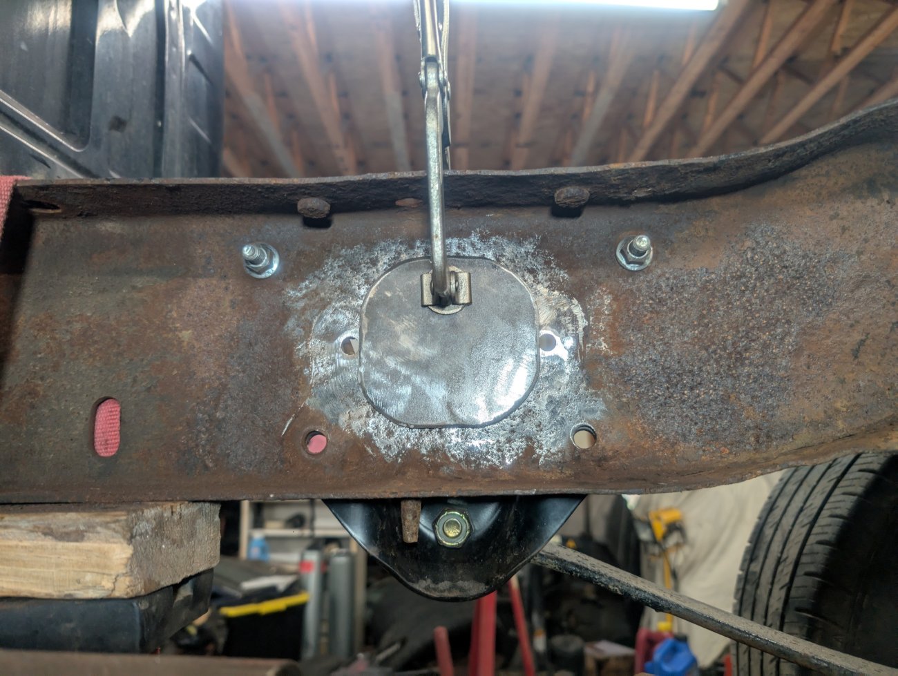

My shock brackets were toast and there was a small hole in the frame next to the bracket on the driver's side. Cut it out, scabbed a piece into the hole, and then plated over it. I messed that one up though and put the plate on the inside. Now the shock mount won't go back on straight unless I space it out with washers on 2 of the holes lol.. shoulda plated the outside.. oh well 🤦🏻‍♀️ learning experience.

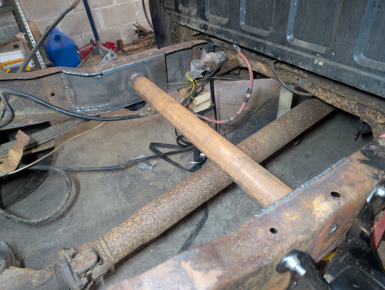

Finished the crossmember!
Trying to figure out what to do about the 3rd one that's supposed to be right over the axle.
There wouldn't be enough room between the top of the pumpkin and the crossmember if I were to use tube.. the diff would hit the tube long before the axle would even be close to the bump stops..
connecting this crossmember to the one back by the shackle hangers with 2 pieces of tube.. one on either side of the diff.. might be the ticket. I'll assess more closely next weekend.
