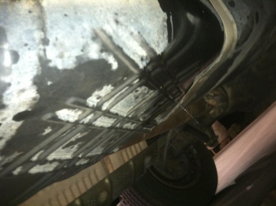

Upon filling her up tonight, I heard a leak and saw a steady stream of fuel coming out of the bottom region of the tank. Due to my frustrations of the issue and lack of extensive knowledge in the realm of Fords I assumed it was a crack in the gas tank.
I did a bit of research and came across the seemingly common problem of cracks in the filler nozzle and whatnot. What is the likelihood that this is my problem? The leak was a very steady stream for approximately 4-5 minutes.

I drove it about a mile and parked, looked under to find the gas tank to be wet, and fifteen minutes later found a wet circle of fuel approximately a foot in diameter beneath the tank. Drove the truck home, and while the tank is still wet there is no visible dripping.
Could it be that there is a crack towards the top of the fill nozzle and it leaked because it was so full, and the fuel pressure while driving is making it seep out?
Attached are 2 pictures from last night, one of the fuel that leaked and one of where I saw the drip. The other picture is the wetness of the tank currently.

More than likely you just have a dry rotted rubber coupling on the filler neck. You can only imagine what a 20 year old chunk of rubber hose looks like.
As was recommended lift the bed off and take a look. If your filler neck is like mine you only need to buy a bit of hose to replace the bad coupling. Mine is metal and is two pieces coupled with the rubber chunks.
