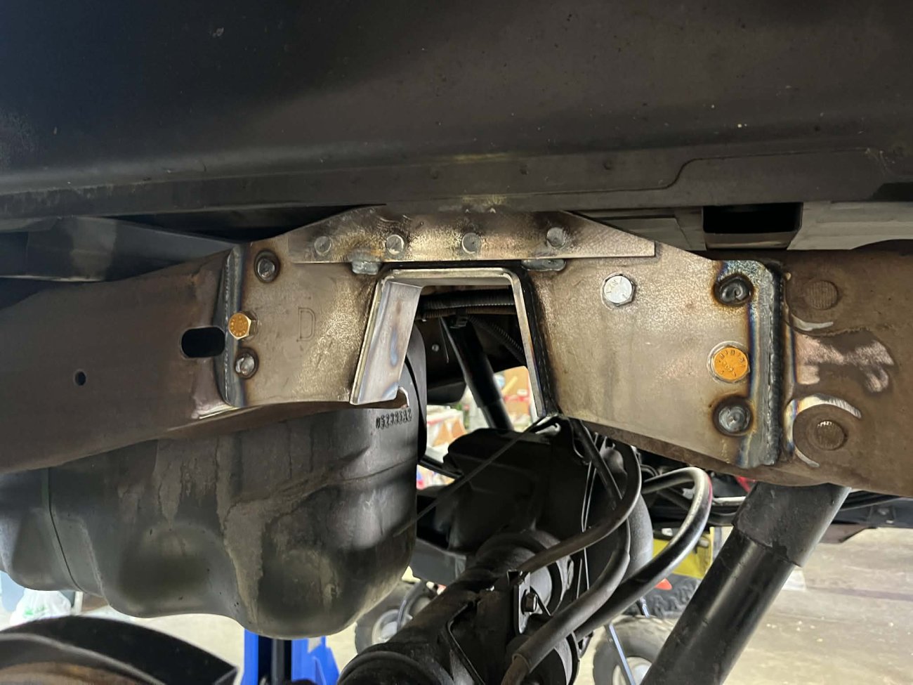

Mine is a 95 regular cab 2/4 drop and was also sitting on the bump stops. I installed a set of Ricks notches. They're designed so you don't need to modify the bed.
