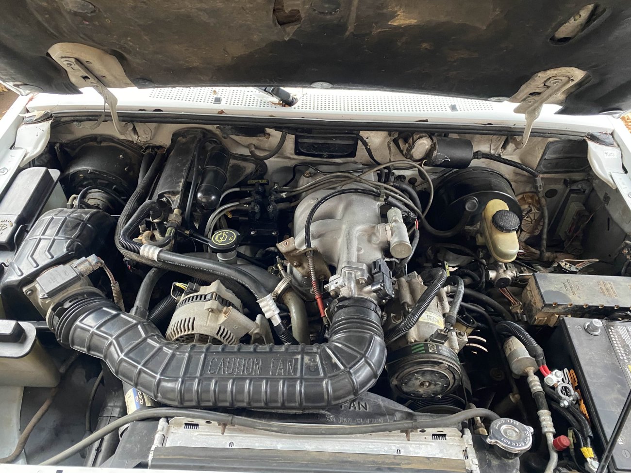

So far I have drained the tank and got fresh gas in it as well as checked the rocker arms for any looseness. The whole engine bay has been cleaned out with the main engine bay harness being replaced (by me) with another used unit that I continuity and resistance checked.(I have not replaced the two engine harnesses just the engine bay with the fuse box and computer plug) I have not run a compression test yet but the pistons have some kind of compression at least just from shoving my thumb in the spark plug hole.
The old computer was giving out random codes inconsistently and when I disassembled it I found the blown capacitors. I was just going to replace them but i then noticed that multiple traces were damaged if not shorted. It looks like it had time to soak into the board for a while. When I installed the new (remanufactured) MCU that’s when I got fuel injection and consistent codes. Currently I still have no spark (tested with spark plug and tester) and the 226 code. I also checked for any signal down to the coil pack and the ignition or the three coil wires and there’s nothing. The ignition computer was replaced by the previous owner but I’m wondering if a combination of sketchy wiring and dead main computer killed the ignition control module.

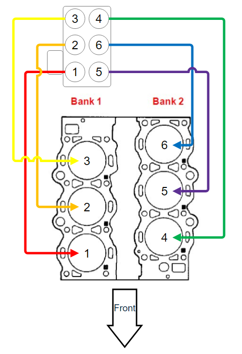

Welp I'm running out of ideas. I got the new ignition computer in and the computer sill looks like its throwing the 226 code. I checked continuity between the computer and the coil pack just in case as well as checking the coil and spark plug order. (fancy graphic I made btw in case anyone wants a more visual guide) It still turns over great but no spark from what I can tell. Maybe dig out the crank position sensor and test it next?
