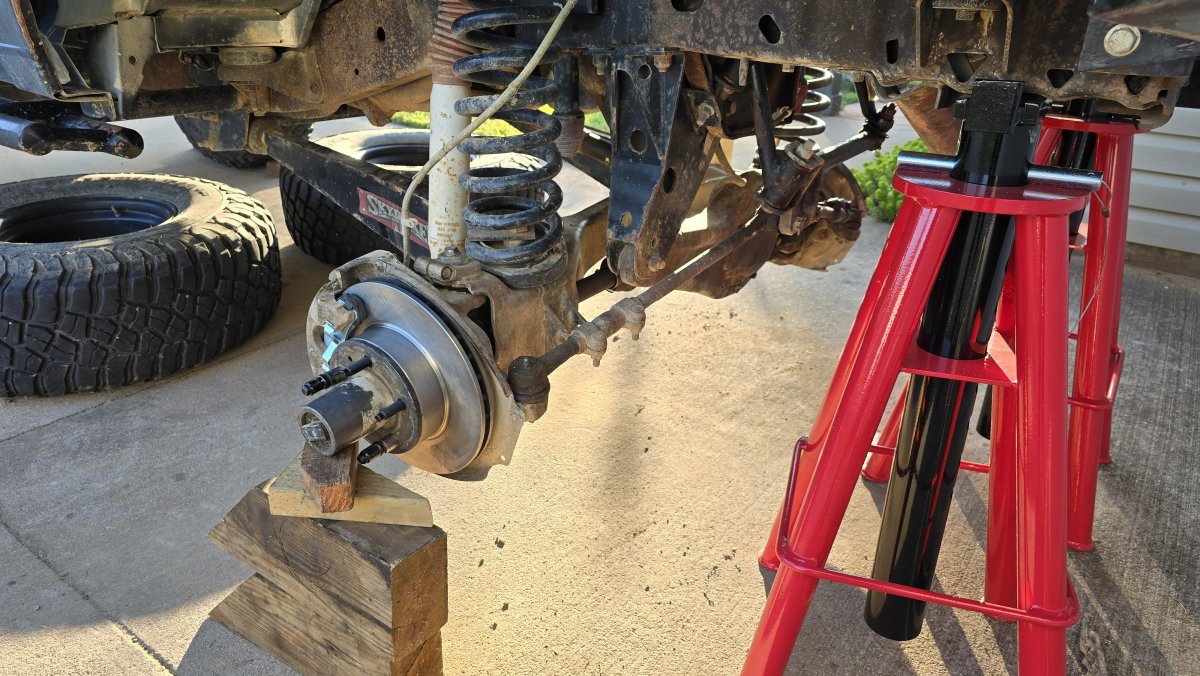

Well, I finally started in on replacing the outer axle shafts on the front end. Im about half way finished with the driver side. Also replaced the axle shaft seal on the diff housing.

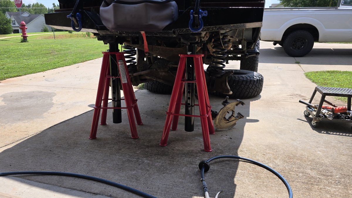

I like my new jack stands. Though I could have gotten the next size shorter.

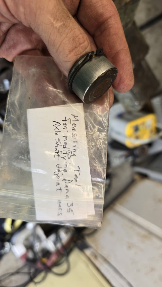

Doing the mod to allow full circle retaining rings for the U-joint cups. Wish I had a milling machine. This could be a lot prettier.
Test fit
Took an old cup and ground the outside so it slips in and out by hand. Made a good test gauge. Will save this "tool" for future use.

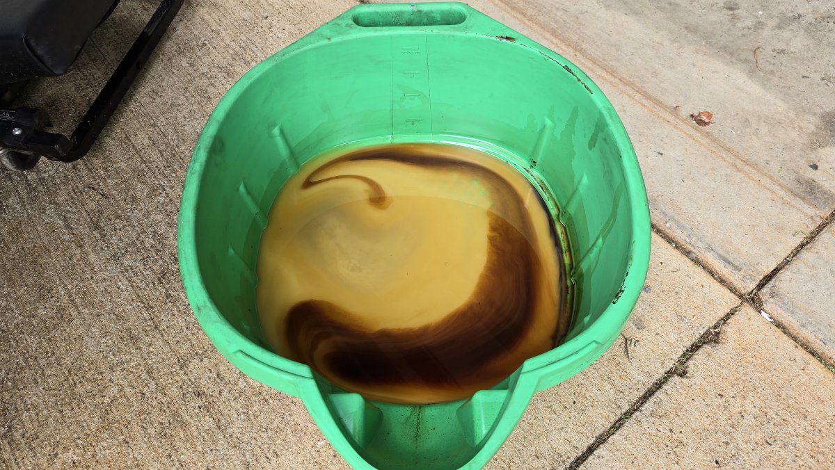

I should probably change the diff fluid more often. On the bright side, there was almost no particles on my magnetic drain plug.
That u-joint tool I bought a couple months ago is worth every penny. So easy to remove u-joints. Picture showing the new outer shaft already installed.
I got most of this finished today. So, total progress in the front Dana 35 is;
1. New axle shaft seals on the differential outputs.
2. Cleaned and re-lubed the spline joint on the passenger side axle shaft.
3. New outer axle shafts, both sides
4. New spindle bearings and seals
5. New brake rotors
6. New wheel bearings and seals
7. New brake pads
8. Refilled the differential.
9. New adjustable camber/caster bushings
10. Cleaned the threads on the camber bushing pinch bolts and cleaned the whole pinch bolt area so, hopefully, I can tighten them enough to prevent the adjustments from wandering.
All that's left is to put the wheels on and do the alignment.

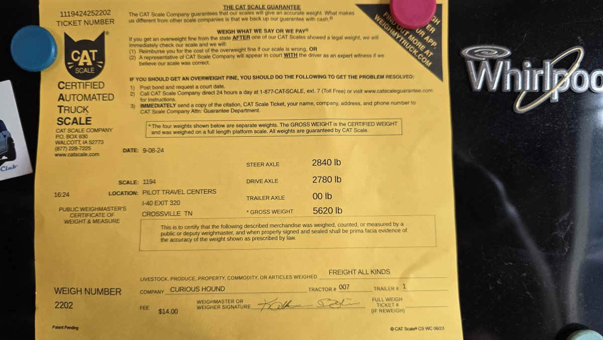

Put it in the scales yesterday, after filling up with fuel. Much, much heavier than I thought it was. This is fully loaded at the end of an 8 day camping trip. Ice chest was nearly empty, but extra mud caked on all the bottom stuff. So, probably not too different than the beginning if the trip.
The ticket.
How do we compare with this?
Your only 1020 lbs over limit.:icon_twisted:
Might have to change from Curious Hound Overland to Fat Bastard Overland.

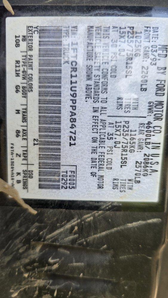

The door sticker doesn't reflect that the rear axle is a 31 spline 8.8". So, that may help a little bit.
my rolling weight is 6k. geared up approaches 8k. so i would say you are right on target.
