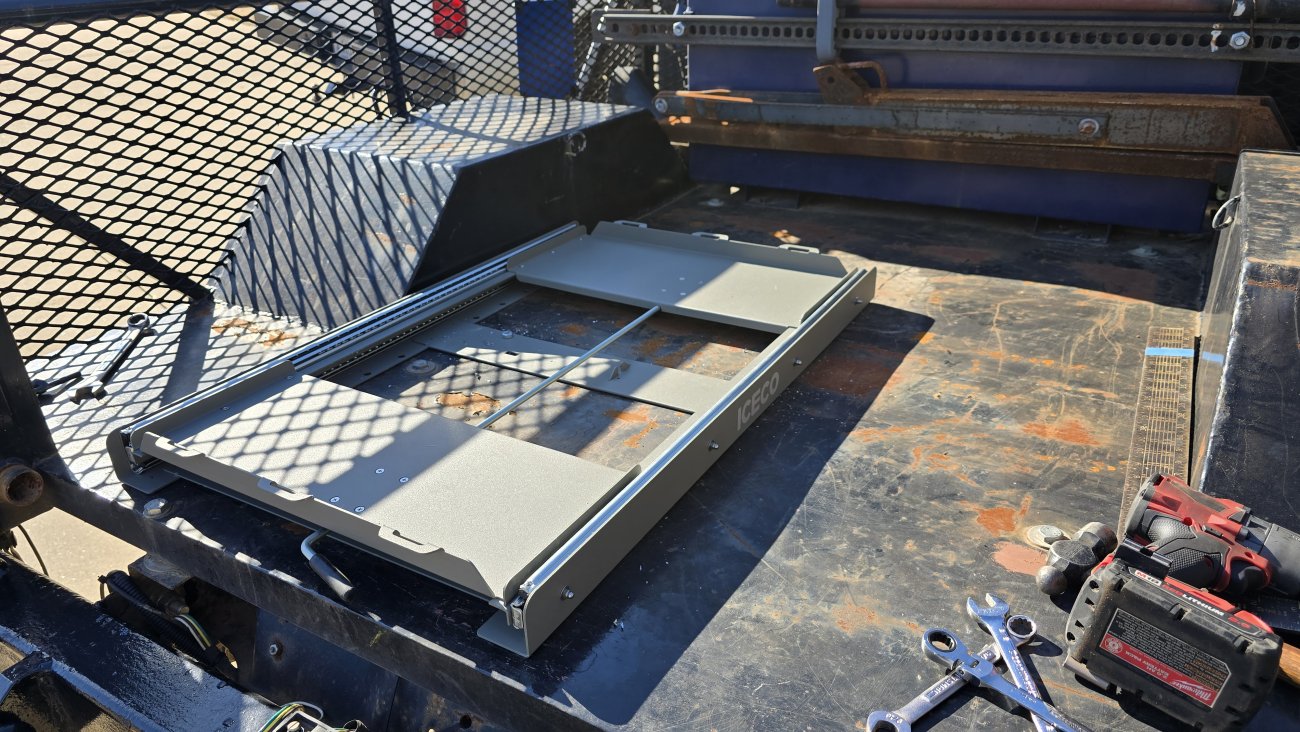

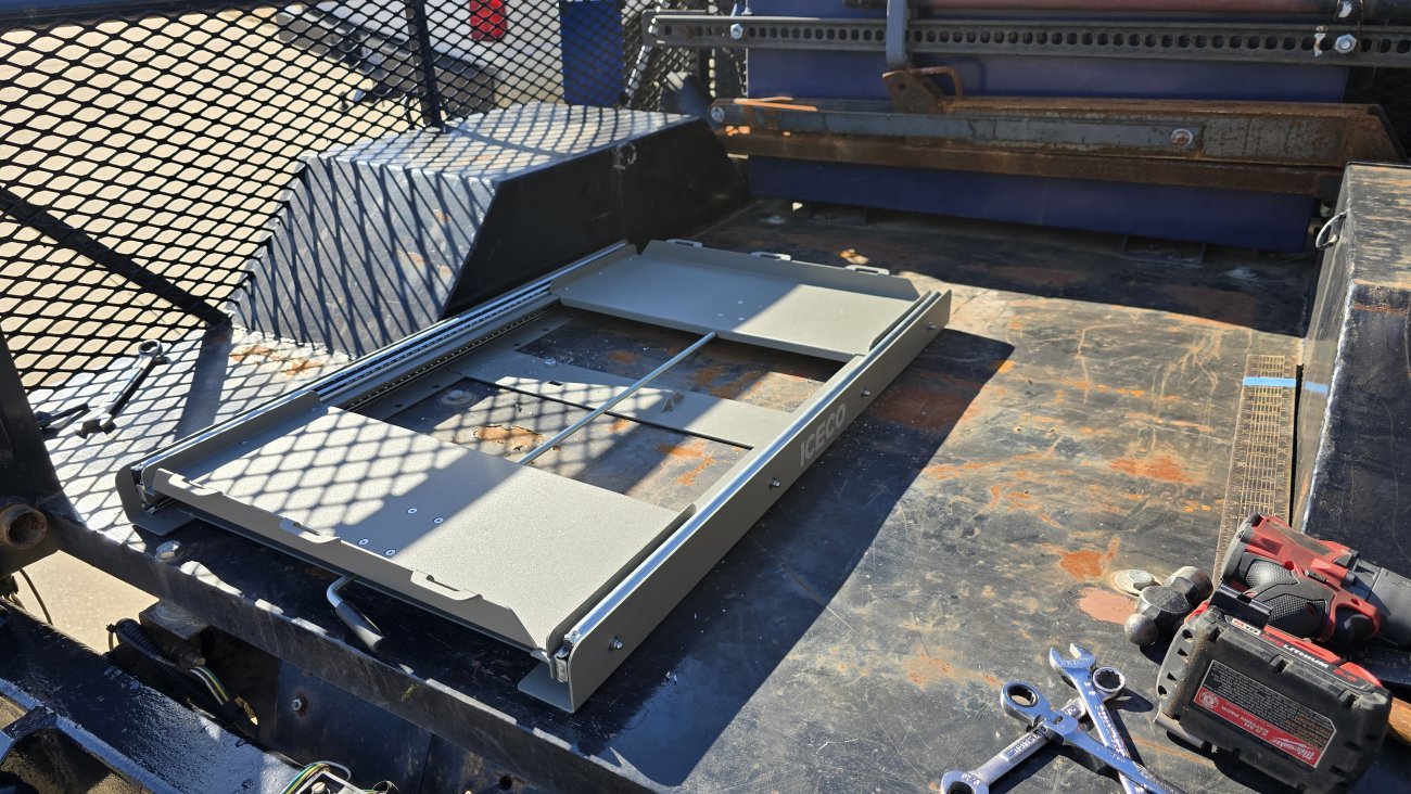

Does it just come straight out or does it drop down too?
Straight out but only with my tailgate removed. My tailgate sits a little bit higher than the truck bed. But, the slider gives clearance over the bolt heads in the bed and an easy way to tie down the fridge. I would have had to build some kind of bracket either way. This saved a lot of time. I welded nuts on the bottom side of the bed floor. So I can remove the slider if it's not going to be needed for a long period. That way I can keep it out of the weather.

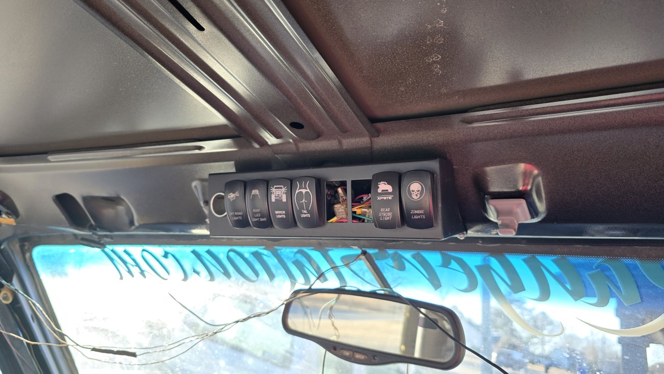

I also began mounting an auxiliary switch panel that a friend gave me a couple years ago. It came out of a Jeep. Currently, I have a collection of miscellaneous switches all over the place for fog lights, rock lights, light bar, etc. This will look and function much better when I'm finished.

I added a couple brackets to hold the switch panel more securely. Then I wired in a good ground and power source and relocated the wiring for my fog lights, rock lights and roof light bar up to the new switches. The extra holes are filled now. One with a switch for the rock lights and one with a USB charging port/voltmeter combo unit. The switch on the far right (zombie lights) will power some internal lights to replace the map lights that were on the dome light fixtures. I believe those and the new "dome light" will be LED strips. I enclosed most of the wiring in split loom.
Noteworthy info for others, I wanted to use "run/acc" power for the aux switch panel because the switches are lighted and I wouldn't want them on all the time. Since the truck never had power windows, there was an empty hole in the cab fuse panel for power windows circuits. I found the wire down below the parking brake assemble, behind the kick panel. Spliced onto it, installed the fuse and everything is good to go. A fairly convenient place to source my power and run the wire right up the A-pillar with everything else.

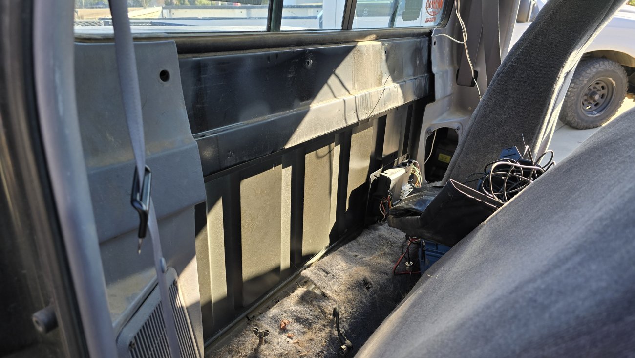

Maybe I'll take a picture tomorrow after I clean everything up. I still have to extend the wire for the radio speaker and tidy things up where the dome light used to be. I'm also relocating my fire extinguisher for easier access and my first aid kit. I need the space behind the seats for the solar panel controller and inverter that are coming soon.

Removed the carpet from the back wall. It was in the way. Need to find some grommets for cables to pass through the floor.
