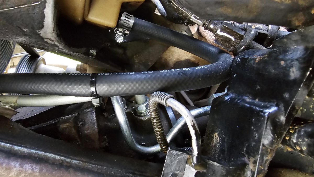

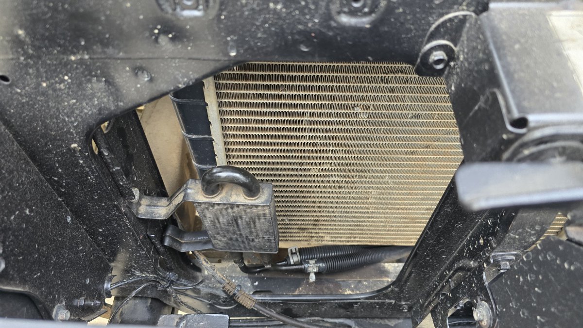

Finally installed new power steering hoses today. I've had the new hoses in the toolbox since I noticed the leak a few years ago. I had noticed increased leakage on the campiut to Round Mountain. So, decided it was time. I also cut and extended the return line and installed a tiny heat exchanger to cool the fluid a bit. The cooler came from the junk yard a while back and was earmarked for this project. The aluminum portion of thevreturn line needed some r-bending/shaping artwork done in order to point it toward the cooler location. That took some time and patience. The old fluid looked nasty. I did everything I could think of, within reason, to get all the old stuff out. Refilled with type F ATF. Everything looks good so far. I'll test drive it tomorrow.

That cooler is nice.
And it may be on your list already, but I'd add some split loom to the hose in your second picture, to keep that pretty new hose from rubbing.

Every place where it's close enough to rub has split loom installed. Other places, it is zip-tied to prevent movement. Thanks for the reminder, though.

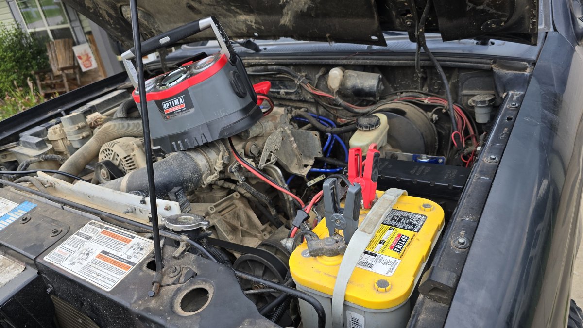

Old Optima yellow top battery is not taking a charge. Won't get past 75% and one cell is much warmer than the others. Thought I ordered a new AGM deep cycle battery from NAPA yesterday. But this morning, realized that I had never finished the transaction because their website was being glitchy. So I ordered one from Summit this morning.
In the mean time, I cut back all my battery cables to find fresh, clean copper conductors. Crimped new ends on. Had to splice on about 16" on the big negative cable. But didn't feel like buying a new cable and replacing it all the way to the engine block. Now all that is ready for the new battery and will be much neater.

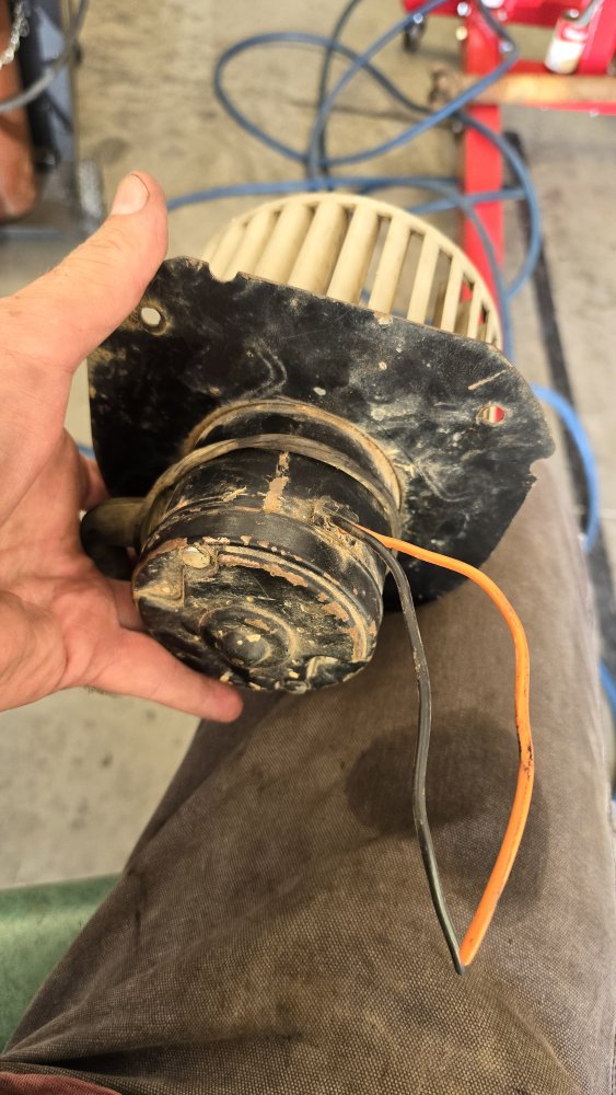

The blower motor had started squealing the last few times I ran it. Years ago, I had disassembled it, cleaned it and lubricated the bushings. My thought today was to repeat that process. But my OEM blower did not have a plug for the wiring harness. So, getting it out of the truck was going to involve cutting my previous splice out of the wires and splicing them again, making them shorter. BUT... I had a spare from the junk yard. Newer model with a nice plug on the back. So I looked at a wiring harness I had gotten from @racsan years ago and sure rough, it had the mating connector. So I cut that out with a generous pigtail. The rest was simple. Cleaned the replacement fan, including blowing the carbon dust out of the inside. Lubricated one of the bushings with air tool oil. They're bronze bushings and shouldn't need oil. But I like to do it just for good measure. Couldn't get to the other bushing because the newer motor is not bolted together. So disassembly and re-assembly would be sketchy. Stuck it in the plenum. Spliced in the pigtail and plug and, "voila!". It should be good for a few more years.

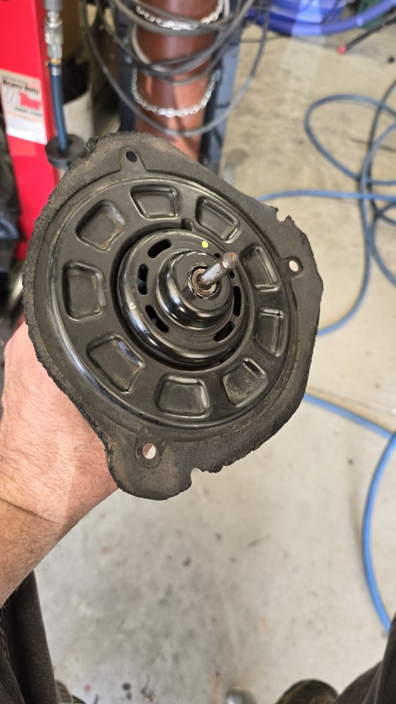

Newer style blower with plug on the back.
Other end of new motor.
old motor showing leads coming out - no plug.

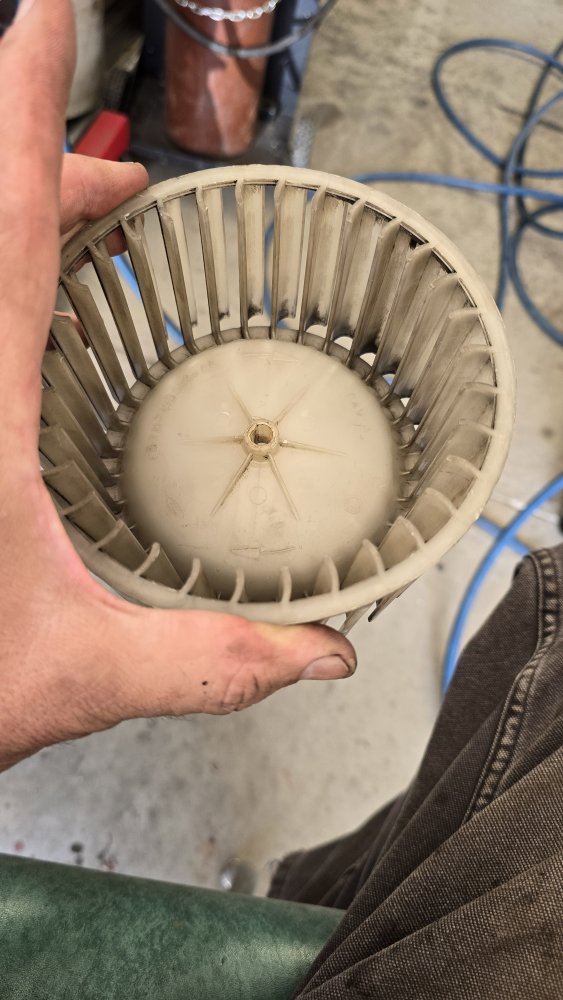

Wash most of the gunk off the wheel

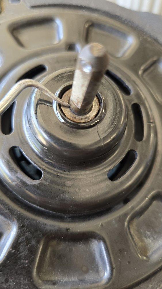

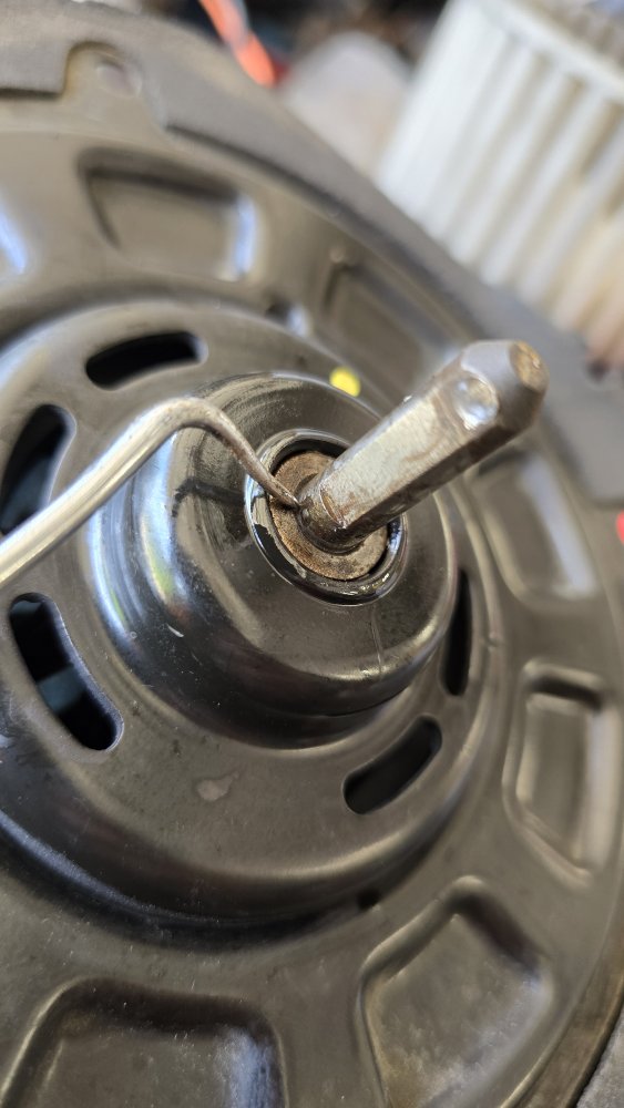

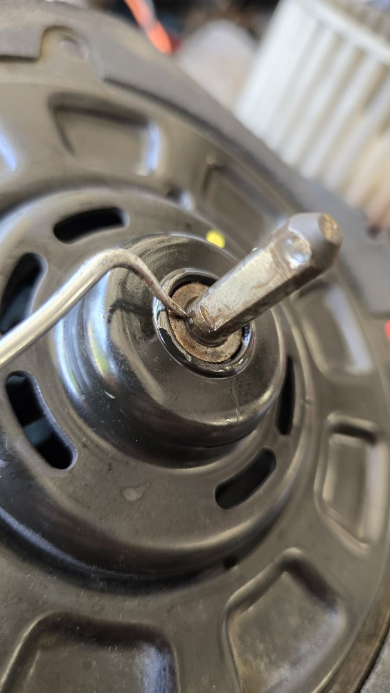

Little bit of air tool oil right next to the shaft where the pick is pointing

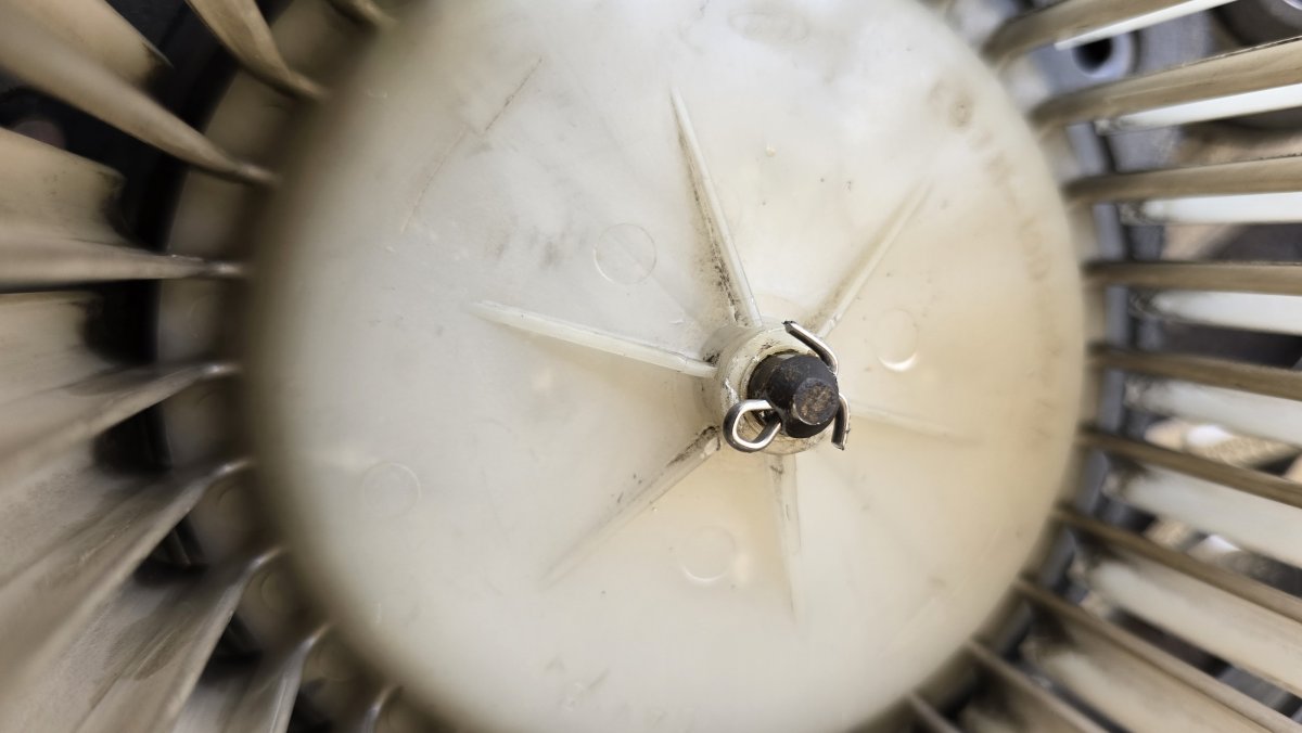

They fasten the wheel with a push-on locking washer thing. You could buy a replacement. I chose to drill a hole and use a cotter pin. The shaft has a flat side. So all this does is prevent the wheel from sliding off.

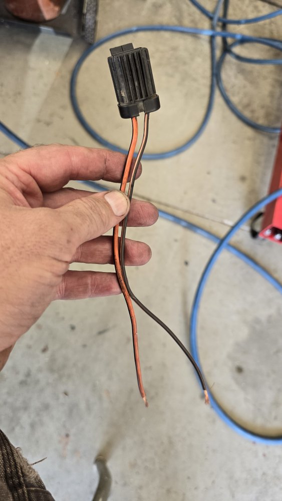

Plug and pigtail ready to splice in.
