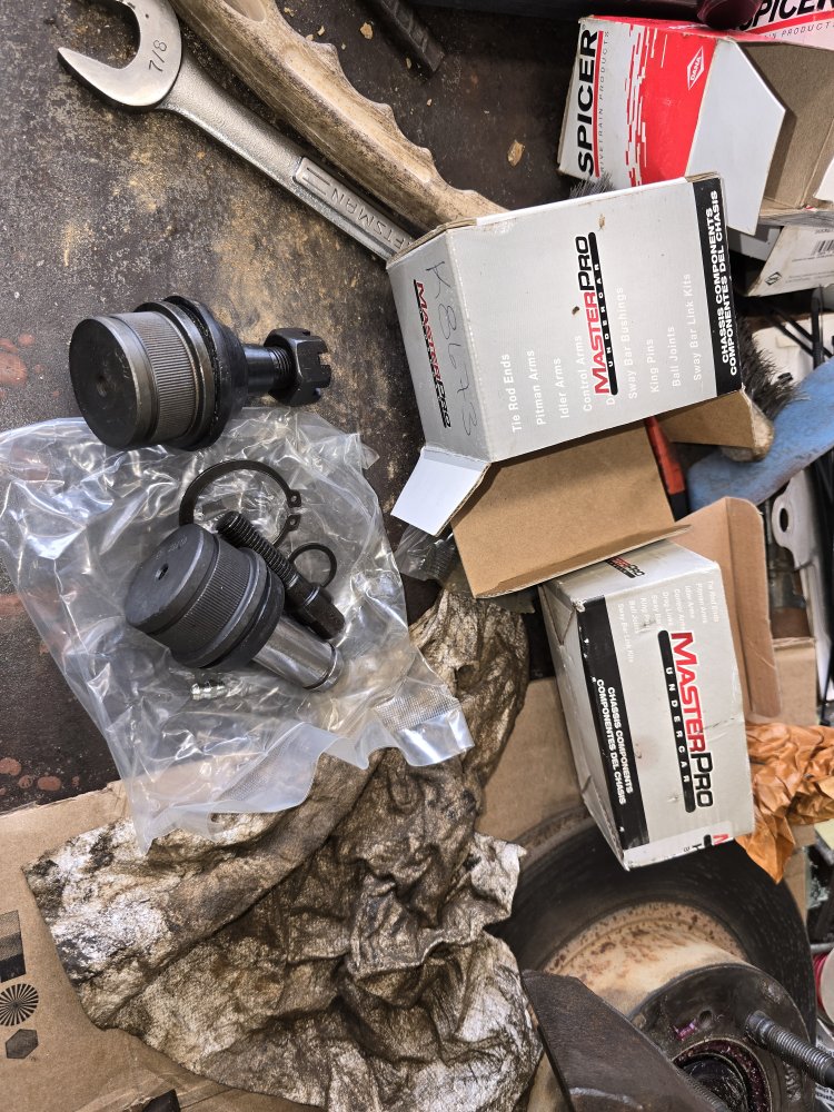

And that's exactly what I'll do. As luck would have it, I found the replacements I bought years ago for the passenger side. So, I don't have to order any ball joints today.

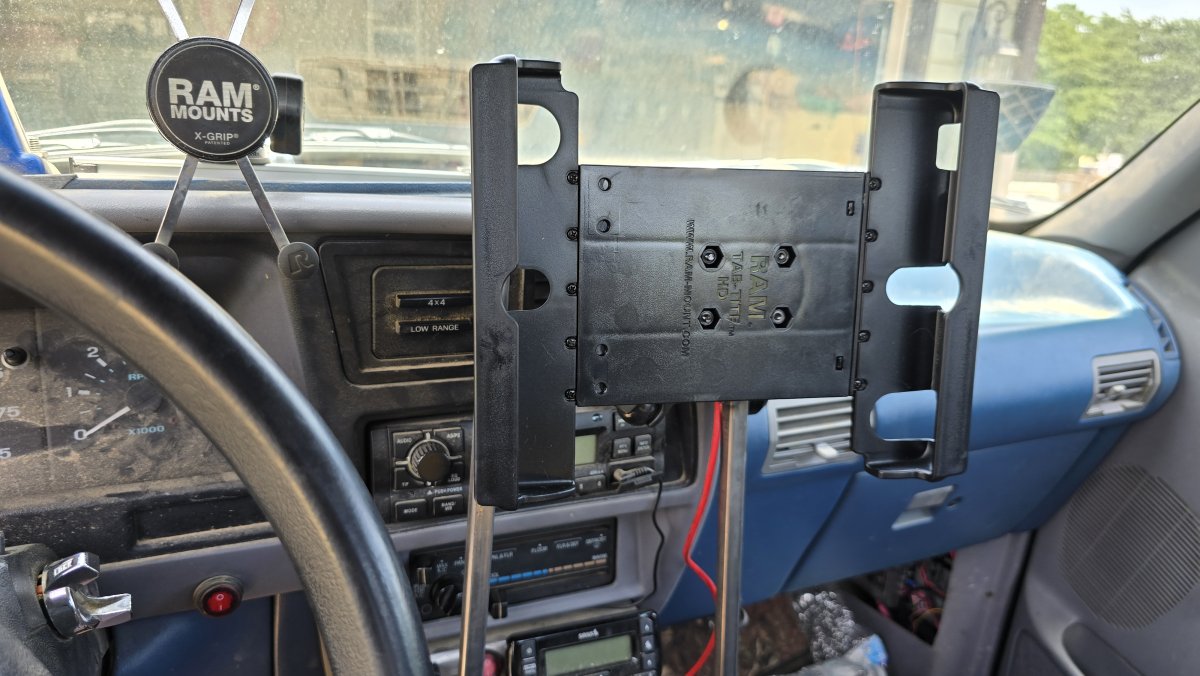

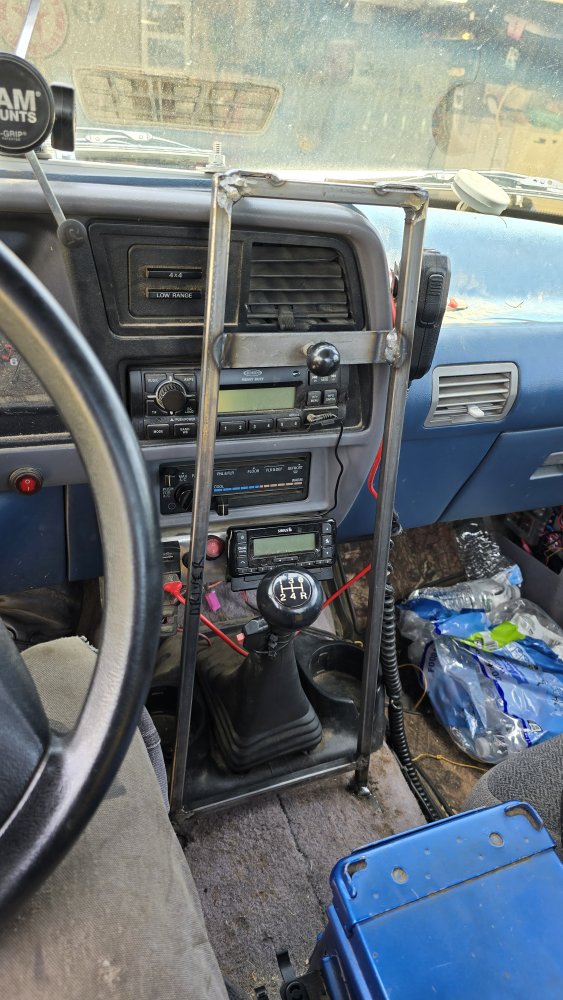

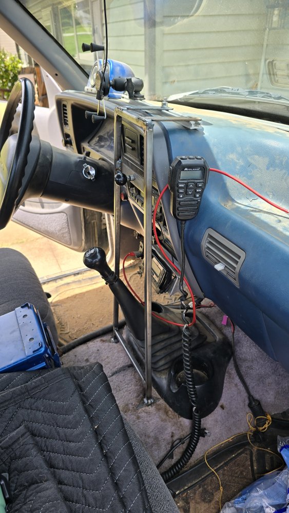

Today, I fabbed up a bracket for my new tablet. Primary purpose is navigation apps. Anyway, trying to make something that is solid and doesn't shake a lot. I think this us going to work. Yes. I have more than enough room to shift gears.

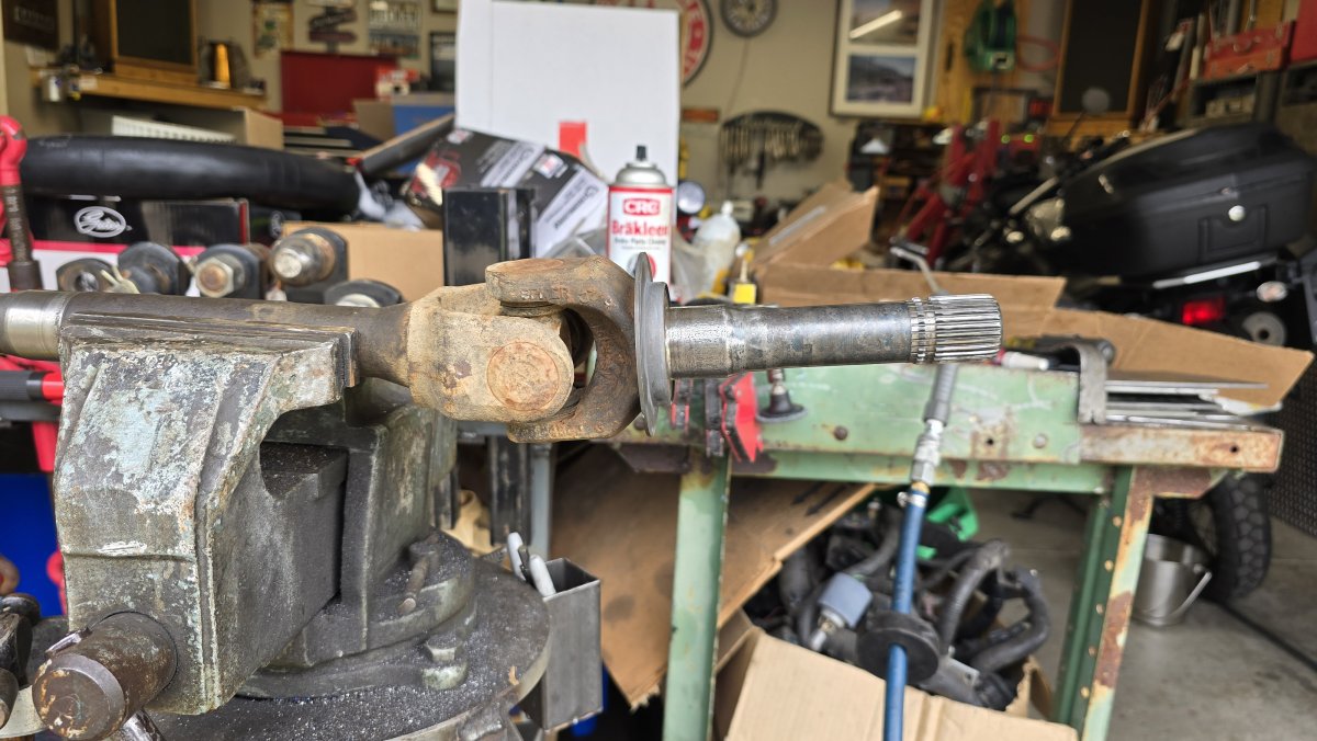

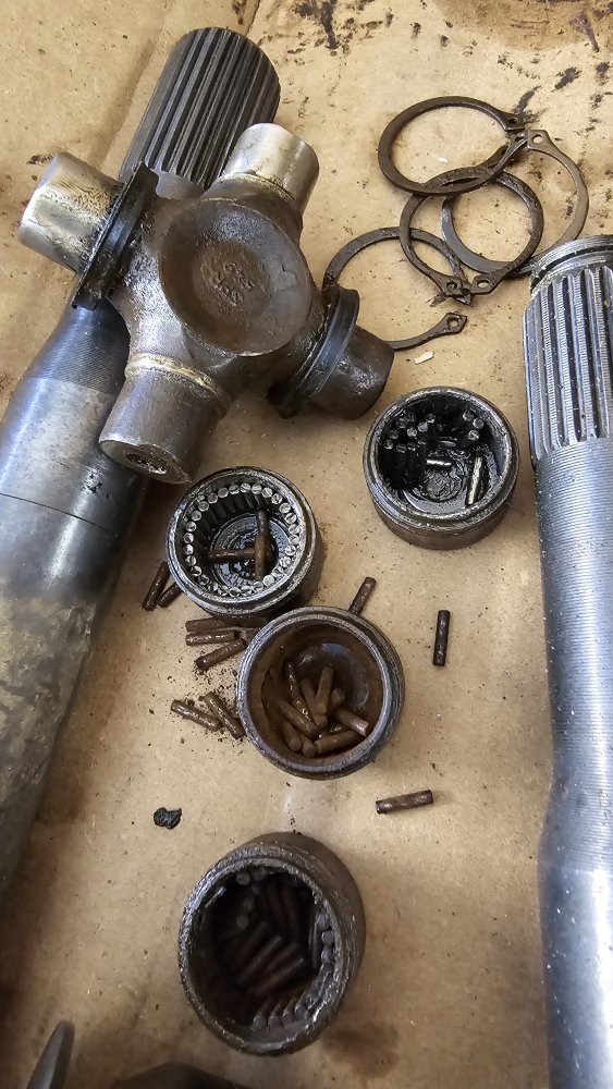

This might be a good time to build up and install my spare axle shafts and keep this set as spares.

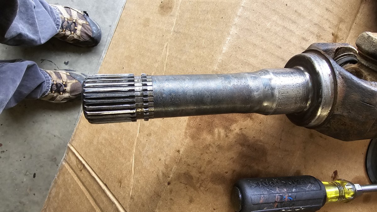

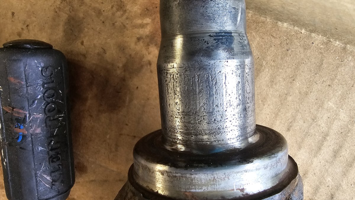

Spindle bearing journal.
Shouldn't this assembly be kinda floppy?
Well, that's depressing. I thought I had a complete spare set if Dana 35 axle shafts that I bought from someone here a few years ago. Apparently, all I bought were the inner shaft pieces. I'm missing the driver side outer, passenger side outer and passenger side piece with the female slip joint and outer yoke. Bummer. I do have a set of new u-joints. So, temporarily, I'll put a new joint in this and install it. The spindle bearing doesn't carry a lot of weight or force, so, with new bearing and grease, it should be OK for my next few trips. The passenger side soindle bearing journal isn't as bad. I need to start watching the junk yard for parts again.
I need to scrounge up more outer shafts too, they are getting hard to find.
I could have sworn there was grease in this thing when I installed it years ago.
