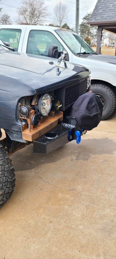

1993 Splash in SC
Murdock would be so proud!
Going to assume A-Team reference? That episode always sticks with me for whatever reason...
That's a spiffy bumper, I need to do some bumper work on my junk, the Ranger's front bumper needs more features, rear bumper needs better brackets, F350 front bumper is a Warn winch bumper but for a Chevy and held on by 3 bolts and the rear bumper is again GM with hobbled brackets and a repop so very cheezy...

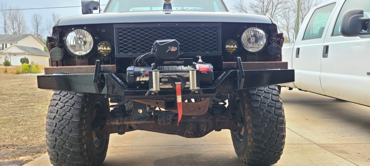

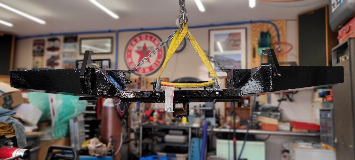

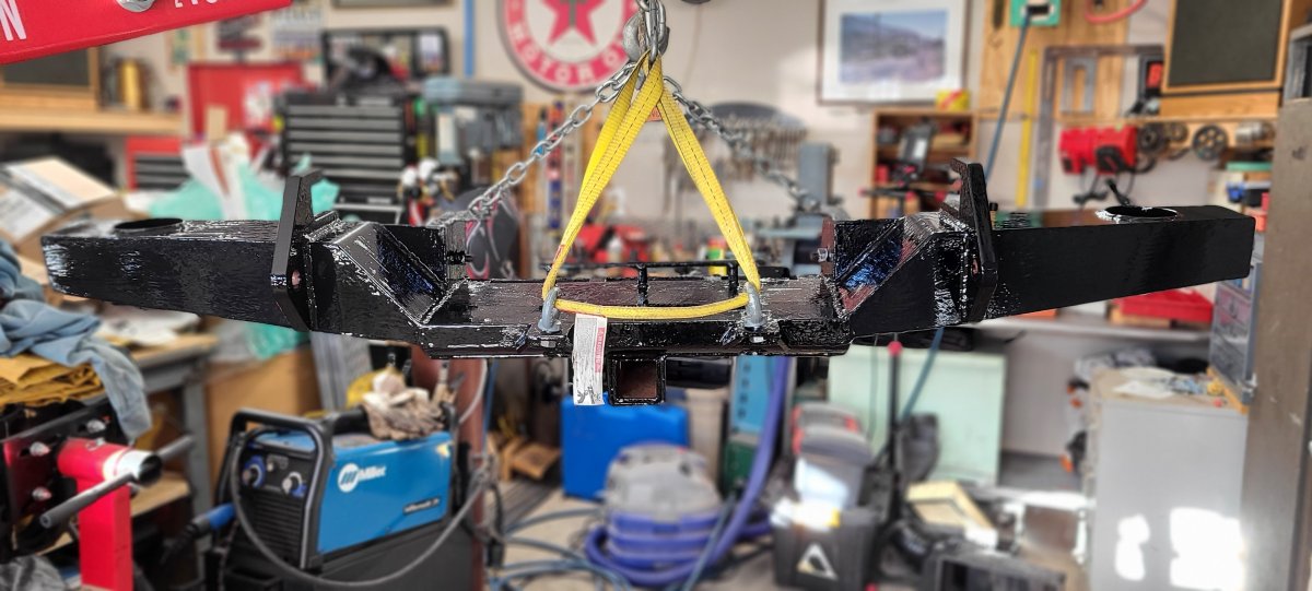

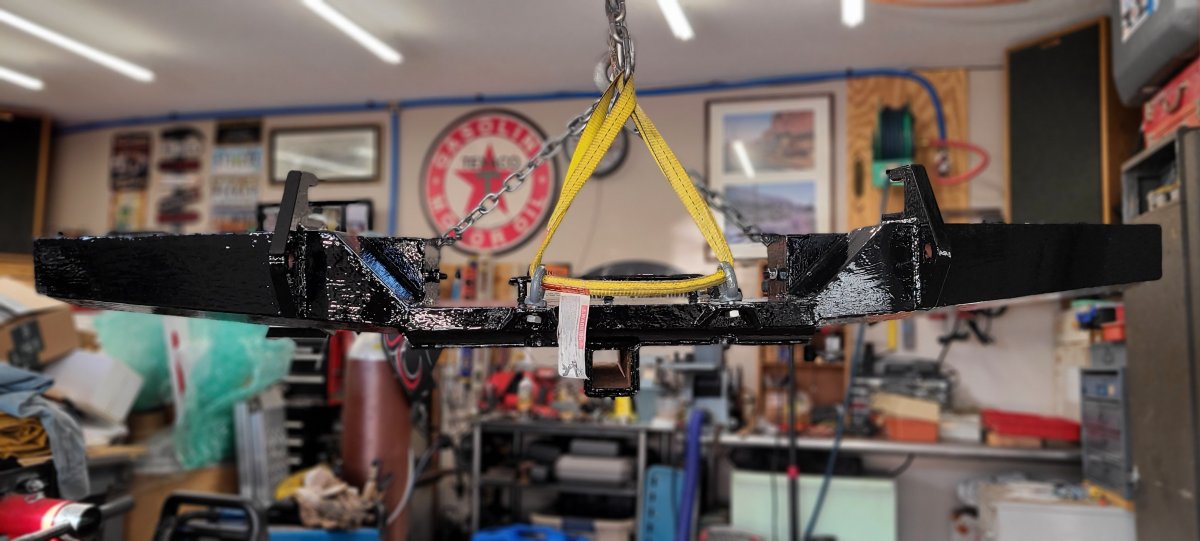

Got the final paint on the bumper.
Can't wait to see it on the truck

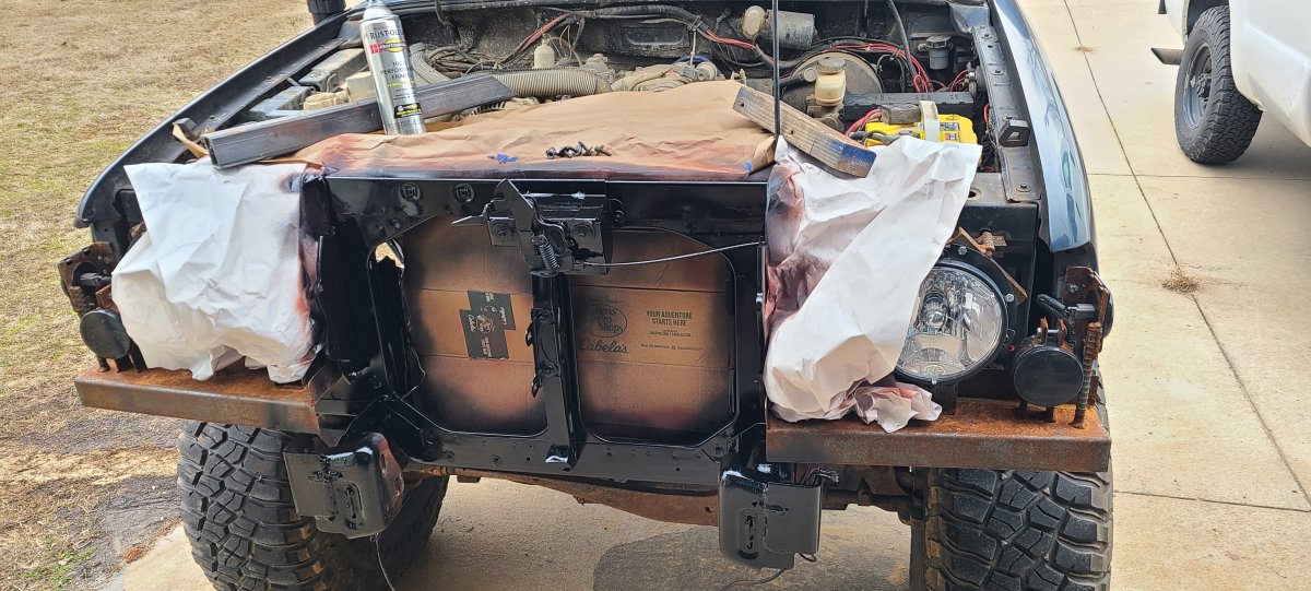

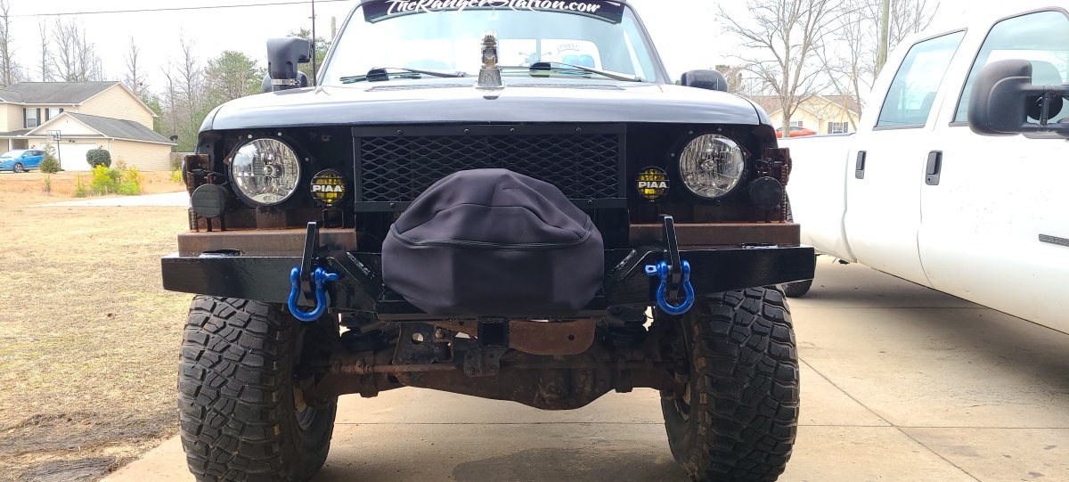

Installed the bumper today. Also sprayed some paint ot the grill, the area behind the grill and a couple shackles. While I was welding on the bumper, I added a bracket to tie the winch cables onto. Now they are out of the way for me to use the winch cover.
Back off! I have Rustoleum and I almost know how to use it.

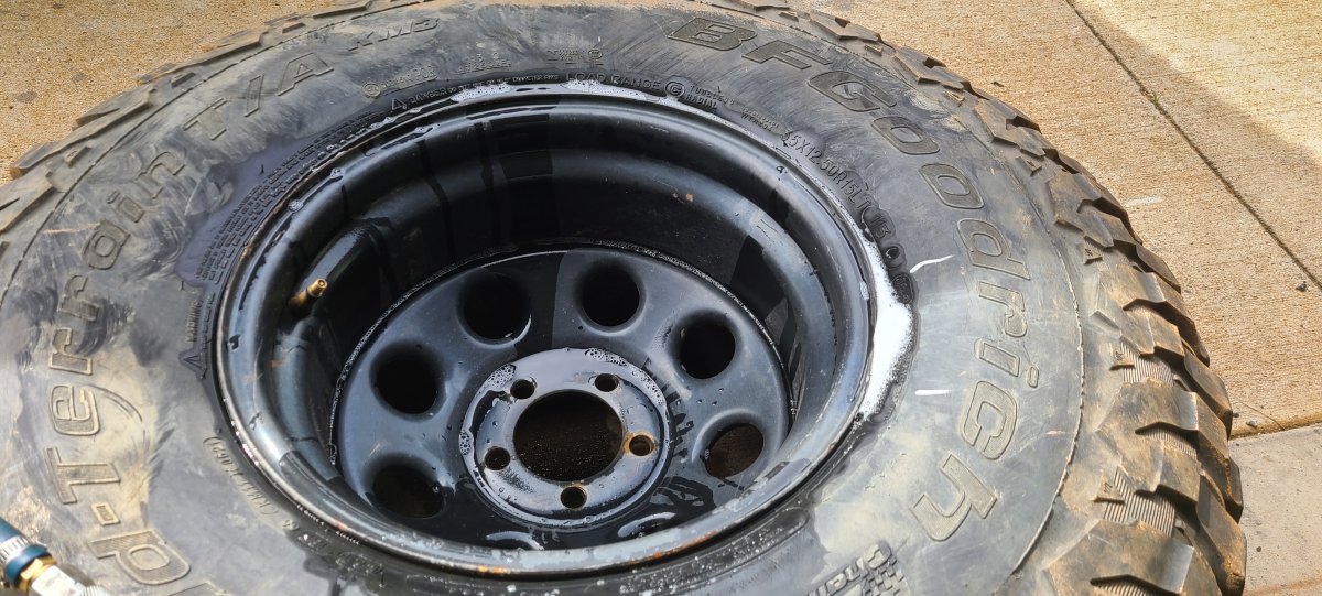

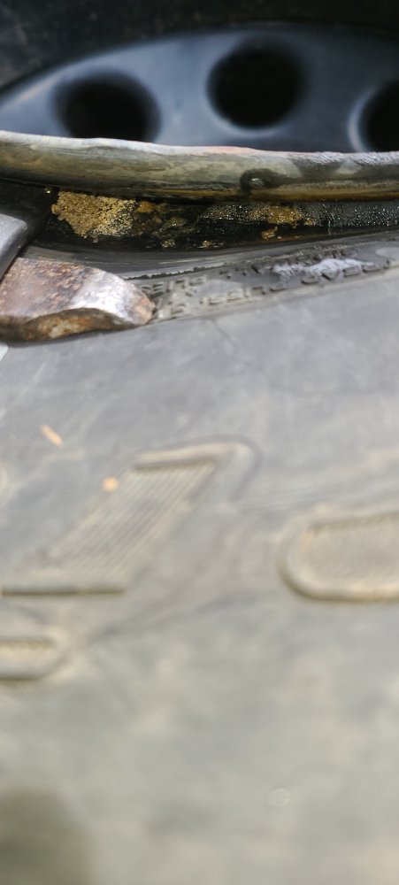

Also worked on the front passenger tire. That's the one I popped off the bead last time I went to the ORV Park. It has been leaking ever since. Popped the outer side off the bead. Cleaned the dirt off the rim and the bead of the tire. Lubed it up and put air back in. Seems to be good.
Hmm. Wonder where the leak is.
Lots dirt and sand in the wrong place. This is looking between the bead and rim where all the bubbles were.

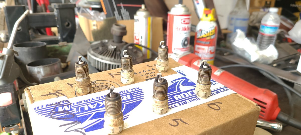

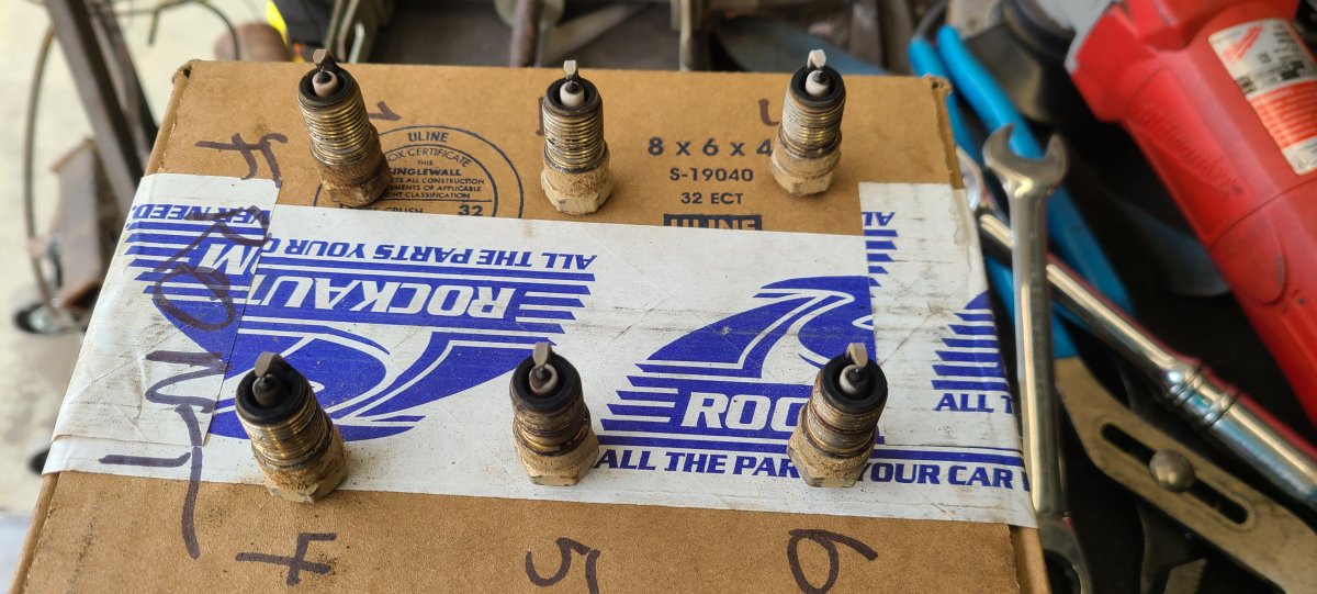

TLC day! Replaced O2 sensors, spark plugs, plug wires, rotor and cap. The old stuff doesn't really have a lot of miles on it. But hasn't been done since way back when I first bought the truck 8 Years ago. Also found a wet spot indicating where my coolant leak is - somewhere on the top, passenger side of water pump area under the t-stat housing. I haven't seen it leak. But coolant is going somewhere and there's a wet spot there.

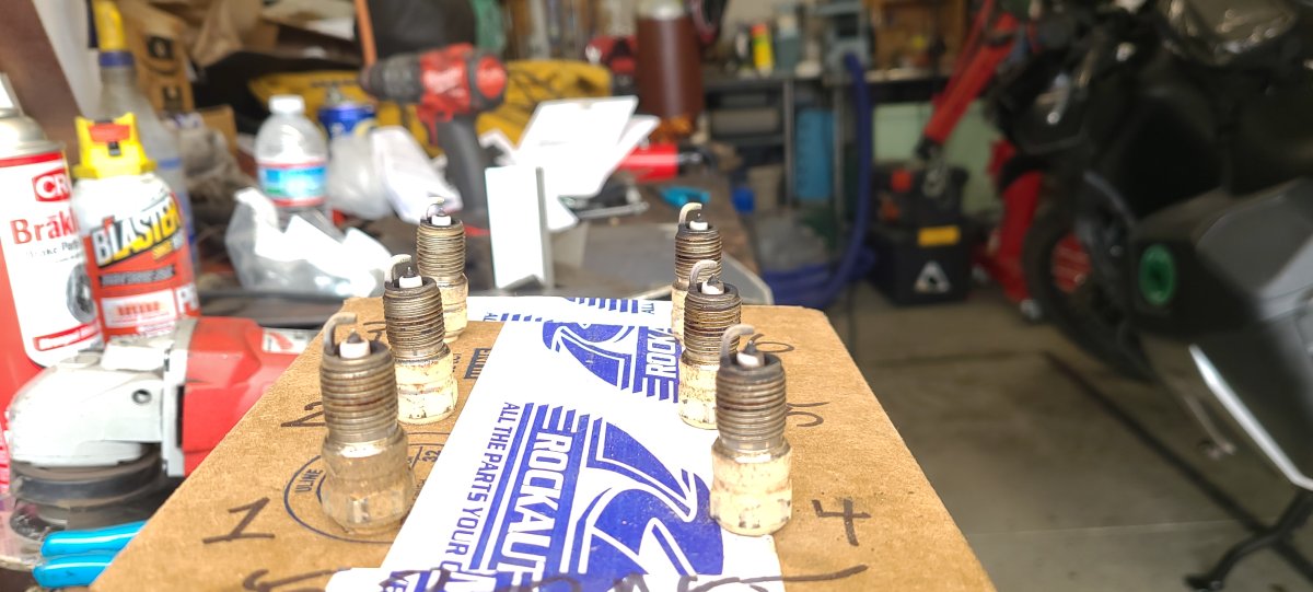

Old plugs. Look decent? I'm open to feedback from those who know better than me. I'm happy to see that they are almost identical looking and not covered in oil or black soot. The gaps have burned open to 0.052" - 0.054". Very consistent. Should be closer to 0.044".

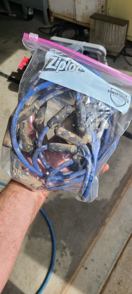

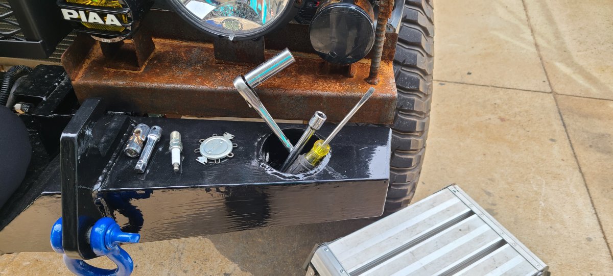

These (plug wires, cap and rotor) go in the toolbox for trailside emergencies. Maybe I should gap the old plugs and put them in the bag, also.
Can't beat how handy a good bumper is.

Yep; aren't you getting on up to the age for that, too? ;missingteeth;
On another serious note, cleaning the "gently used" plugs and packing them with the backup wires would be a good idea. There's been several times having serviceable used spare parts has saved me a call to a friend or a needing a tow.
