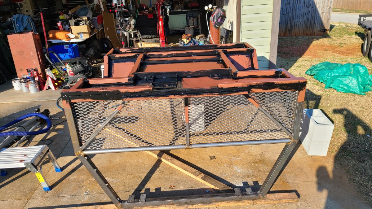

Ok. I got primer on the upside-down parts and splashed some top coat in the areas that require brushing. I'm ready to quit for the day. So not going to fill the roller pan with black today. Bumper got primer and first topcoat.

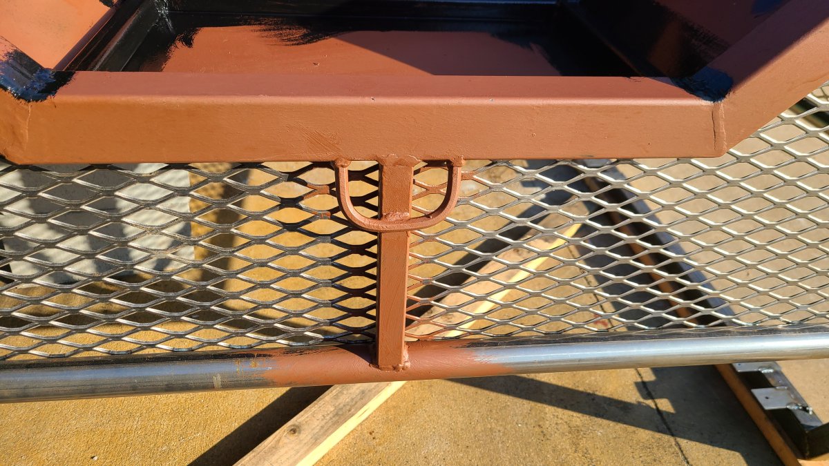

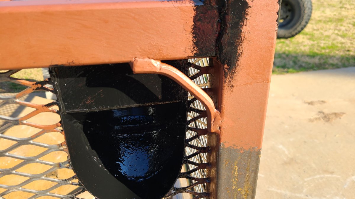

Front and rear side tie-down points look like this.
Middle tie-down points

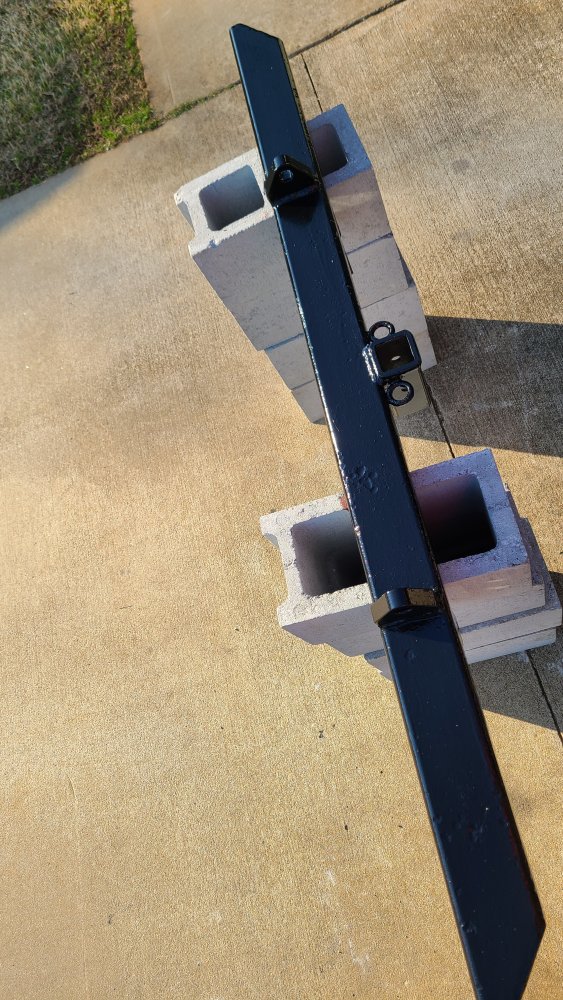

Bumper is finally black
Bottom side primed.
Getting so close!
I just looked back. I bought the steel on Jan. 6 and finished the last weld today, March 3. Just under 2 months to build a custom truck bed AND a rear bumper. Not bad for shade tree working.

I really like how you did your tie downs.
I have been planning on adding some to my headache rack, but didn’t want them to stick out too far and be in the way. So I may end up liberating your design.
