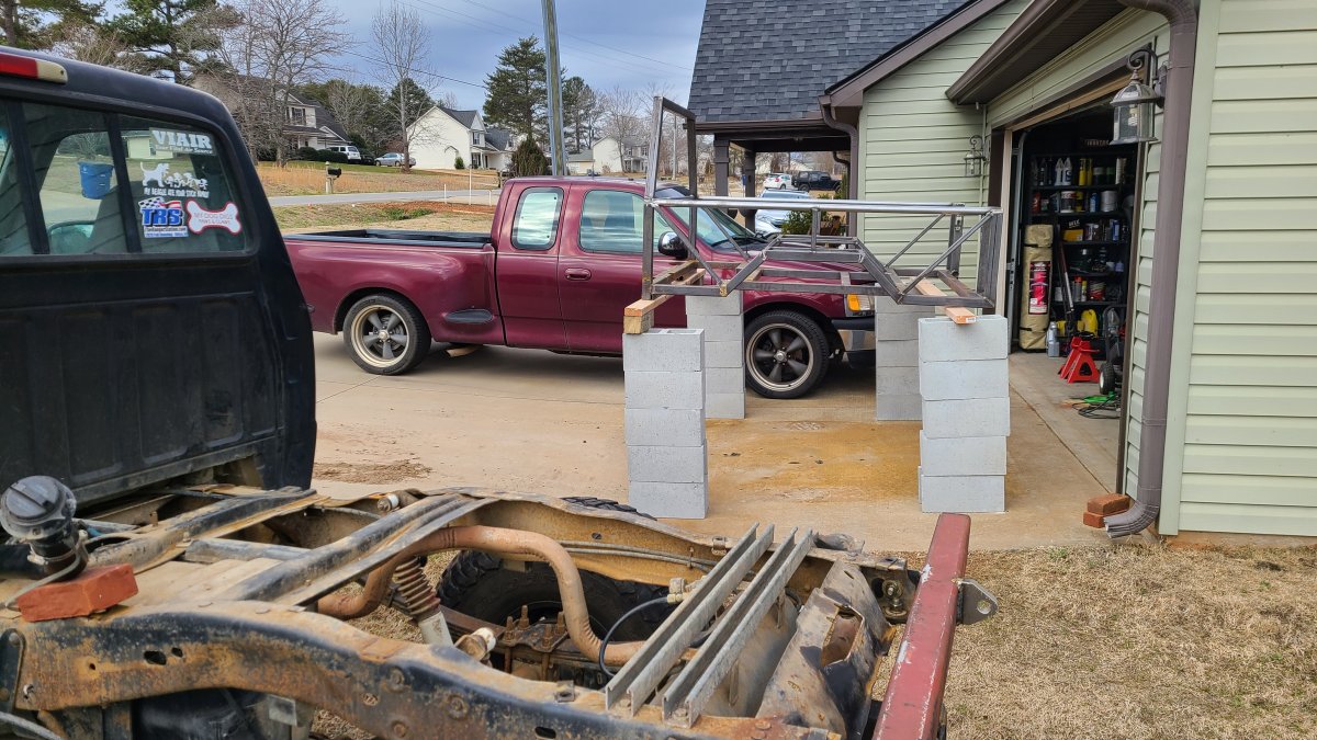

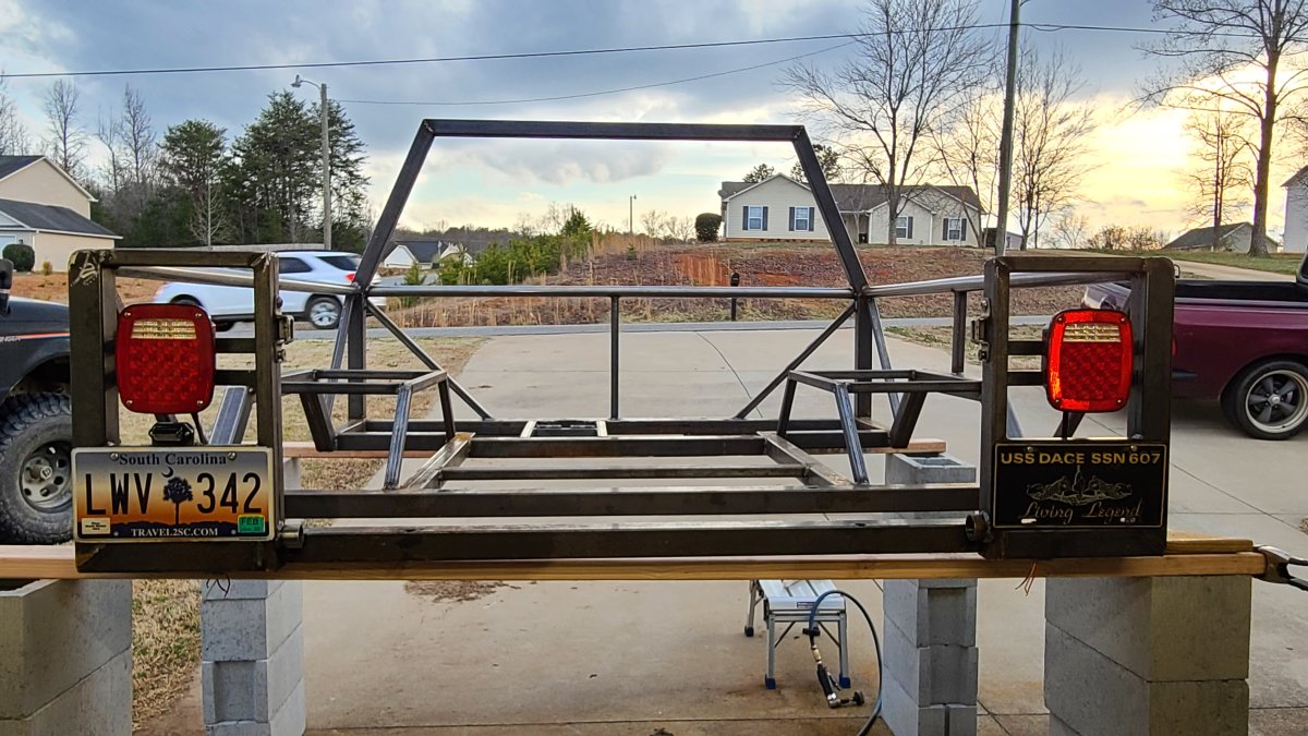

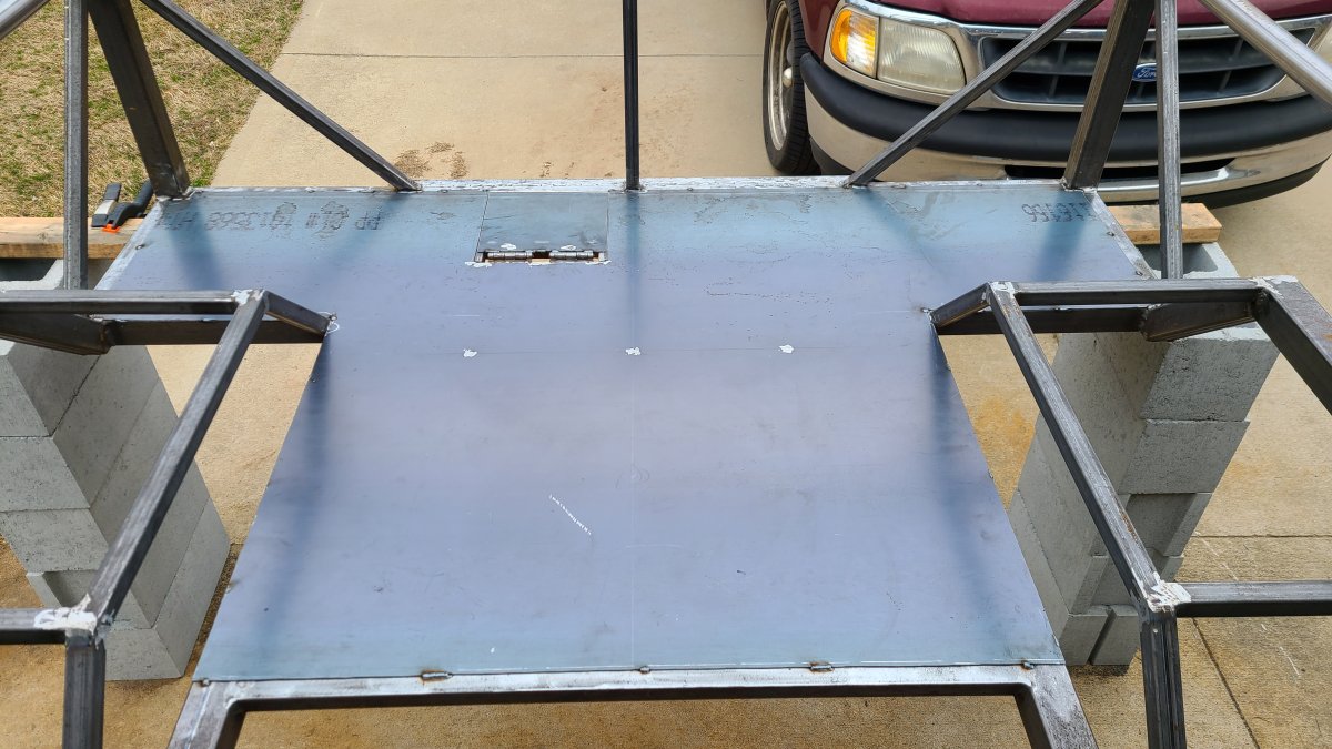

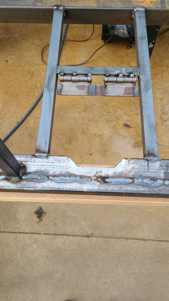

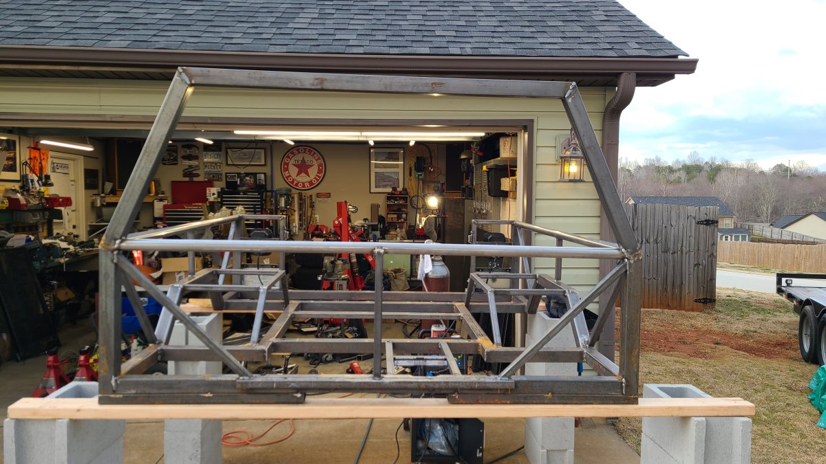

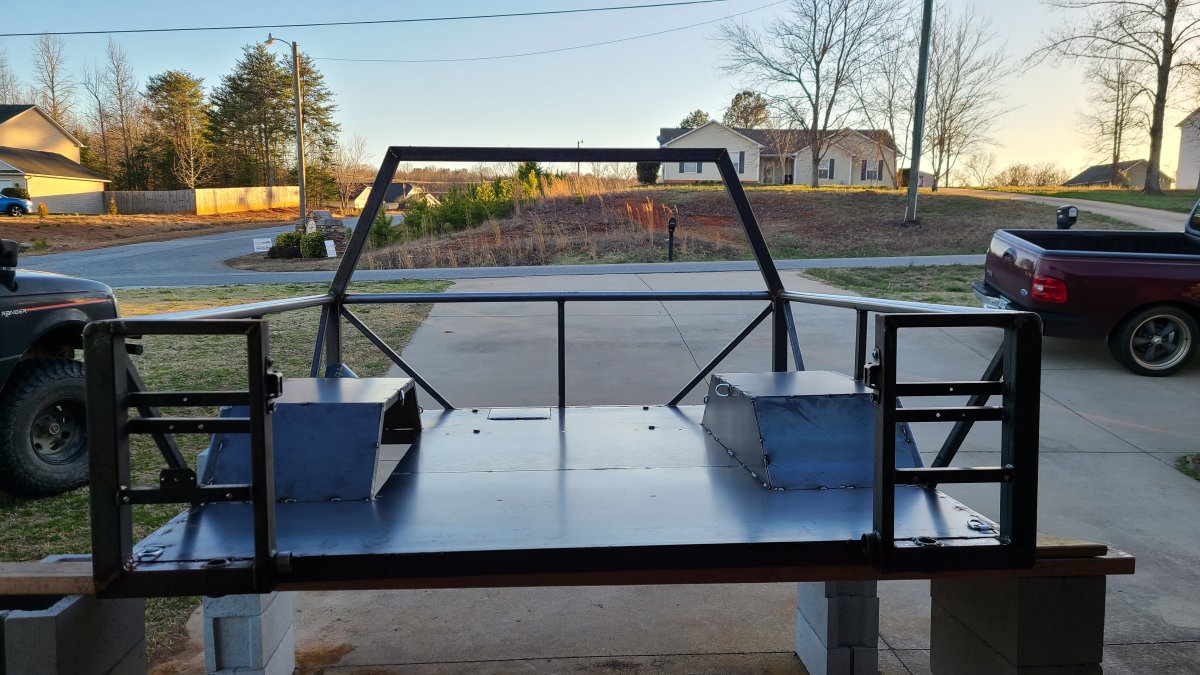

Sorry, guys. I had another beautiful day to work outside. Got the truck out from under the bed. This gives me a lot more freedom to move around and weld stuff. Finished the cross bracing for the front end. Framed in for the fuel pump access hatch and got the hinges in place for that. Got my supports in place for license plate and tail lights. And cleaned up some topside welds. I need to get another roll of MIG wire ordered quick.

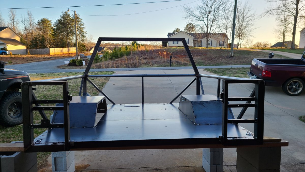

Half day at work today. Stopped for MIG wire on the way home. Then still had a couple hours to work on it. Not bad progress for 2 or 2 1/2 hrs. It looks a lot better with skin on. Not sure if the weather will cooperate tomorrow while I'm off.

Did you do any math to see how much the flatbed will weigh vs. the original bed?
Can't wait to see it done.
No. I didn't calculate the weight. When I lifted it off the truck, I guessed that it felt similar in weight to the old bed. I did weigh my new bumper. It is 4 lbs heavier than the one I removed.
We always kept our buggies as light as possible. While you don't want to go overboard on weight... some extra on the rear of a Ranger is probably a good thing.
I think it's going to be alright. I'm afraid I might need a few more pounds on the front of the truck when I get my new springs on.
Are you going to put the skin on the inside or outside?

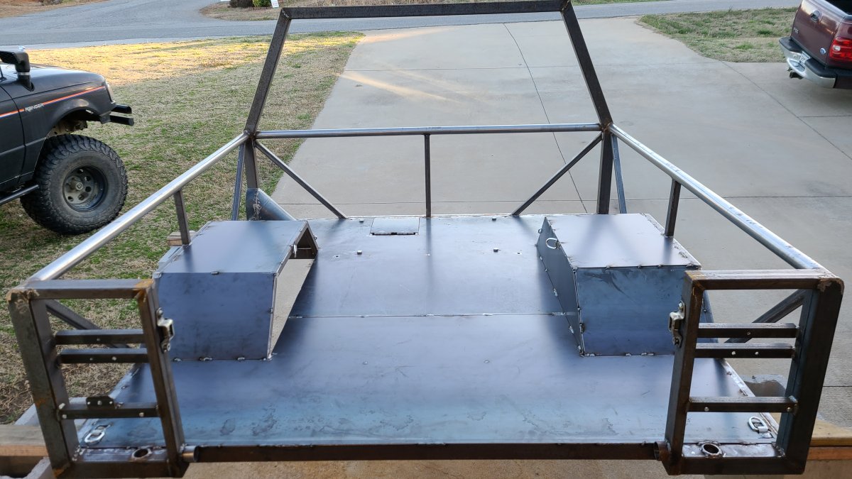

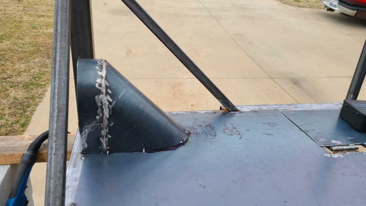

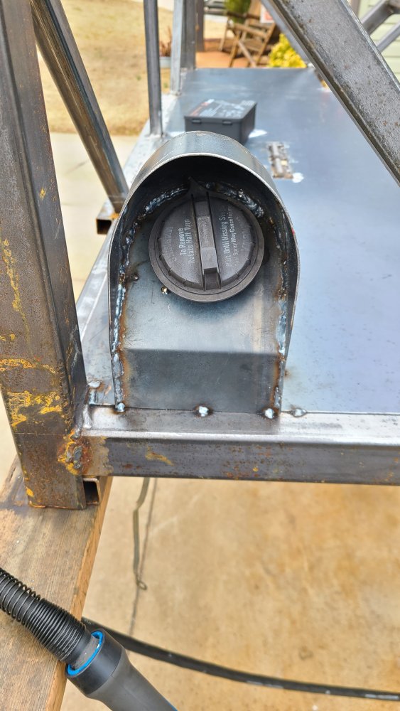

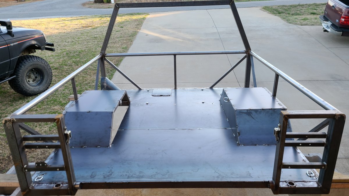

Well, I finished the fuel filler hose tunnel today. It took nearly the whole afternoon to get it this good. And this is not how I originally envisioned it. Next time, all flat geometric shapes. No more #%&>=$%÷*& round stuff! That was very difficult for the tools I have available.

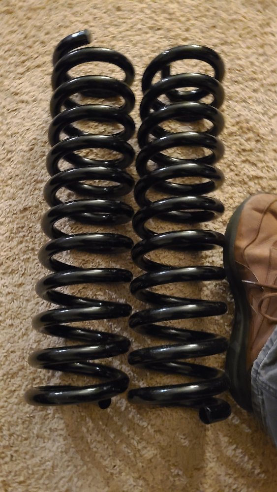

Livvy got some new springs for the front of her Ranger today. Skyjacker 176. These are for older F150s with 6" lift.

Pretty good progress for a day that started out foggy and rainy.

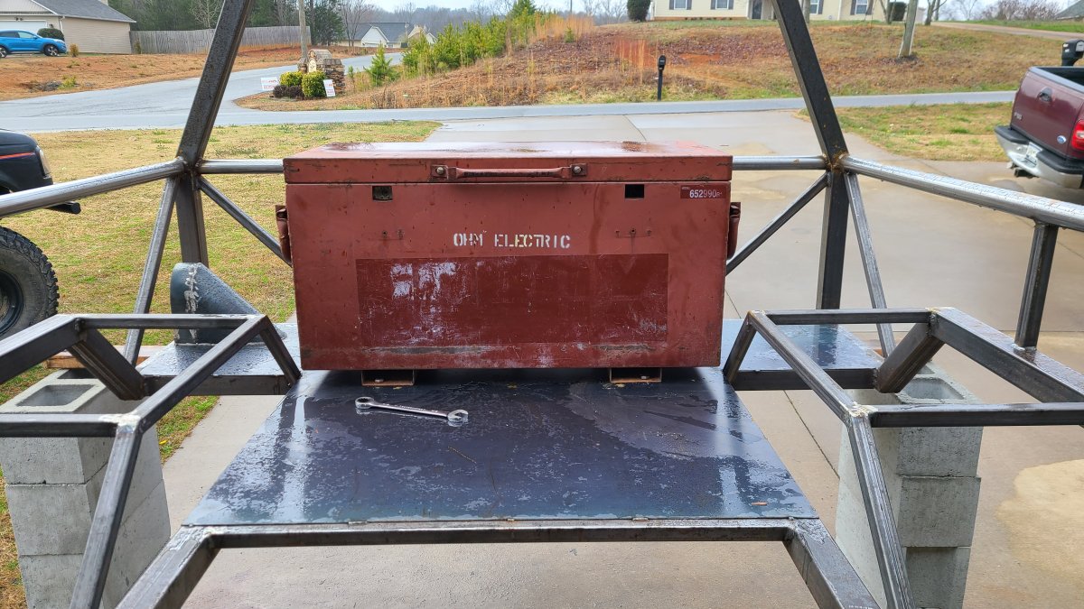

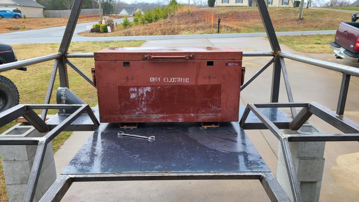

Laid out the position of my toolbox. Then drilled mounting holes and welded reinforcements and nuts on the bottom side.

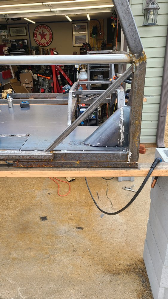

Started fitting the skin on it. Also welded in some tie-down rings.
I have really bad knees, so I would have mounted a box like that on top of the passenger tire kick. Access over the side...
And it would offset the lean from my overweight ass....
