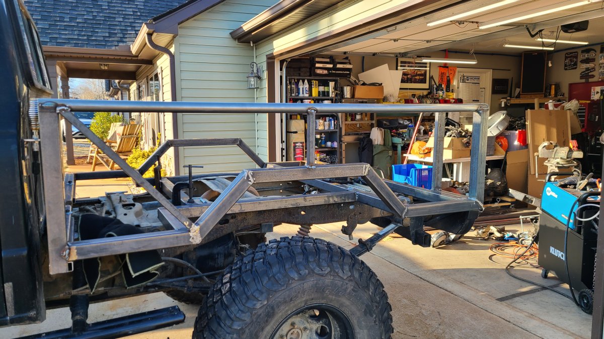

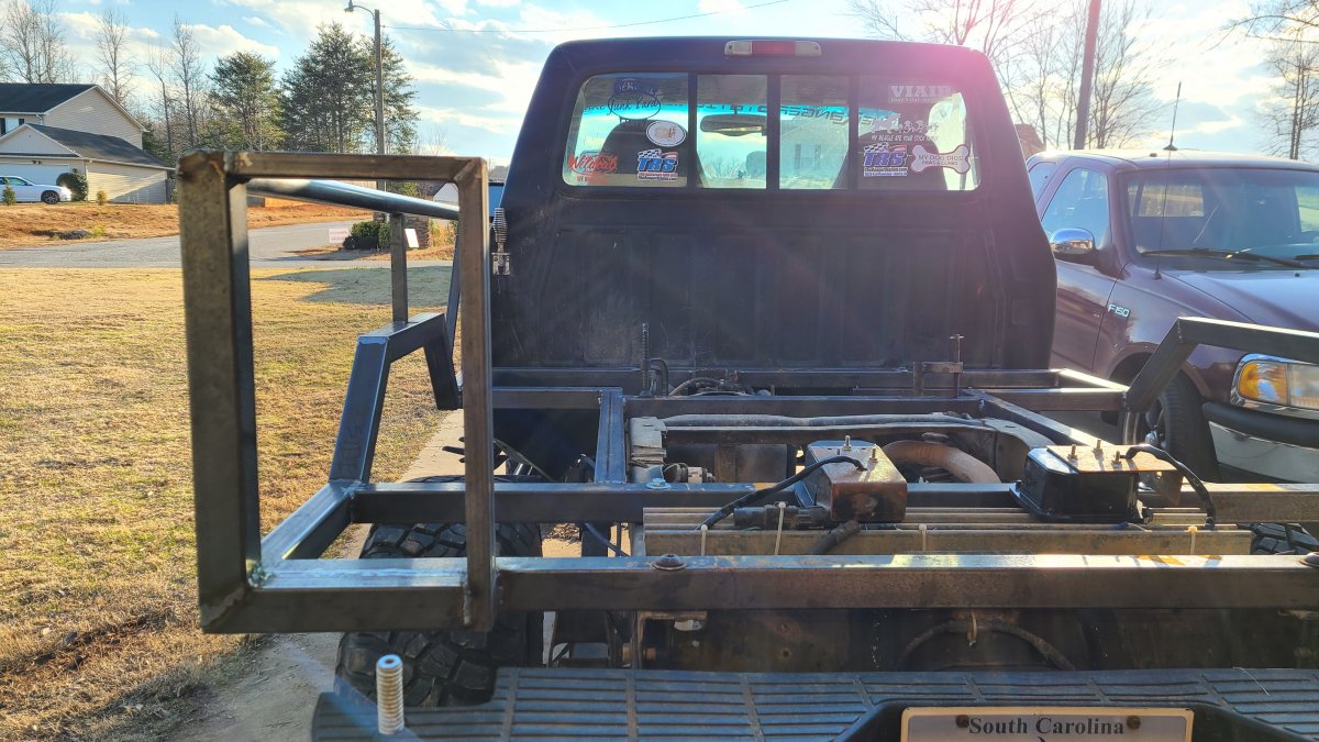

Nice, warm day. Progress made. Error made, too. But nothing serious.

I may never tell. Depends how obvious it is at the end. Actually, there will be a few minor imperfections. Some based on the fact that the truck frame is out of square and has a slight vertical twist. Difficult to get everything perfect under those conditions.
Thank you. How much is the height of your wheel arch above the flat deck level?
Forgot to answer you, sorry, it's around 6" from the bottom of the outer frame to the inside of the wheel arch. I'm guesstimating that I have at least 12", maybe more between the top of the tire and the inside of the arch at ride height.

How tall are your bed sides going to be? The one looks really tall in the picture, but it may just be an optical illusion.
18". A little taller than I originally wanted. But I want to use the talgate/ table that I had already built for the original bed. So, they're really no taller than original. It just looks taller because the whole shape is different.

How you going to skin it? tread plate?
Simple flat 14ga or 16ga in the bed and possibly expanded metal on the sides. I need 3 sheets of material either way.
