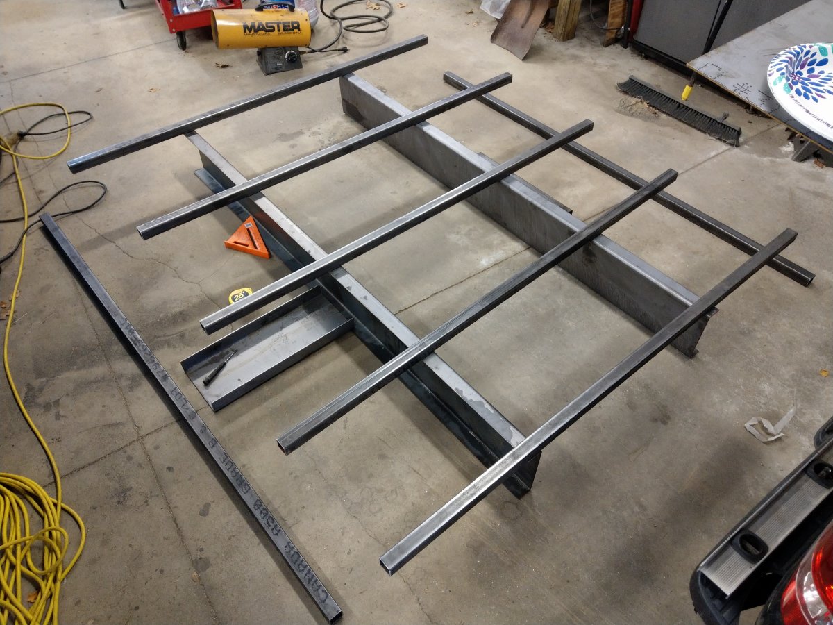

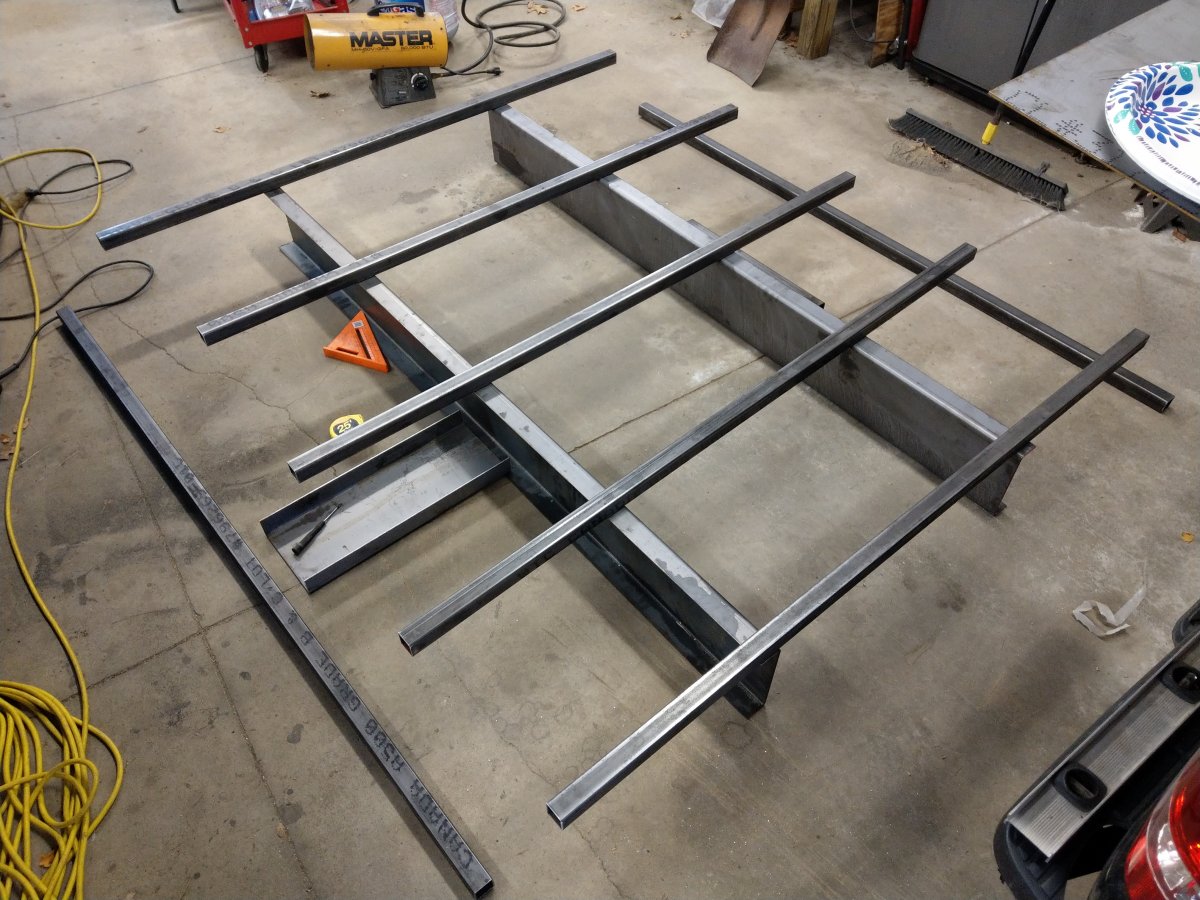

When I built the flatbed for my old truck, I had the actual bed bit sit upon 8" c-channel I ran perpendicular with the frame rails. Quick measurements put that figure as being enough rise to not have rubbing at full tilt..... I was wrong. 9" probably would of been the number needed. This was stock suspension with 30s.
