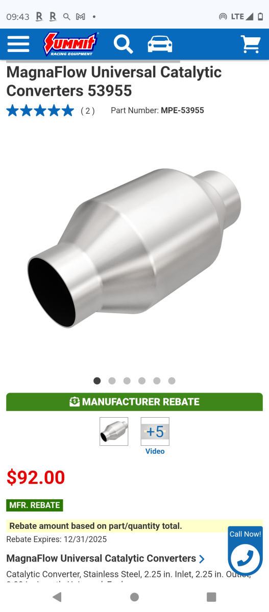

I'm a firm believer in not breaking the law. If your cats are not working or if you are after better flow, replace them with these by Dynomax or Magnaflow. The 200 series universal version works great and are easy to acquire from Amazon, eBay, Summit Racing for about $100 each.
NOTE: currently with Rebate!!
