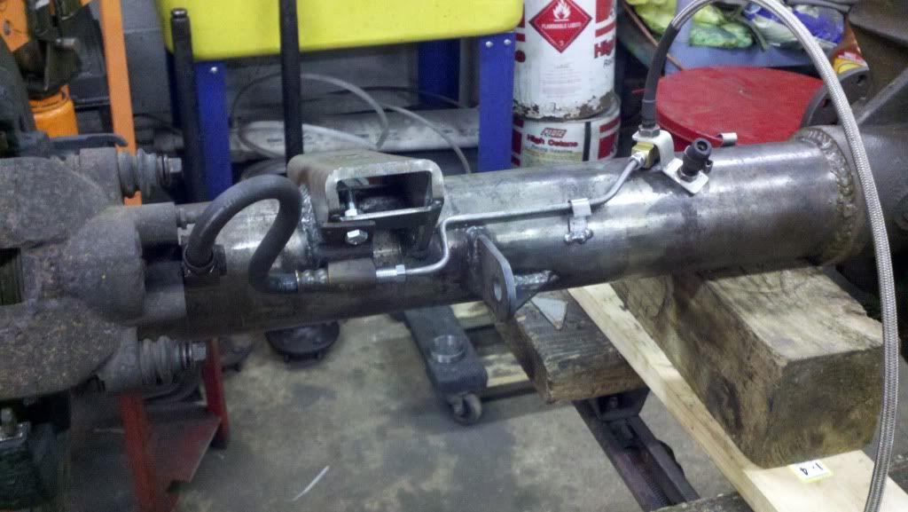

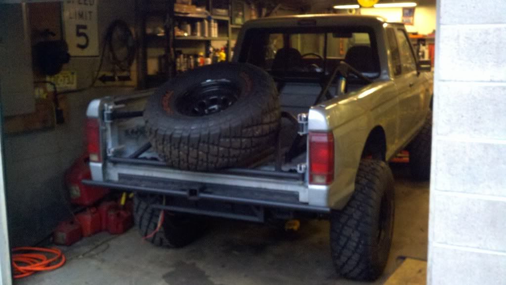

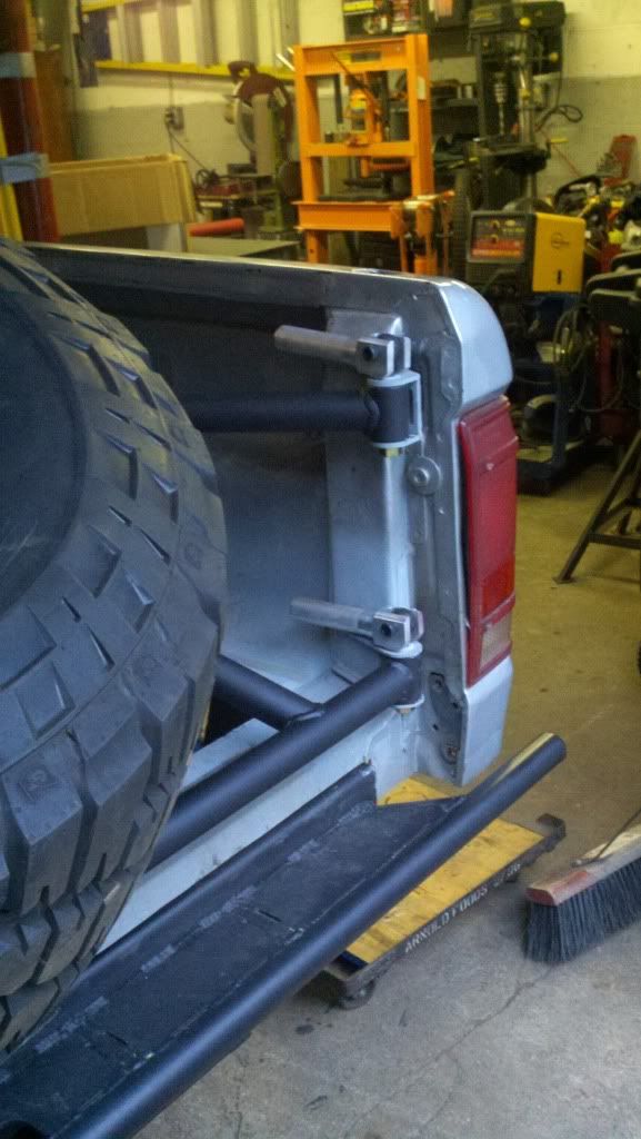

You should gusset that hitch up a little bit with some plate. Piece top and bottom will do. Keep it from bending from lateral forces (non-straight pulls).
The hitch goes through that whole 2x4x.120 tube and is welded on both sides... if that makes a difference from that your seeing....
Sent from my DROIDX using Tapatalk 2
It should do, now that I look at the bottom of the picture showing how it's 2x4. Threw me off that you didn't center the receiver in the tube.
I'd still throw something on it just being me.
Where do you live in Jersey?
I may throw some more on there when I do the rear skid plate...

Did you ever think of adding some lift lugs?
You mean tow points? Im guna add some to the front off the frame and im guna build a special receiver for the rear that gas a D ring on it for towing people of getting pulled out...

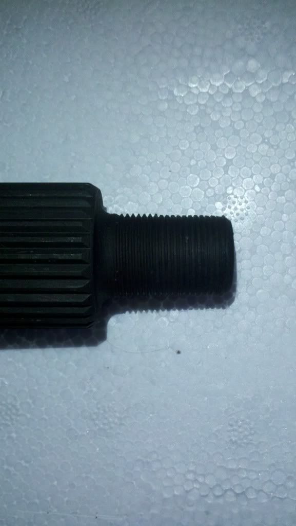

Got my nitro ring and pinions today and the 8.8 pinion threads are FUBAR IMO... im not to happy and now im worried about the quality of this NITRO stuff...
