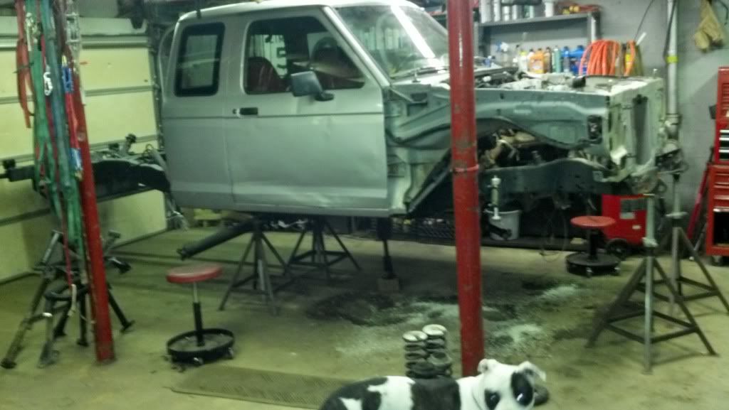

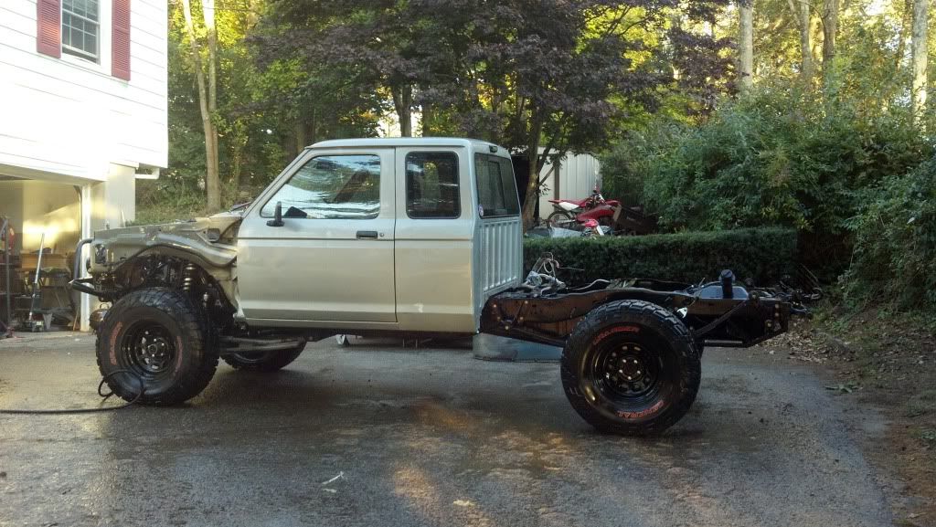

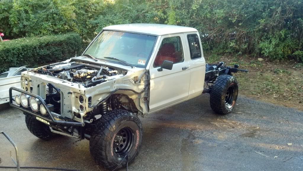

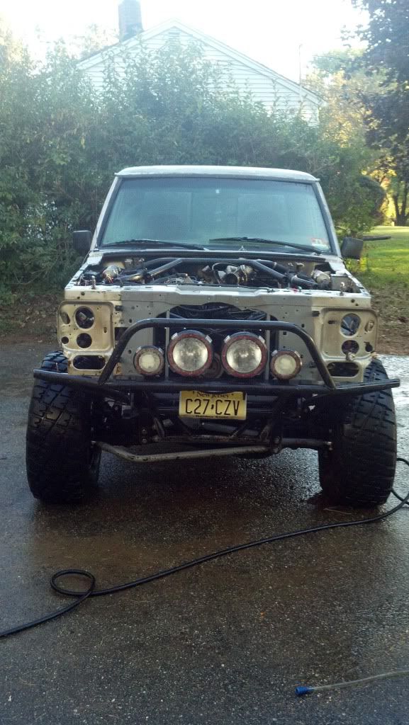

Getting her torn down to move parts to the BII bomber...

Some more progress on the tear down. Hopefully i can start bolting some of this stuff into the Bronco II this week. I ordered some 12" coilovers for the front of the b2 so hopefully i can get them to fit in it with simple shock hoops keeping a good motion ratio and not have interference problems with the brake system or tires at bump.
The 14" coilovers that came off the front of my ranger are going in the back of the b2 with softer coils. The 8.8 out of my ranger is going in it with a simple l/\l style 4 link to keep it strong and simple....
