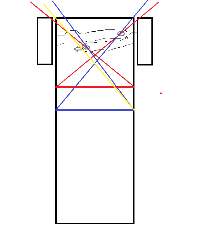

You want the lower end of your swingers (where your tierod will mount) on the red axis lines if you're looking for the least amount of bumpsteer.
OK I understand what your saying but think about this. After some hard thinking and testing I realized that as a TTB supention cycles downword (droops) it creats a toe inward to the truck if there was 0* "bumpsteer" built in. I say this lightly becasue when I say bumpsteer im defining no movement from spindle to axle beam.
Picture this. Turn your wheels completly strait with a good alignment and weld your spindle to the beams, so both wheels are strait and they completly follow the path of the beam and radius arm arcs...
As the suspention droops out the beam pivot causes a camber, which in turn pulls the tires closer togerther on the bottom where they have contact to the ground. They have to becasue they are following the beam pivot point. But becasue your radius arms are also a pivot point the rear half of your tire does not toe in the same amount as the front does. This is because as the suspention droops out the rear of your radius arm (where it mounts to the truck) stays to the outside of the vehicle while at the same time the front (where radius arm connect to beam) does not.
The opposite happends on compression...
I was thinking that by placing my swingers in front of the beam pivots paralell to the truck i would correct this toe in and out caused by the flex.
I was correct about fixing the toe out on compression becase as the suspention cycles up the shorter tire rod length following a different angle curve would result in the tires toeing back into normal track paralell with the frame.
But on droop this would have multiplied my toe inward. Not good.
So Junkie, and anybody else if your following me lol, I understand why now you say you need to mount the swingers on the "red line". But by doing this you still have the natural TTB bumpsteer problem. I figured out a way to get rid of it... To do this you must not mount them on the red line, but just below the red line...
Picture a line from your beam pivot to your radius arm pivot, your looking at this line parrallell to your vision from the front corner of the truck, you want the tire rod pivot to be slightly below the line. This way as the TTB droops out the tires toe back out becasue of the pivot being slightly below "red line" and when it compresses it will toe in. Same kind of action that taked splace with your pinion angle on an unequal 4 link rear.
With all that said I realized something else. By putting extended radius arms on a TTB without extending the Pass side beam and moving the mount accordingly we are messing up the equalized camber/caster curve the TTB has with stock length radius arms. Im not sure how bad it is but look at this picture below, the red lines represent stock radius arms and the blue represent extended ones on stock beams, notice that the curves are no longer equal on both sides with the blue pivot points? The yellow line represents where the passender pivot should be in order to fix this unever arc.
I have thought about it alot and Im thinking about just getting the 4" drop pitman arm Skyjacker Part # FA600 instead of building a swinger setup....
Is this the way to go?
I want to put off building swingers untill "stage 2", when I extend my beams, do a C&T and move my pass side beam piviot to the drivers side of the truck as much as I can to make up for the extended radius arms...

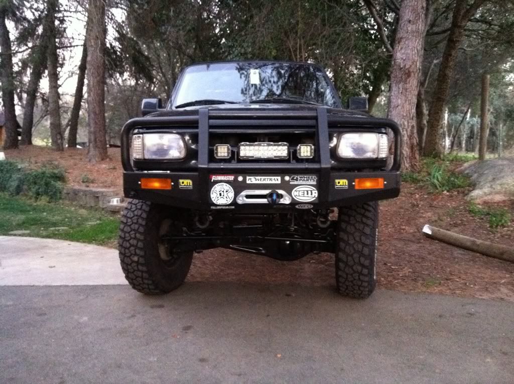

K-link setup on mine:
1991 Ranger Long Travel Woods / Prerunner Build1991 Ranger Long Travel Woods / Prerunner Build
If you look real close, you might still be able to tell a small bit of toe-in on the drooped tire, but because the steering centerlink is where it actually belongs (on the same plane as the beam pivots) it's probably not even 5% of what that f-ed up Explorer has.
Going from stock steering to the K-link was a very noticeable improvement. The truck tracks straight going up an off-camber hill climb (the type with the divots created by people spinning their tires with open diffs) whereas before it would dart side to side because each side of the linkage could not operate independently because of the way it's linked in the middle.

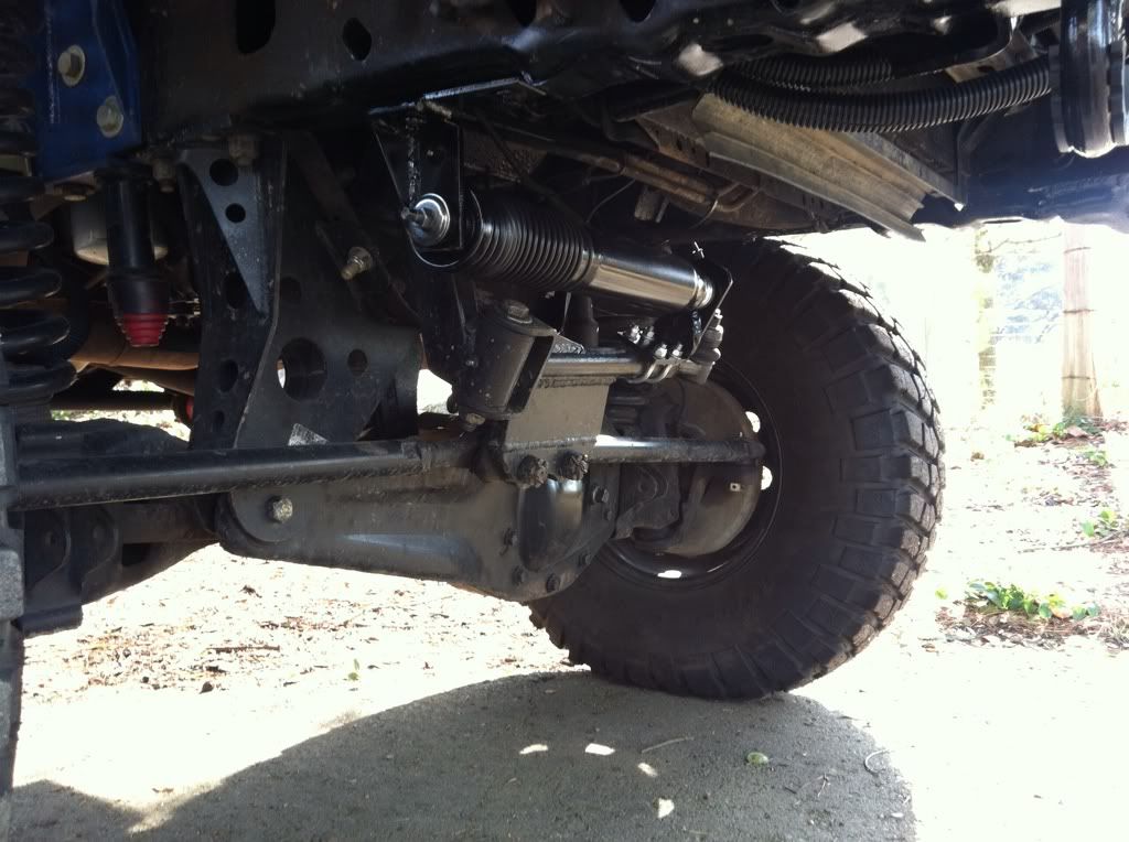

My Klink works great commuting and is light years better than my stock y-link setup was and offroad it works great too, though there is always room for improvement.

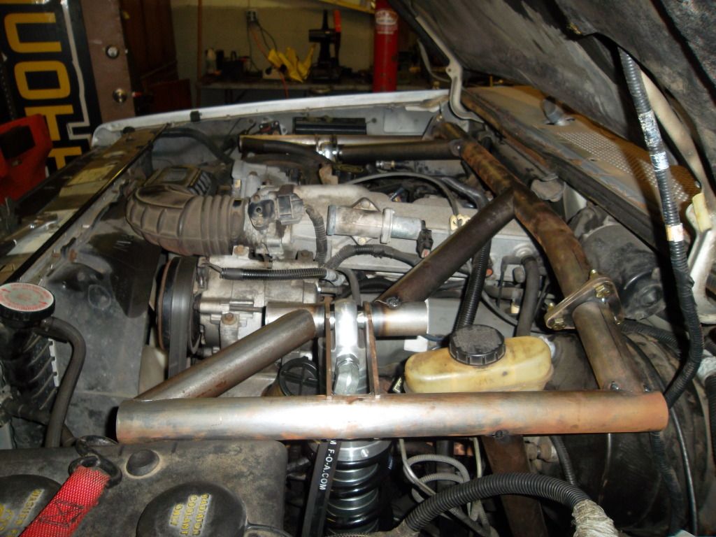

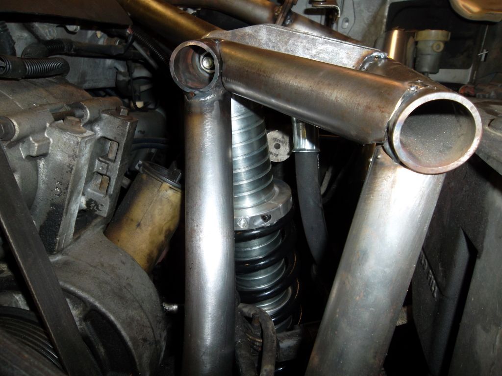

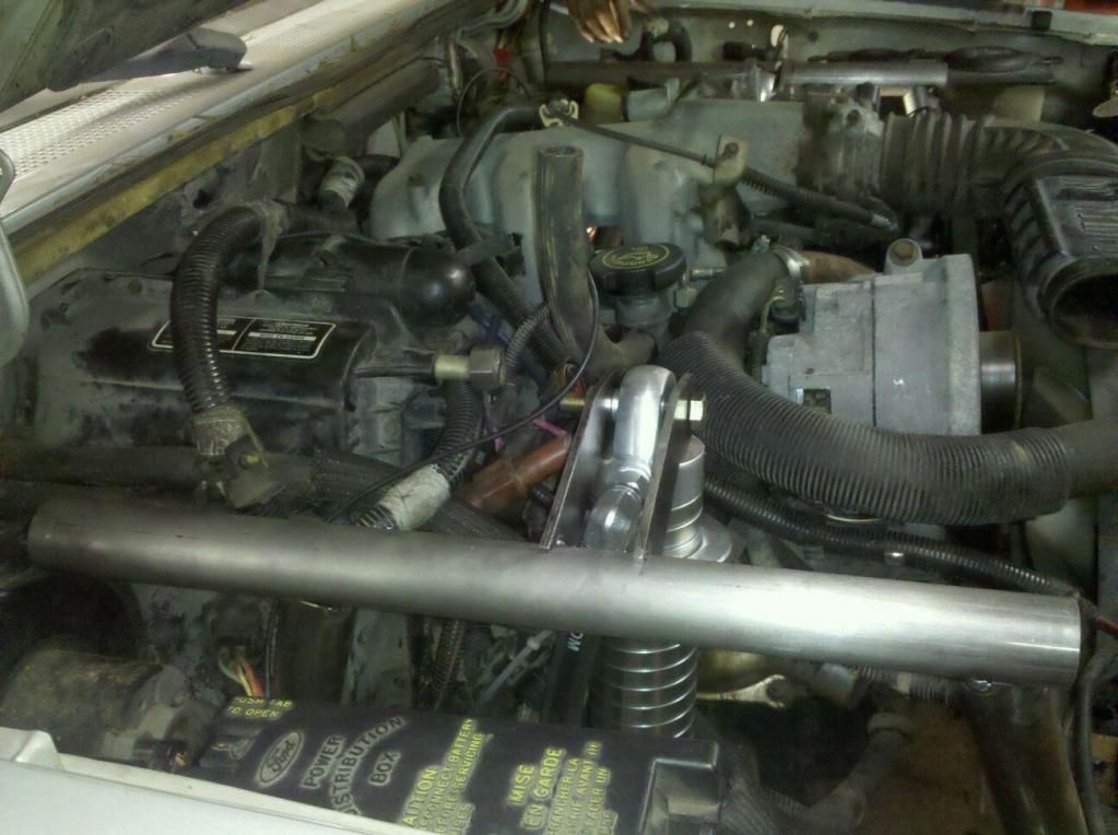

I have gotten some close up pics from Lego a while back for a K link I am building for my truck. Because of the winter months I put it on hold but will be getting restarted on the project now that spring is in the air. I am doing my setup with heim joints and double sheer mounting. It is being built out of 1.5" DOM .25 wall. I have already drilled a pitmanarm and have the basic layou tset up. I need to get my plat epieces from a cousin that is fabing those so I can do final measurements before i do any welding.
I think for a TTB suspension the best and most cost effective solution for steering once it is lifted is the K-Link design because it allows the stering for each side move with the wheel semi independant from the other side.At least on paper that is how it appears it would work. If I was better using my CAD software I am sure I could get it to animate it for me and show me what each part is doing at a given time. Alibre is pretty decent CAD software but for someone with no real training it gets very confussing quick...

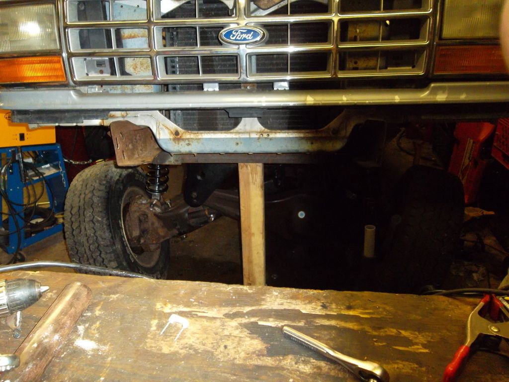

nice truck and nice build but i would really recommend getting rid of those drop brakets and building your self some extended beams
Thats next (stage) possibly D44 or modifies D35...
Im going to run it with these for now... I dont see any reason why not.. Its a woods truck that will be driven fast lol
noticed you notched the frame
