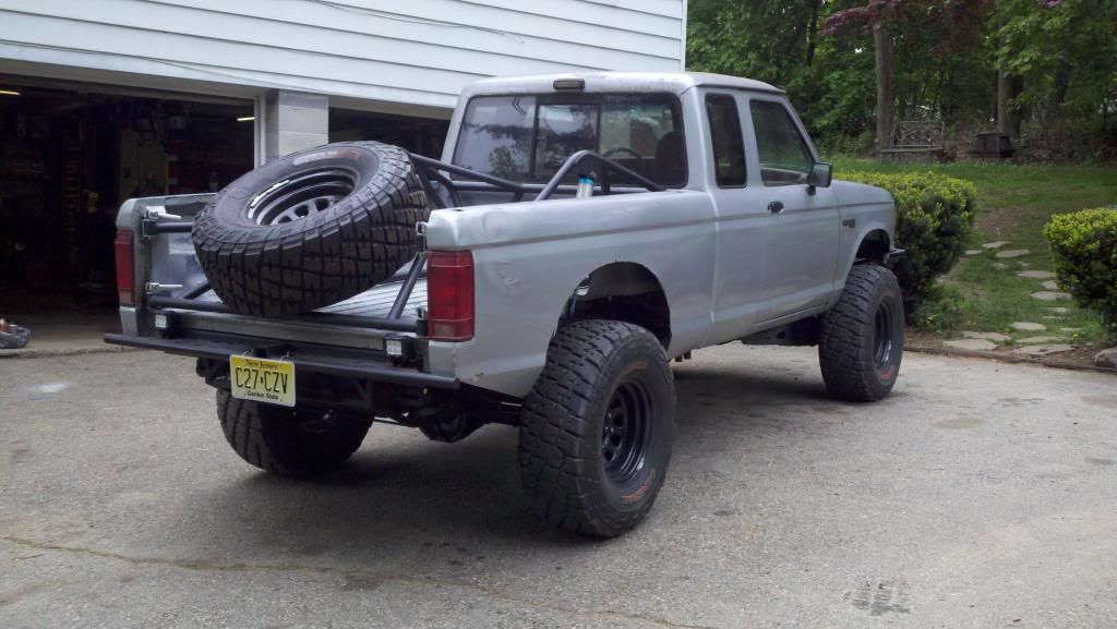

Thanks! Its been a long run... im still wiring today.... Than I need to adjust the ride height, do alignment again. Bleed brakes, build inner fender wells, strap battery better, tie shit off and a ton more but it the moves!

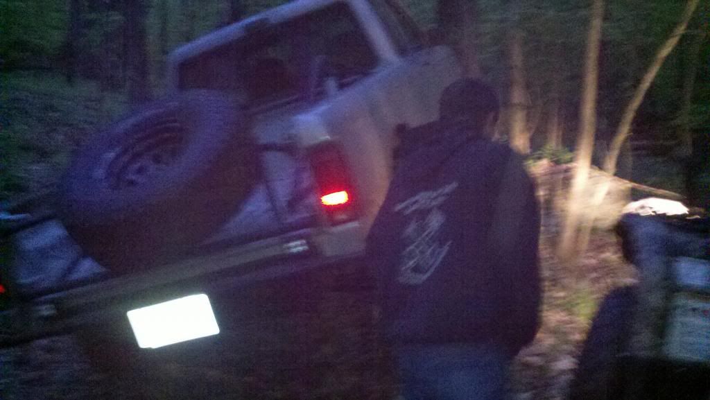

Truck got some use this weekend and did very well IMO.
I went on a 2 hour road trip and took it crawling all night saturday night. Than yesterday I drove home and took it to the sand pit down the road by my house to give it a "dezert test" or at least as close as I could get.
The rear is packing a bit but otherwide the suspentions feels very good. The only truck makes alot of jittery noises but I dont think I will be able to get rid of that...
Check out the pics and vids and let me know what you think!

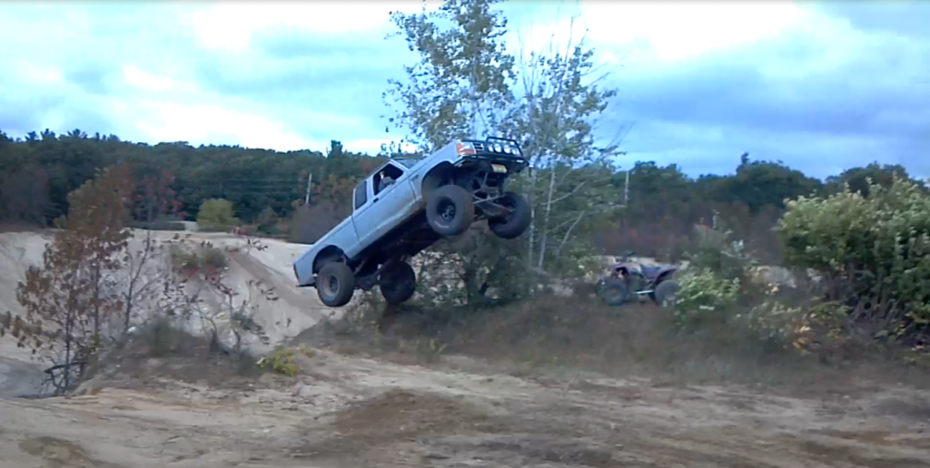

I went out to show the jeep guys that my TTB can drive anywhere they can.
Damn! That's a lot of air :eek:
