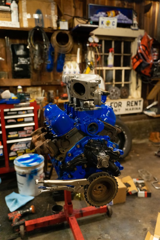

Alright, guys, I need your collective ford knowledge for the little predicament I'm in. I'm on my second 2.9 rebuild and I'm slowly learning from my mistakes from the first time I tried this. I recently purchased an 89 block from a pick and pull yard, the engine has roughly 140k on it, in decent shape. I ran a leak down test and got results leading me to replace my piston rings. I replaced the rings, honed and deglazed my cylinders and replaced every engine gasket top to bottom, new fuel injectors, sensors, etc, etc. what I want to know is the proper break-in procedure once I get the engine in the truck. I've heard everything from run it at full tilt for 20 or so minutes to baby the engine for the first thousand miles. I know I need to run high zinc break-in oil and change it after 500 miles but the exact process for successfully breaking in the rings eludes me...Haynes manual is less than useless for this. The only new internal parts are the rings and gaskets so 99% of the engine was left alone I just don't want to do something wrong and have to redo all this work again. And before you say it, I should have done a 5.0 swap and saved myself the stress of messing with the 2.9 but what can I say, I'm stubborn.

so what I'm hearing from everyone is to drive it easy but occasionally give it the beans and to engine brake, varyingRPMS. My last question, how long can I take once the engine is running to time and tune it?? I have heard letting an engine with fresh rings idle is a huge NO NO.
No racing the first 500 miles, basically is what it means, not sure but I don't think racing anything with a 2.9L V6 would win you anything anyways, but basically don't race and don't tow anything and it'll all be fine. With today's traffic trying to break in an engine in the real world is pretty impossible. Just don't drive around with the skinny pedal to the floor and all will be fine. Biggest thing is to change the oil shortly after the rebuild, then doing it again around the 1,000 mile mark. Once you do that it should be good to go, I still run a zinc additive in my Bronco 2 even though the engine rebuild was done almost 2 years ago. Doubt it really does any good but I'd rather not find out with another $5k engine replacement bill....PO didn't do anything helpful to that poor Bronco 2.
