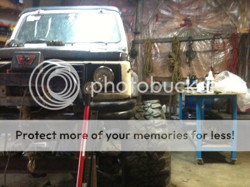

got the front bolted in (what a friggin pain...)
1988 samurai LWB build
the drivers side went easy the passenger side i couldnt get the centering pin in (needed another hand to jack up the axle) so i took the spring off the truck bolted it to the axle then bolted everything back to the truck

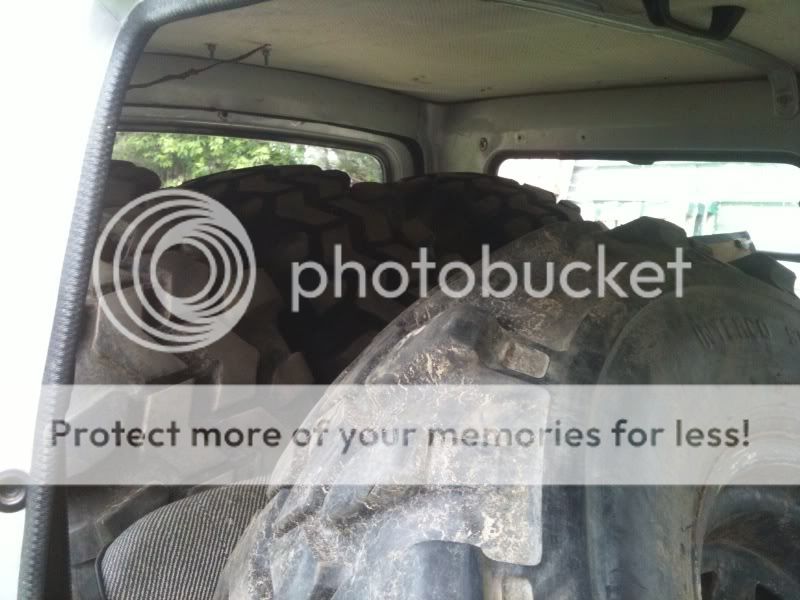

once i was done that i took my 33s and threw them in my safe aka my poor neglected sj.. this thing keeps getting pushed further and forther back on my to do list

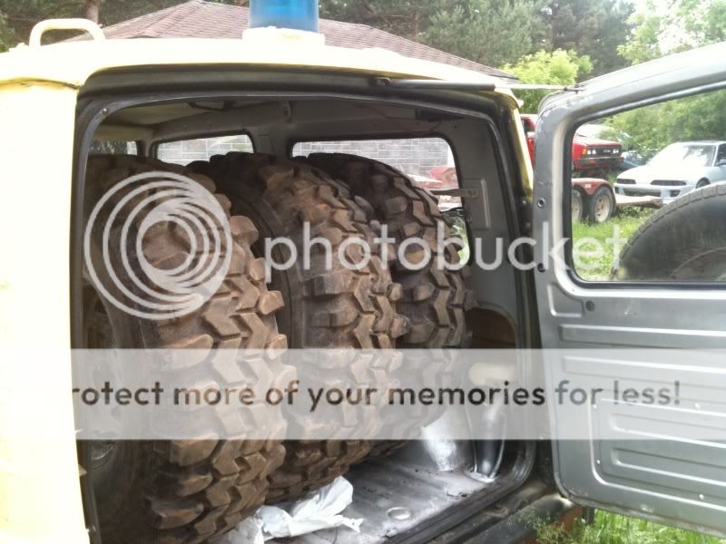

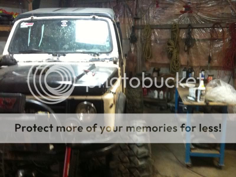

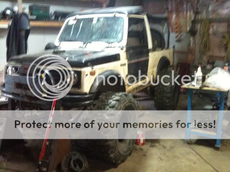

then i pulled the rear tires off and started taking the rear axle out then
threw a few of the grovved 38s on to see what it looked like
i think its lookin pretty bad ass. had to stop early today its 2.5 years with the gf today so i figured i should be home for when she comes home. more tommorow!! i hope

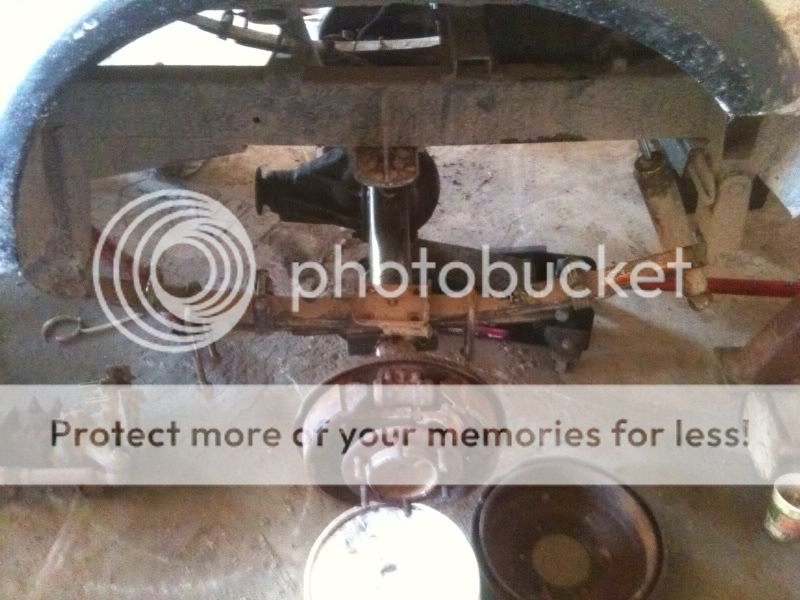

ok so i went and pulled the samurai rear axle out today and threw in the toyota rear.

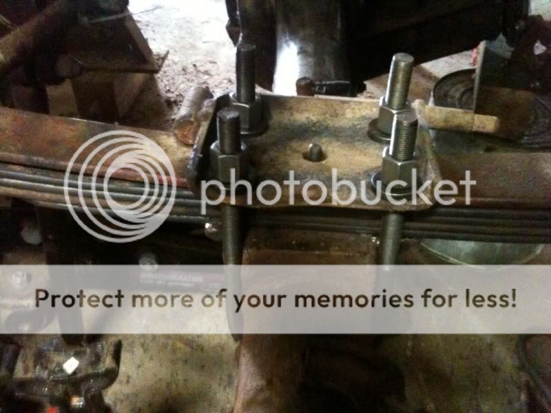

all in all wasnt so bad i cut the opld perches off and got some 2x2 square tubing 1/4" wall. kinda overkill but it was in the scrap pile and just long enough so i used it.
i forgot the camera so no pics. pretty basic stuff though. cut them both 6" long the stock toyota ones were like 3-4" long. i went a bit longer cause i figure it could halp with axle wrap and thats how the last ones were done so i copied them. And the torch was outta gas so i had to cut a triangle out of the square tubing then ground the edges out until it was a nice circle shape.
made sure they fit and found the centers marked them and drilled the holes for the centering pins. tacked them to the tubes at 35 1/4" inside of perch to the inside of the other. (stock samurai spring width)
threw it all under and turns out one perch isnt level with the other. but its not a big deal i realized im probally going to have to reset the pinion angle anyways once i get the new transfercase in.

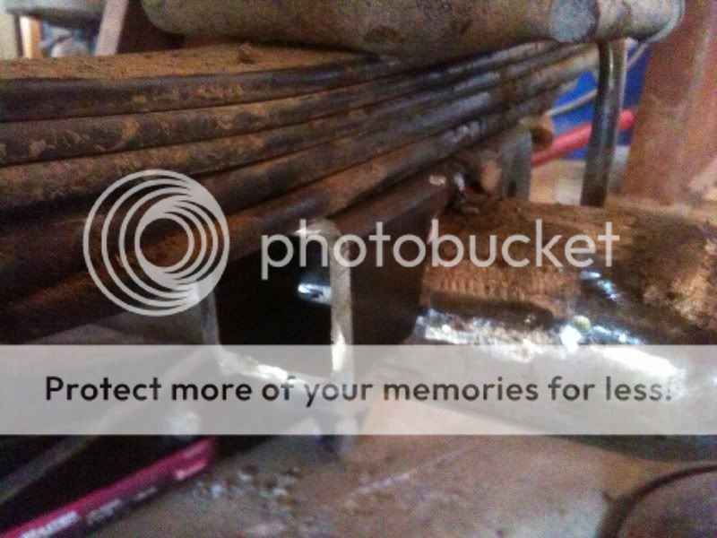

heres the axle under the truck

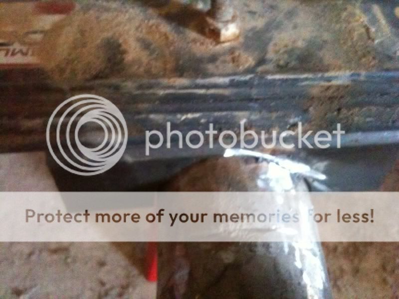

my homemade perchs
this is the side i got the angle wrong on so i jacked up the truck so theres a bit of pressure on the axle from the springs and cut the tacs and the force fo the spring spun it to where it shoulda been. good enough for me. i still need to get the new transfercase in to be sure that i dont need to change my pinion angle b4 i burn it all in.

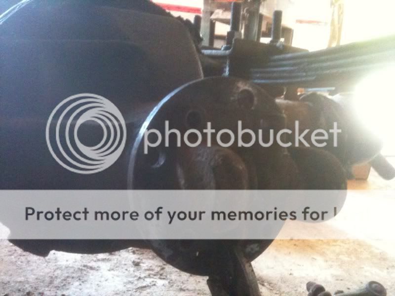

i also grabbed a spare yolk that zac had laying around for his mazda and threw it on my front pinion to see if i could use a regular toyota shaft on the landcruiser pinion. turns out you can the centering ring lines up nice and tight. but the bolt holes are off so i just turned it about 30 degrees and am going to drill new holes tommorow. i didnt have a drill today.
most people say to drill the new holes 45 degrees to put the new holes in but i figured in case i need to now i can add another bolt pattern in there if need be.

after all this i went back to grooving the 38s. i just about have the 3rd one done then its all good. thats all for today

oh yes and of course im talking to dad last night about how i had to make the perchs he tells me a much better way.... use 2x4 tubing mark the center on the 4" wide piece get a hole saw and drill a hole (whatever size the axle tube is) then when your done just split it along the center line. done 2 perches in like 5 minutes... not my way that took like an hour lol
