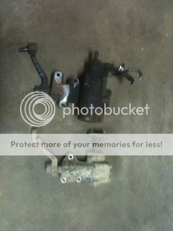

ok so im looking at the power steering boxes. and i have 2 options an both toyota IFS power steering boxes.
one is from a 86-88 and the other is 89-95. but for the life of me i cannot find the difference between to 2. anyone know the difference?
chances are ill end up with the newer box as im trying to get one from a wrecker and i doubt they will still have an 86 toyota sitting in the yard
From what I can remember the newer box is the ticket, something about better design in flow and power assist circ.
okay so i sold those 33s and went out and got myself a power steering box out of a 93 4 runner got that all mocked up and evrything threw a knuckle on the check my placement and it seems that its going to be perfect where its sitting
toyota on top obviously and it is bacwards to the samurai on because one is on the inside of the framerail and ones on the outside.

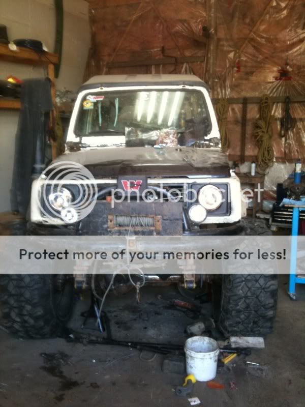

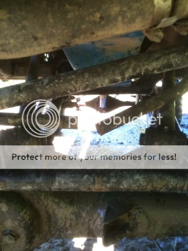

unfortunatly its was a 1 step forwards 1 step back day... i went to throw in my steering linkages to see what all needs to be done with that and my crossover from knuckle to knuckle hits my leaf spring.... so looks like im gonna be needing a highsteer kit
and like what was said b4 i also need a different pitman arm thanks to toyotas wierd ass stock version. i was hoping to have the break in and shake down run next weekend but now with having to spend the $ on this stuff i doubt it'll happen.
good news though with the new box outside the frame it looks like all the stock landcruiser stuff is the proper length but i will need to switch out to a fj80 TRE at the pitman arm because the replacement one is tapered for that. (im still looking to see if its a different taper then a fj62 TRE)
not too many pics because inside the fender well was too dark for my crappy camera. but all in all it really wasnt too hard to get the box to fit. a littel inner fender trimming and i was even able to reuse one of the holes from the samurai box to locate the toyota one. i will try and get better pics tommrow hopfully, after the mud bog im hoping to be able to get back and throw my diffs in and rebuild the knuckles and get those on then the front end is all buttoned up minus the steering

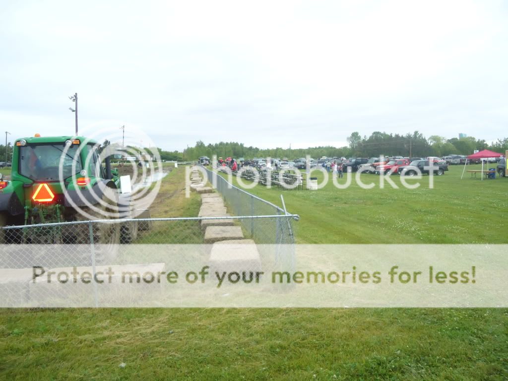

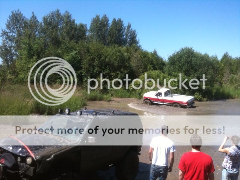

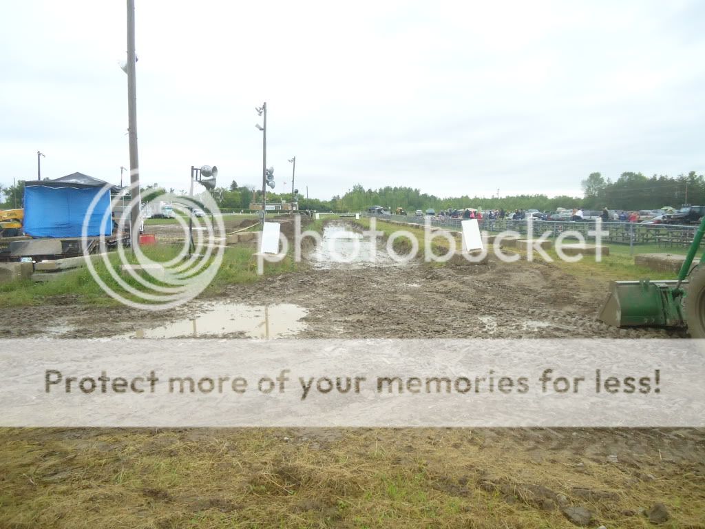

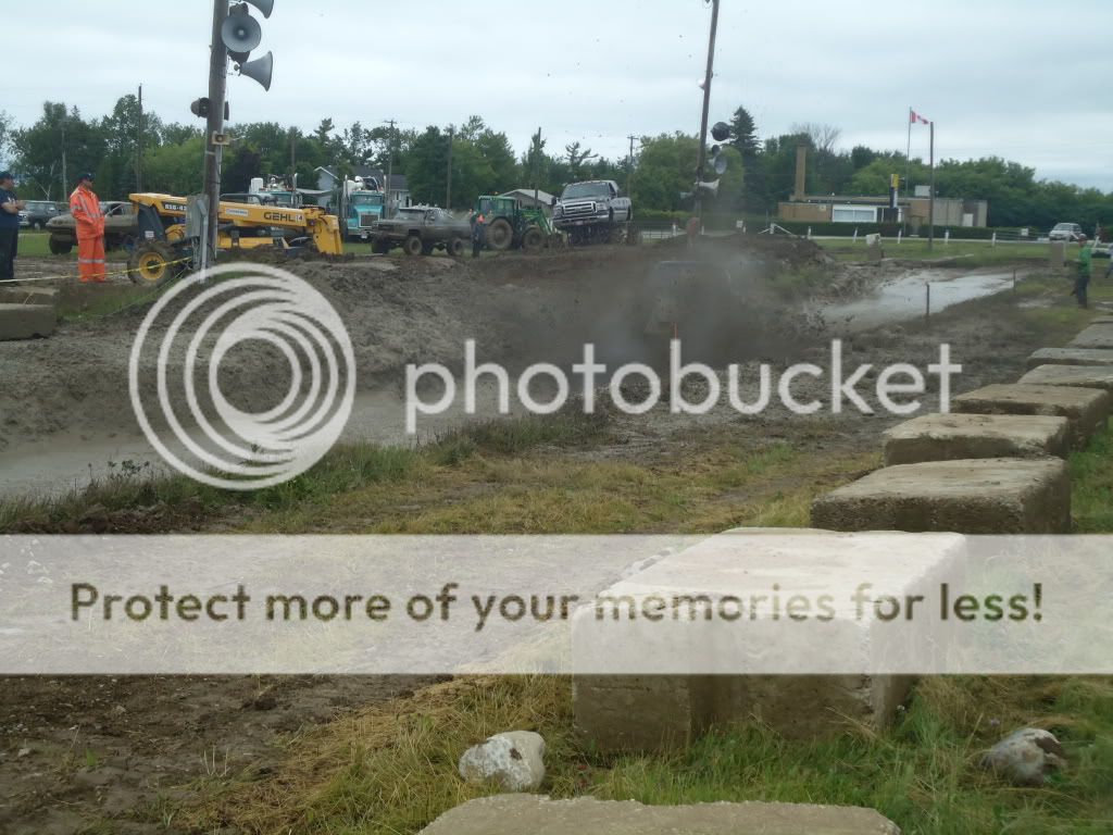

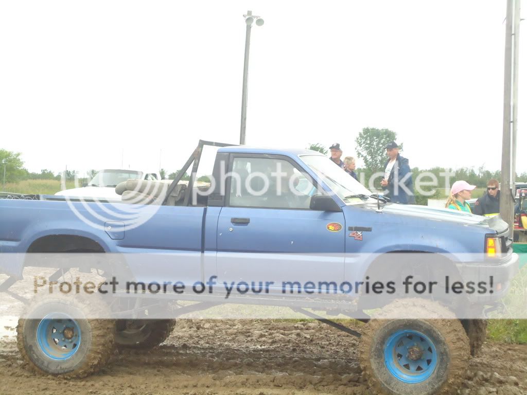

well heres some pics from saturday pretty good day overall. dad sponsord the event and scince this truck was down my buddy brought his mazda to run in my place and i got to play pit crew for him and also a few other people lol.
im not wearing shorts
the pit before the 1st class. they had 2 hydro-vac trucks there to ad water and added dirt with a few tractors for every class.

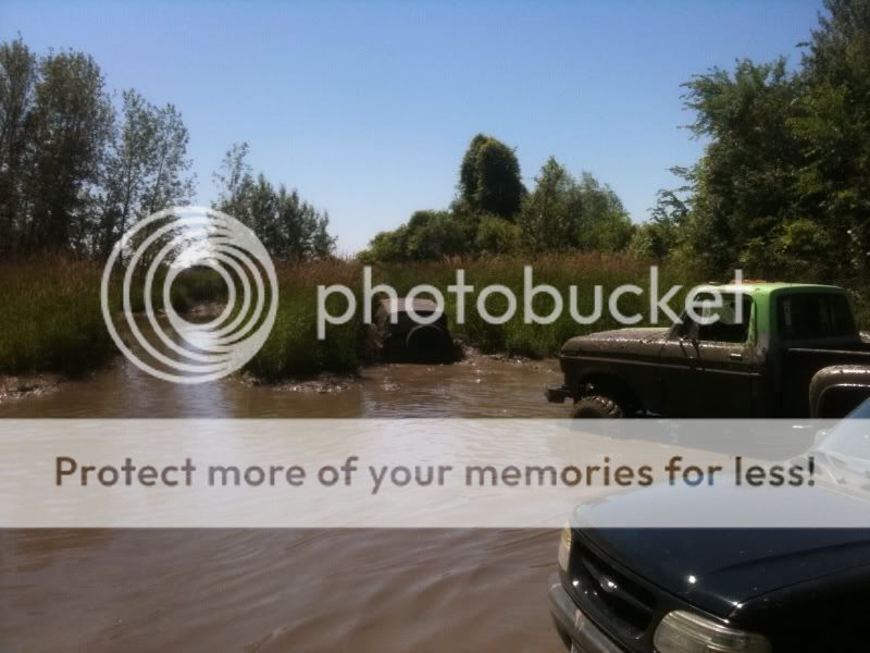

and while setting up
carnage for the day was 2 front driveshafts in two different trucks one was a 69 f100 on 44s and the other way an s10 buggy on tractor tires around 38" tall. (no pics)
one rear driveshaft under an 2006 ish chevy sas'd and all that on 44s also bent the link bars in the rear end and all that pinion pointed straight up lol (no pics of this truck)

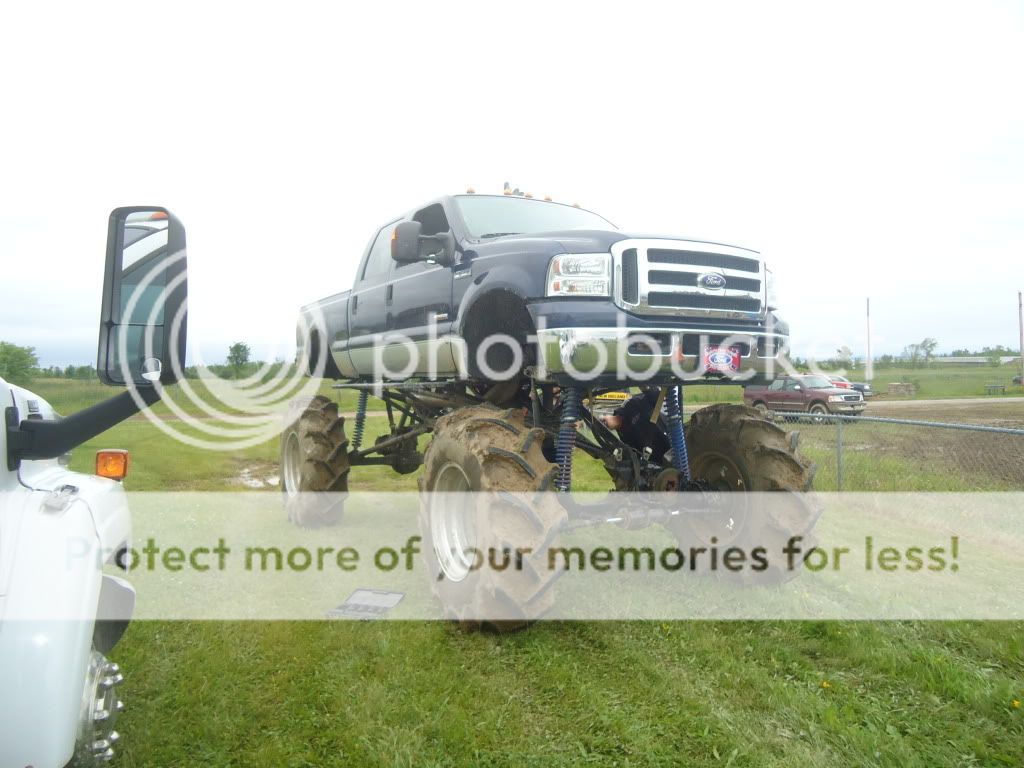

transfercase housing cracked in mikes big ford its an 06 truck but has a 7.3 in it turbo work done, range box, chipped and generally badass on 57" tractor tires. rolled last fall

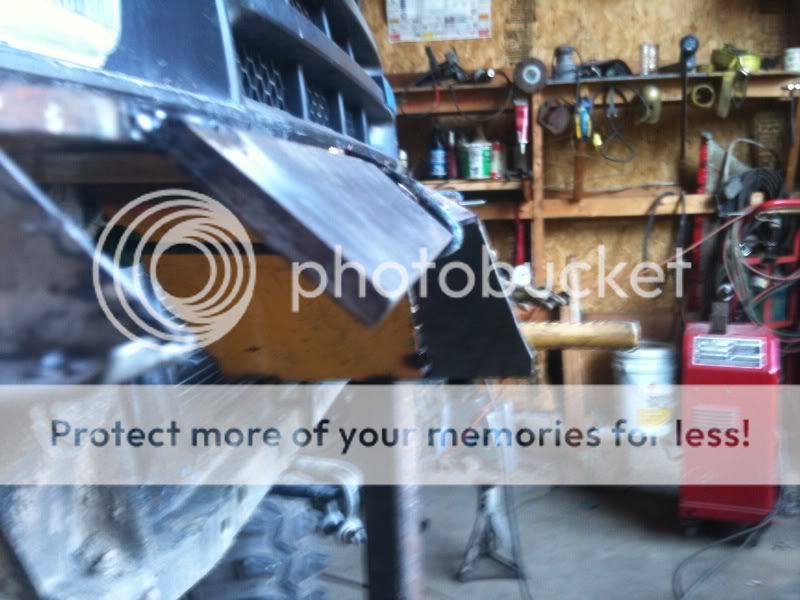

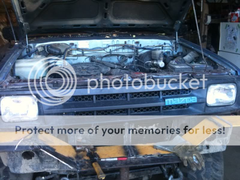

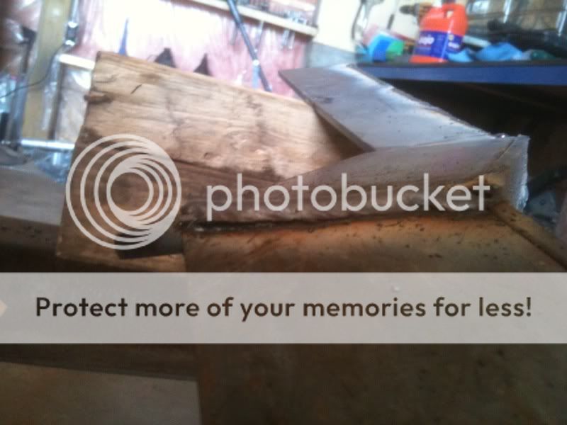

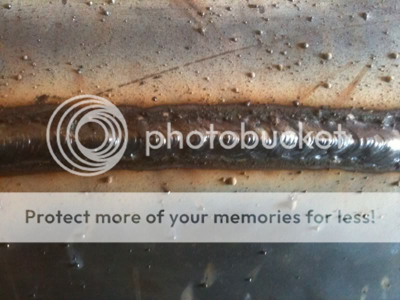

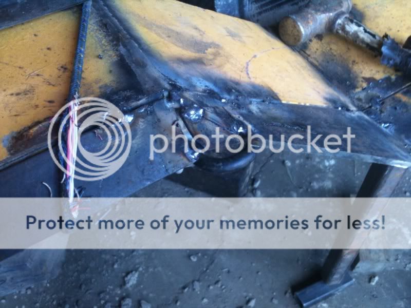

still waiting on my highsteer arms so progress has not been made on this. ive been builing a plate style bumper for my buddys mazda. we also went wheeling yesterday ill get pics of that up in a bit but for now heres the bumper
and i dont know if you can see this but i was getting the slag to lift off the weld on its own.

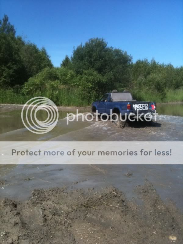

and the result of his mazda yesterday lol
panhard par went boom. its a super clean break though... almost like that tube has been welded there b4 but its a brand new thing that he got custom made from some low rider shop
well its probably because it was from a lowrider shop.....lol
yup lol but he figured a panhard bar is a panhard bar. and they make "custom" lengths now we know that they cut and spile in the middle instead of doing it the right way..

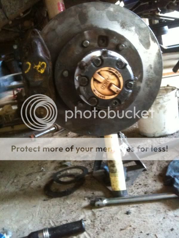

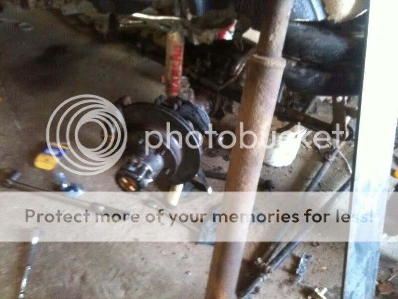

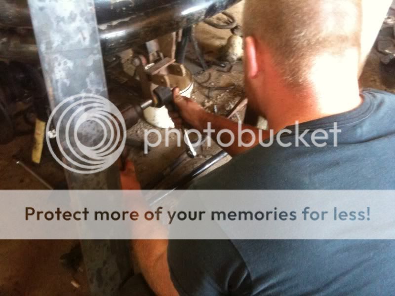

ok SO! todays progress. once i got there i tourqued my wheelbearings and everything on the drivers side and then threw my the rest of my hub together that side is now done.
the plan was to have a step by step thing on how to assmeble these knuckles with pictures but my camera girl fell asleep. lol so lets just say its not all to hard and you end up with this
while i was on that side i realized i hadnt tightened my leaf spring bolts yet so i did that quickley
i pulled the whole knuckle off the truck by taking the lockout cap off and removing the circle clip at the end of the shaft then removing the king pin caps. doing it this way lets you take the whole knuckle assembly to a table to break it apart (also a nice fast way to change a broken shft on the trail)
once its on the table i take everything off and line it up along the table in the order and orientation that it came off. if it faced in that side of the part etc faces downwards to the table.

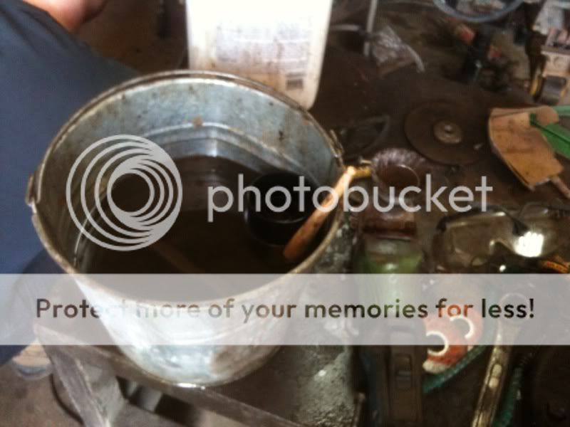

then clean it up in your fancy dancy parts cleaner
repack everything with new grease. ( i went all out and got the fancy crap) lol actually it was cheaper then the crappy tire brand

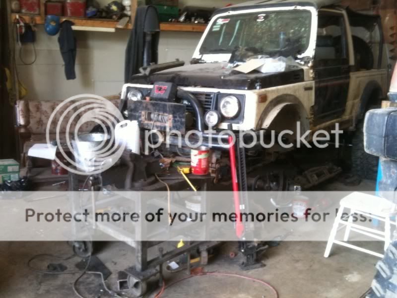

and re assemble until the truck looks like this
then........
all i have to say is :thefinger: this thing gonna be a tank
