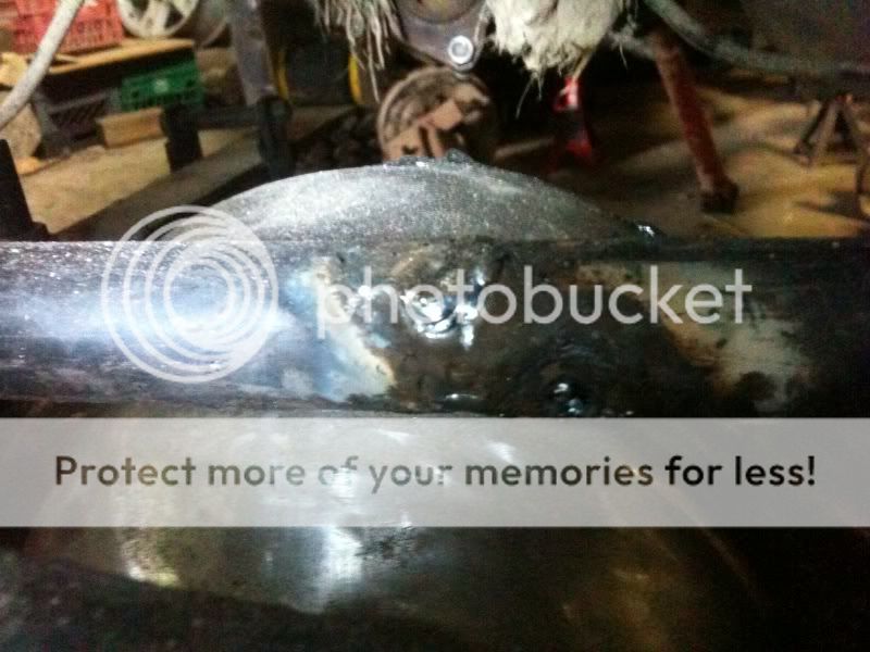

i got my highsteer arms on and threw my crossover bar in and the two tires are pointing completly different directions haha. so i took 4.5" out of it sleeved it internally with solid round bar then burned it all togther again with 4 roset welds and then a bead all around where was cut. its all good now tires are straight

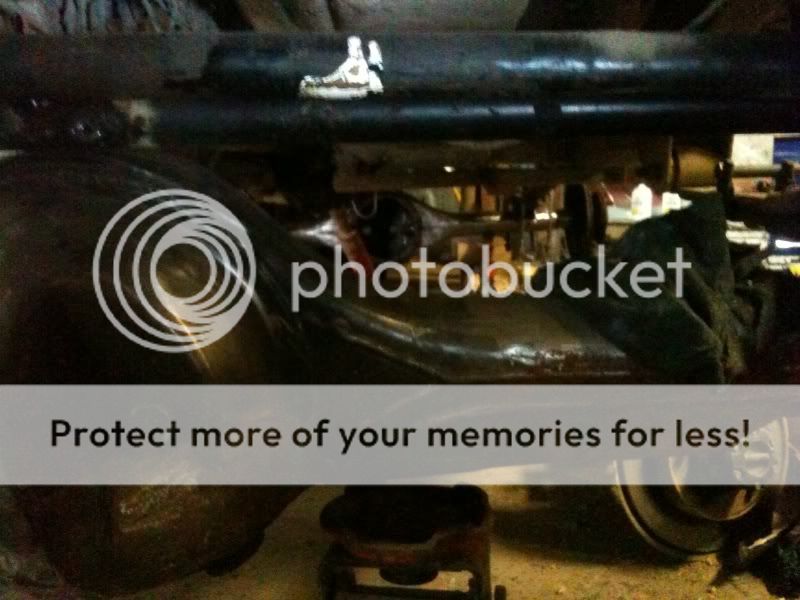

1st off here is my shortened crossover link. i know it doesnt look the greatest but this is all being done with a stick welder and getting burned in HOT so dont worry lol plus like i said before hammared inside of it is solid round stock you can kinda see where i did the roset welds

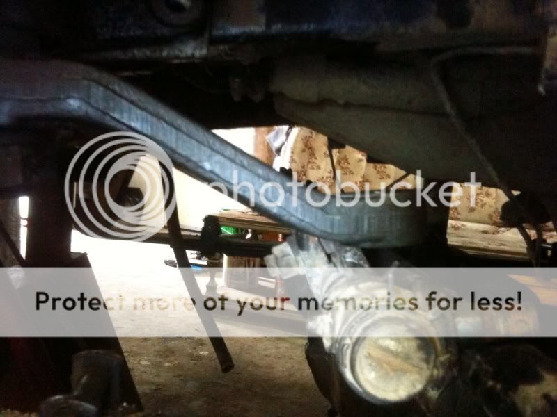

and here is my steering linkages at ride hight think im gonna have any problems with bump steer? lol

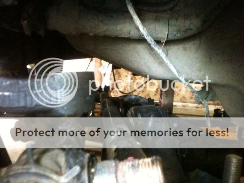

and the clearances between the crossover link and the oil pan i think it'll be fine but we'll see worst comes to worst ill actually have to put in bump stops

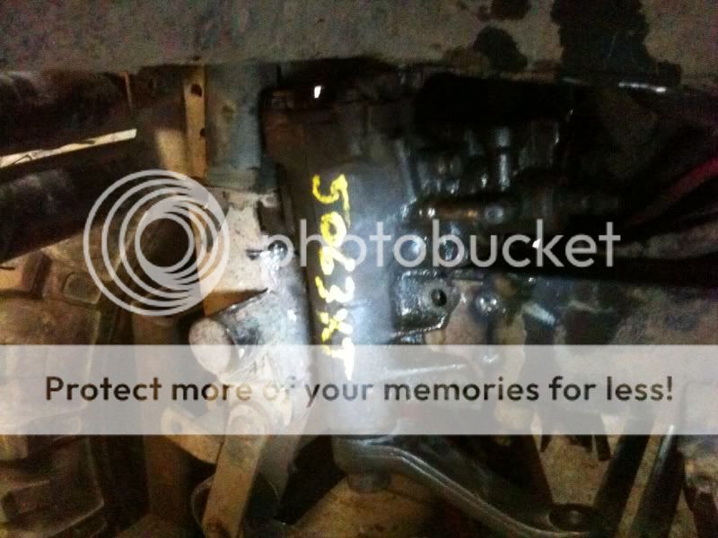

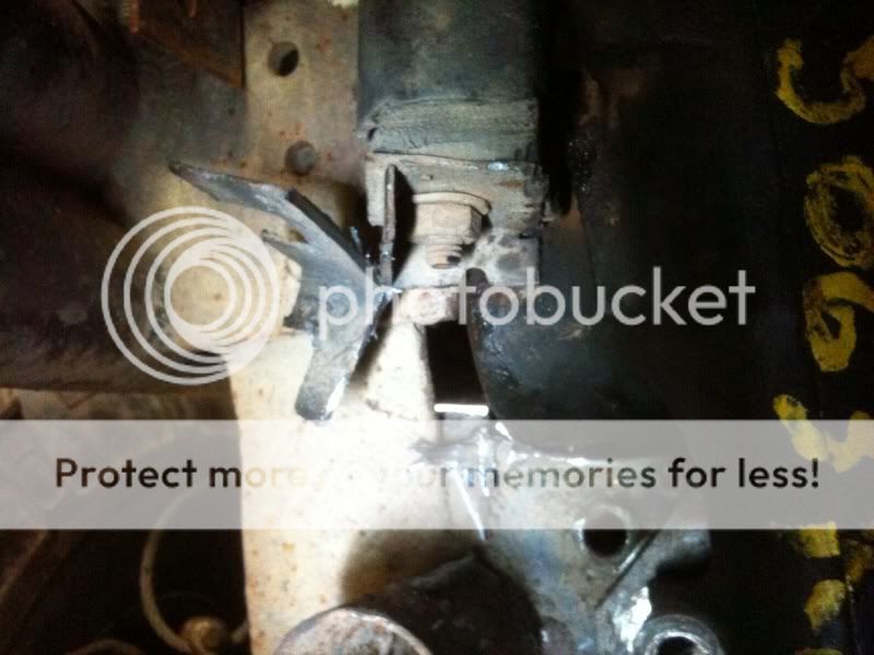

now in order to get everything all nice and straight i had to move the steering box up ALOT more then i wanted to so much so i had to remove a body mount...
1988 samurai LWB build
the body mount will be replaced with some angle iron welded to the bumper support. (bumper support is like 1/2" thick it should bestrong enough)

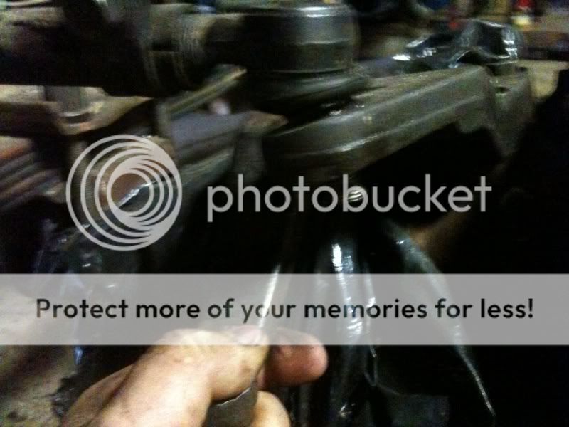

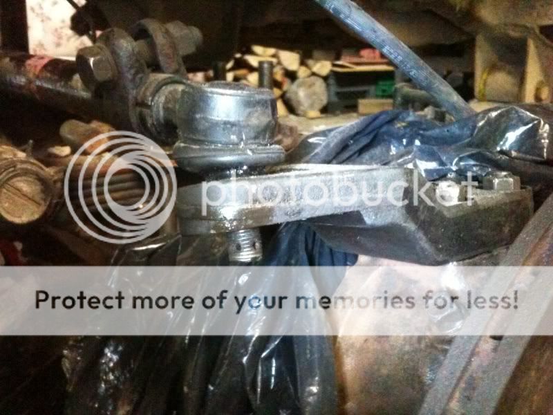

so once i had my box in place and everything done i decided to change out the pitman arm.
this is the old with the stupid male TRE built in.
and here is the new one. its the exact same length and drop as stock
now its hard to see but my crossover clears the pitman arm by an inch the two bars are exactly parallel but im concered with them hitting each other as i have my swing shackles up front. but i like that my drag link is almost flat to the ground ( i could easily get a flat pitman arm and not have a worry but i like that i figure im going to have zero bumpsteer)
so if it becomes a problem im going to do a shackle reversal so the axle swings to the way and away from the pitman arm.

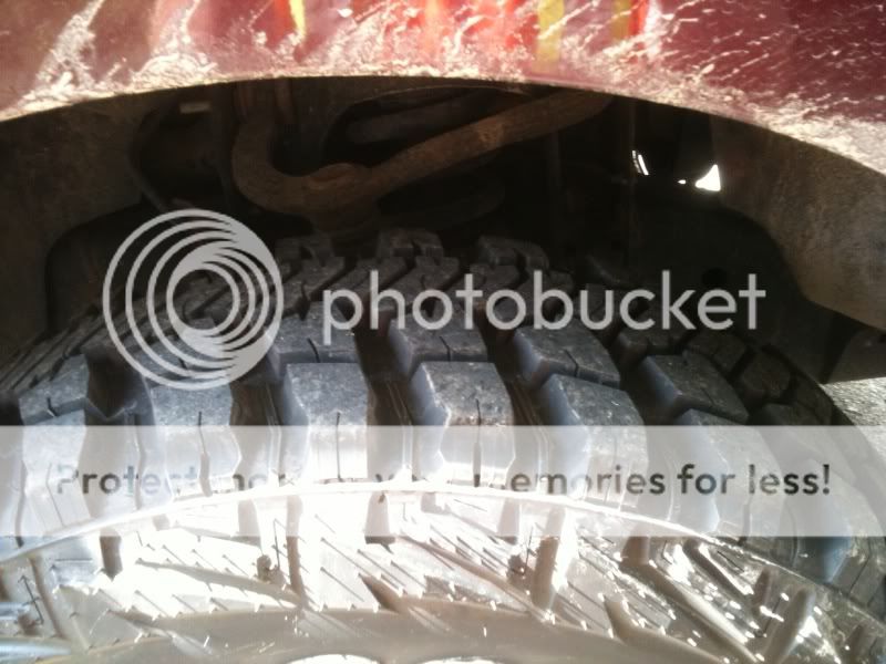

Nice, like them tires on the 150!
seem familiar? lol i like them so far i work as a labourer for miller doing bridge construction and i got to play with them a bit today on the way to a pour. In the mud of course (we've had alot of rain for the last two days) my forman and one other guy had to lock in 4wd and i backed up the hill to the bridge with no problem lol. and im only 2wd!
