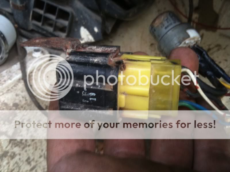

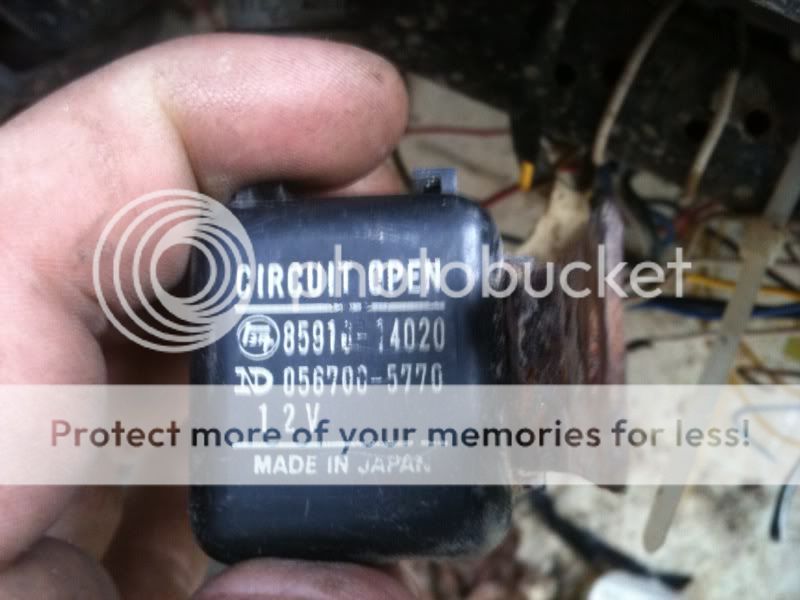

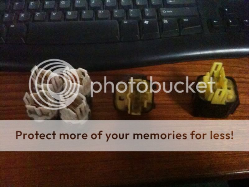

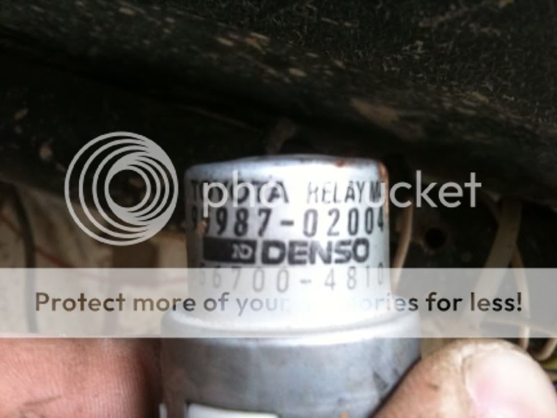

heres the two things im thinking of replacing ones a 4 prong relay (round one) and the other is a circuit breaker

alright so i went into town this morning to grab those 2 parts. the relay (round) was 9 bucks and square circuit breaker was closer to $400.....
needless to say i went to the junkyard in hopes to find one and of course it was easier to find all the round ones. i went through 15 trucks and cars and didnt find anything then i went over to the 88 landcruiser i got the front axle from and BAM! theres a circut breaker.
1988 samurai LWB build
the round ones are my extra relays for the fuel pump. then theres the 2 circuit breakers one old and one new the old one is the one on the angle.
i opened up the circuit breakers and the new one looks new. the old one looks melted.. so considering it wasnt easy to find and arnt cheap new i wanna know why it melted in the frst place b4 i put the new one in the truck. but of course its pouring out right now

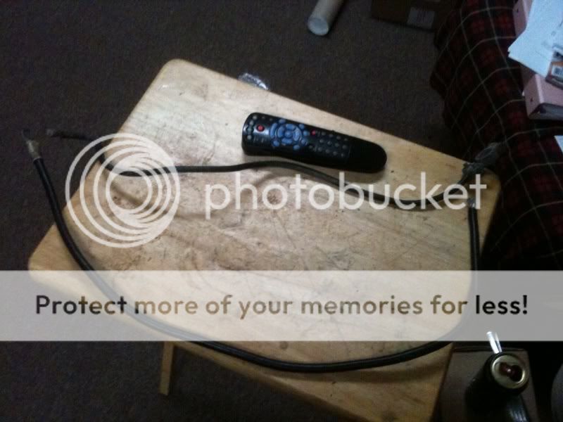

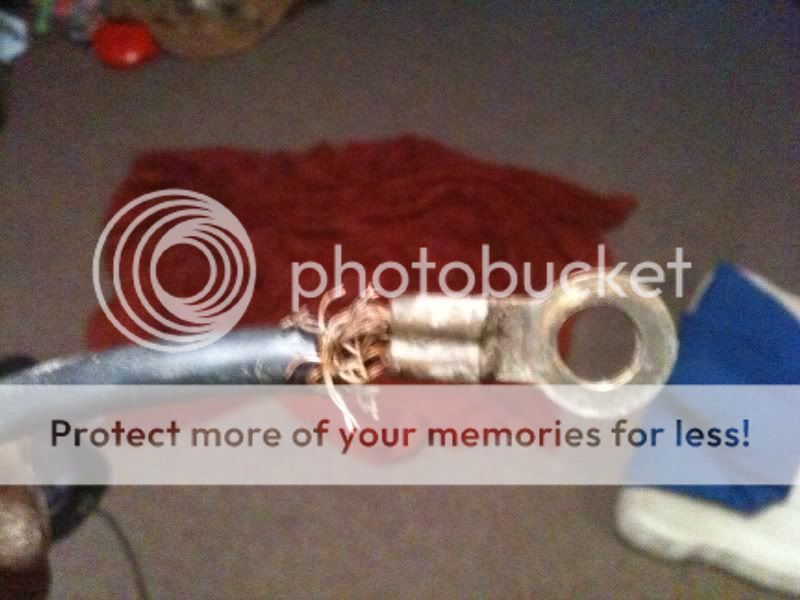

its happened like once every two years its the ground from the battry to the motor. i just threw a set of jumper cables from the battry to the block to be sure that it was the problem and sure enough it turned over. so i went and grabbed some 4 gauge stereo wire from a buddy and replaced the ground with that. heres some pics of that scince ive been slacking with those.
old ground on top and new on the bottom

and this is the end of the old one

so it was a bad ground? no joke, i was gonna suggest to look at all the grounds, but i figured it wouldnt be that simple. i once chased an electrical problem for weeks myself. replaced the grounds going to the starter and to the block, nothing. on whim, i decided to have the alternator tested and that was it.
well part of it was a bad ground. thats just why the truck wasnt cranking over with the key. it still doesnt run thanks to these garbage pumps lowrange was sending me.. but that should be fixed tommorow morning then tommorow night its being loaded onto the trailer and up north for a 2.5 day trip completly un-tested :headbang:
