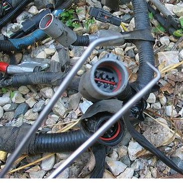

Edit: I just got a few pics.
This is where the Big White Plug would later be.
This is a much wider shot of the same area. All of my splices are here. It's not as complicated as it looks. Most of that bundle is extra power wires for things the Explorer (It was a Limited, lots of options.) had that I didn't need. Think power seats, windows, mirrors, etc.. I actually used a couple of them to power my lights. You can relays mounted there.
This is one of the factory connectors you want leave. If you can unplug it, it can be made into part of the adapter. There are only 2 on my truck. I couldn't get either one unplugged. That's why I had to make my splices outside.
