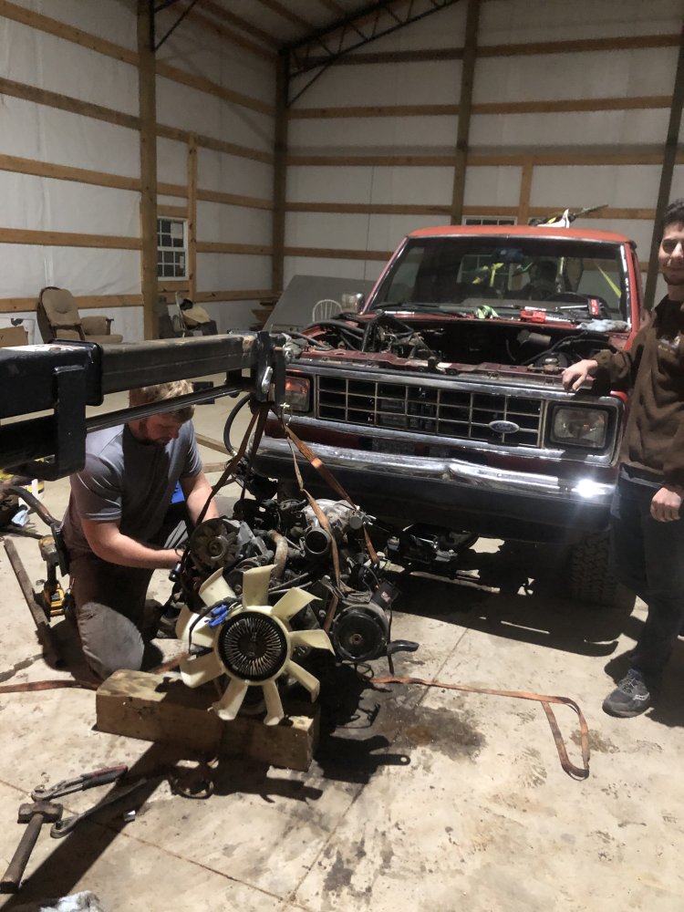

I bought an 87 ranger 4x4 with a 2.9 manual and my head gasket went bad the next dayšŸ˜’. The engine already had some blowby and I had another ranger I could buy cheap (also wanted more power) the 91 ranger I bought for the engine is a 2wd with a 4.0 (also manual) me and a buddy have the new engine in the truck we just haven’t done the wiring or fuel ext. was wondering if anyone had done this swap and could gimme some advice on the wiring or just advice in general. Thanks.

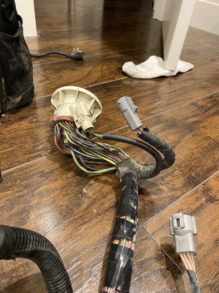

Hey so my wiring harness got cut on this (long story lol) and there are identical wires running through it and I’m unsure which ends go to each other. Any help?
Man, wiring is a whole nuther beast. Good luck with it though, wear your thinking cap and bring your patience
Post up some detailed pictures of what you have for wiring and maybe some specific questions. It's a difficult thing to explain over the internet...
Very generically, you want the computer and and every wire originally attached to it (all the way out to each sensor) from the 91. I found it easier to pull all of the relays and the underhood fuse box from the donor too. When you pulled the engine, should've just unplugged a large connector to the rear passenger side. It would plug right back into the other wiring you need. If done right the only splices required are at the firewall on the driver's side, to keep the 87 dash.

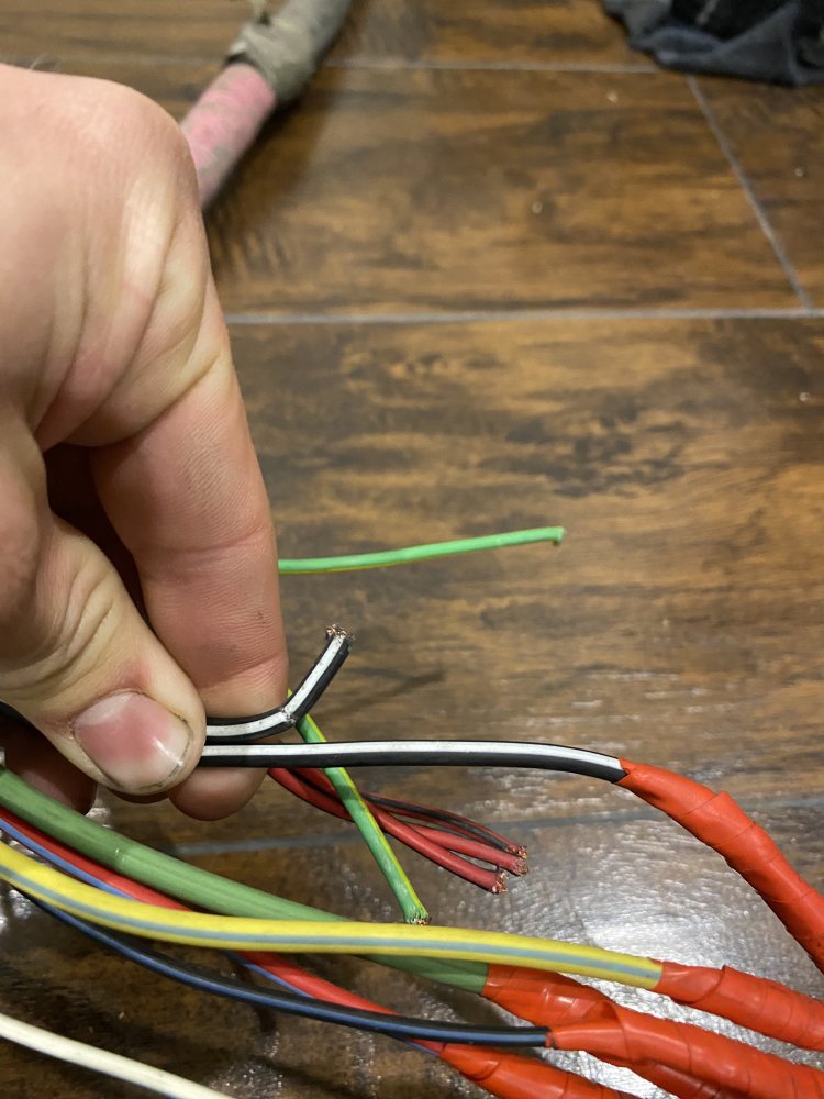

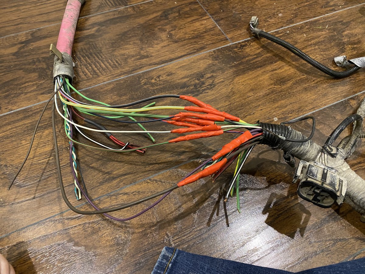

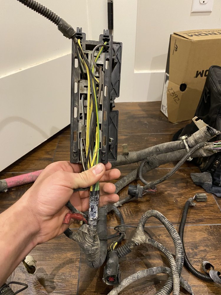

The wiring harness has been cut in two different spots the wires run from that fuse box to the plug that goes into the interior. I patched a handful of wires then noticed the identical black and white wires. So I tried to find a wiring diagram for the truck so I could trace them to where they need to go. But couldn’t find anything helpful/: thanks.

just use the eec harness and pdb.
I'd be willing to bet that those go to pins 40 and 60 on the ECU. Which are both ground from the battery.
Id use an OHM meter to probe a wire on the cut end and check the plugs until you find where it goes to. I have an old meter set up with an alligator clip on one lead so I can strip a little insulation off and clip that end on and probe with the other. Pain in the neck, but it works. Label each wire as you trace it. Masking tape works good for temporary labels. If I think I’m ever going to have to trace stuff out again I print labels with a labelmaker.
I’m going to say it… I don’t like the looks of your splices. Not sure what your method is, but it looks like you may be inviting future problems. Be less of a worry in the cab, but IMHO, the best two methods for splicing on a vehicle is solder and glue-lined heat shrink or the solder-shrink connectors that have a ring of solder that melts when it gets hit with a heat gun inside of a bit of heat shrink. Even those are not quite as good as unbroken wire, but much better than wrapping with tape.
