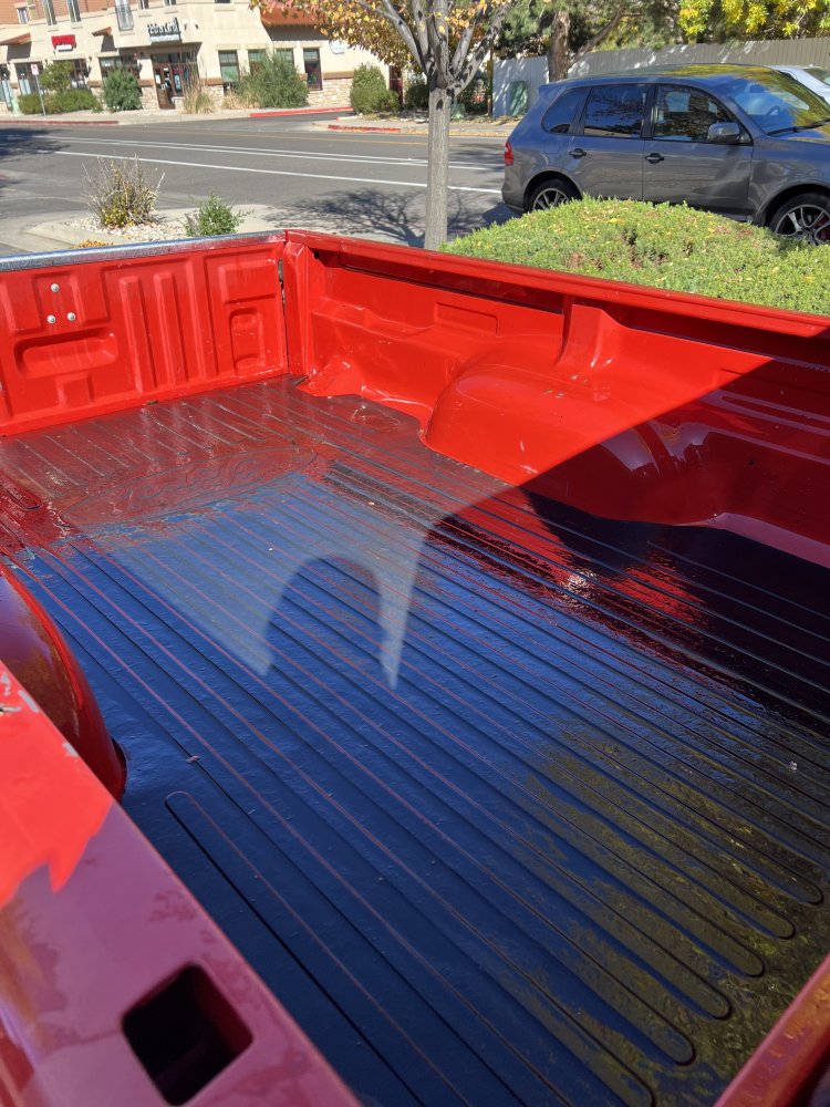

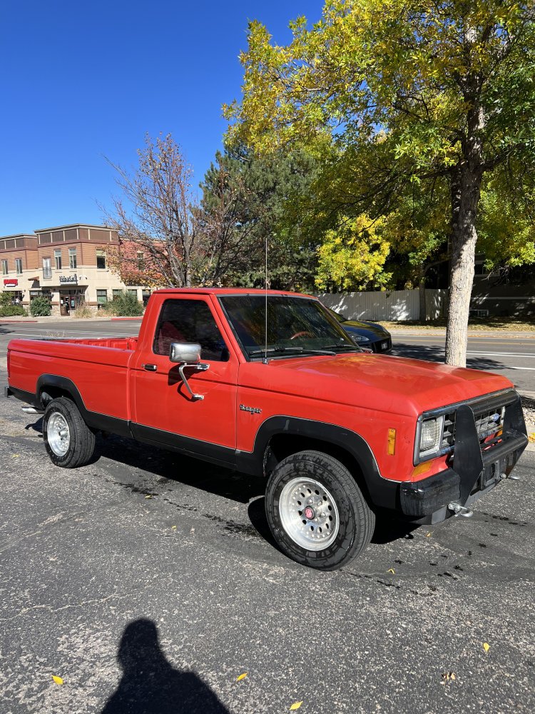

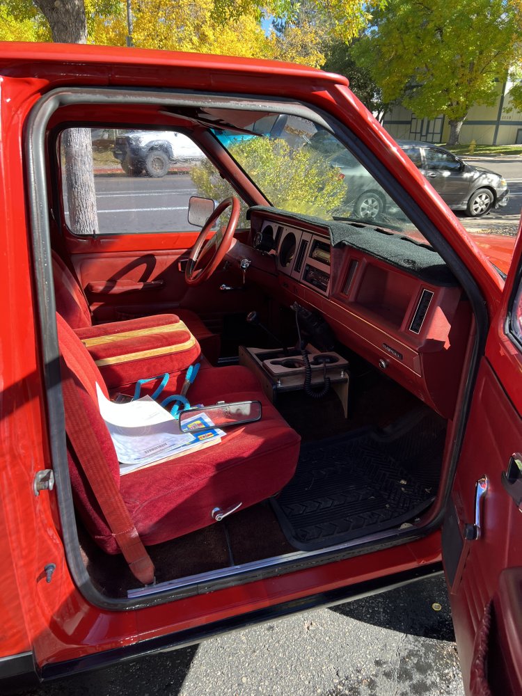

If you look at the pictures, you can see why I’m trying to save this thing
1986 Ford Ranger 2.9l Rod knock
