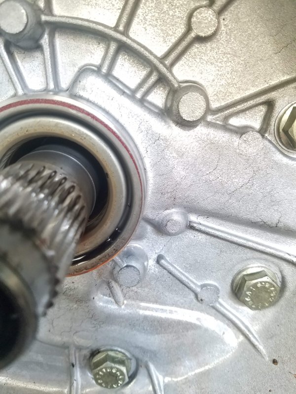

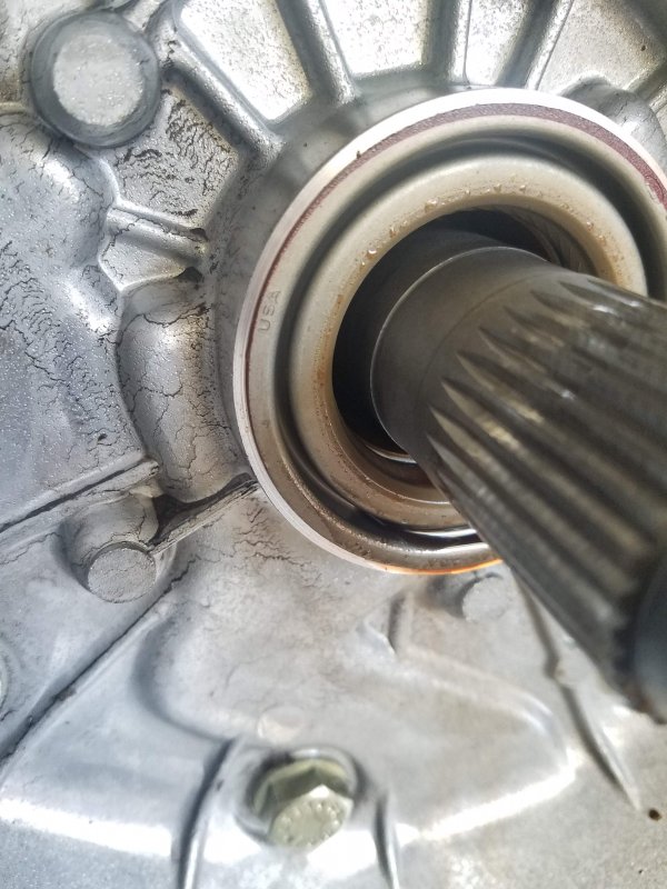

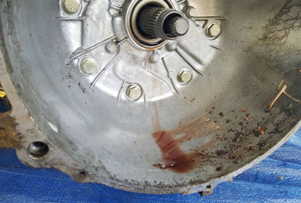

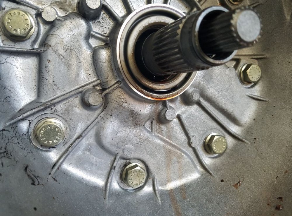

It looks like my seal is leaking in the the trans as suspected.
Now to order the replacements. I'll probably blow out my vent hoses as well. Just want to be sure they are not clogged and building pressure....
I'll also replace my rear main seal while I'm in here.
I ended up not having to loosen the y pipe up to the manifolds. Once you get the massive cat out of the way it gives you a lot of room to work with.
I also pulled the trans and transfer case at the same time.

Any tips on pulling this seal? I do not want to loosen the bell housing from the trans if at all possible.
I'm thinking sheet metal screws and prying it out. Sounds like a plan?
After reading online it appears some people replace the pilot bushing in the back of the crank if their seal goes out.
Anyone have any experience with this? I ordered one on rock auto along with the rear main seal, trans seals, and a new pan and filter.
I want to try and keep from having to go back in here if we can help.
You shouldn't have a pilot bushing. Your torque converter slides on to the input shaft of your transmission, and bolts directly to your flex plate (flex plate is like the flywheel in a manual trans vehicle)
