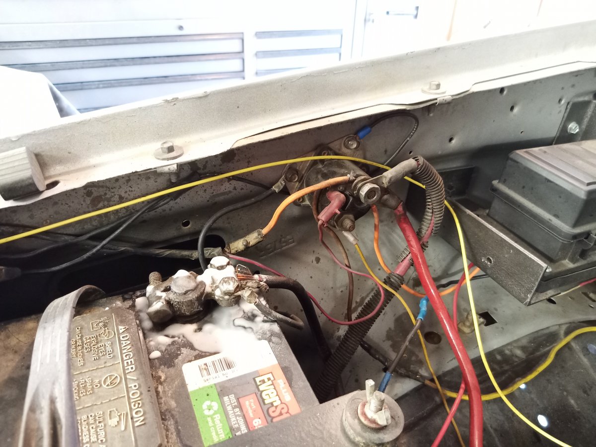

Went from this:
59537
To This:
59538
I'm running a PMGR starter, so I figured I could ditch the fender-mounted solenoid. I was partially correct.
I moved the wires from the battery terminal on the solenoid to the positive battery post, then ran the start wire from the ignition switch directly to the starter. Didn't work.
Checked the starter with a Power Probe, engine cranks. Checked the voltage at the start wire in 'crank', had 12 volts. What I found out is the PMGR starter solenoid pulls way more amps than the remote solenoid did.
-Simple fix, I added a 30 amp relay in the fuse box for starter duty. I fused the circuit with a 5 amp fuse and it blew. Upped it to 10 amps and starts now. The PMGR starter solenoid pulls between 5 and 10 amps then...
