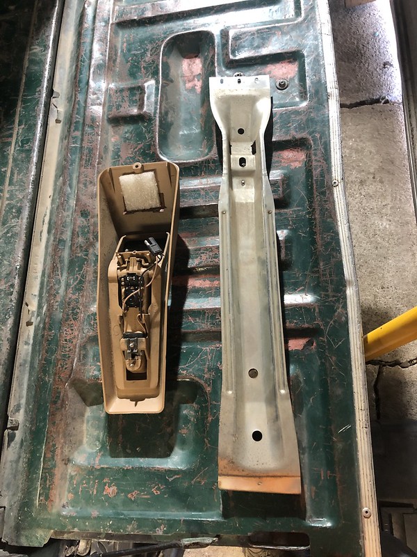

@Shran can you send me a pic of the console? Thanks!
BII's had bracketry above the headliner to support the OHC with a clock/maplight. Not sure on the touch drive consoles.
Rangers have a lower roof and don't need the framework.

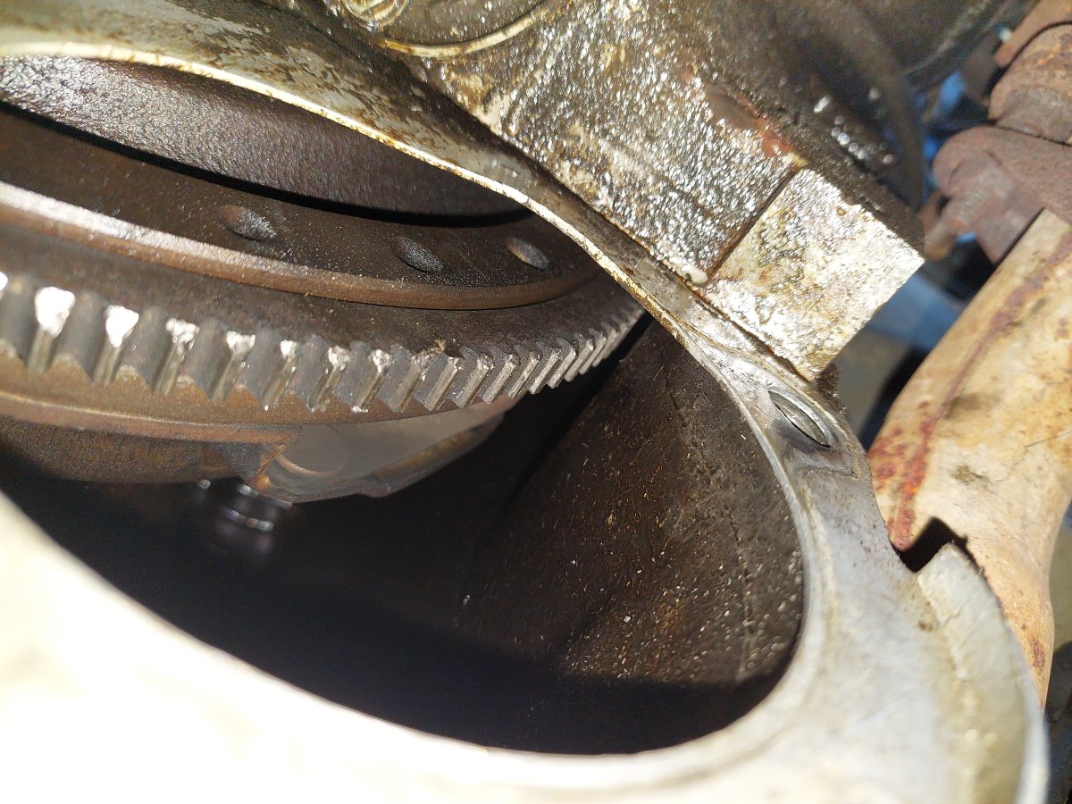

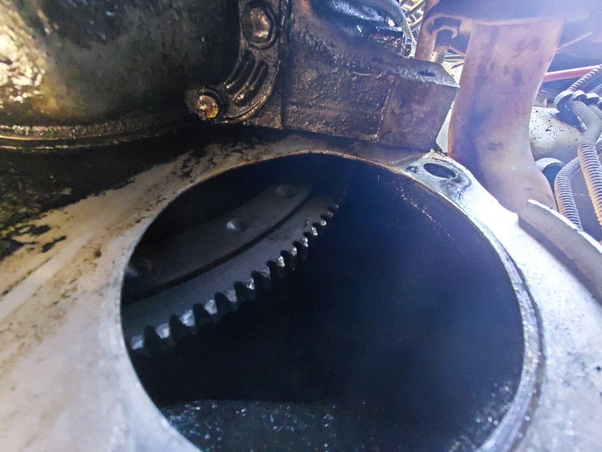

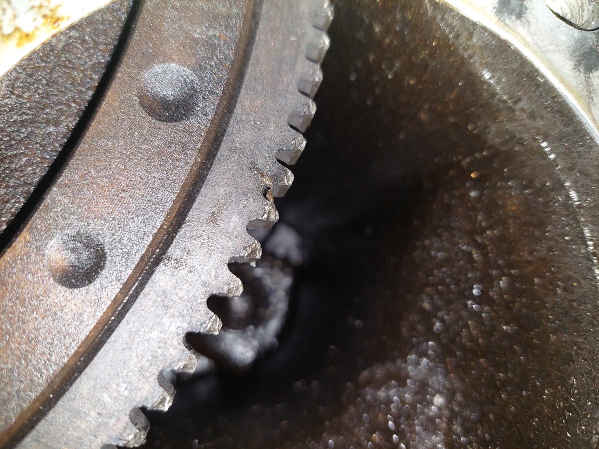

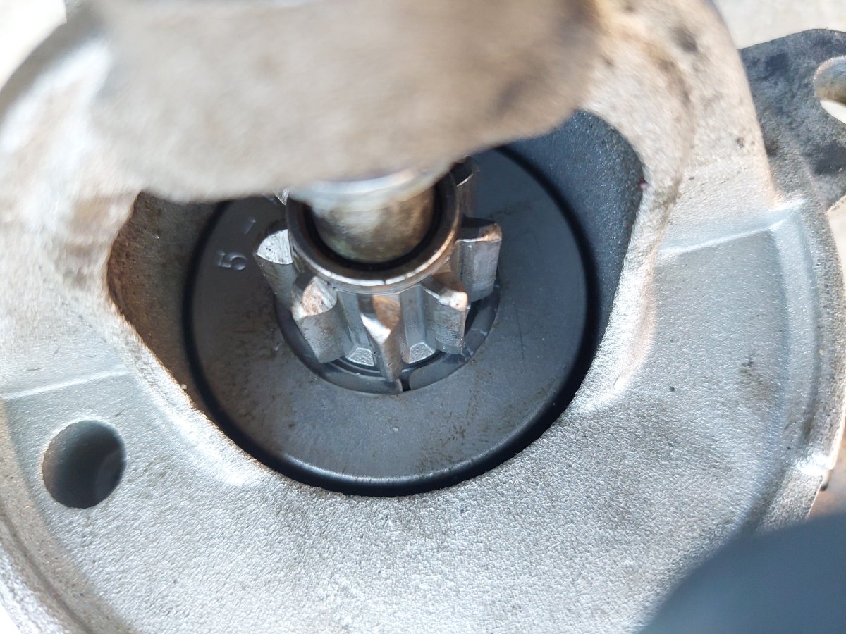

I took the starter out:
1984 Bronco II XLS side project

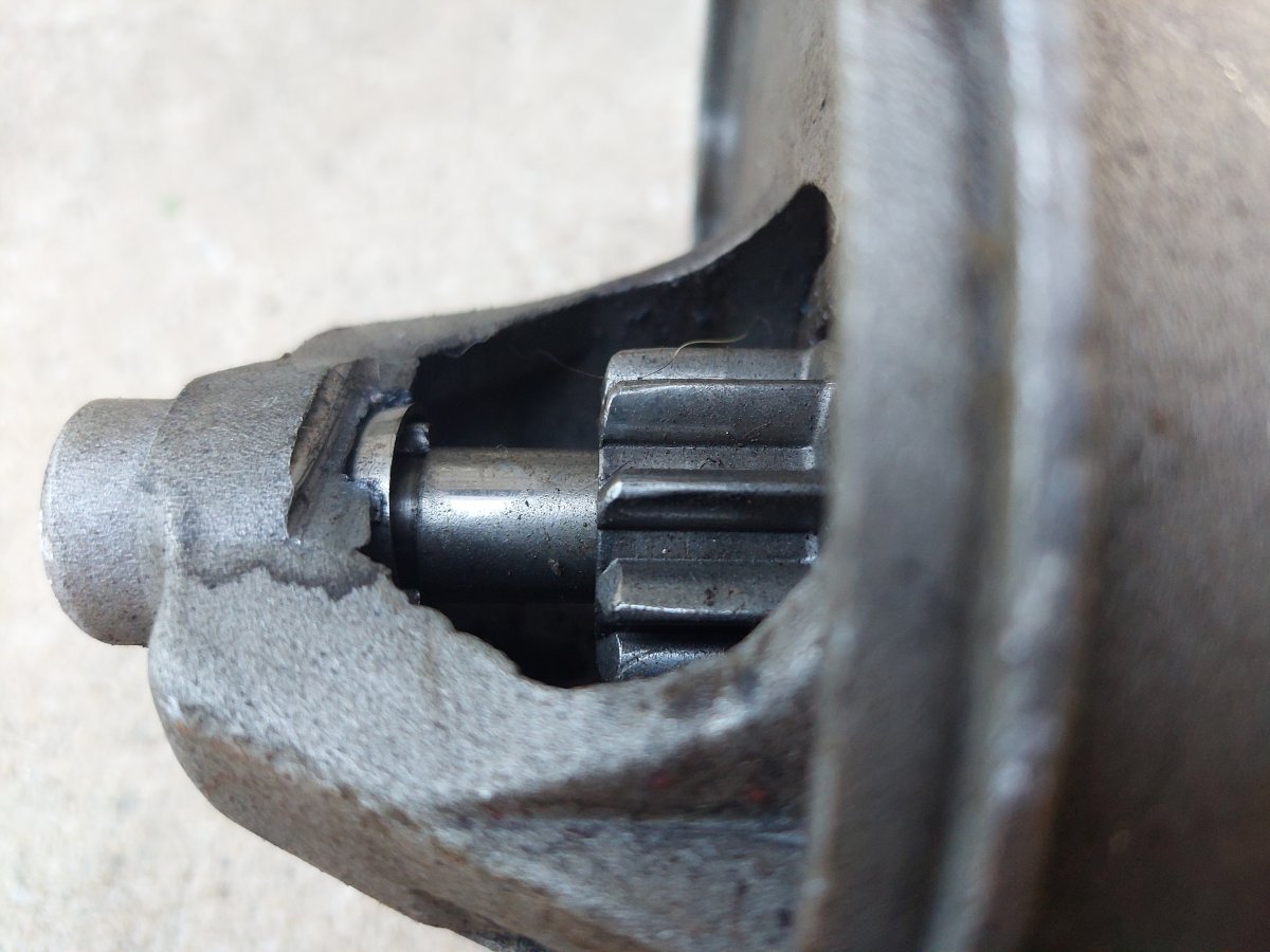

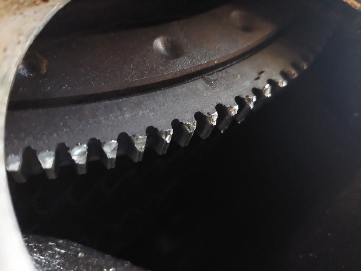

You can see where the starter has chewed up the edge of the flywheel teeth. The starter teeth look like the could be worn, but not much.
My question is why isn't the starter fully engaging the teeth? Not doing so seems to have damaged the flywheel, but there also looks to be plenty of teeth surface left on the flywheel that it should still be able to do it's job if the starter was engaging it.

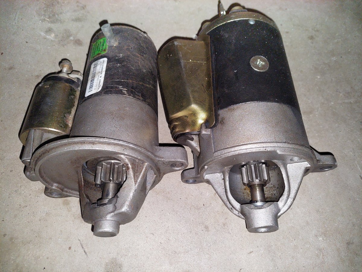

Trying to figure out a fix for this. I have a 4.0 starter from my 1996 Ranger I could stick on there.

Teeth look fine. None missing is the main thing. Does the starter just spin or does it spin and grind? Crappy rebuild jobs is the main reason... some people suggest swapping in a 10 tooth drive gear on the starter too.
A 4.0 starter will work as long as it's from a manual (you have an auto, right?) but it's wired differently. Lot of work to fix that problem. Mainly you would need a 4.0 positive battery cable. Probably easier to use the right starter.
Speaking of battery cables, make sure yours are in good shape. If they look really crusty, might be worth replacing them. I guess I could see a situation where the starter is not getting enough power because of cables that corroded internally.
I'll try to remember to get up in the attic and pull out that console I have this evening.
I thought you could use the 4.0 automatic starter on a 2.8. The spacing between the teeth are the same. I'm guessing I wire the solenoid on the 4.0 starter instead of the one on the inner fender.
The body of the 4.0 starter on the left is smaller and lighter.
Looks a lot like old vs newer sbf starters too.
