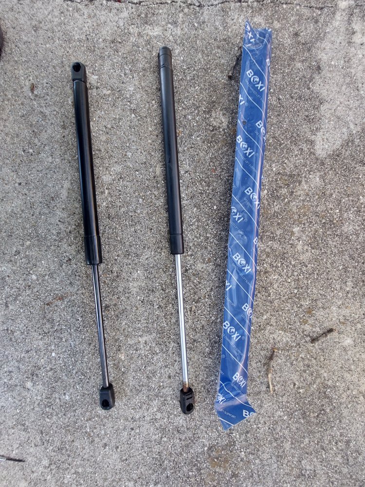

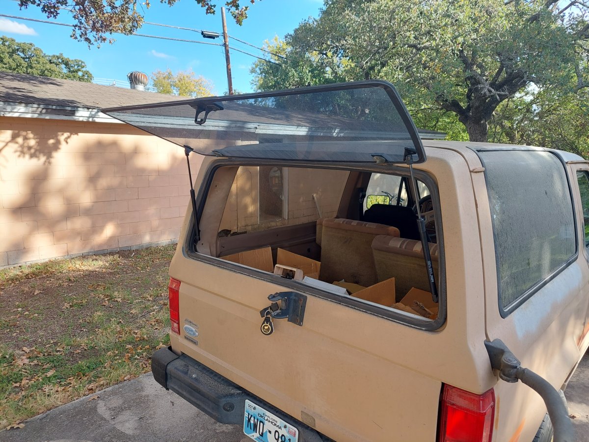

I changed out the struts that hold the rear window open, so I at least accomplished that today.

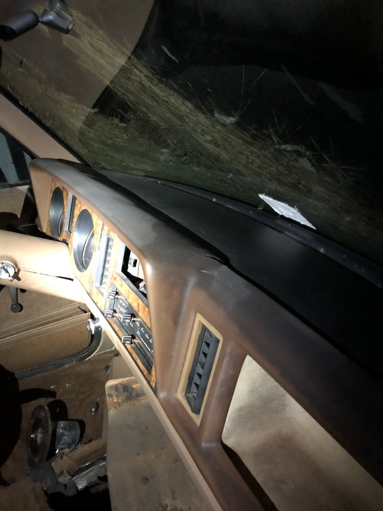

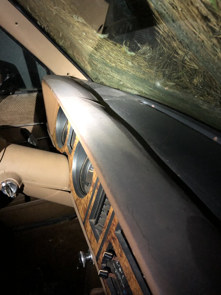

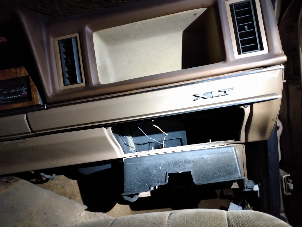

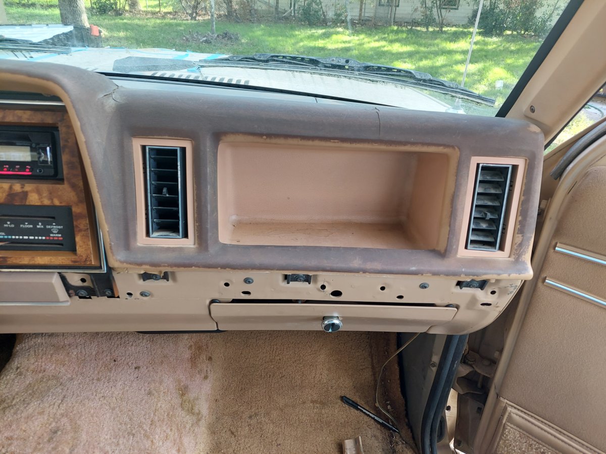

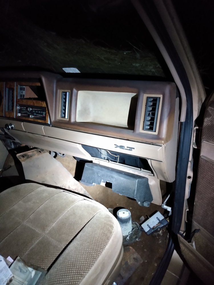

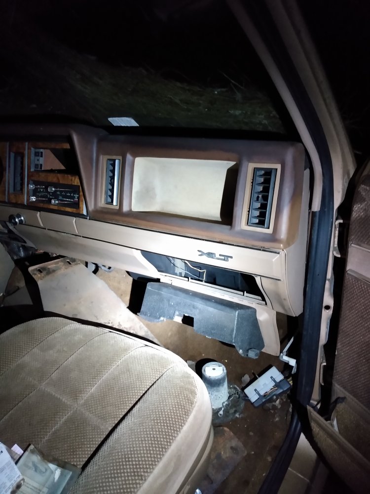

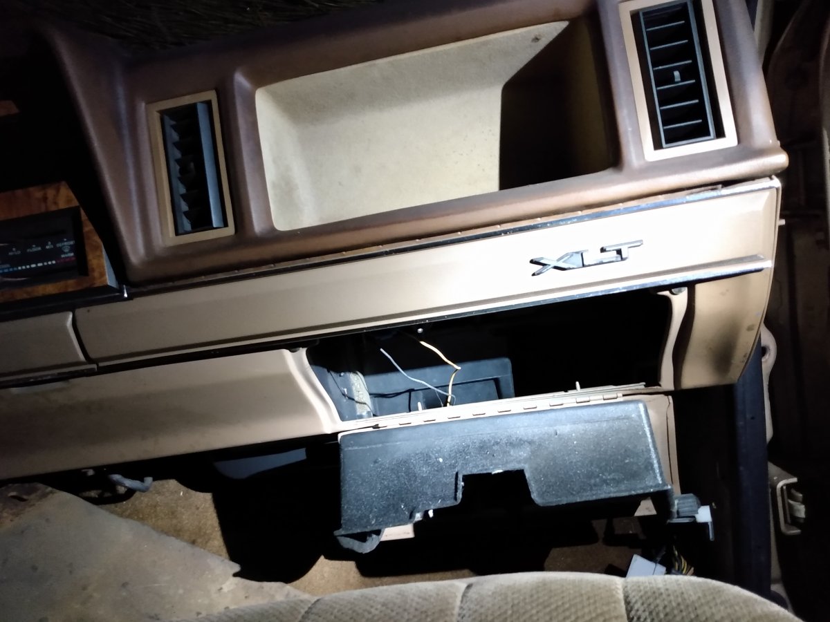

I also need a new dash cover and this piece of trim missing over the glove box. Anyone have an extra piece of this trim laying around? I can paint it
Will send pics when I get home spare truck has a tan interior but it's an 88 not sure they are the same? I'll get you some pics.

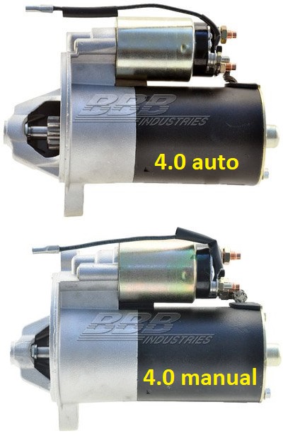

I just pulled these pics off RockAuto, there are two 4.0 starter variants depending on if you have an auto or a manual. Note how the drive gear snout sticks out further on the auto and the gear itself is recessed into the starter housing on the manual. So what I am saying is, the 4.0 starter will work as long as the snout length matches what came with the truck in question.
4.0 starters that I have seen all have 10 tooth gears.

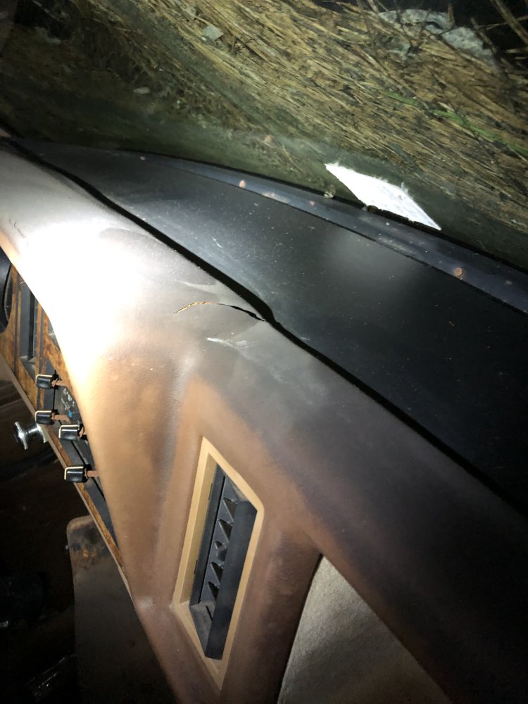

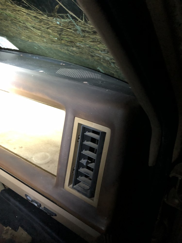

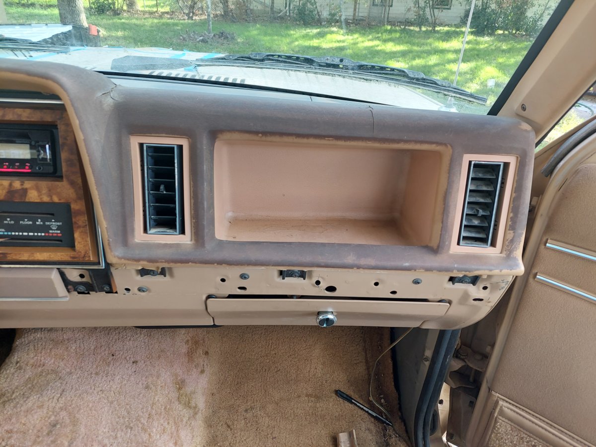

Is your dash pad cracked? Looks solid.
Can you send me a message with how much you want for that trim piece shipped to Nocona, Texas 76255?
So dash panel is in my truck DM on shipping tomorrow we can work that out. As far as dash pad. A few cracks nothing major not perfect.

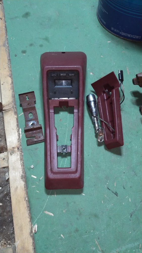

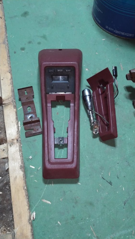

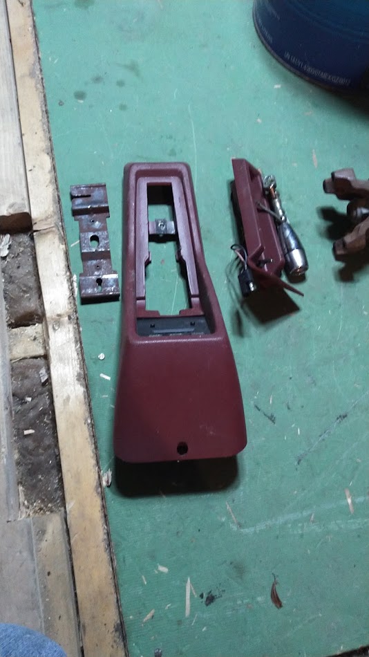

I think the bracket on the left is the Ranger single cab version but I'm sure you could make it work with a B2.
hmmmm.....
I'm trying to remember what the roof looks like under the headliner. Seems to me there's cross supports. wonder if I can just bend a flat bar to work?
For the first time ever I will go ahead an day it for ya: "too bad it says Ranger on it"

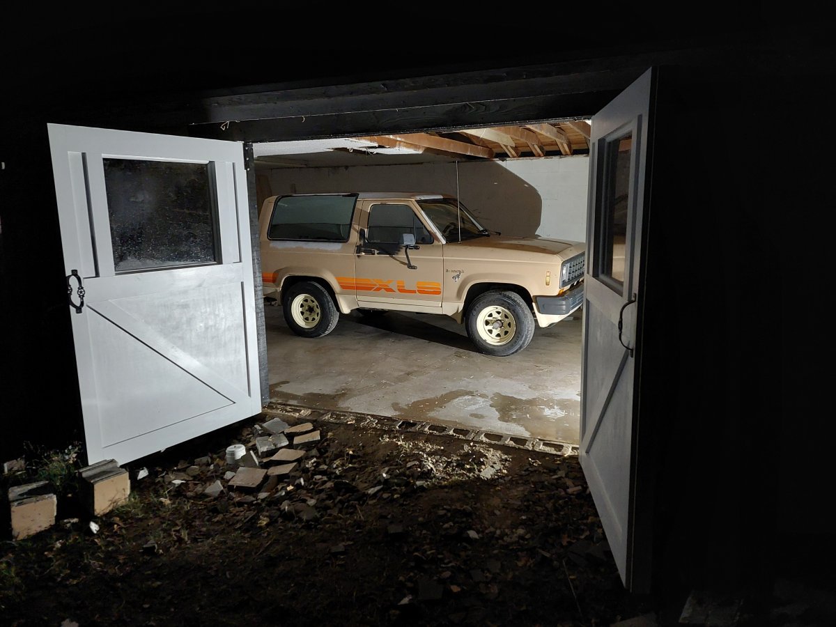

Strangly enough the first vehicle to get worked on in the TRS garage is not a Ranger.
