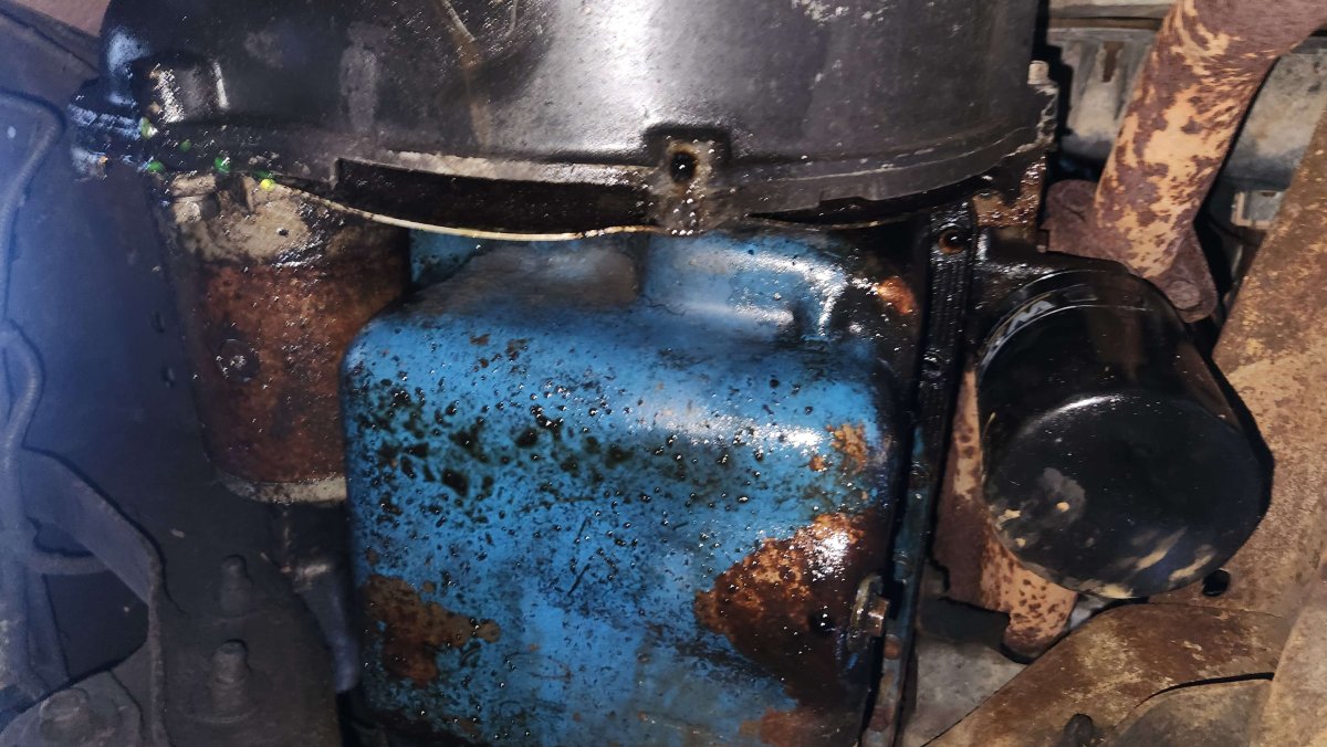

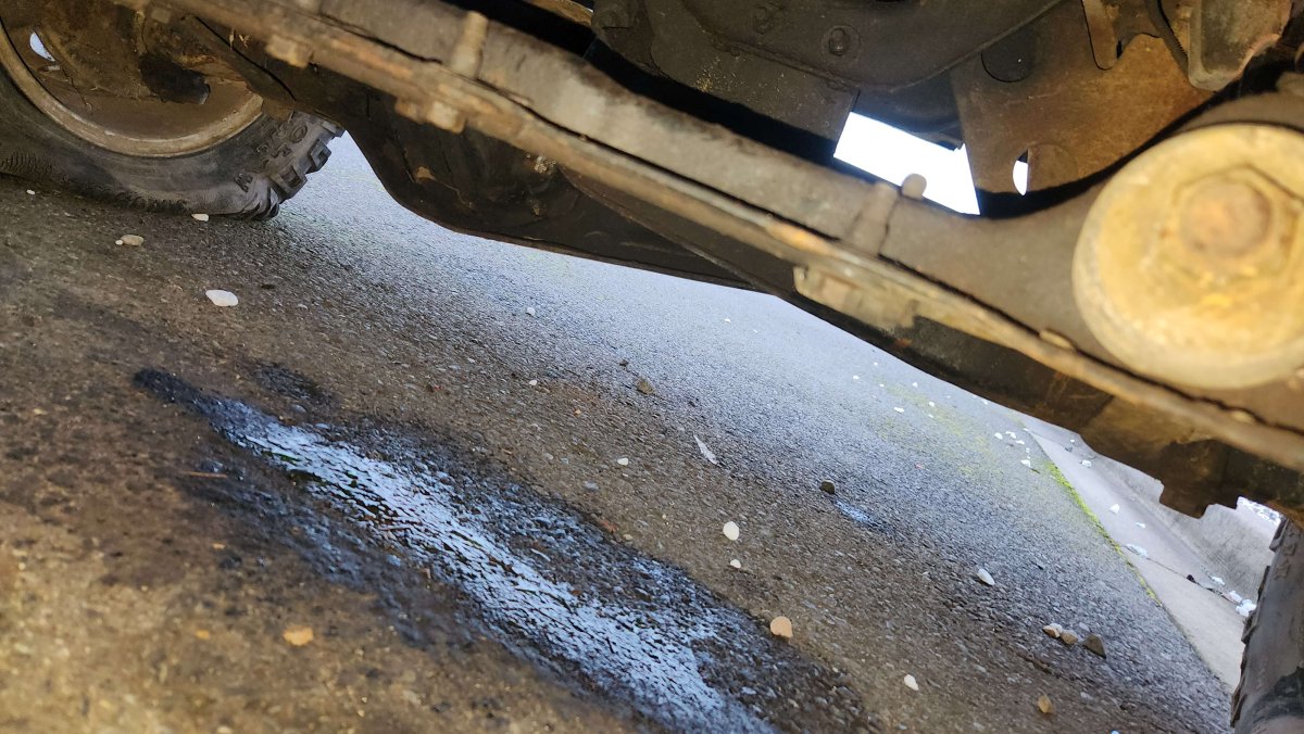

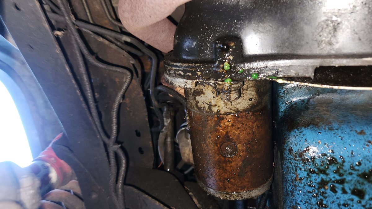

Hey yall, I bought a 1984 ranger a while back, shes just been sitting out the the driveway, but now that ive got her going, ive noticed a coolant leak coming from somewhere behind the engine, and the transmission looks damaged, id appreciate any help yall could offer as to what the problem is, and how to fix it. Thank you very much for any insight.

On my '84 the freeze plugs are corroding through (still the originals). Several are dripping, and not looking forward to it, as I might as well pull the motor and do all of them.
There are freeze plugs on the ends of the heads that'll make coolant drip from where your pic shows. Mine has a leak there too.
I think that there's coolant flow through the intake manifold, so that could be a possibility too.
>>> An inspection mirror would really help you get a look at the back of the motor to help you pin down the leak source. A couple of bucks, and it's a handy tool.
I'm not seeing where the transmission looks damaged.
There are usually freeze plugs in the back of the block. If you pull the engine I'd replace every one of them on the engine while it's out. The cost peanuts compared to the damage overheating will cause.

as far as the transmission, its missing a bolt, and the bottom of it looks chipped, and bent

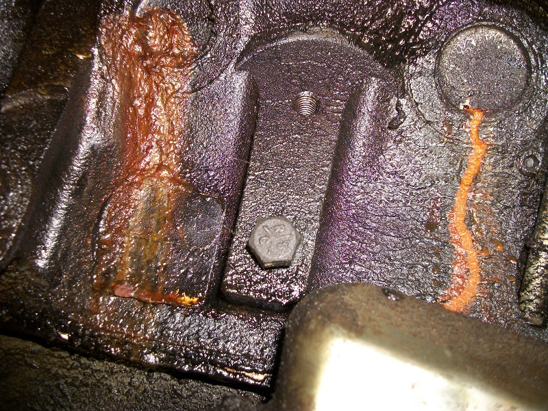

First, you should try to confirm what exactly is leaking. And also look at all of your other freeze plugs too. Here's what they'll look like when they're "weeping":
1984 2.8 V6 with a coolant leak, and some tranny issues, could use some help
If the one on the back of your block is leaking, you'll really need an inspection mirror to see it, and it'll damn near be impossible to get to it, to pop out the failed one and drive in a new one. If the old one could be pried out with the motor in place, an expanding rubber freeze plug replacement might work.
