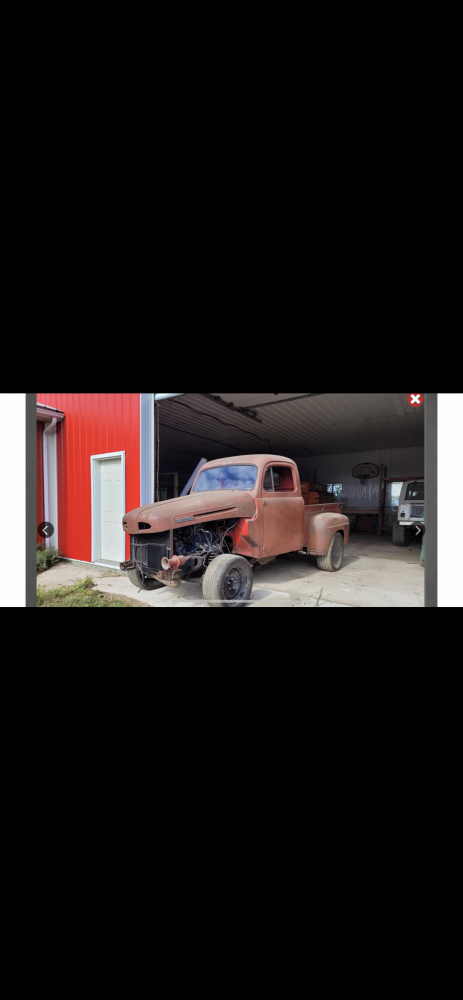

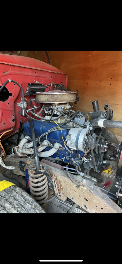

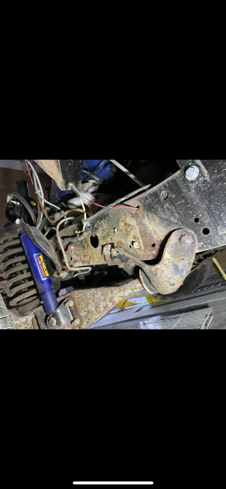

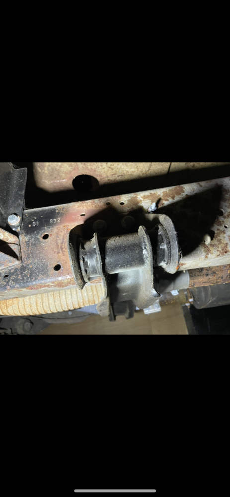

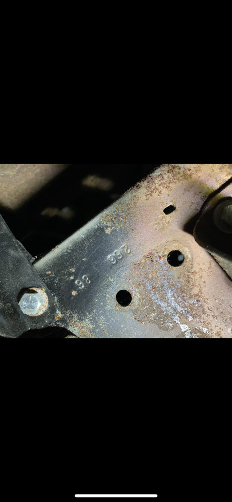

Hi I recently purchased a 1948 Ford F1 truck sitting on I believe a mid 80’s possibly 1986 Ranger frame. The 48 truck body glove box VIN plate is missing so I am trying to locate the Ranger frame VIN number to try to get the truck licensed here in Canada. Any help in finding where to search would be appreciated, the truck is using a 302 motor and unfortunately the woman I bought it from knew nothing really about it as it was her husbands project truck and he has passed away.

The f150's were on the passenger side on top of the frame, behind the front tire right where the frame starts going up to the front suspension. Not sure on the rangers but it would be a good place to start looking. Since they are stamped by hand on the line, they can be faint and hard to see. And it will only be the last few sequential numbers as it went down the line, usually not the full VIN.
Thankyou I will have a look, I think I will end up having a number assigned on this but the more information the easier it will be Thankyou

I have never seen a VIN stamped on a Ranger/B2/Explorer frame. Lower left corner of windshield frame and on the driver door data tag are the only places I'm aware of. @honda34dad are you missing both of those?

Only other option might be the build sheet under the passenger side carpet if it's still there. Not sure what to tell you... there are plenty of vehicles out there that only have the VIN number in one location. My rule of thumb is anything that doesn't have a title is a lost cause.
Unfortunately in my case with the Ranger I only have the chassis and it is under my 1948 Ford F1 body, odd that there isn’t more identifying marks like most of the 60’s fords there are numerous places to match numbers etc
