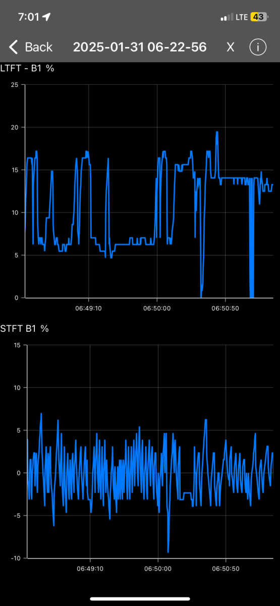

I would probably attack this more from a diagnostic than a throw parts at it and see if that fixes it (aka 'parts cannon')... grab yourself a v-linker v gate obd2 cable ($30-35) and a copy of forscan (free download)... and see what your live fuel trim is doing (while running), that will diagnose an injector issue and rule out some other issues.

this is what the fuel trim looks like. And it’s all factory stock tire size and stock ride height.
