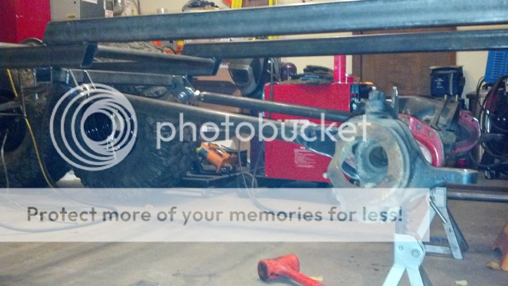

projects looking good, Im just having my doubts about that 44 holding up to 39.5" tires
It's gonna be light weight, low power, I bet it will hold if he drives it right.
I believe it will make it for a while, he's not really known to drive with a real heavy foot...
SVT
A guy i wheel with runs a 44 on 39.5s in a full bodied explorer 5.0 without problems. he may have aftermerket shafts though
Me too. Could have gotten something like a q78 but I just would of went bigger down the road.
And 13" of diff clearance won't hurt either.

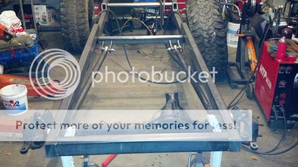

Looking good!!!
I have seen a few light weight low HP rigs on a D-44 but they were running smaller tires... I would stick with 37" and a shorter wheelbase.

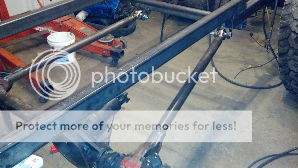

I bet $1.00 amercian that the ball joints will be the first major failure. (imho axles are not major)
That's too bad, 10" or 12" co's is what I'll be looking for when I sas my Trac. But its looking good...

Only have a few hours at a time to work on it but I'm trying to stay on it.

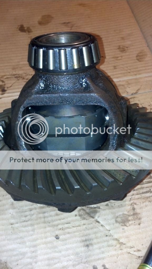

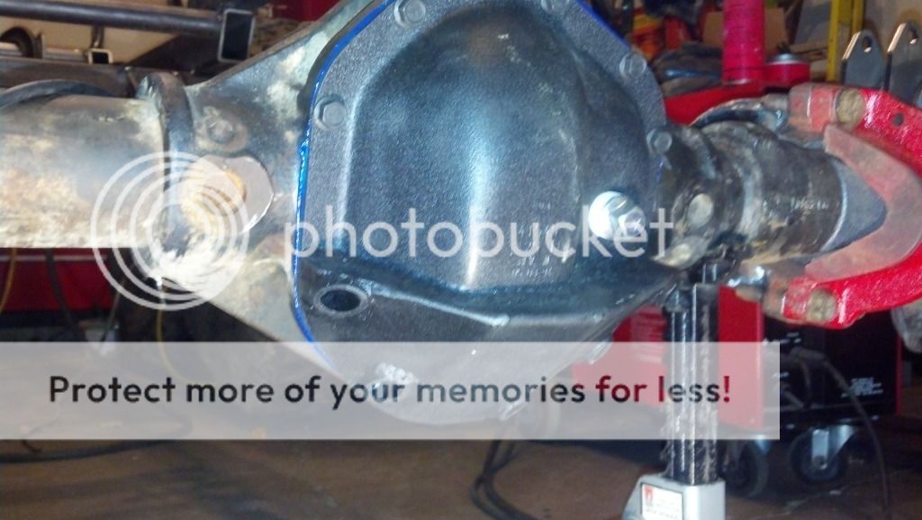

Tonight I installed the 44 Spartan locker and put the diff cover on so the rtv could dry.

What diff cover is that?
SVT
Hmm, Kool...
SVT
i agree, that diff cover is sweet. might have to try a home built one
