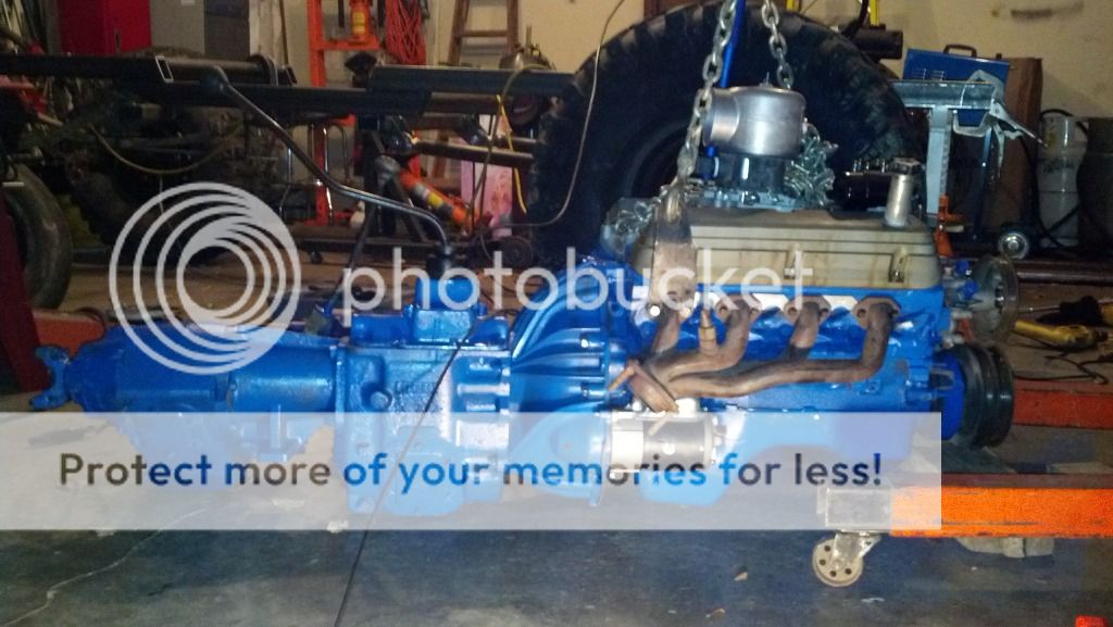

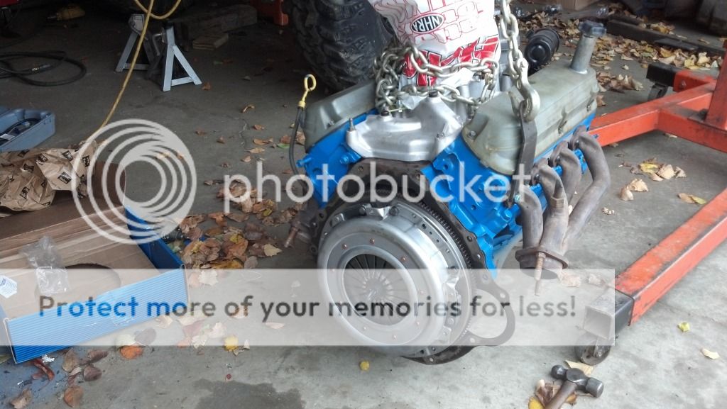

Got the flywheel and pressure plate on but broke the shift fork and can't get another one until Tuesday.

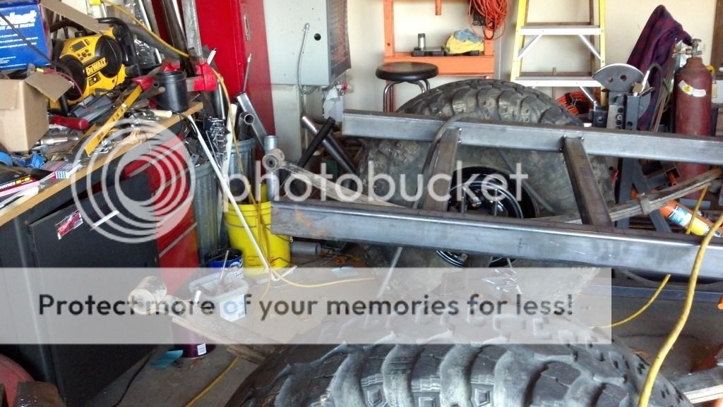

I think your missing a couple shackles :D
