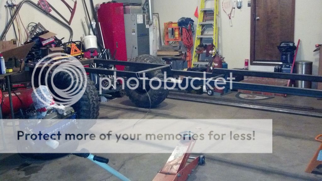

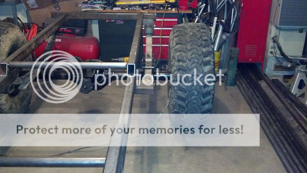

2x3x3/16 for the frame rails. The rest will be mostly 1.75 dom with some 1.75 and 1.5 hrew
I have almost all the parts. Just need to get a front locker, pedals, and steering linkage from the box to the steering wheel. Also need to pick a winch for the front, I bought a 5000 lb for the rear and was thinking of putting the same thing on the front but they might be a little small for the front. But if the front gets too heavy I wont be able to use the air shocks I already have because they are only rated for 800lbs each:dunno:

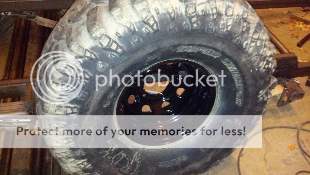

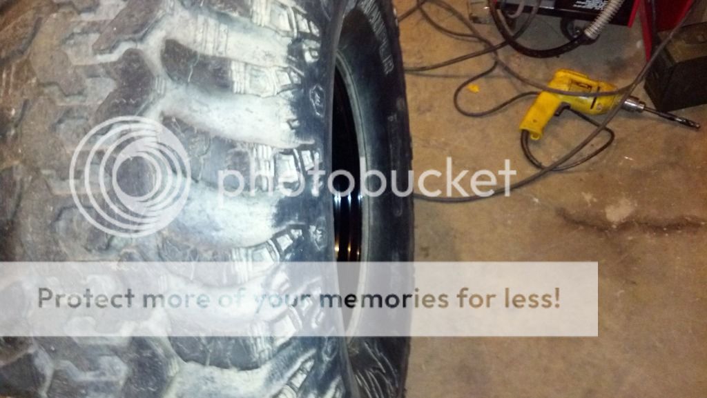

Mounted one of the tires by hand. Had to go with reverse offset 2.5" backspacing so these wide tires would be able to turn without getting too hard into the radius arms. But it's going to be wide, about 83.5-84 outside to outside on the front axle.
Beadlock it to make the rim a little wider. It'll make the tire form better to the trails :icon_thumby:
SVT
SVT
It's not a good ideal to beadlock a reverse offset wheel because the tire has to be put on the wheel from the backside.
Most rigs with this tire (39.5/13.50/15 Irok) I could find by searching run a 15x8 with no beadlock. 76lb tire and 24lb wheel 100lbs per corner isn't bad for 39.5's.

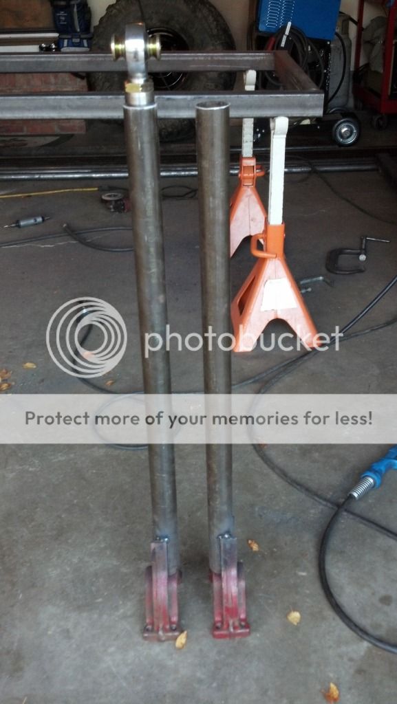

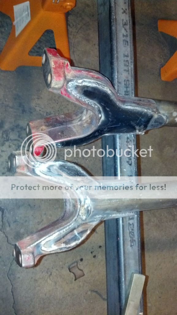

Started on the radius arms. Still need to plasma out some 3/16 to tie it together better but I offset the tube to one side for more tire clearance. 45" to the center of the heim.

Thanks, I'm trying to knock it out but I spend most of time with a tape in my hand trying to decide where things are going to be. Like those arms, needed the crossmember between the trans and transfer case and the front axle just in front of the oil pan. I'll be glad when I get to the cage part of it.

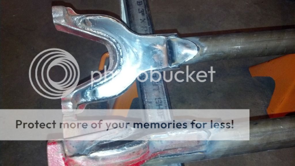

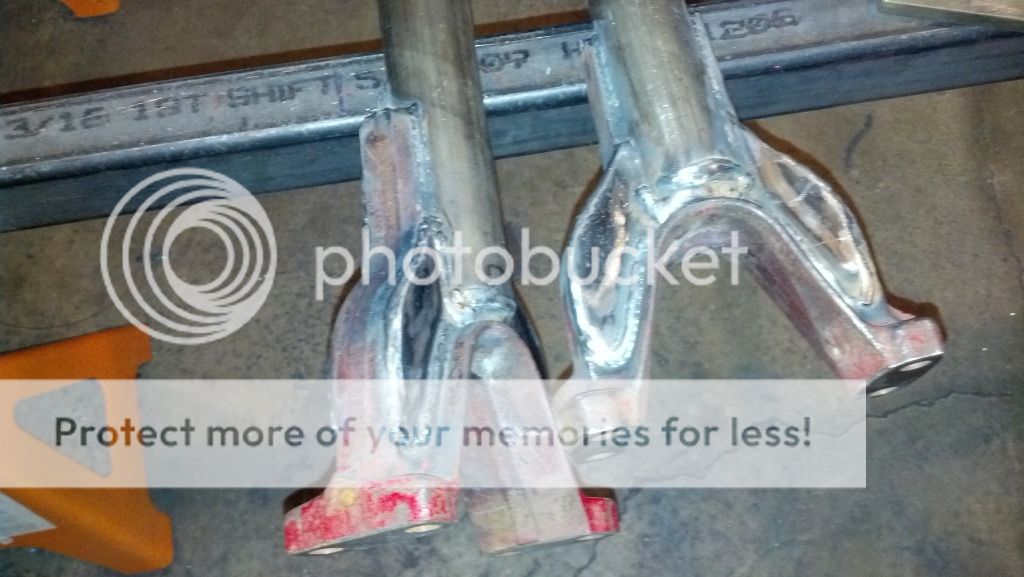

Welded some 3/16 on the end of the radius arms. Think that will be enough?
Had to do it different on both sides because the tube is offset to one side.

I like it! I'm curious... (Not questioning or anything just learning) Why would you build the suspension before the cage and motor placement?
