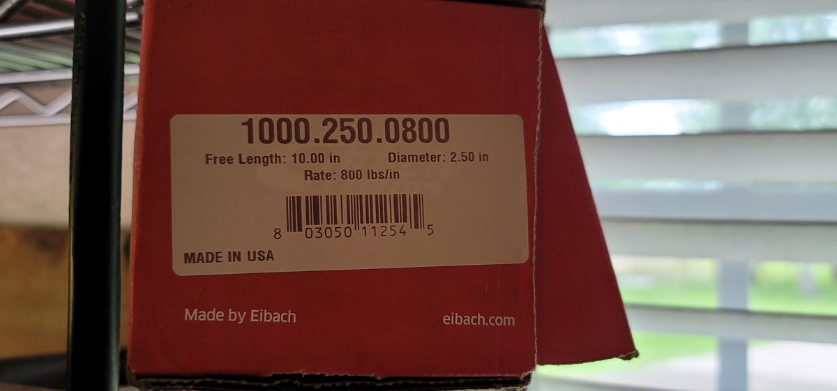

Eibach stocked nothing between 700 & 800 lbs. So thinking that the 700 pound spring would be too soft, I went with the 800 pound model. The spring preload is about 1.25" on the shock body. For a "2.5 inch I.D." spring, there must be another manufacture out there that would stock a 750lb/2.5" spring. The other adjustment is the shock nitrogen preload. I considered going with a "dual rate"spring setup, may still give it a try. Springs are cheap.
Right now with this coilover mod, the front suspension has gained 1.5" of additional travel. I had been having interference issues with the 31 inch tires rubbing the inner fenderwell, currently that problem is solved. So currently after some 5kmi on the suspension lift with these coilovers, I would say that they must be some more adjustment to make the ride a little bit softer. However, not wanting to loose much travel, I am considering adjusting (lowering) the shock preload pressure. Other that that, a winch & a pre-runner style front bumper will weight it down. Which is really the next step now that the coilover modification has proven itself out and the "cement truck" style of ride quality is gone. Getting ready to fab up some longer A arms. But sourcing longer axles are the issues here. There have been roomers of some longer china junk axles. I like to go fast, an old desert racer.

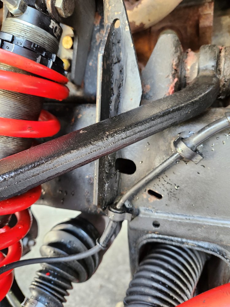

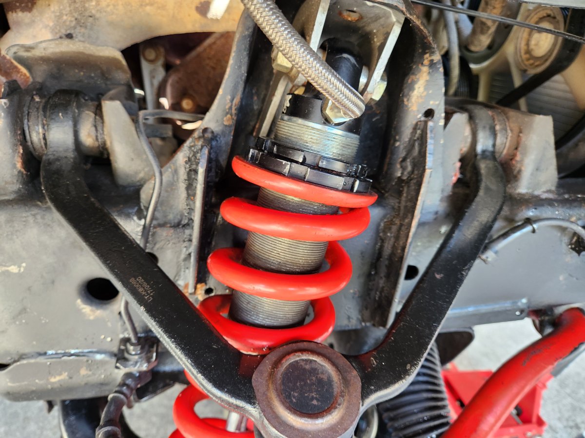

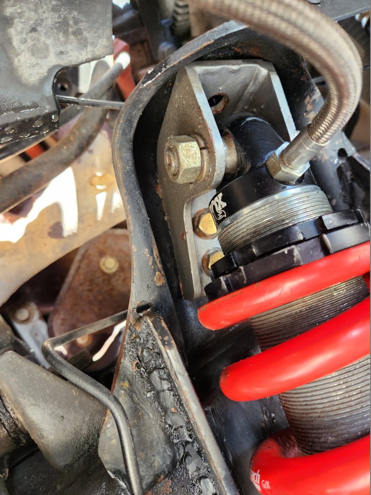

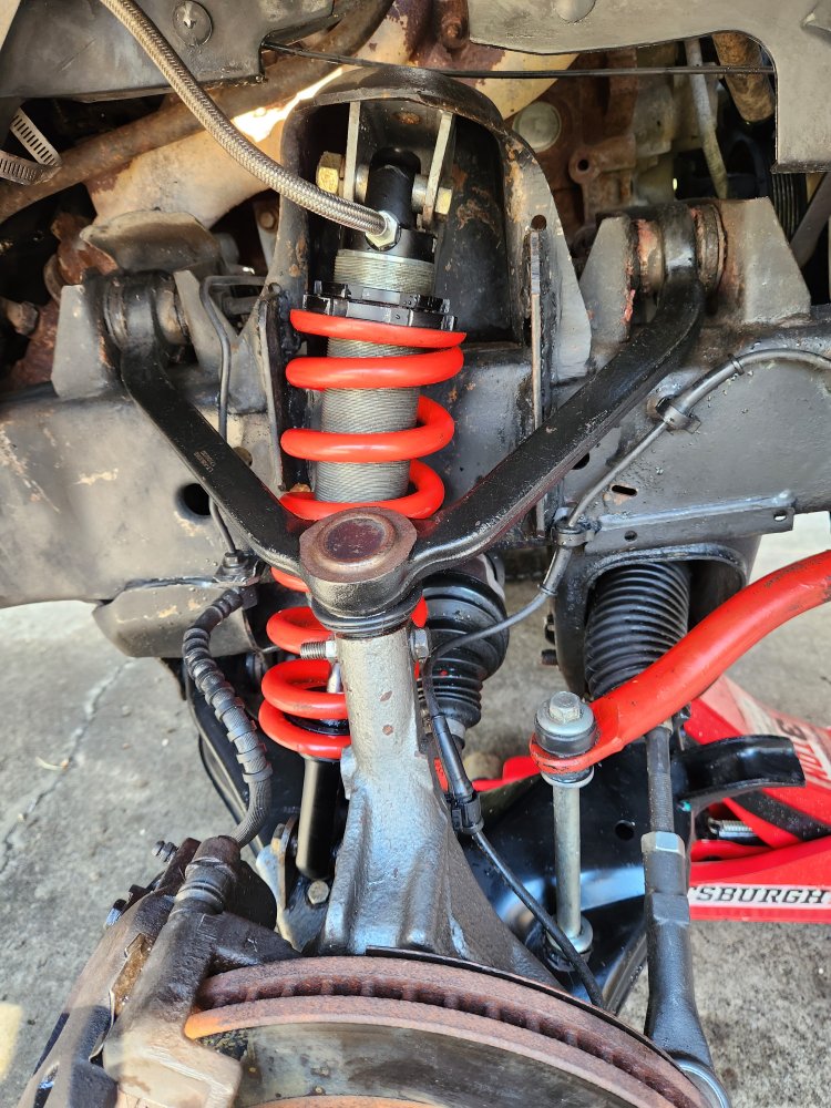

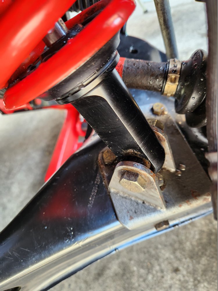

For some of you who have been asking, it's a lot easier than you think. I took a few more coil over pictures.....
Pic below: Notice the upper shock heim receiver available from some off road shops pre fab'ed. I looked on Kartek's website, did not see anything. If anybody knows who has these please post here. Google fails big time because "heim joint" makes them big china bucks I'm guessing they can't list the receiver because there junk. I'd not buy anything not made in the US for that use.

Below a pic of the lower shock mounting bracket-
These MIG welds were done with a 125Vac, 10 Amp "Hobart 190" is maxed out with 3/16" material so for this 1/4" steel, it took an extra pass. Looks worse than it really is. This mod has 9000 miles on it, so far no bad issues that I can discover. Perhaps one day I'll find another 4x4 ranger & put in something more substantial. Like a shock hoop and some longer A arms that can articulate much better. Now that there seems to be a somewhat reliable source of longer CV axles. I love to TIG CroMo tubing ! Makes these rat turds look like...real welds. I should of pulled the trigger on that $800 2004 4x4 that needed "a new motor".

Seeing your coilovers makes me want to get mine figured out sooner then later!
