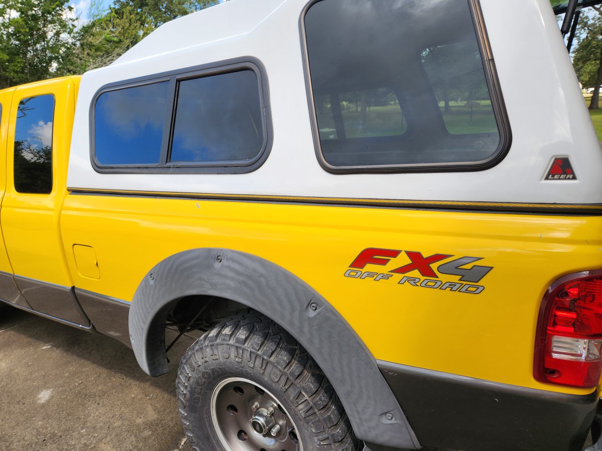

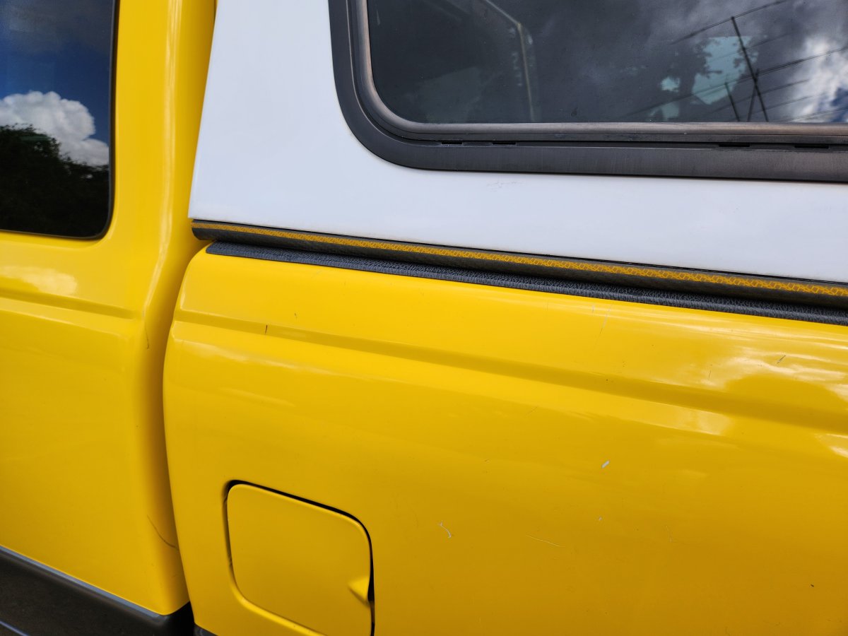

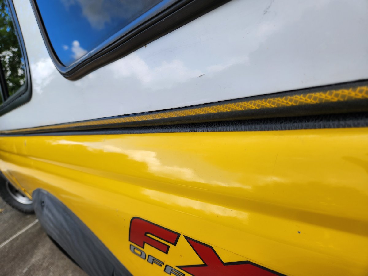

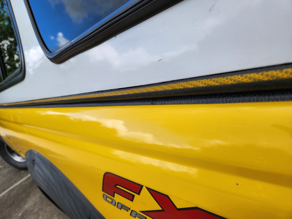

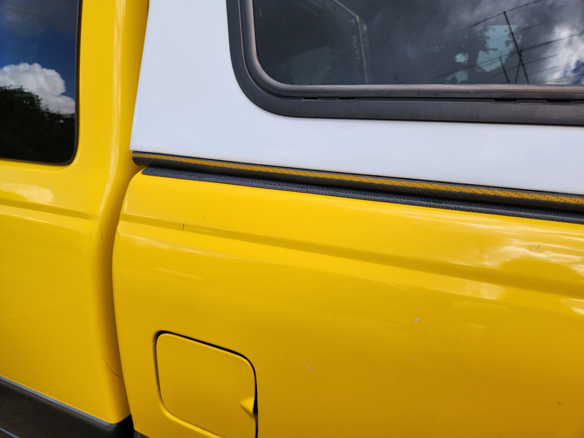

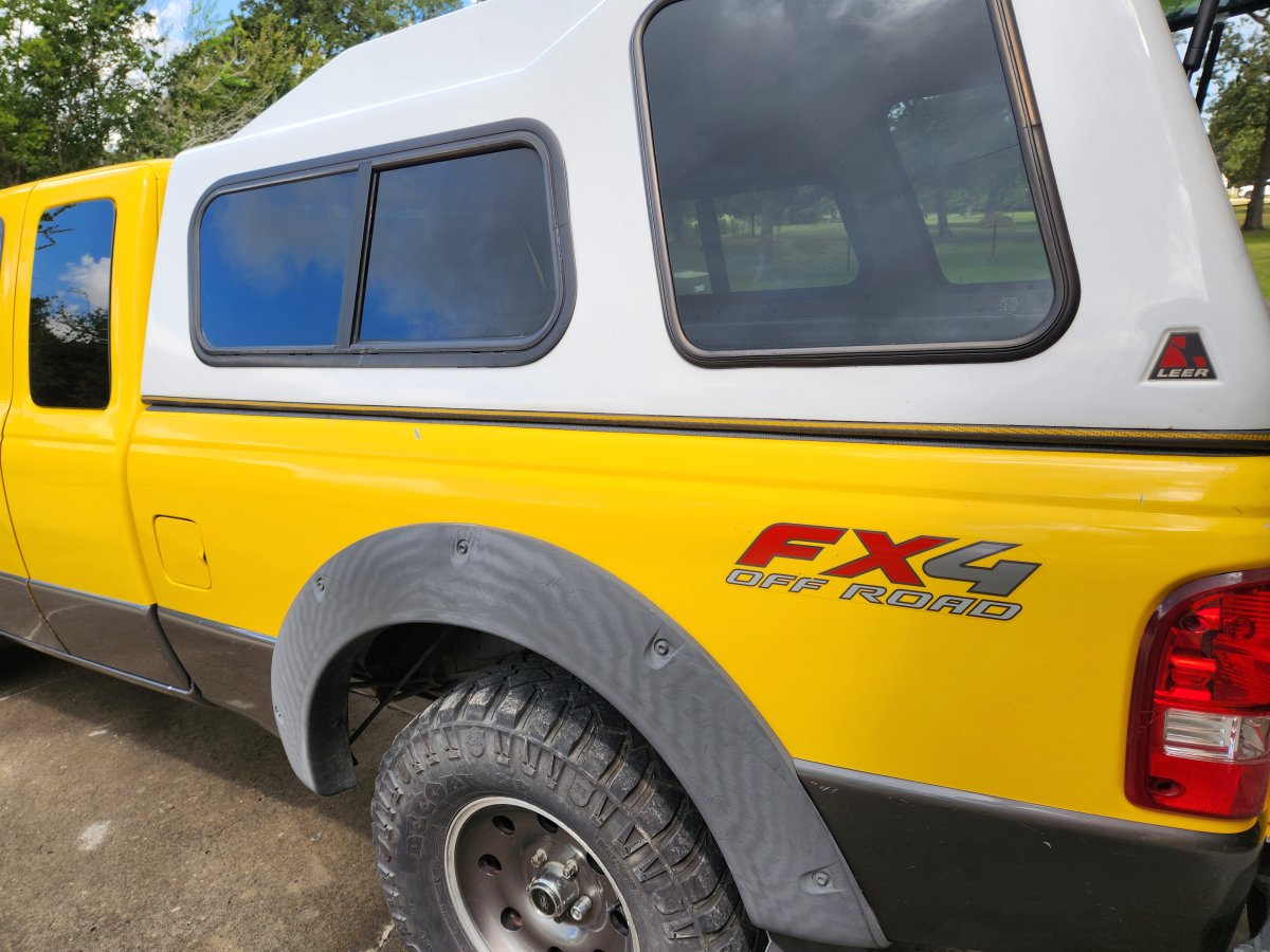

The bed rails of this style Ranger are not flat. They taper down towards the outside. The bed camper top has a flat shape that won't sit flush, so I needed to come up with some sort of gasket, not a typical topper gasket, something that has some height. The top's mating surface is totally flat and in contact at the inside, with a 1/2" gap at the outside.
Enter the color coordinated gasket.....
This is redneck as I've gotten in awhile.....
The bed rails of this style Ranger are not flat. They taper down towards the outside. The bed camper top has a flat shape that won't sit flush, so I needed to come up with some sort of gasket, not a typical topper gasket, something that has some height. It's totally flat and in contact at the inside, with a 1/2" gap at the outside.
Is that a length of plastic hose? Ingenious!
From lowes, extra section of "no kink" garden hose, better than the new stuff.

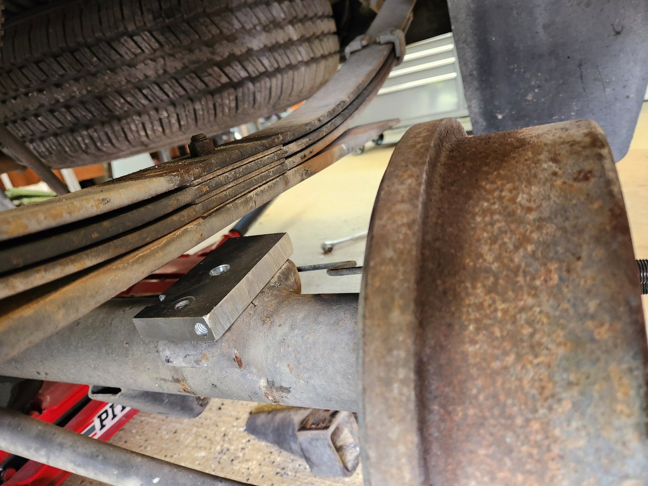

The rear had some new Ranchos, but were more for the stock height, and now I discovered a next longer set in their line up, so going to try those. The rear axle was being held in place by the older shocks limiting any further up travel. The stock U-bolts have an extra 1.5" so their plenty long enough for my almost 1 inch thick home spun spacer block. The locating pin size will be determined (5/8ths or 9/16ths) and installed.

Just food for thought on your rear lift. It's not a good idea to "stack" lift blocks on the rear. Also taller lift blocks lead to a greater chance of axle wrap.
If you need a bit more lift in the rear... lift shackles are a better bet IMHO. I put 1-2 inch lift shackles on my truck. At the one inch setting... no ill effects that I've noticed. I heard people having issues using the two inch setting... leaf spring will sometimes hit the exhaust.

If I can remove the rear stock block (comes OEM w/ a bump stop), I may just screw my new 3/4" block to the OEM one. Thx for the tip. I'm never hard on take off with this rig on the street~
man, colorado is so nice that time of year. its the perfec temp to go out and have fun exploring. i believe we are going to nebraska to see our oldest son since he should be back from his trip out of country

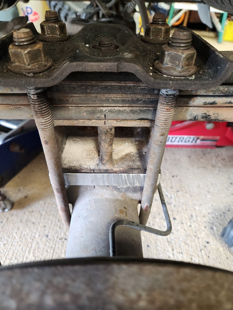

The front will stay where it is for now. The upper shock mount is firmly up at the very top of the stock shock tower. I thought the 2ea. 1/2 bolts were in shear, but the bracket is all the way resting at the top inside & bolted. The upper A arm is also very close to the upper frame rail when jacked up. I believe that is all I can get out of with what stock suspension that's left. If the front wants to go any higher, it will require different parts. Exactly what & when that will be if ever I'll see. She's good as she is. There is also a decent chance that if ever I find some decent 32s, the rear lift may lose the blocks and go with a new set of leafs as these are alright, just not 100% fresh, slightly sagging, not flat. Don't want a longer shackle as they will affect the depart angle and drag as the lower plastic rear bumper trim has burrs from the trail rubbing the bottom of the bumper. No widened deep dish cranked up mall crawler stuff allowed :)
The rear went well however > No change in the ride that I can tell with the short drive 1 mile down the road & back.
3/4 inch higher at the rear ready for some 6ea. 50lb buckets of rock.
Here is how it went down at the rear axle-
Keeping my original alignment lines-
Made sure to lubricate the U-bolts using a teflon pipe dope crayon stick.
