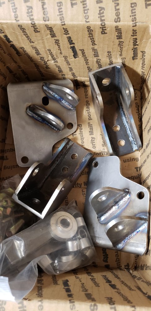

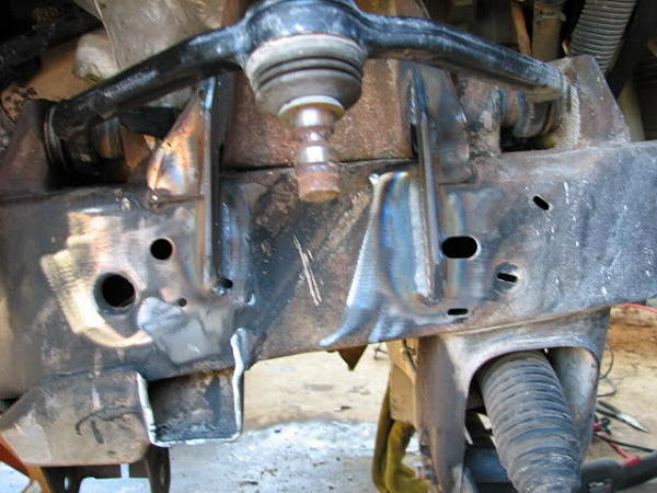

The gent retired from making the kits. However.....as you can see and read, hopefully you can extract what exactly I did. I would start with the shocks. And then shop for some already fab'ed shock mounts, which are out there. The upper is simply a closed heim mount, and the bottom is the same except the designer decided to wrap the lower otherwise flat "foot" around the edge. So the kit came with one of those "closed" mounts for the top, and flat type or "open" for the top of the lower A arm. The shock heim spacers you can get from any desert racing supply house, https://www.kartek.com/
The gussets are simple some cold roll plate, 1/4" thick x 3/4" x ~ 4 & 6" long. Or...you can show the picture.

The guy making these has retired doing any more currently. But like I mentioned, with the shock in hand you can see what has to be fabricated. It is actually ( I hate to say this) a "bolt on" modification. Except that the shock tower must be strengthened as shown. As far as the expected skill set, you should already know how to weld 1/4" steel. A 240v MIG machine would be required as my Hobart 140 required a few extra passes with flux core wire. I miss my Miller 350. Let me see what the shock PN was and I'll post it here. - Doug

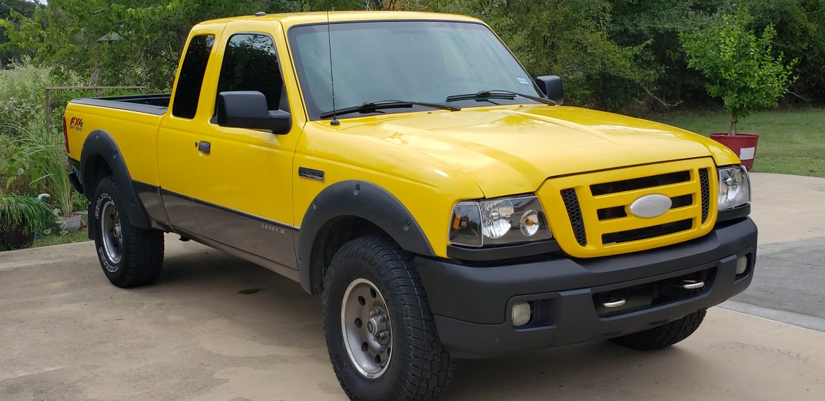

You all probably seen this in the into section. Looking forward to having this well used but not so bad looking FX4 Level II Ranger getting some upgrades. Starting with a set of Rancho 5000x shocks. Cheap $$. Don't know anything about these except the suspension really needs some attention. Waiting for the last one from UPS on this Sunday.
I was at the FORD stealer to get a set of new keys because my wife uses her fingernails to operate the remote buttons and the blister style button construction just does not like to be stabbed, as I included. Also, I inquired about what the FORD factory dealer parts department was asking for a new FORD emblem......$48 + tax. For the advertisement, should of been free. The whole crew never ever even heard of a level 2.
A nice looking truck. love the custom headlights, fender flares, and wheels.

Hey Lefty, It's all stock except for those headlights, the coilovers & the Chrome Zarape hangers. I get comments at the gas station, folks honking, and I just turned down an offer for $12,800, paid $7000 three years ago.

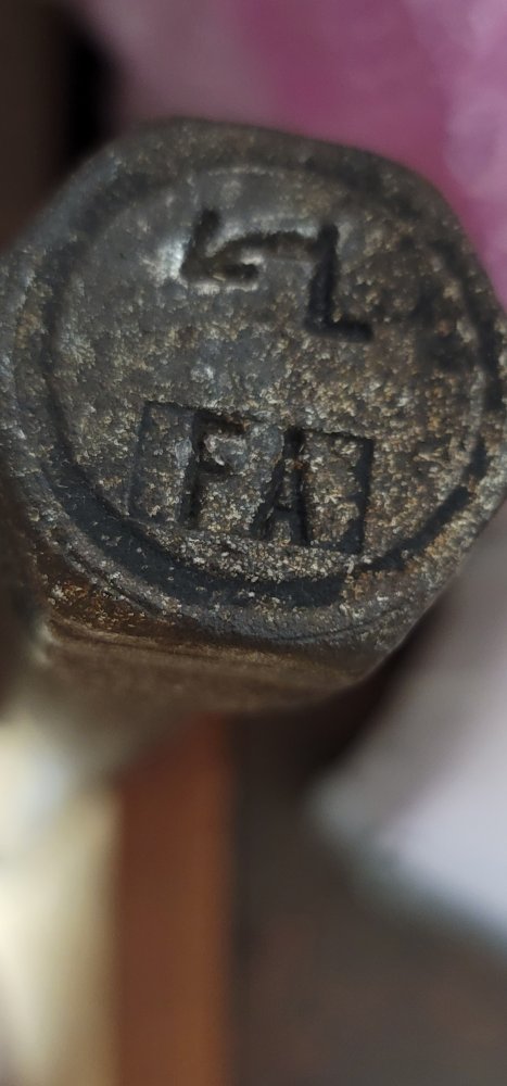

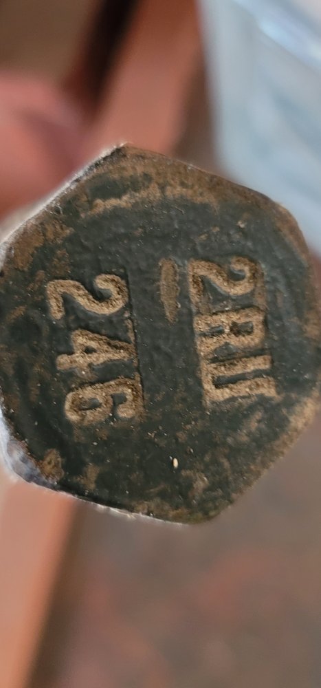

I guess I don't see a code 1 on that bar. Unless I'm not looking at it right. But I don't see a B or an F. Do they measure the right size?
I'll take them either way... they have to be bigger then my code F bars.

Uncle Gump, they measure, sure deal, 1.09" dia.
I see "FA" and the left notation with an arrow. The right bar also shows the "FA", and the right arrow. There was a sticker, but it's long
My #1 bars have FA stamped on it as well.

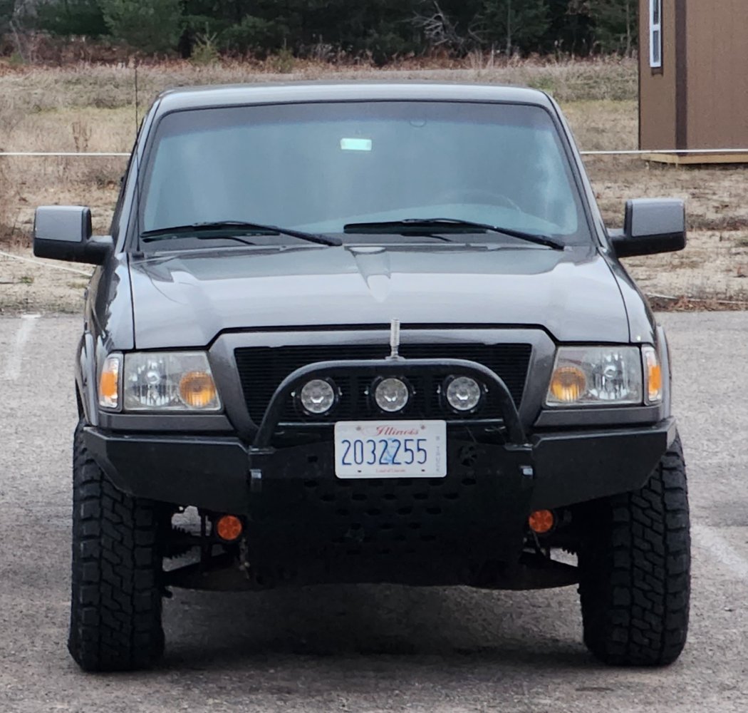

My truck with the bumper and skid plate adds I would guess 65 to 70lbs. It will benefit from the big bars... carrying the extra load and still a decent ride.

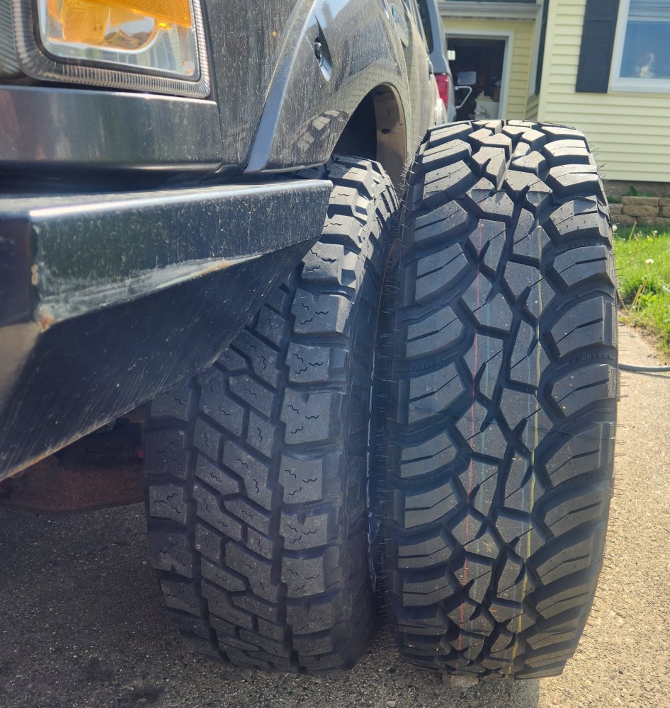

Gonna spend a minute tweaking them and calling the front suspension good. If I need more... I would probably do a one inch body lift. I want to be able to run these 33's.
You might get away with a T-Bar crank but I suspect you will need to go to a lift to get the tires to clear properly. The body lift might just be worth it to avoid getting a rough ride from too much t-bar crank.
Yeah... I have zero plans for maxing out the bars. I think you can favor the upper limits of the factory spec on ride height (m aybe even push it a little)... and still be reliable and not wearing things out.

33s? Dang, my F-150 can barely fit (w/ no lift except a 2" lift in front ) those Generals, Red Letter tires (there back). Dang they work great.
