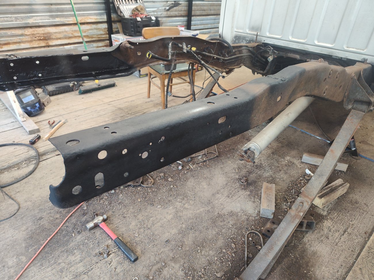

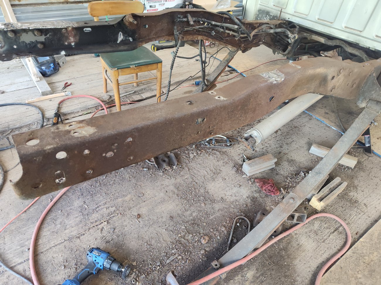

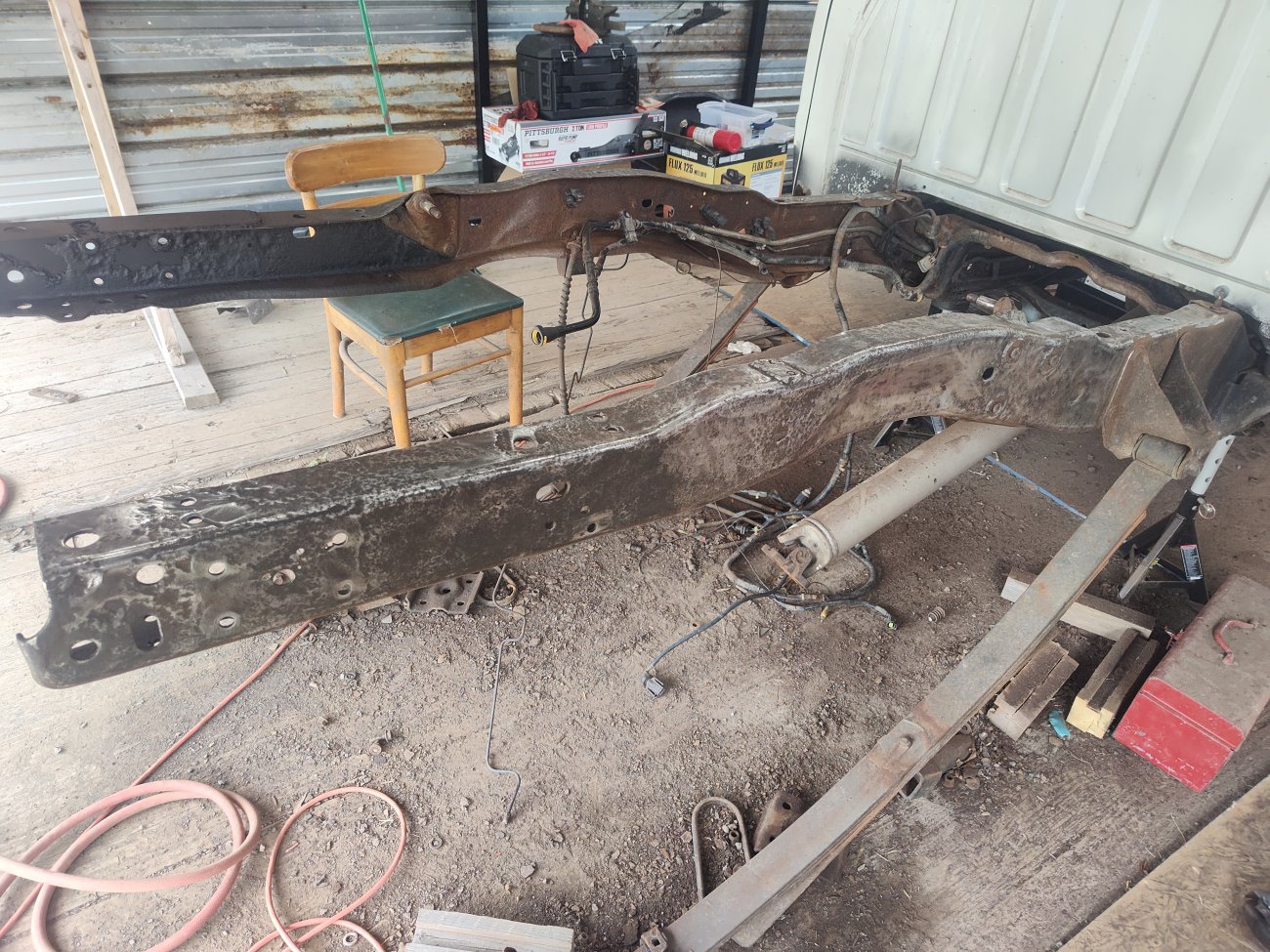

Frame descaling almost completed, its in pretty decent condition. The black paint is rust converter/primer. I will be treating the whole frame again, but bare metal gets priority.
I also realized my parts truck has a tow hitch, so that's one less thing I need to buy! But I still need to learn how to wire in a 7 pin plug for my camper. Trip is in 6 weeks. Hoping this truck is out of the garage in 3 weeks or less.

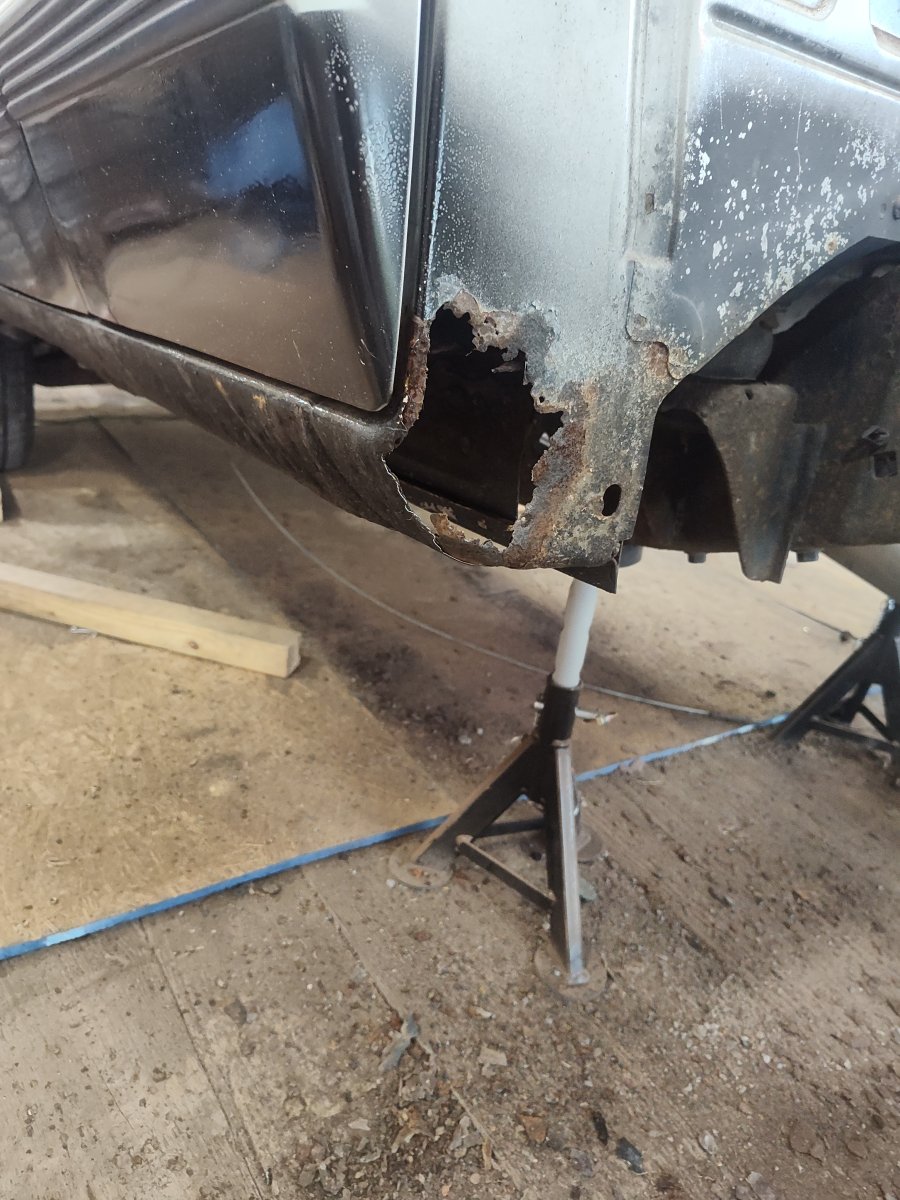

Found this suspicious spot on my cab corner and investigated with my stupid tools, 2 seconds later.... Luckily I have a dryer I'm trashing, so I have sheet metal lol.

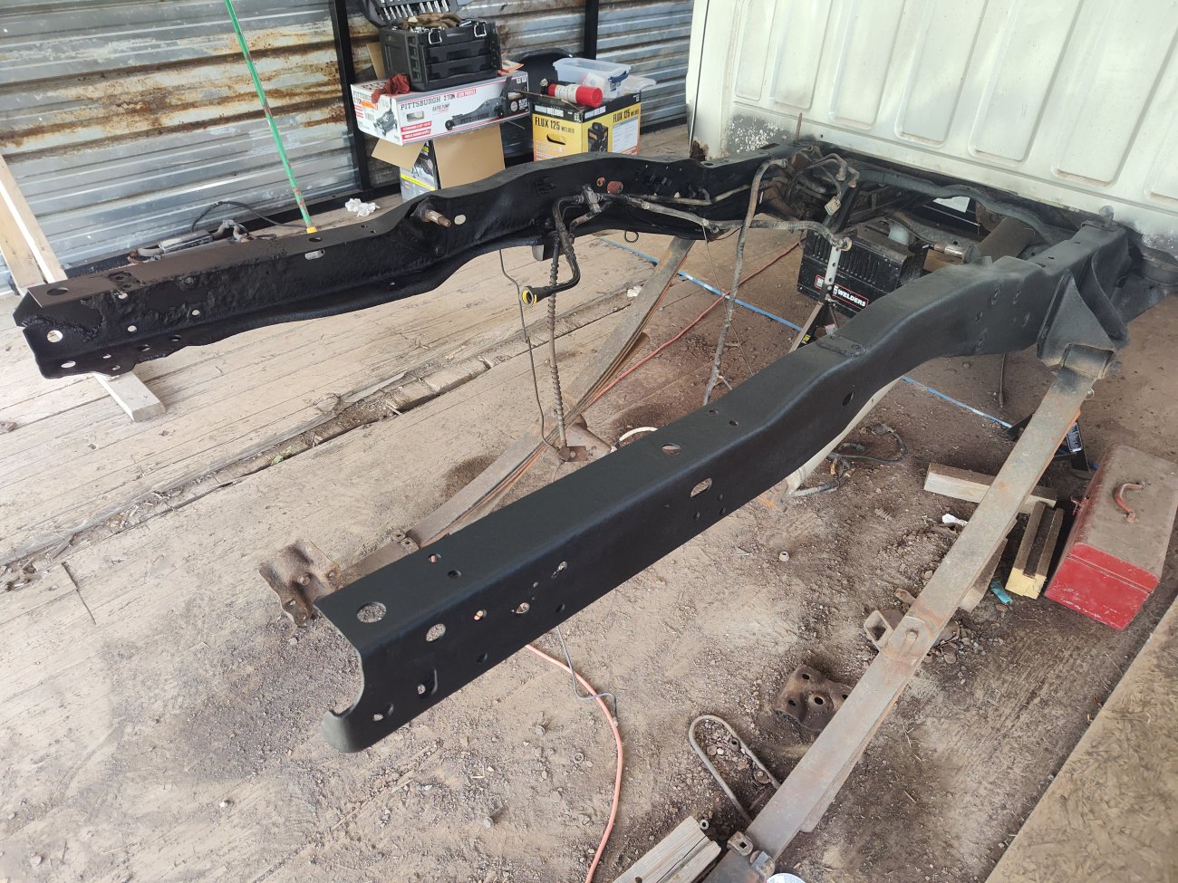

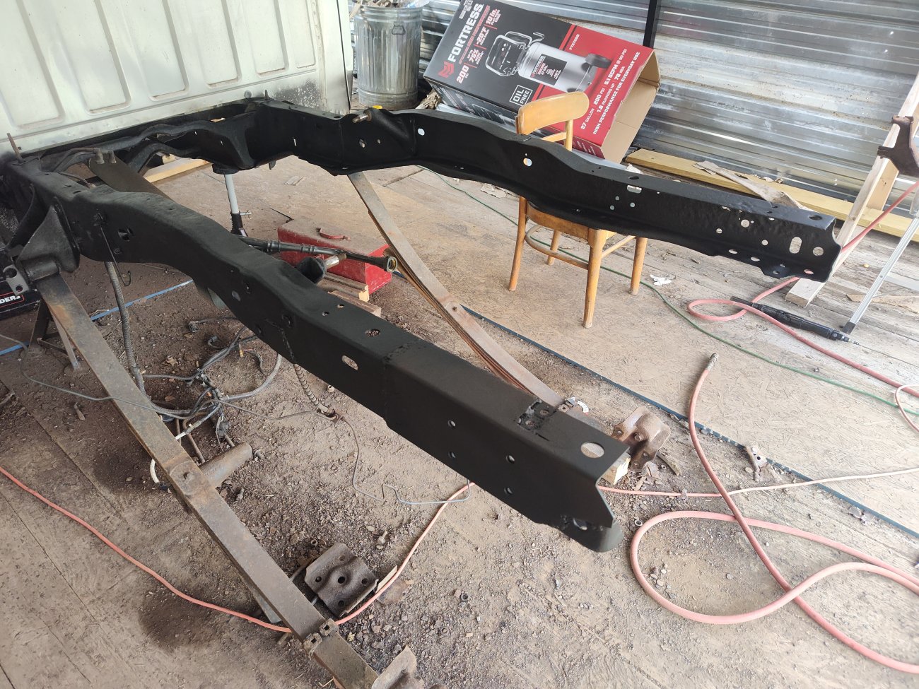

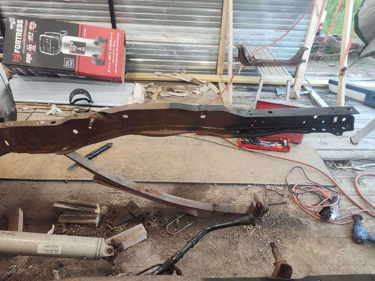

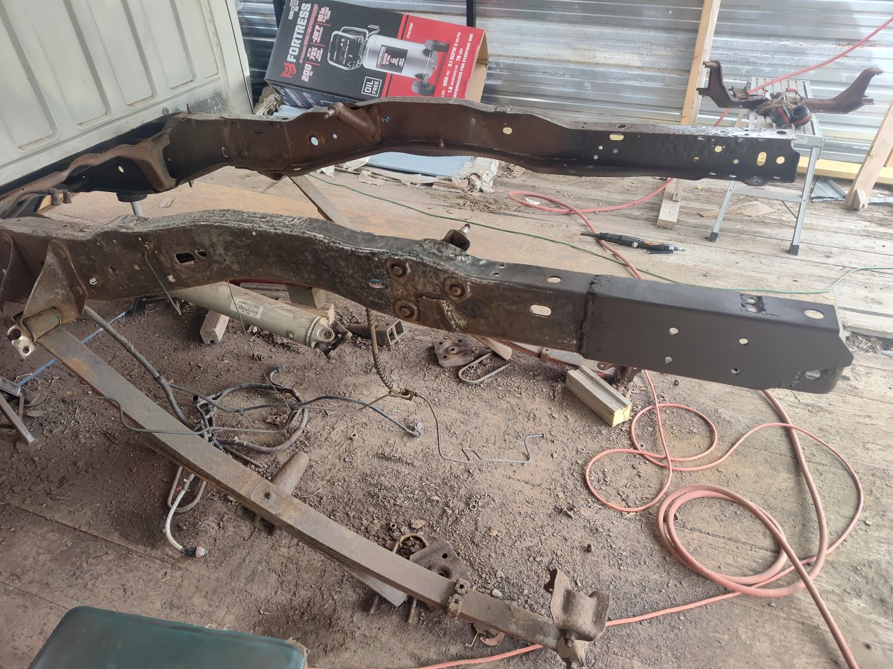

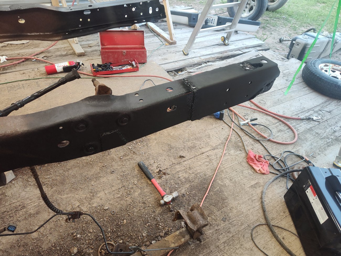

I'm pretty sure I made that quote somewhere on here, but yeah. Pretty much. Speaking of, I'm done with the frame rails!
06 Frame Repairs
06 Frame Repairs
06 Frame Repairs
06 Frame Repairs

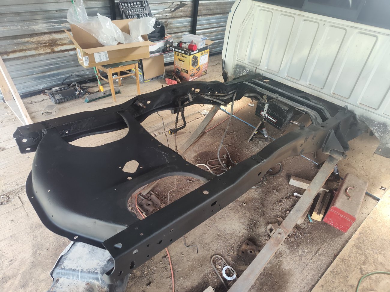

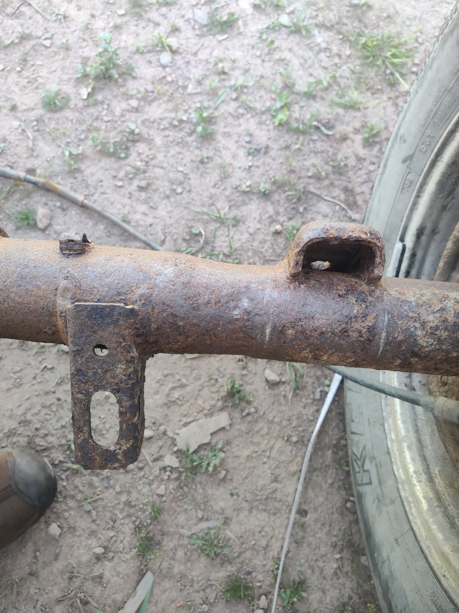

Now I'm bored.... I am waiting for the forward crossmember to come in next weekend, and all I have left to do is paint the frame (that's just primer/rust converter) and paint the replacement axle (also service it, but I'll wait till it's under the truck).
The taper of lost metal on the replacement axle is much better than the other. 1/32" loss. Which is almost nothing.
I spent the last hour only removing scaling rust from the axle, mainly the diff, it's pretty much ready for a service and repaint. All of which may happen next weekend or the following.
That's all the work I'll be doing this week tho, I'll be doing a bit more on Sunday.
