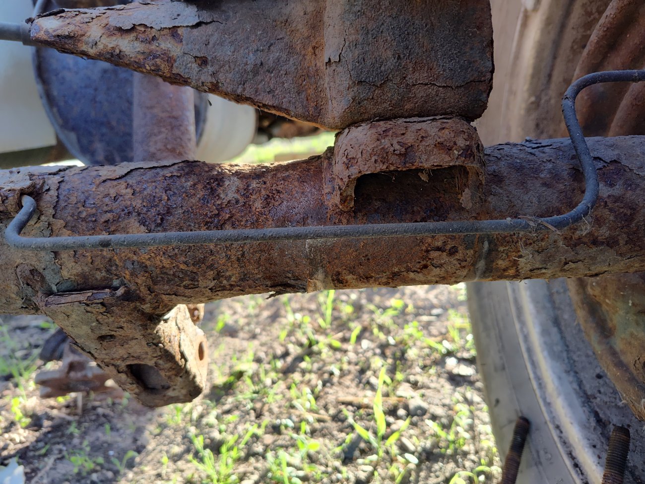

I got the bed and the u bolts off the parts truck, as well as the shocks and driveshaft. Unfortunately the 3.73 rear in the parts truck has the same rust damage as the 4.10, however it's only rusted down 1/32, vs the 5/32 on the 4.10.
Is it rusted away, or is that just where those axles neck down. The tubes aren't the same diameter the whole width, they get smaller inboard of the axle perches IIRC.

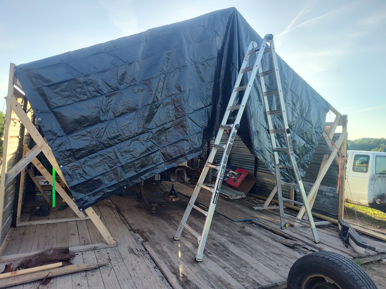

My clapped out garage is getting there. That's a solid $80 hobofreight tarp, because my roof was a colander lol.
I dub this garage "The Shanty House".
It's actually rusted down. That's where the sticker was. I removed a ton of rust to inspect it.
My parts axle isn't much better, but definitely has more tube wall left. At least enough to where I call it safe for highway and light towing. (I had a senior mechanical engineer look at it for me too).

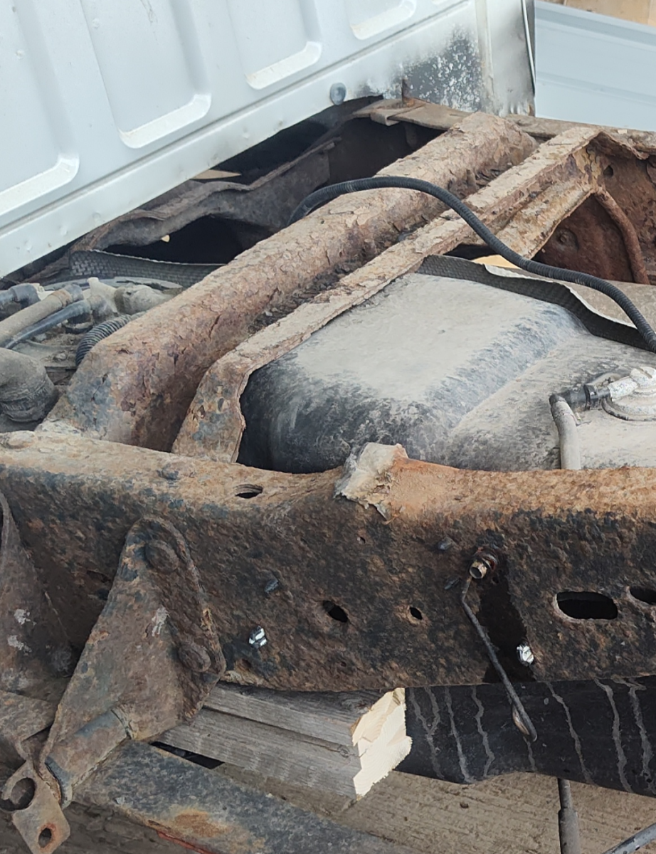

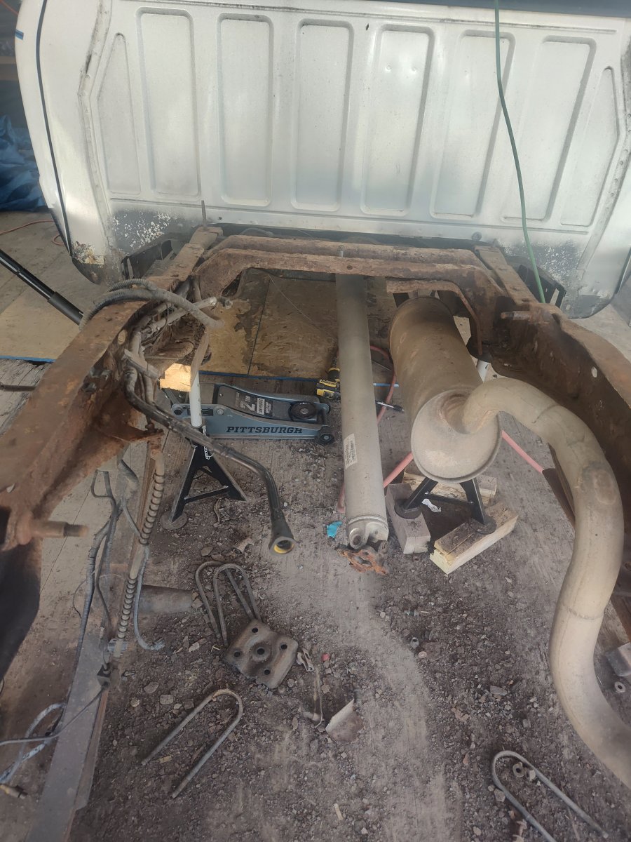

Removed the gas tank, rear strap is messed up. Prob just going to weld it and reinstall.

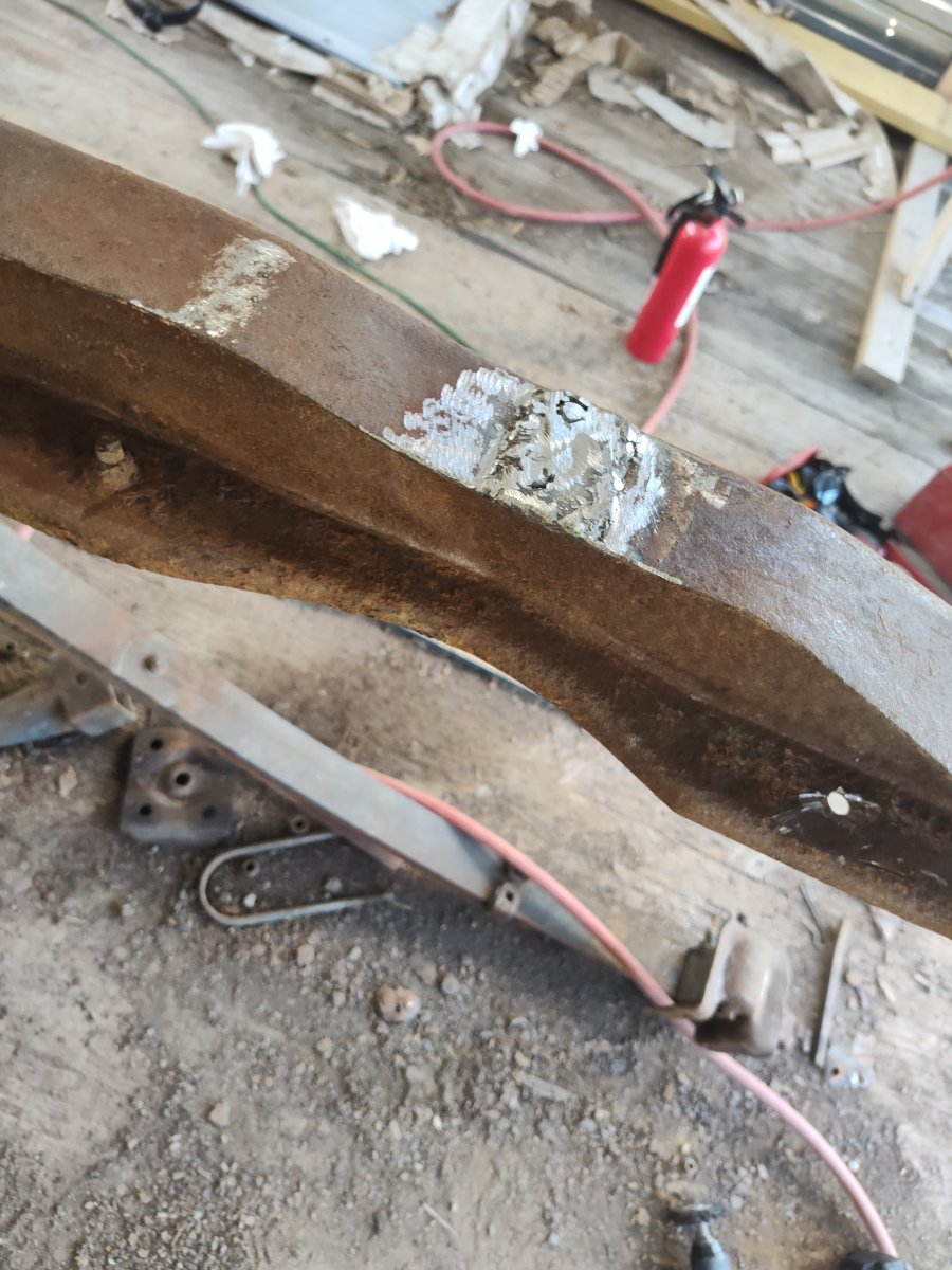

I just got a Chief needle scaler from hobo freight, replacing my $40 cheapo from Advanced Auto that spilled its guts.

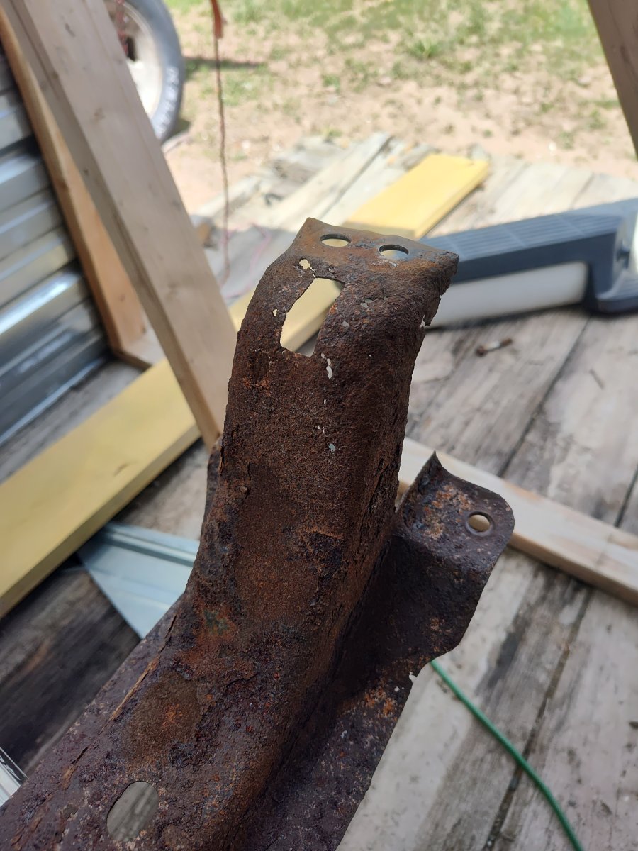

Heres a before condition.
06 Frame Repairs
After 5min of work, my old one would have taken 30min to do this. No rust holes, nice and thick metal too

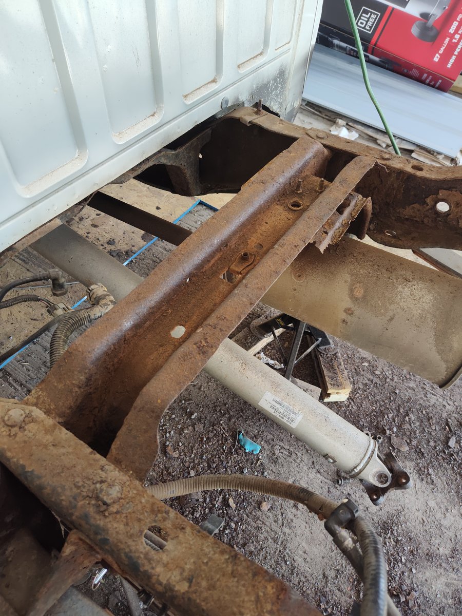

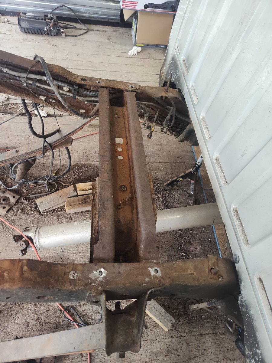

Due to the condition of the bottom of my crossmember, I purchased a new one lol.
Unfortunately it'll be a week before it gets here, cost me a solid $118 after shipping from eBay. Also cheap shackles/mounts (cheaper to buy with mounts too for some weird reason).
I really like the air chisel I got. It's cheaper, but is a game changer for removing frame rivets. Between a cutoff wheel and air chisel, it's a cinch.

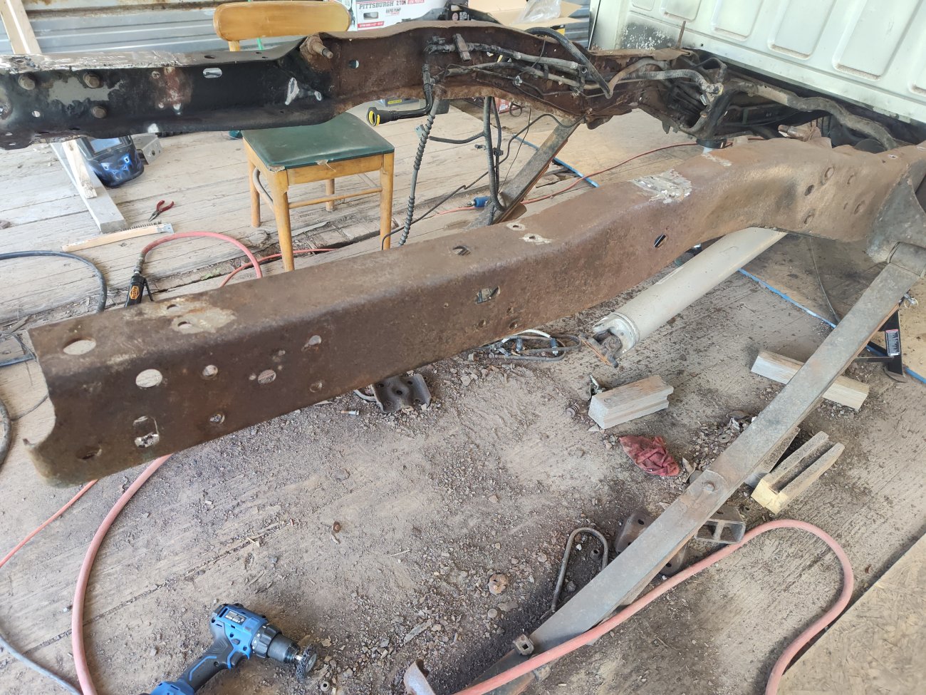

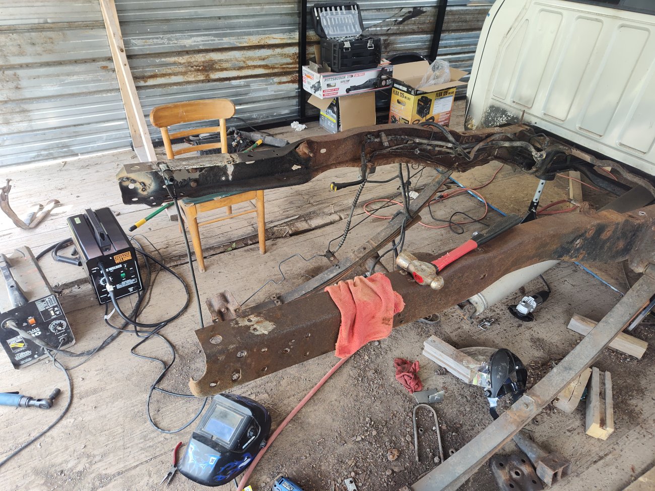

Frame cleaning is going well, that needle scaler works wonders.
06 Frame Repairs
6/8 rivers removed from the crossmember. Using a grinder while on your back sucks....

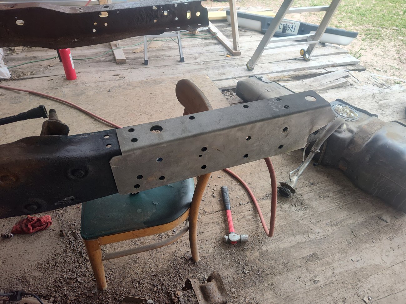

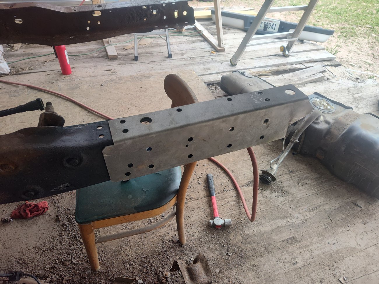

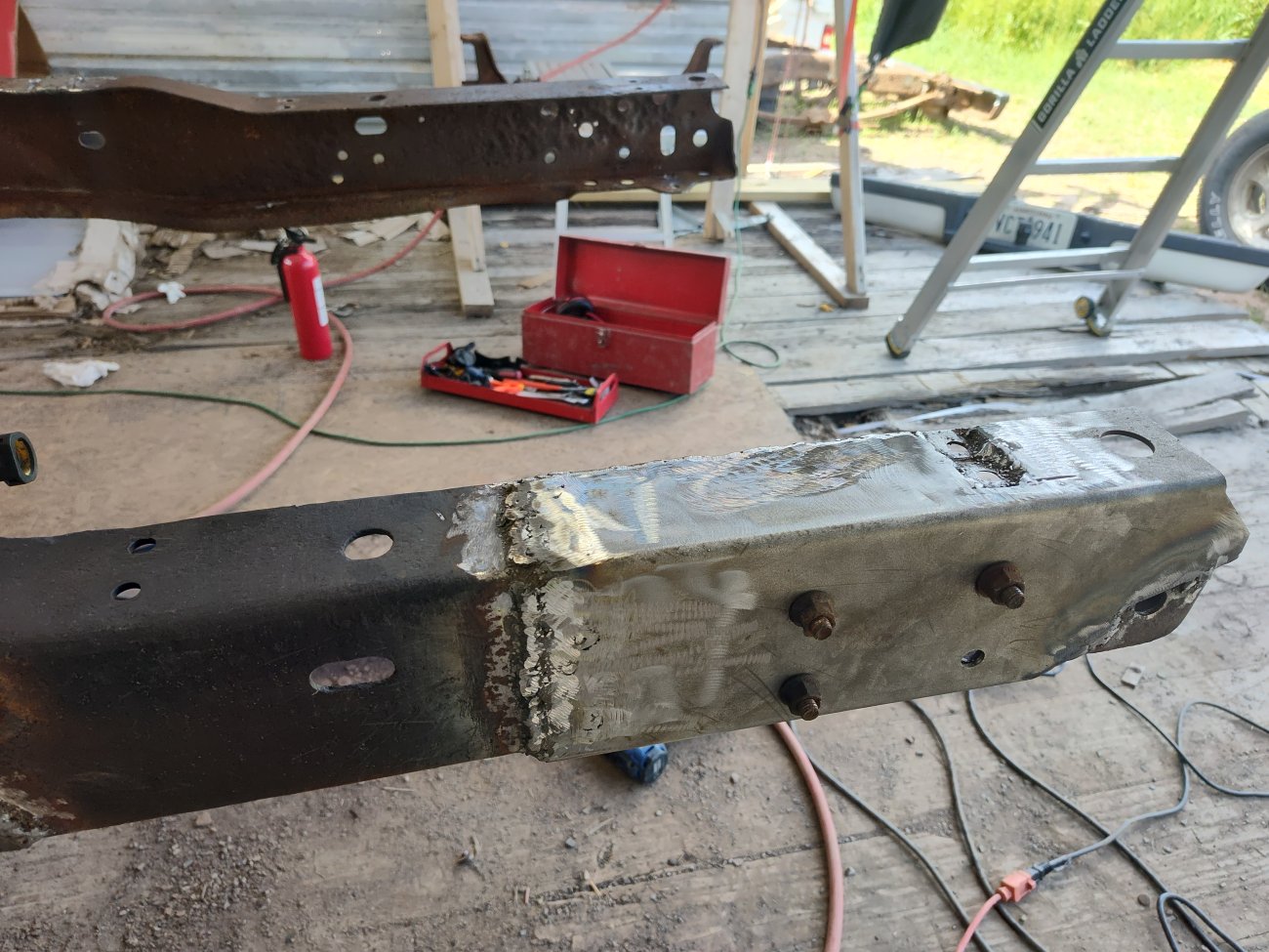

Modified and mocked up sleeve, still need to fix 2 of the holes, this is for an older frame design, so the holes are slightly off.
06 Frame Repairs
Is it galvanized? Be careful not to breath the fumes if so, very poisonous.
By all means, I deeply inhale over every weld, can't waste the good metallic taste.
It's a painted steel sleeve. I removed all of the paint/coating on both parts where I'm welding, fluxcore sucks as is, so every advantage helps lol.
Got that stupid crossmember out, man do I dislike frame studs lol. But it's cheese at the lower mounts. So new one gets here next weekend. You can also see the sleeve partially welded on.

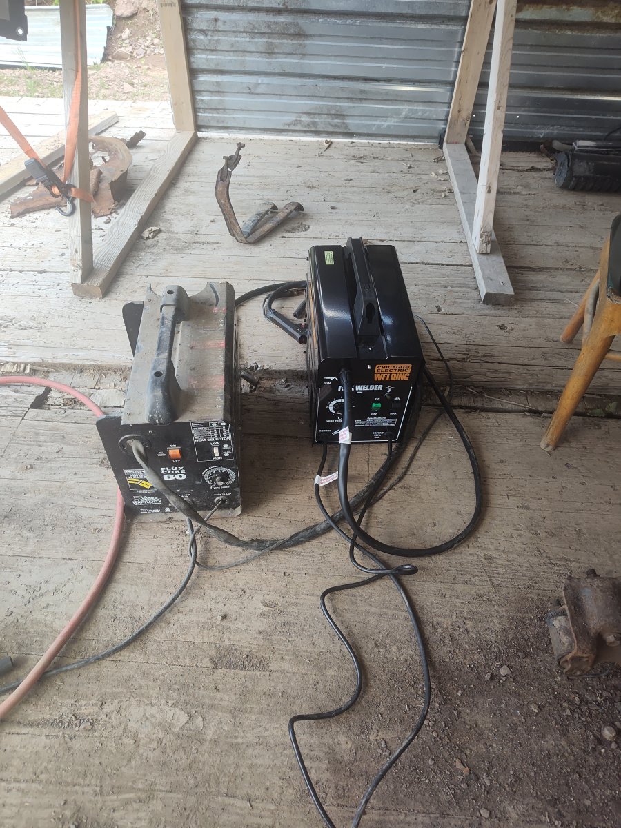

Comparing my old and new welder, holy crap the chicago electric is way better. Great penetration and I don't have to be slow with my welds. My old one just can't give me enough continuous power.
Having a safety switch is a luxury I haven't had in a while lol.

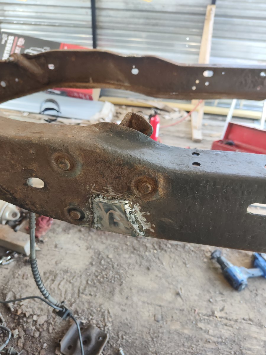

06 Frame Repairs
Well. I'm not an expert, I'm a professional..... sucker that is... my welds look like garbage, so I switched to my hobo freight welder and got much better penetration. They are solid, just ugly af.

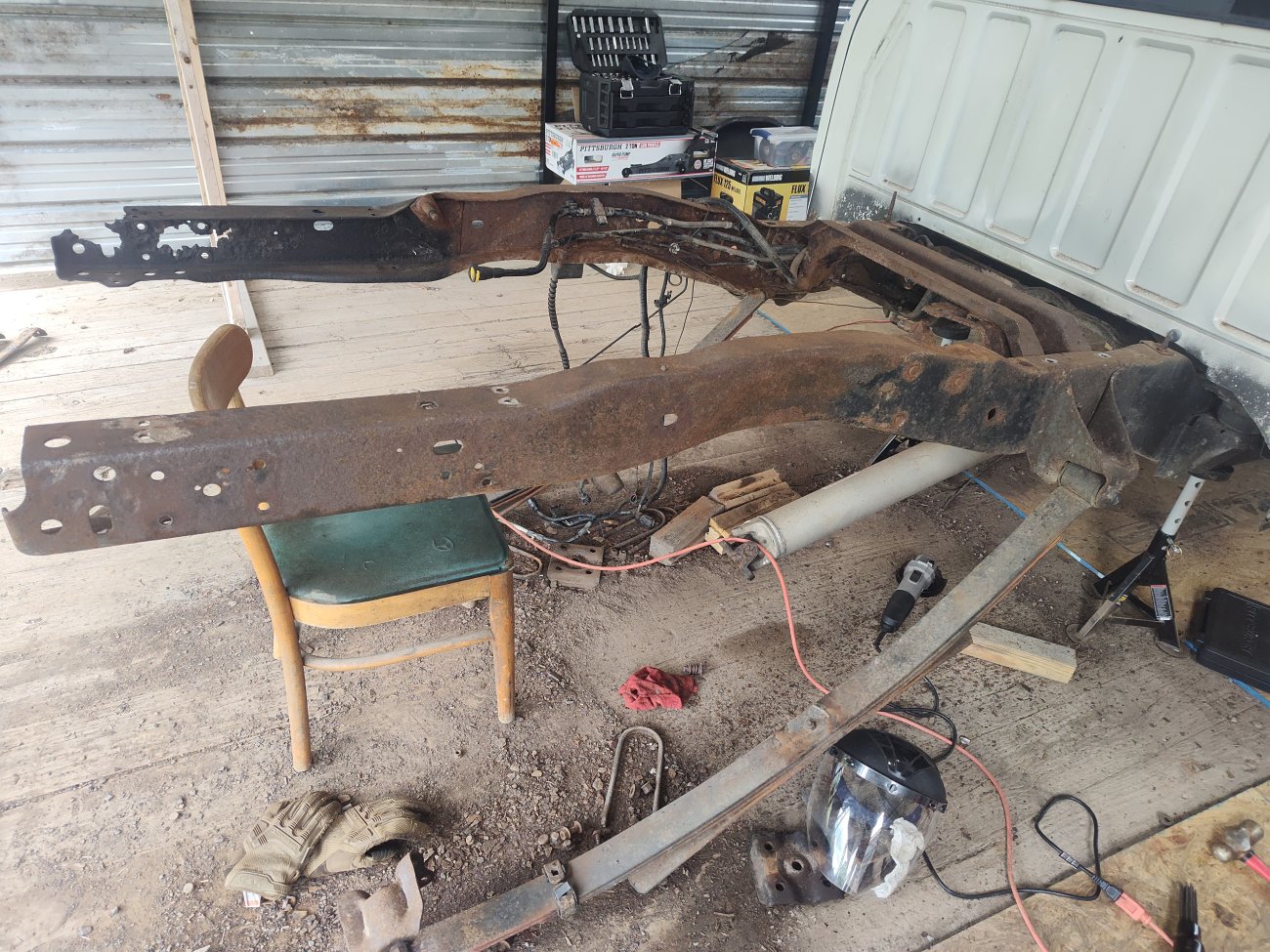

Now back to rust removal, the outside of the right frame rail is done, looks very nice, very smooth too. I will be hitting this with the grinder and cleaning brush before treating it with rust converter/primer. Then onto paint.
