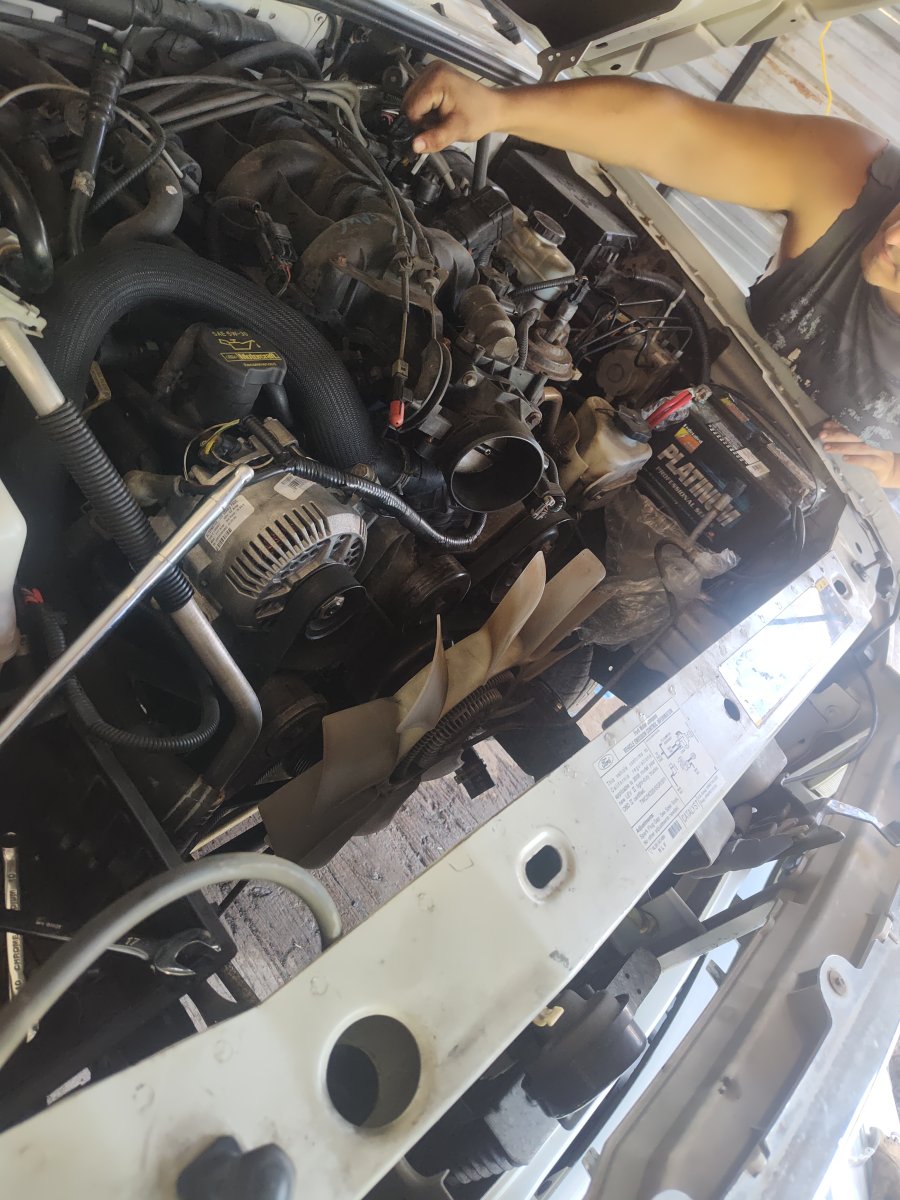

Was driving to Mansfield for lunch with the wife and I heard a bad squealing sound over the music, I turned it off and saw the coolant temp peg. I immediately pulled over and turned off the truck.
Smoke everywhere from under the hood, coolant all over the engine bay. My dad met up with me with tools and we pulled the thermostat, reinstalled with just the gasket (thinking the thermostat might have been stuck). I refill the radiator with water and its dumping immediately all over the road. The engine starts chugging instead of running correctly. I might have destroyed my engine. Woooo.......
I am ordering a new water pump, pulling the radiator from my parts truck and replacing the thermostat and housing next weekend. This sucks...... Hopefully I didn't toast the engine. The oil seems fine from the dipstick, no coolant smell.
Local tow shop is dropping it off today at the farm for me to work on. It should run just well enough to pull into the garage.

Luckily I have a replacement engine in my parts truck that runs great, but we shall see on Saturday if the engine is dead
