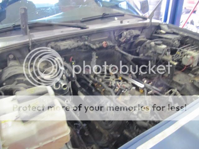

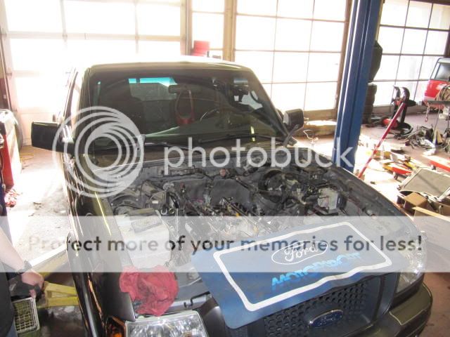

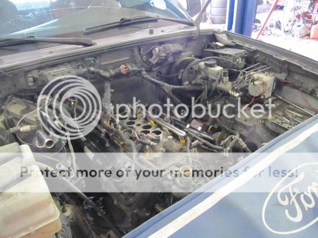

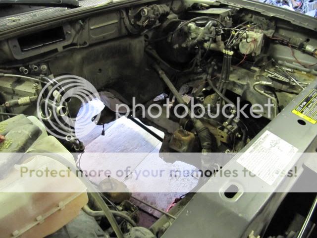

3.0 out 5.0 in. Wiring tomorrow.
No headers yet. Supposed to be here Monday. They are not the P heads. Will test fit the 89500's just to see if they work on a torsion front with non P heads.

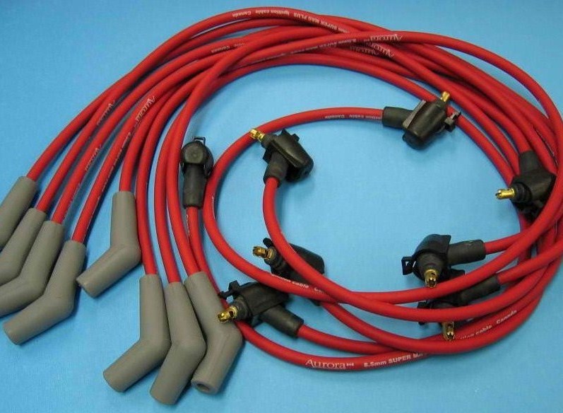

Should have the drive shaft tomorrow. Then to the exhaust shop Friday morning. Still haven't fired it up. I ordered the wrong plug wires so I can't start it yet. I ordered a set of Aurora wires for the 5.0. http://www.auroraignitionwires.com/index1.html Part number 95323. Should have them in a few days. In the mean time, I will put a used set from my Mountaineer on the motor so I can run it. Just too exhausted tonight. It WILL run tomorrow night!

It's ALIVE!!! Have to wait till tomorrow morning to drive it. Have to pick up the driveshaft the morning. Then it's off to the exhaust shop. Had to re-pin the connector to the transmission. 96 and 98 4R70W's are pinned different. The only codes I have now are for the evap vent solenoid circuit.
