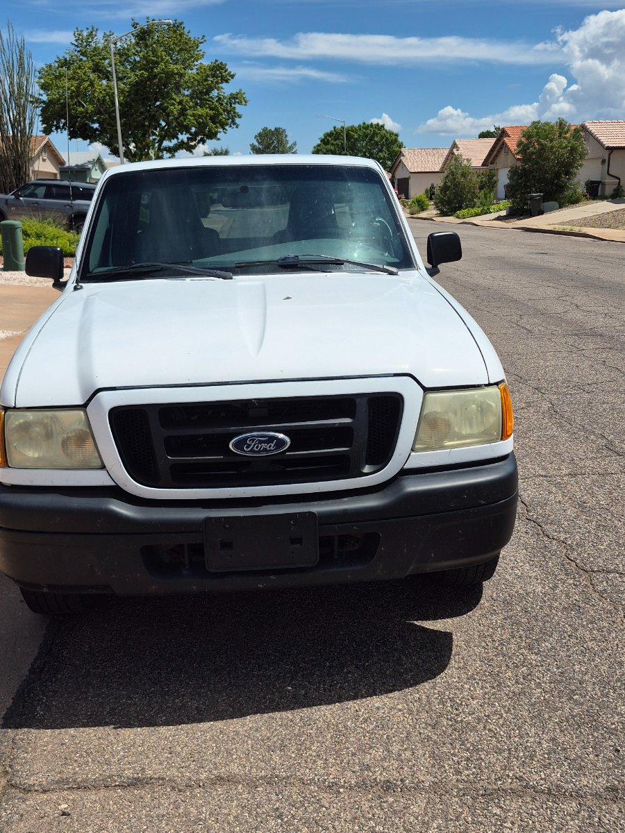

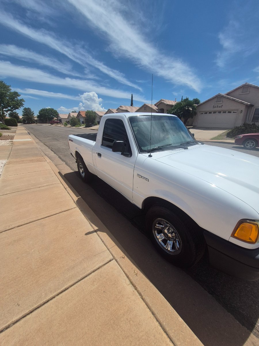

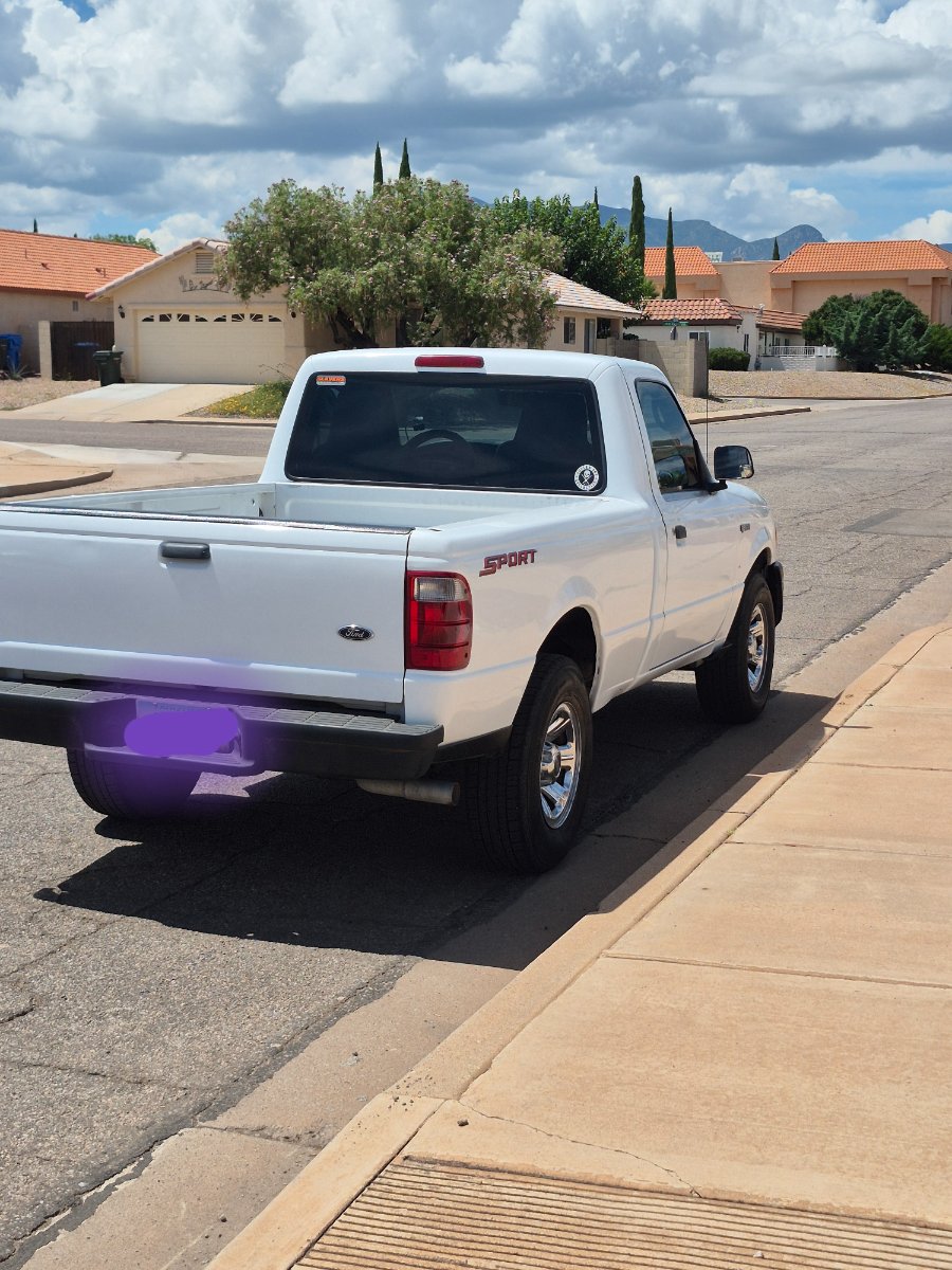

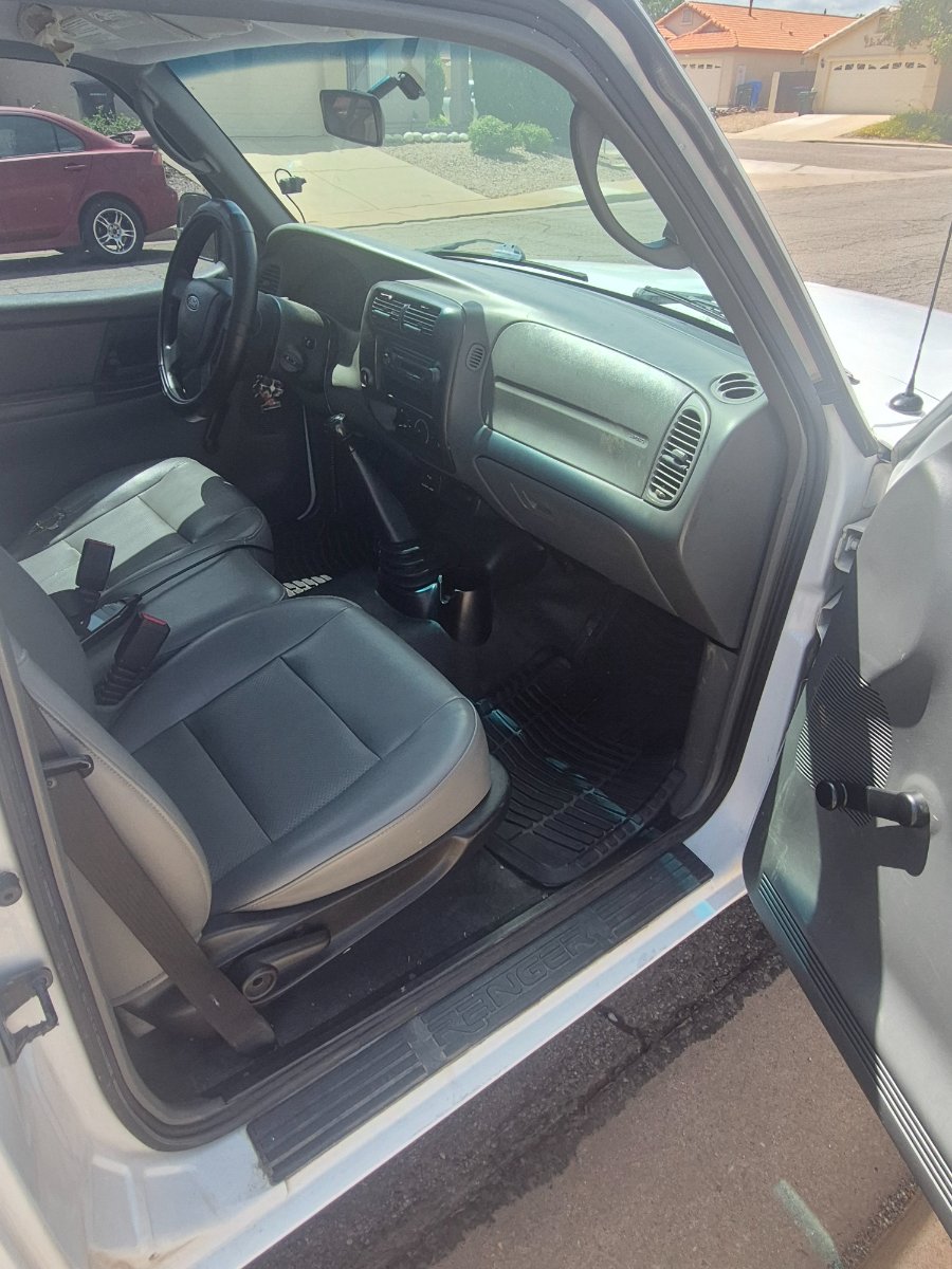

Hey everyone, I just purchased a 2004 Ford Ranger Edge Sport. Its a single cab, manual transmission, V6 3.0L. Its has 210k miles but has been taken great care of and runs great.
The plan is to drive this for a while, get it tricked out, and pass it on to my son who is currently 13.
I grew up in the "mini truckin" scene...Ive had Chevy S10s, Toyota Pickups, and a different Ranger before this one.
Im new to working on trucks in general, but my son and I are going to learn together. I started this thread to show the progress, finances depending, it may be slow, but there will be progress.

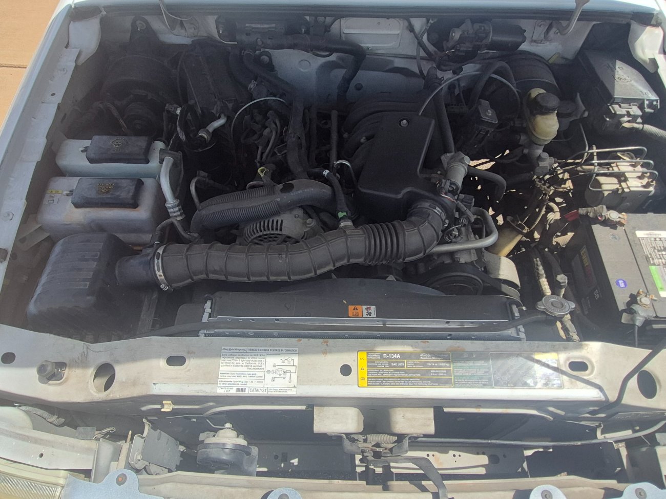

First project is the exhaust and cool air intake...
Back in the day, I had a KN intake and Flowmaster....
I want that deep sound...
I know it's only a V6 but can you guys recommend

For what it's worth, don't waste your money on a so called "cold air intake"...
the K&N system pulls air from the exact same spot as the factory box.
"less restrictive flow" may have helped back in the day with carbureted engines, but your engine is managed by a computer, which is tuned specifically for the factory air box.
Get a K&N air filter if you like, and then spend the rest of the $400 you just saved on something cool.
like suspension, or speakers (That go Boom!)
