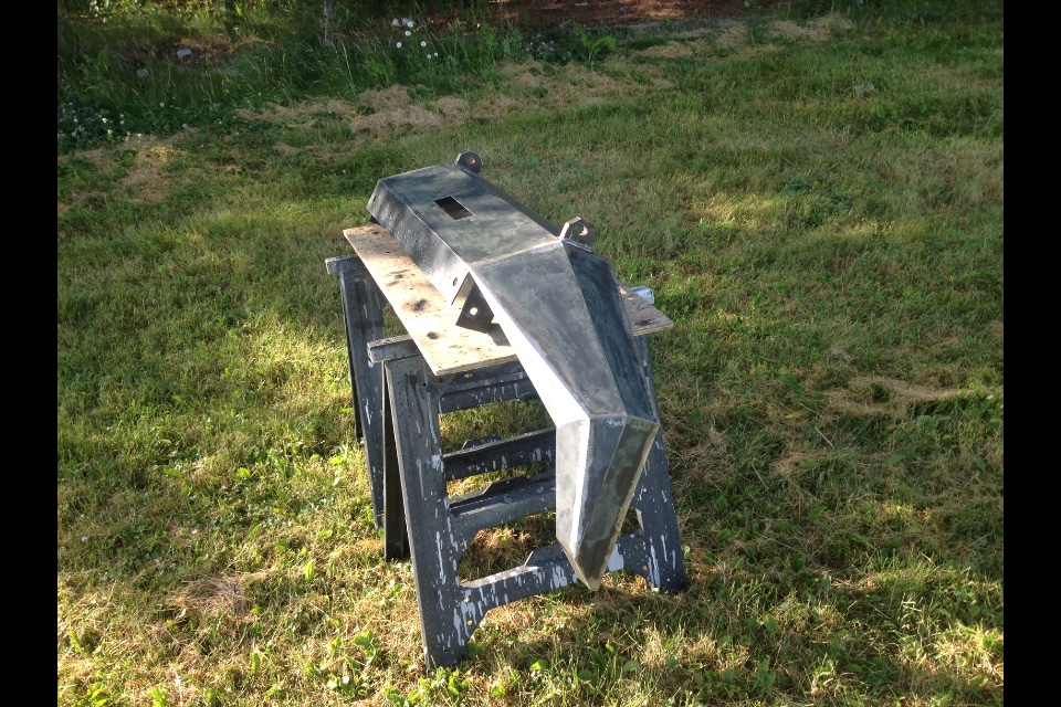

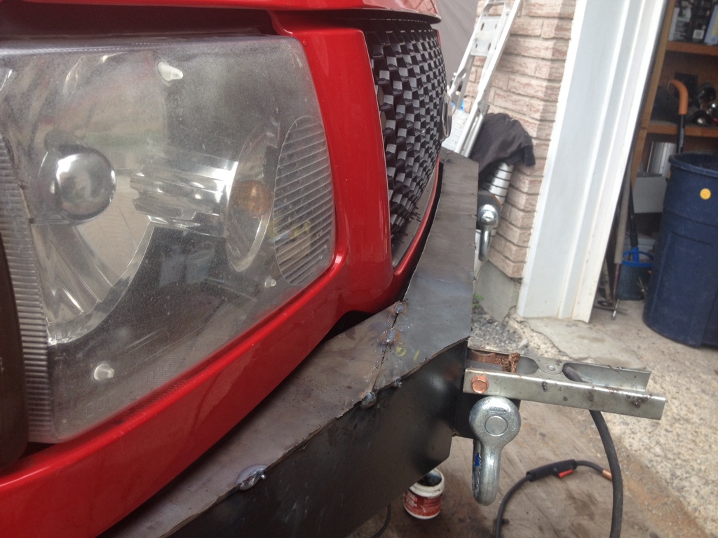

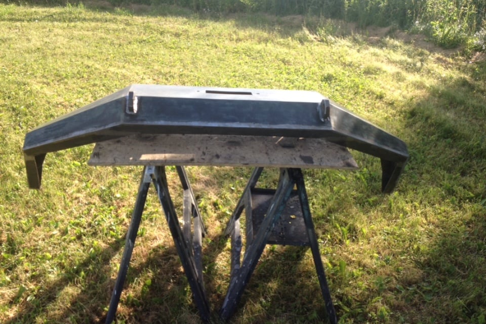

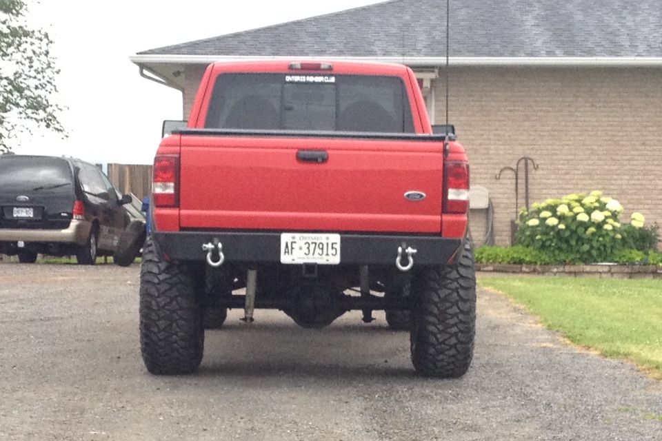

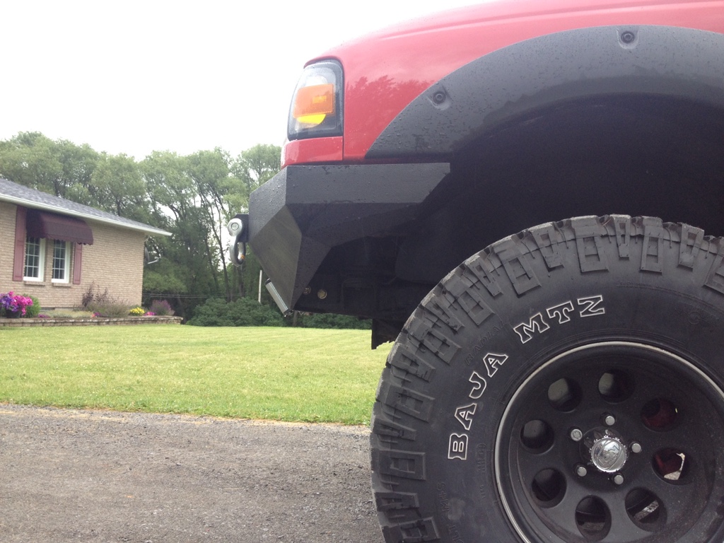

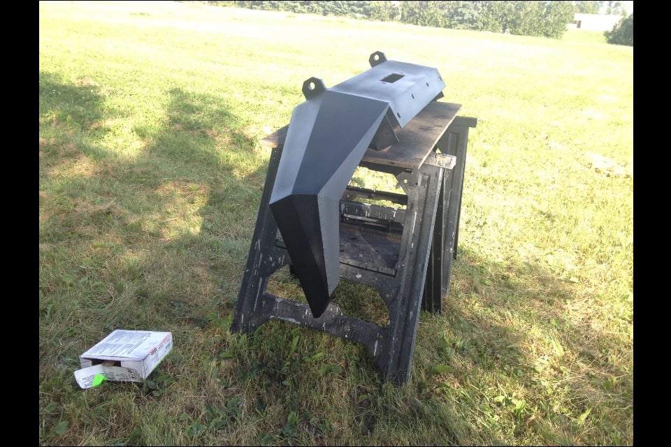

Primed and painted it for the time being so it doesn't rust, still have to plate the top and add some plate to the sides yet. When it's finished it will be Bedlined.

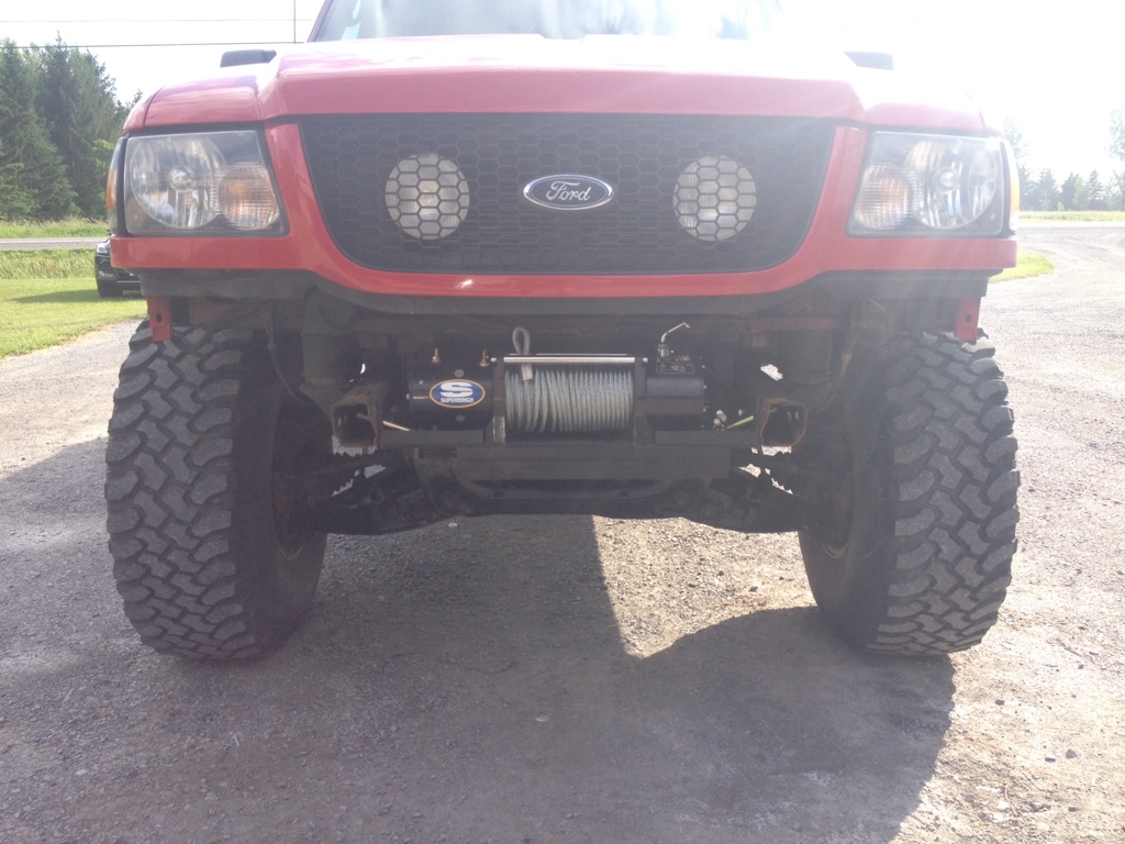

Started making a winch mount
02 FX4 Twin stick Build

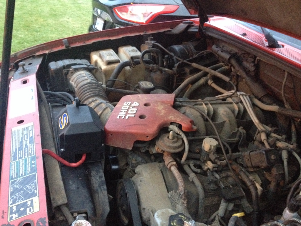

Looks like I'm gonna have to relocate the solenoid box under the hood so the winch will fit

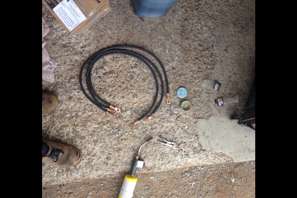

Made extension cables for the winch solenoid box from 2ga welding cable
Mounted the solenoid here

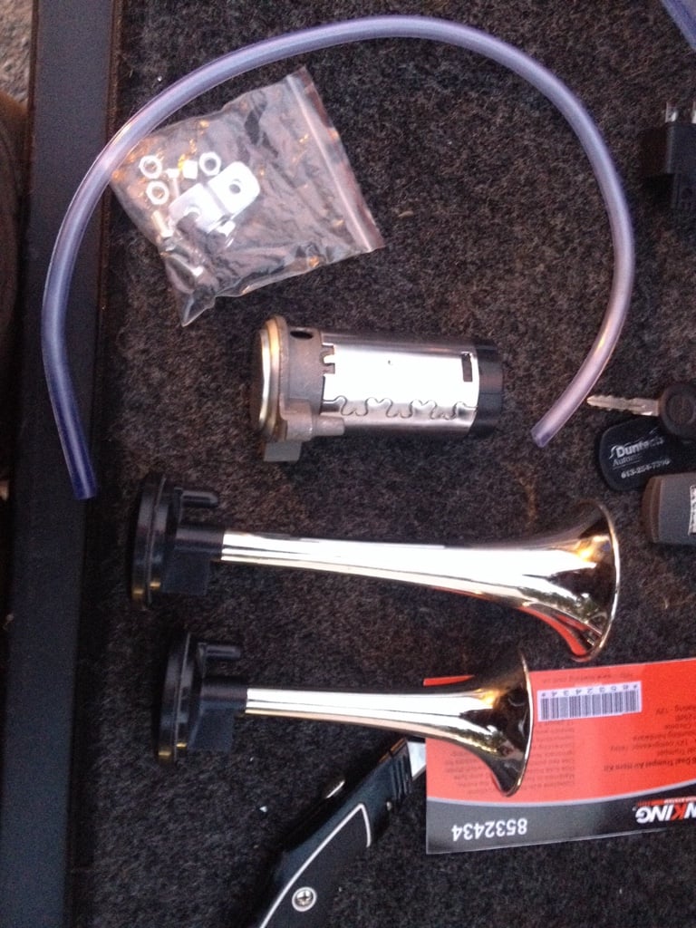

And I'm childish so I bought these air horns

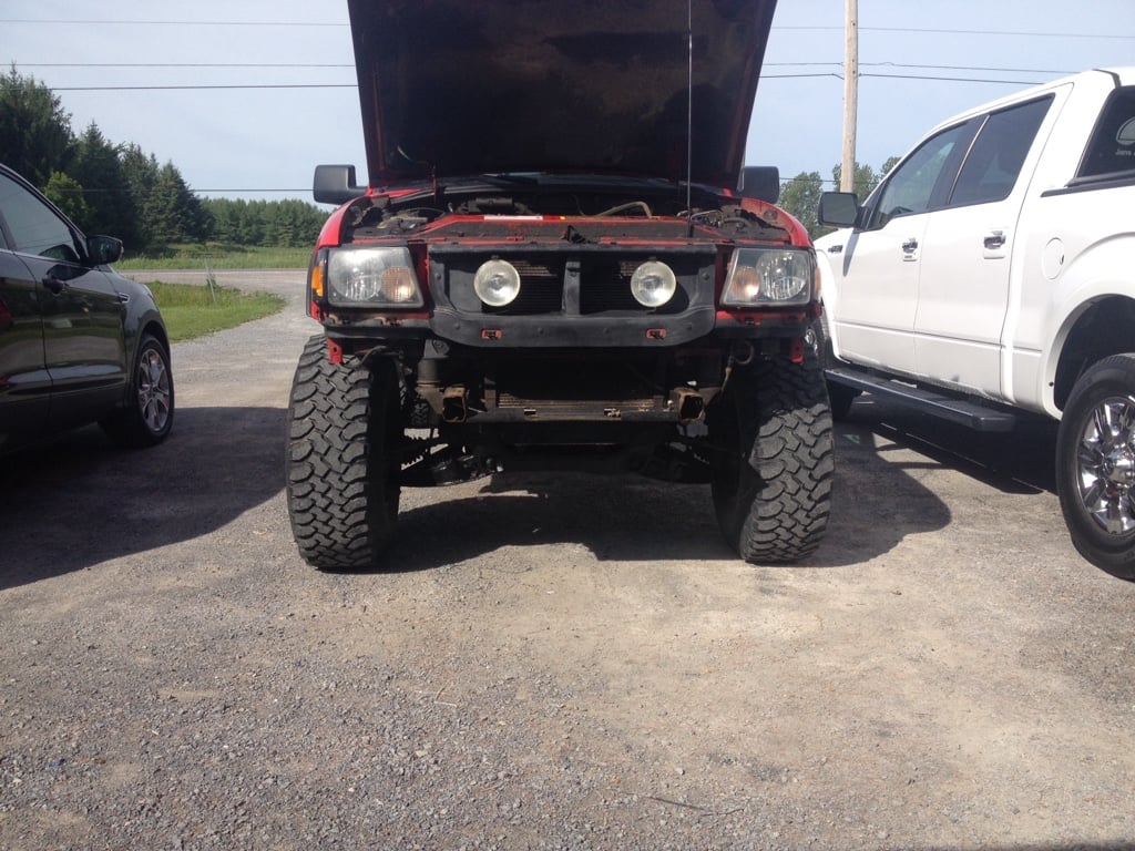

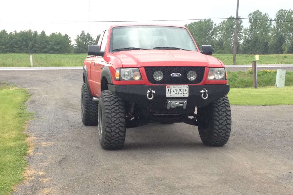

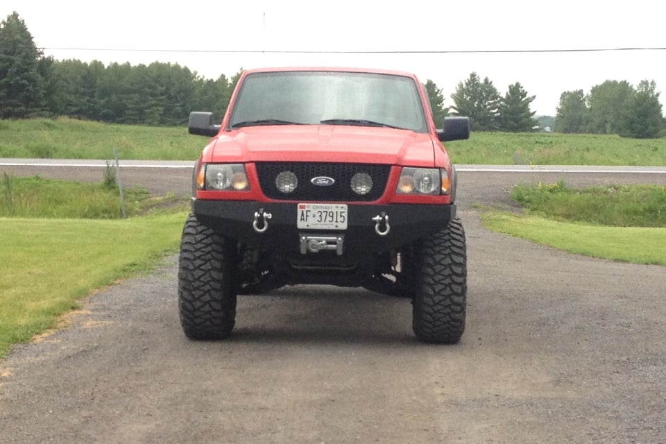

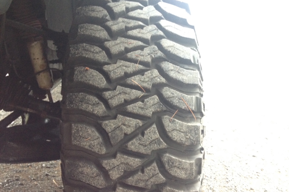

Well it's finished, and I got new tires.

Thanks. The CB whip is fine, although i I have to take it off if I go through the car wash.

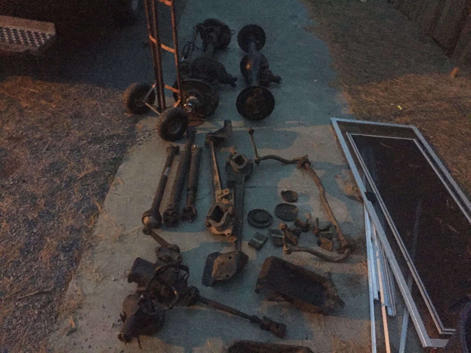

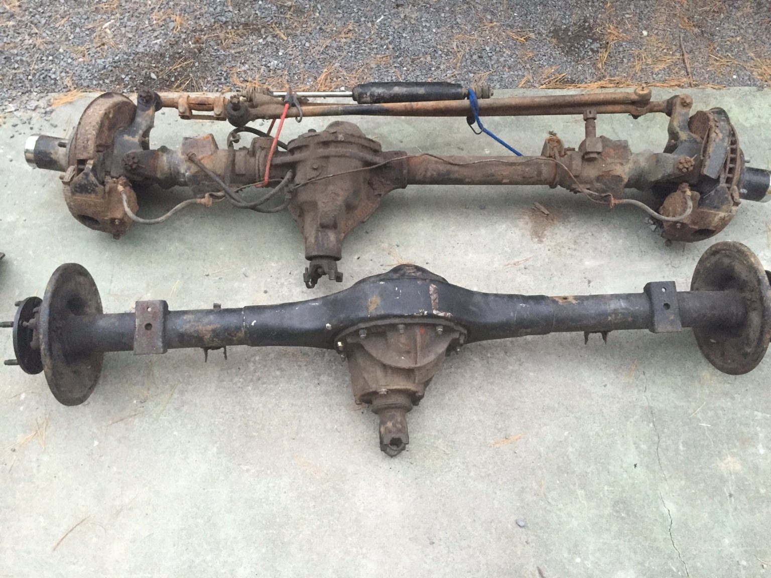

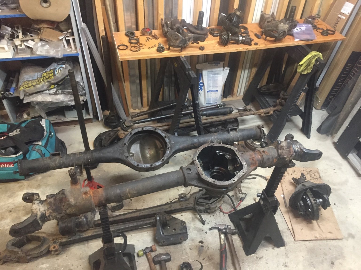

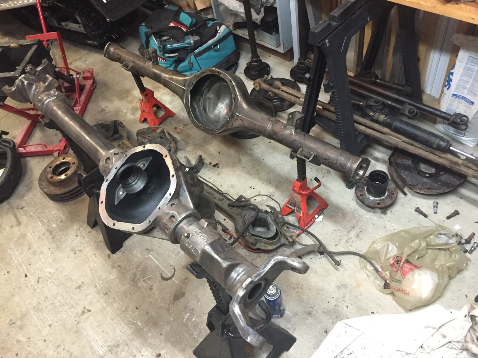

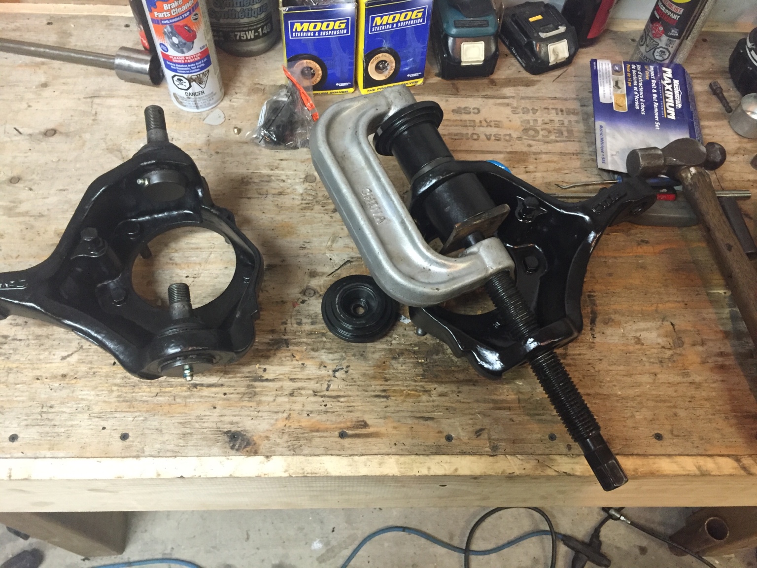

picked these axles up, 78 bronco full width high pinion Dana 44 and a 31 spline 9" rear end. Also got a bronco/f150 steering box, bronco radius arms, coil buckets, some driveshafts and some other stuff. Only set me back $300

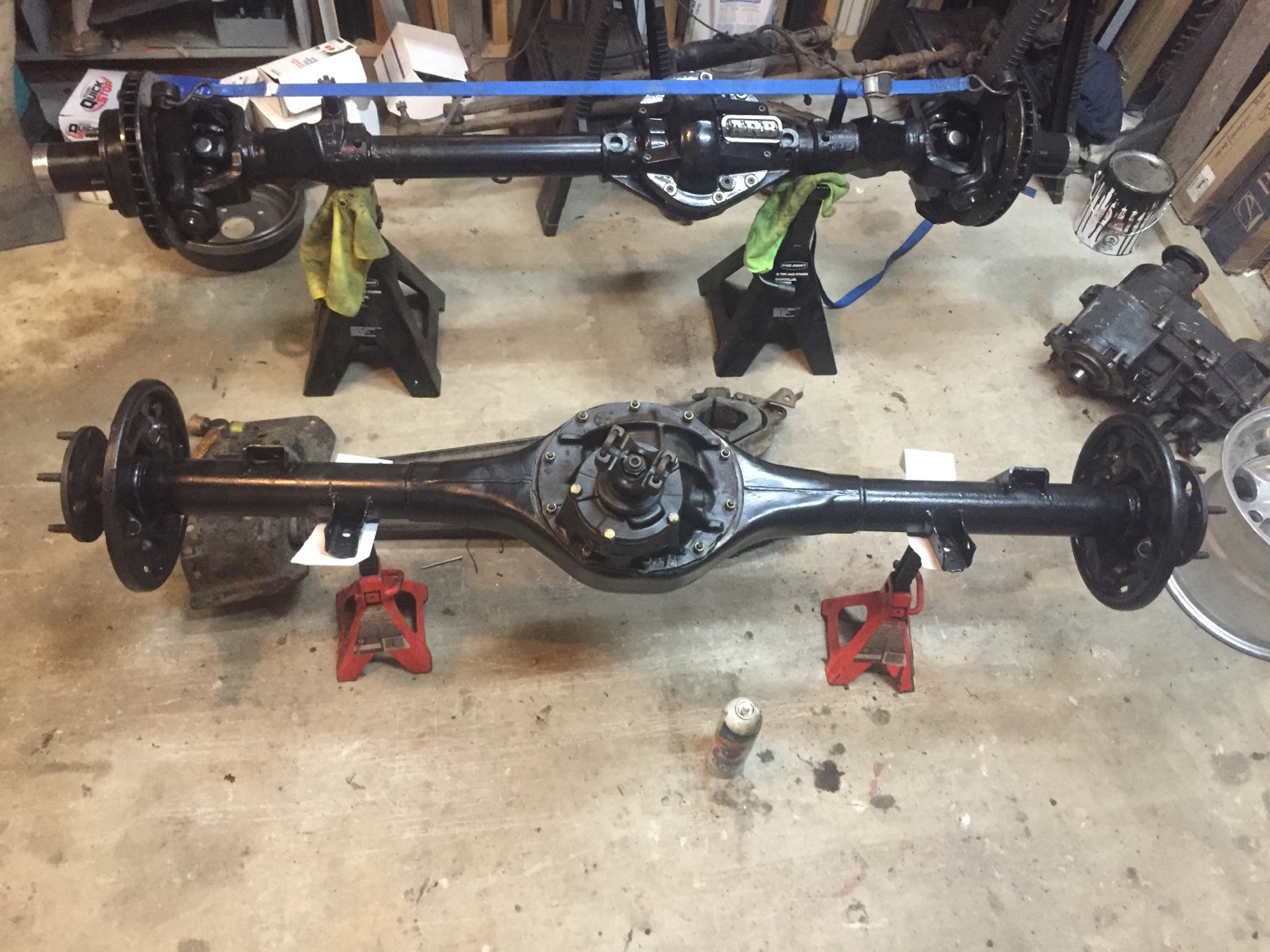

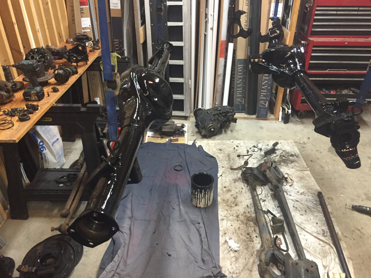

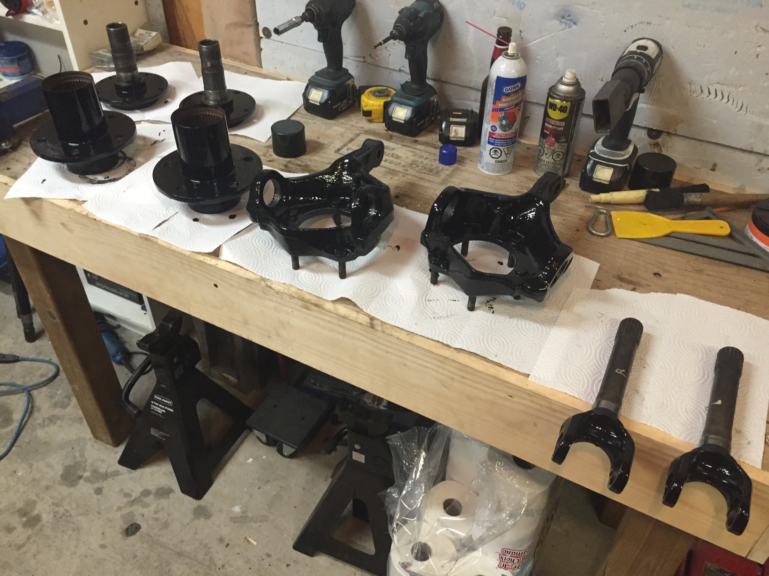

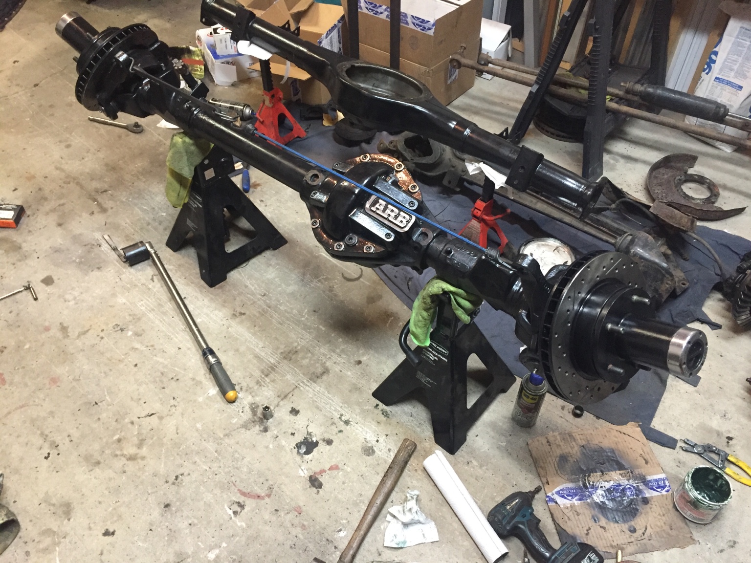

Got the axles apart, cleaned up and painted

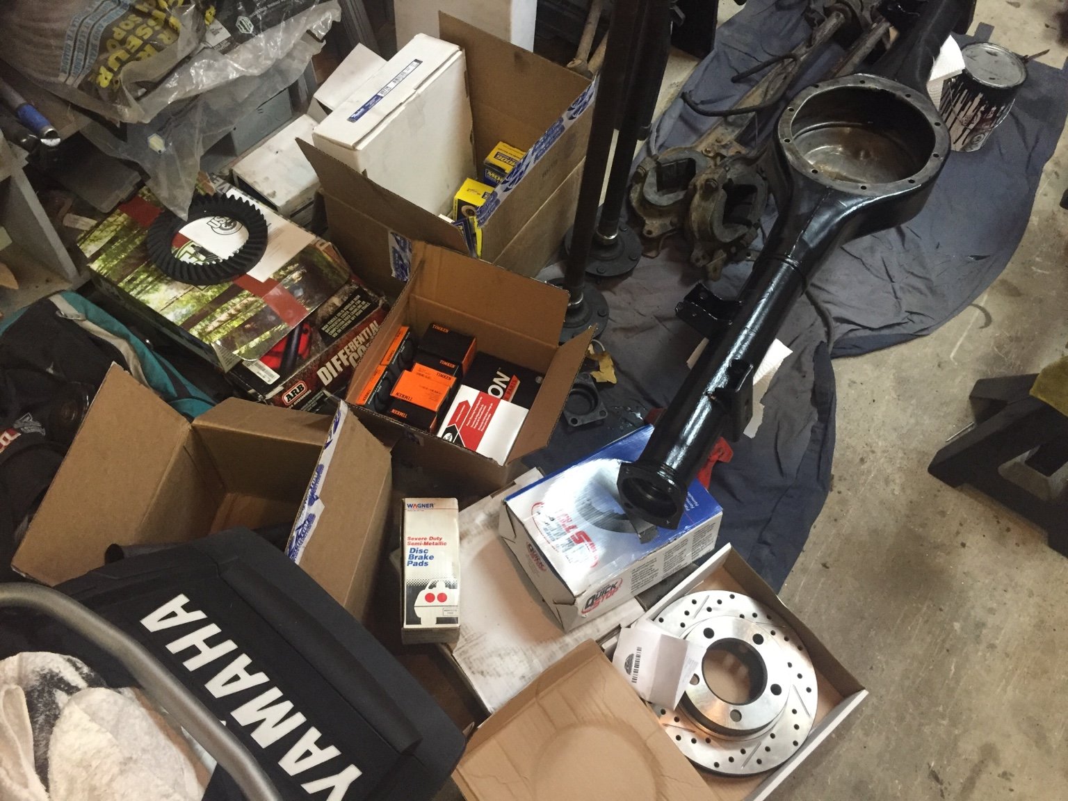

FedEx guy has been to my house a lot lately

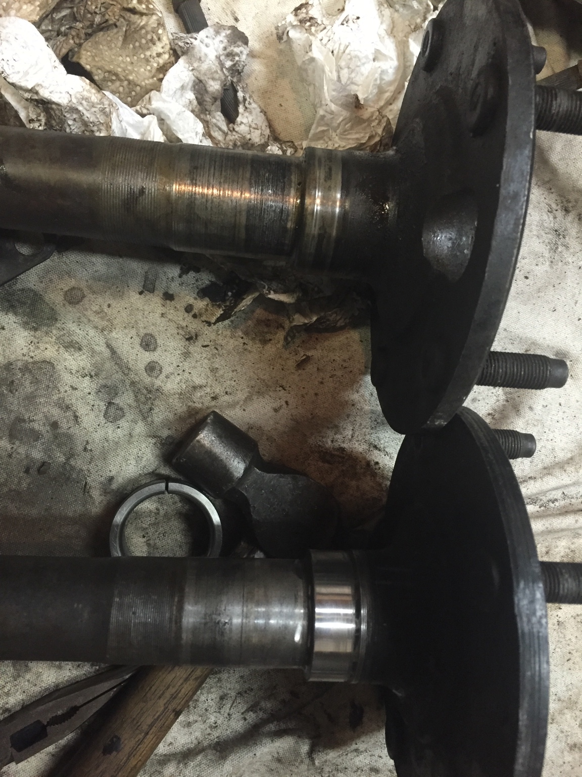

The 9" axle shafts had a groove worn in then from the seal, turns out they don't make a specific speedi sleeve for it, but I measured it and ended up using a crank shaft repair sleeve on them and it worked perfect

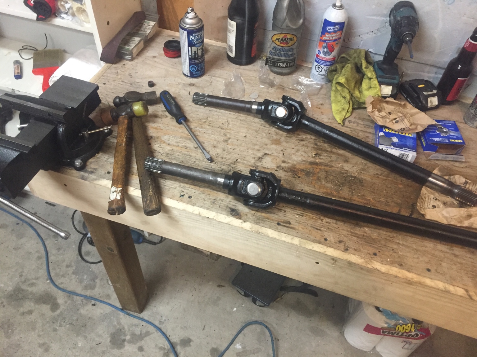

Baljoints and u joints installed

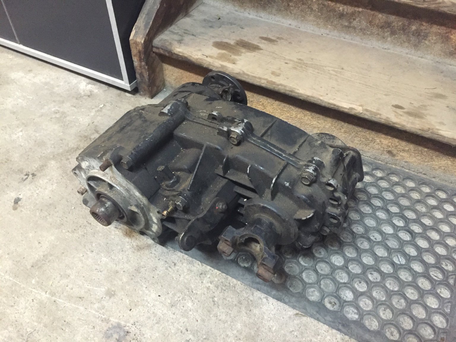

Picked up a manual t case with a yoke front output shaft instead of the cup type output shaft I have, scored it for $80, it has new seals too

5:13 gears and Detroit locker for the 9" rear end

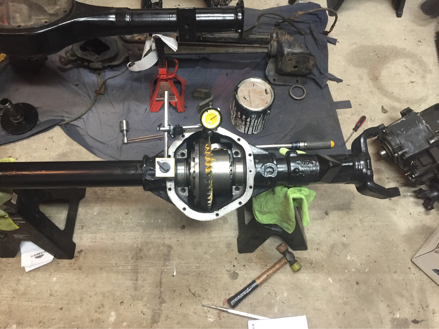

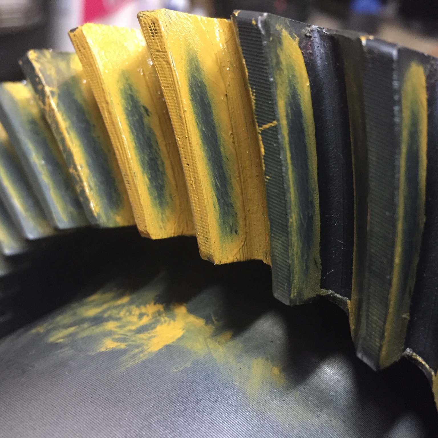

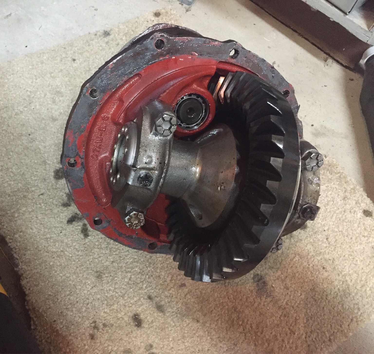

And started setting up the d44 ring and pinion with 5:13s and a Detroit true trac
Sweet build! Can't wait to see more!

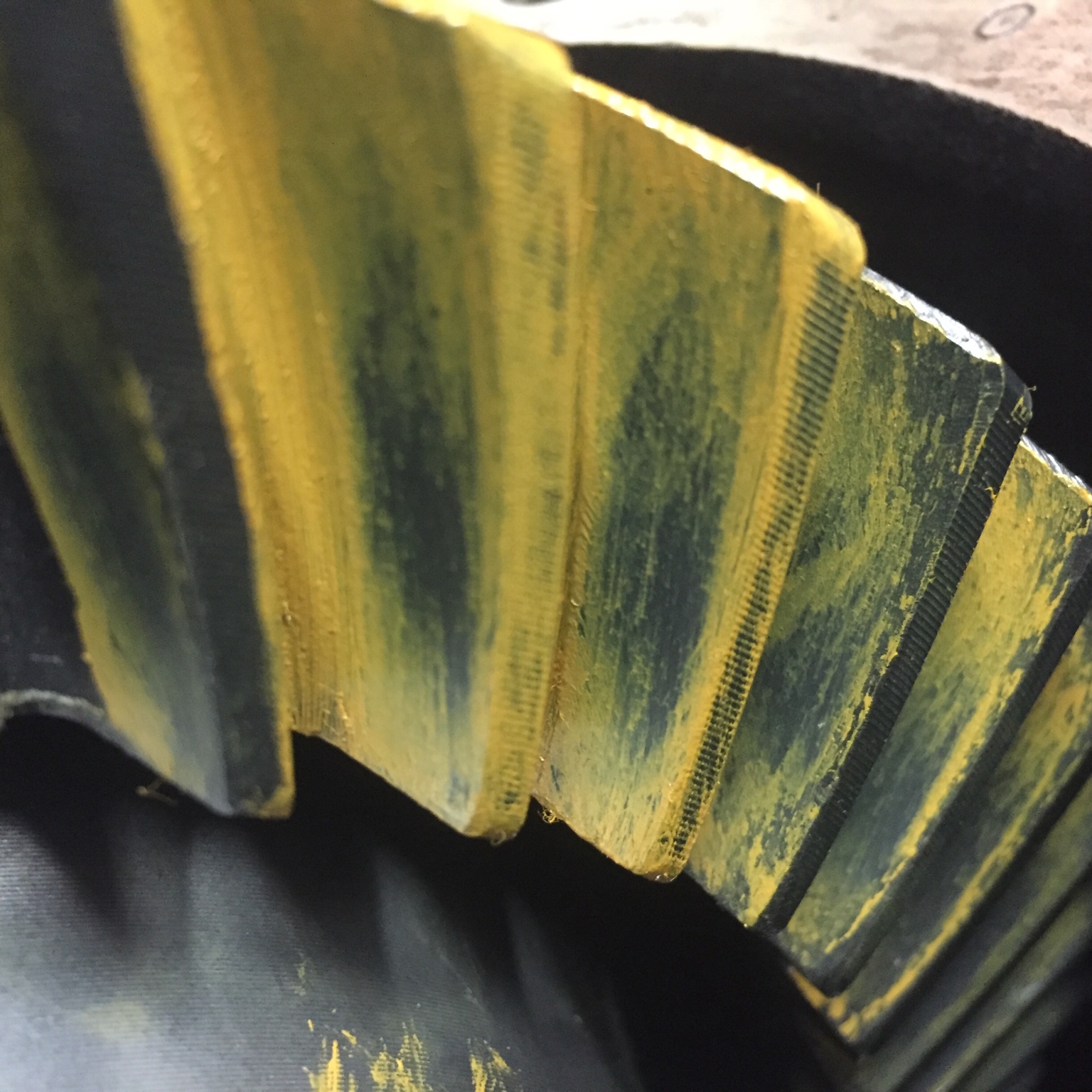

This is my final gear pattern, I'm pretty happy with it

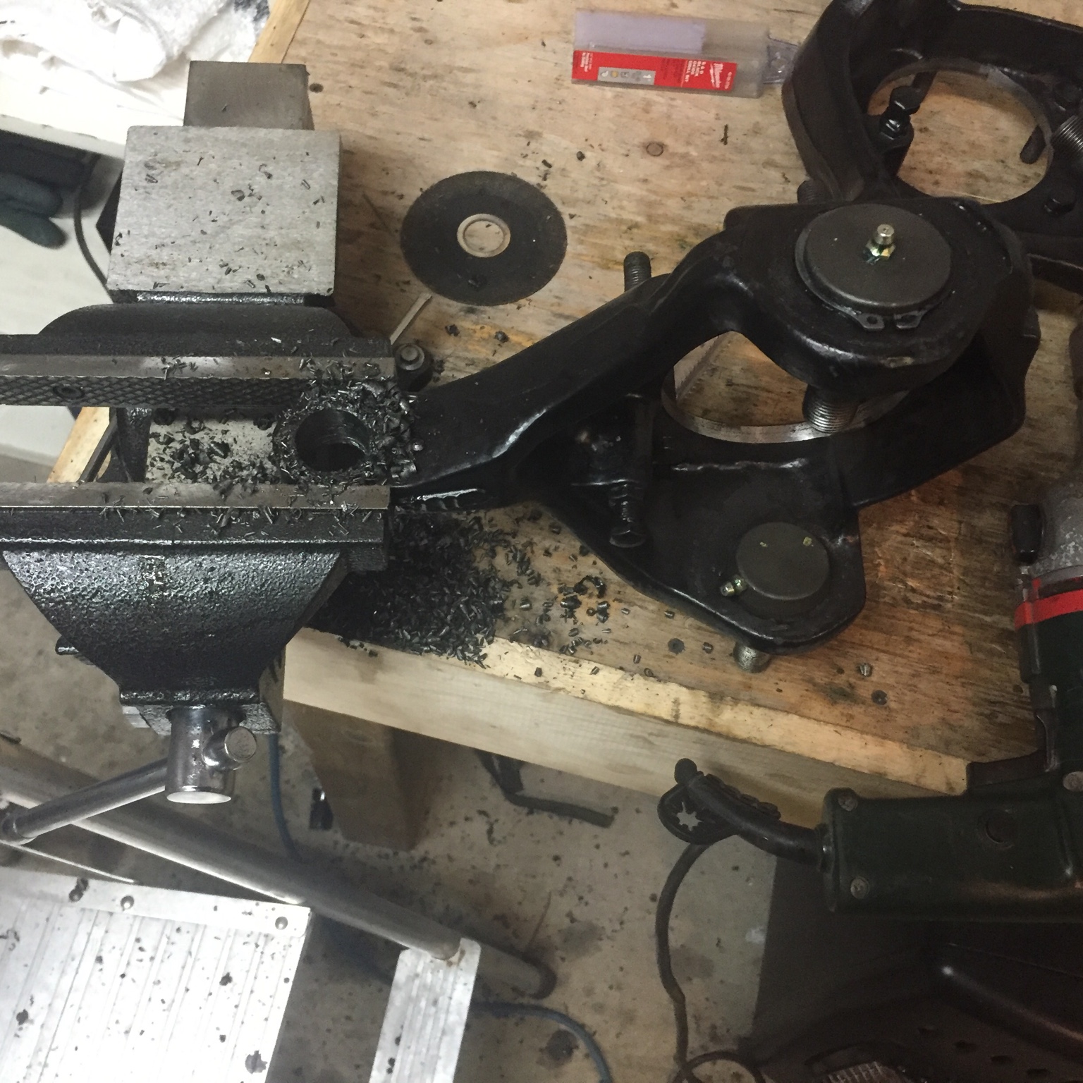

Drilled out the knuckles for Chevy one ton tie rods

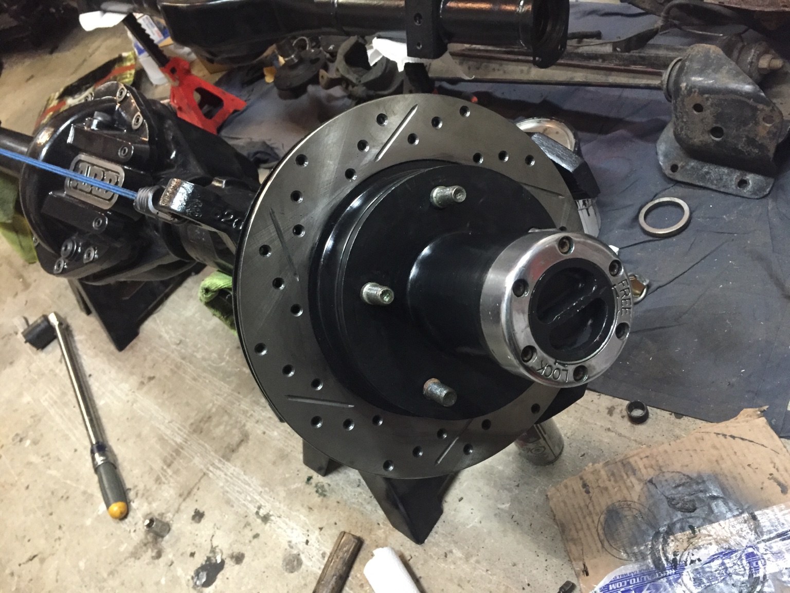

Rear axle is finished other than brakes.

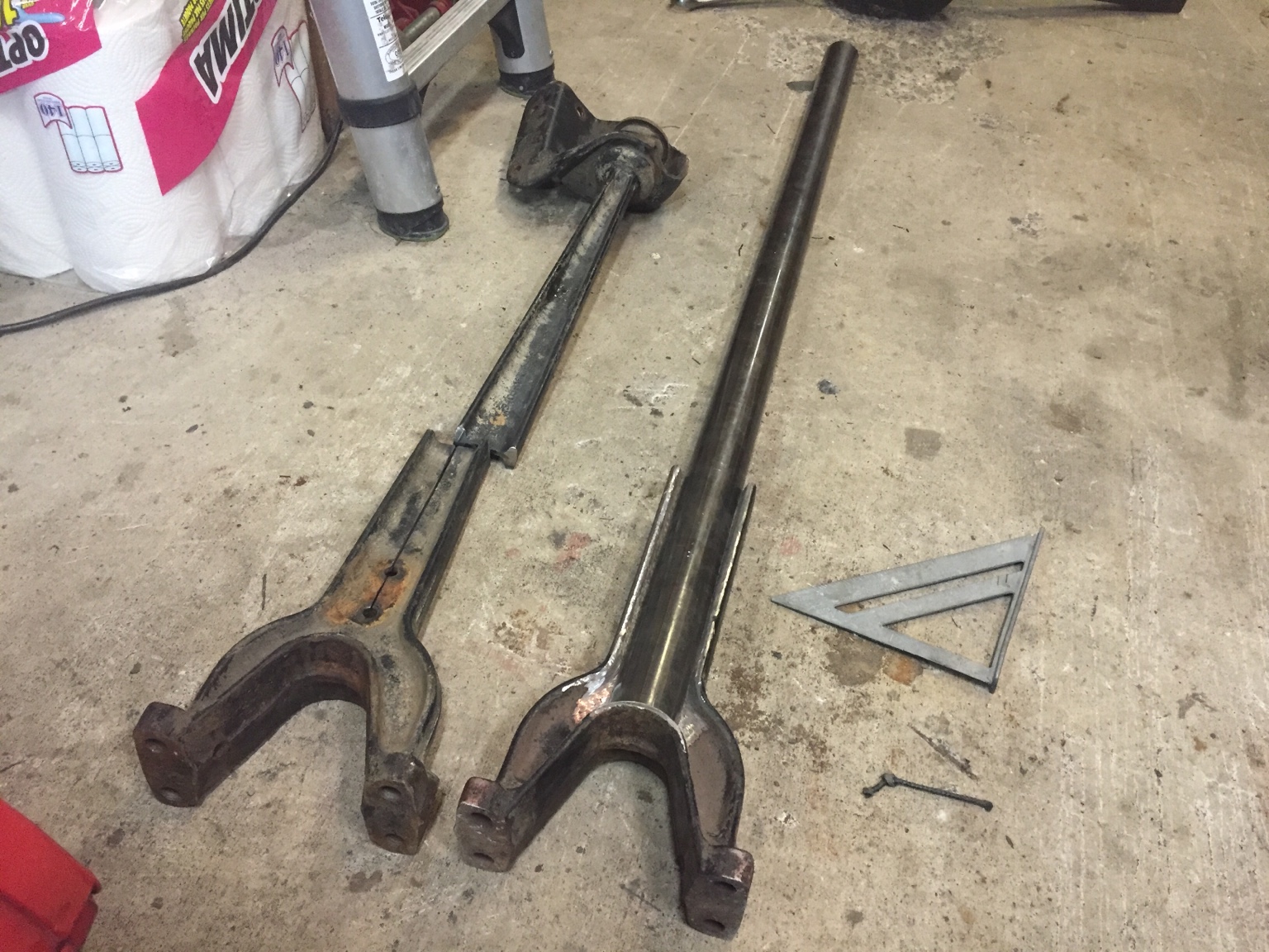

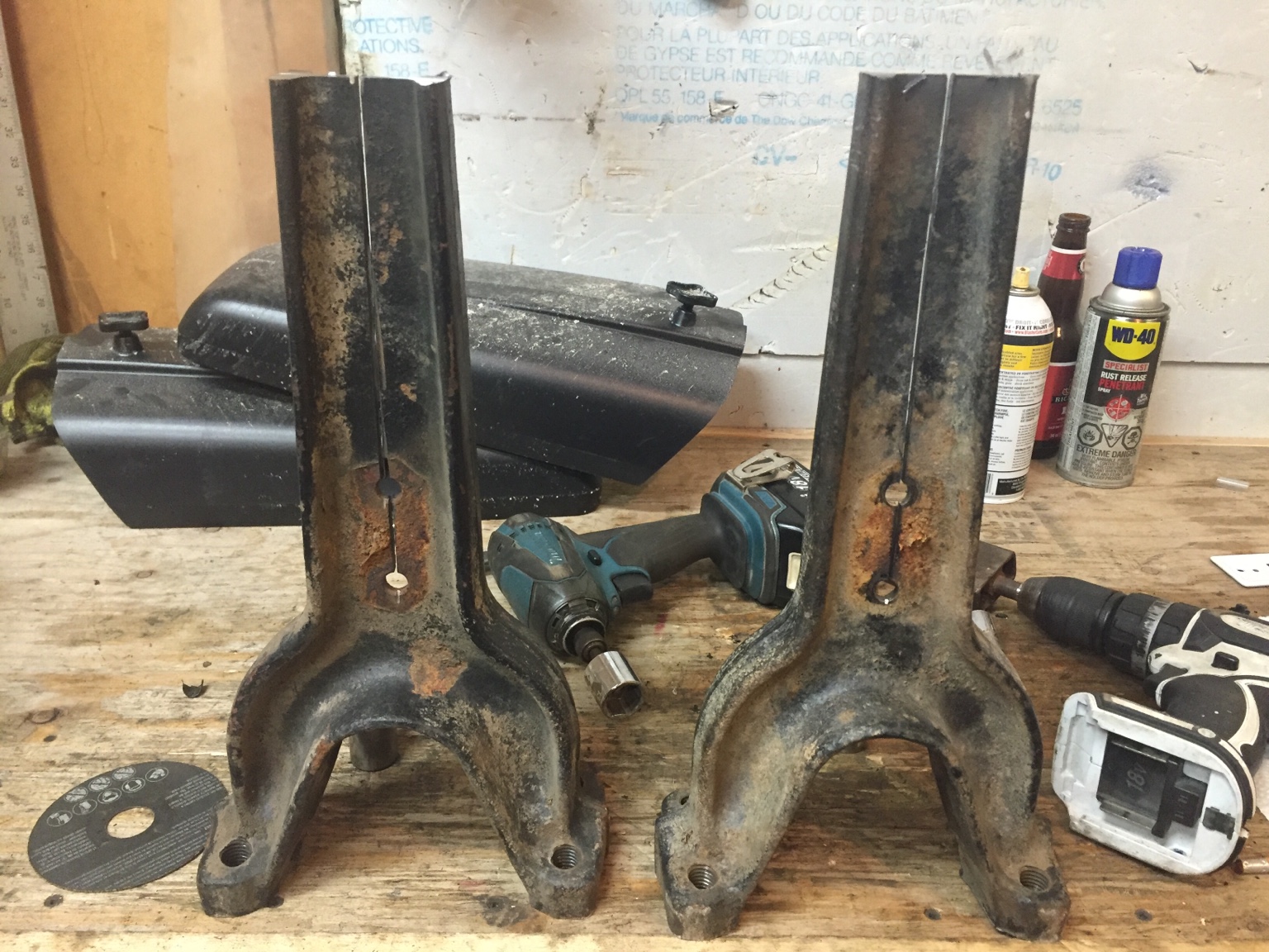

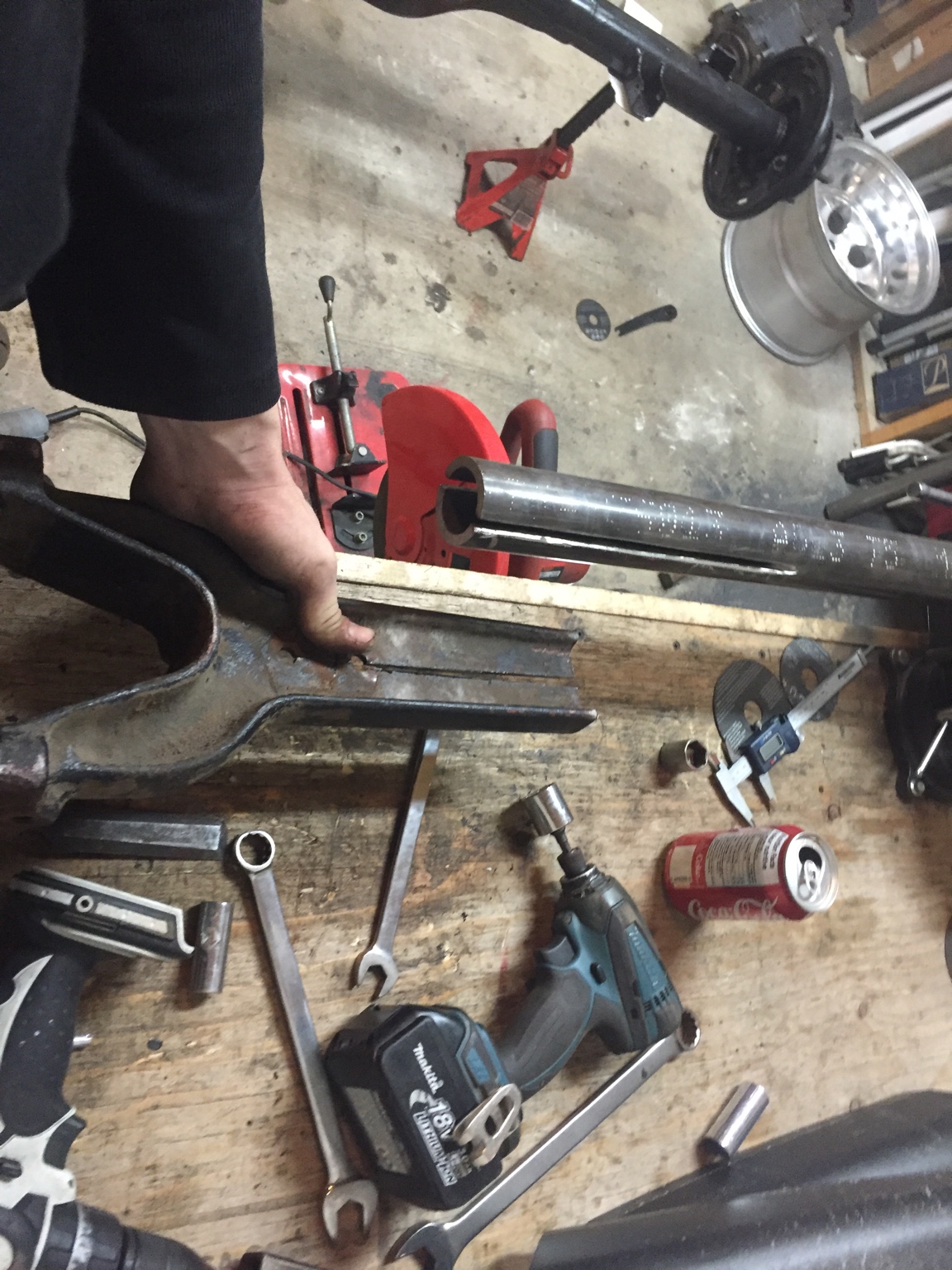

And started on the radius arms

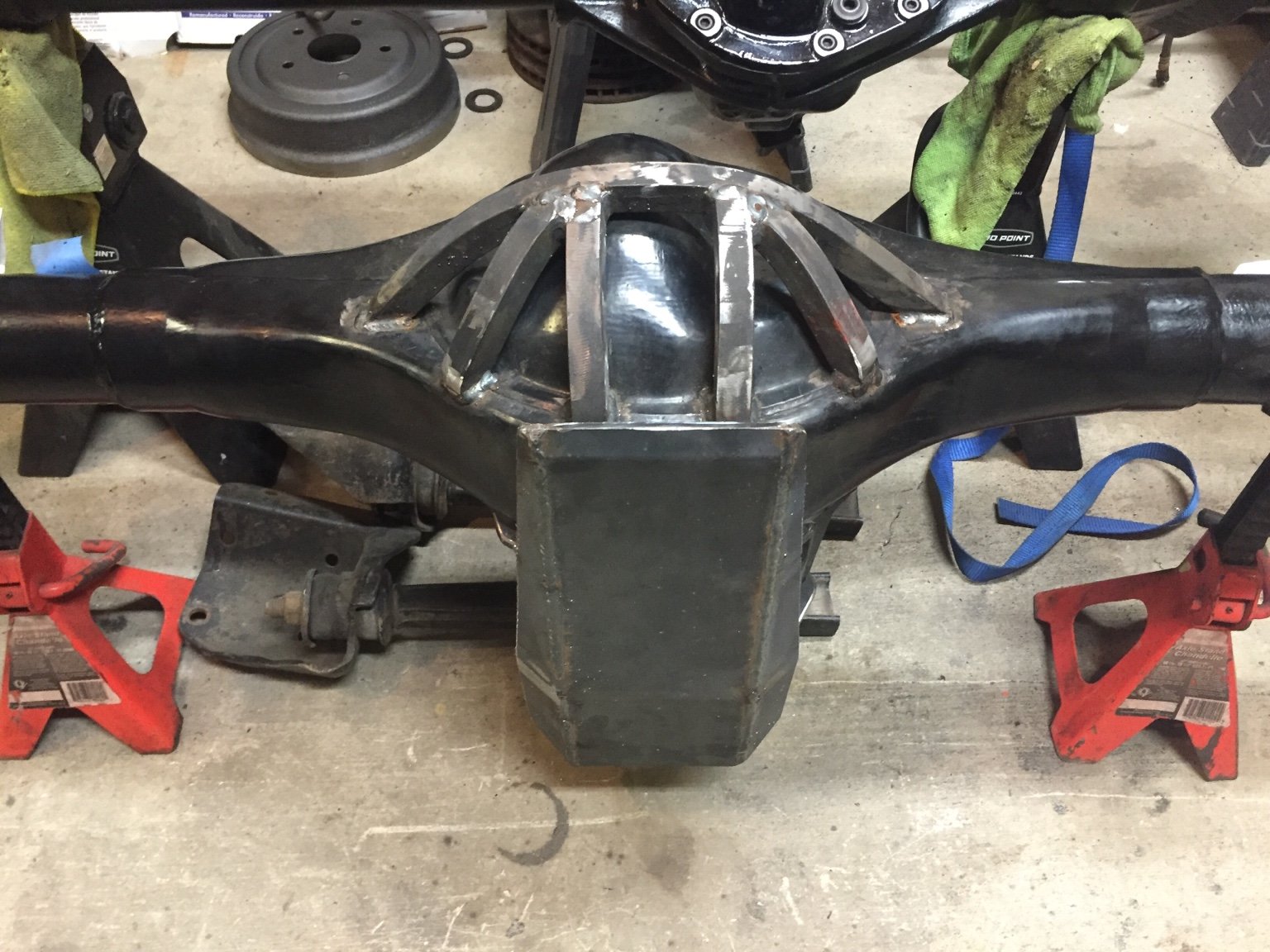

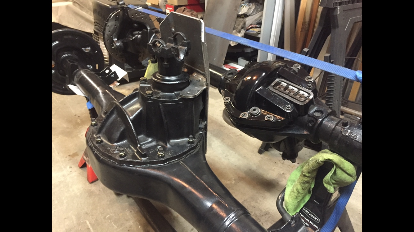

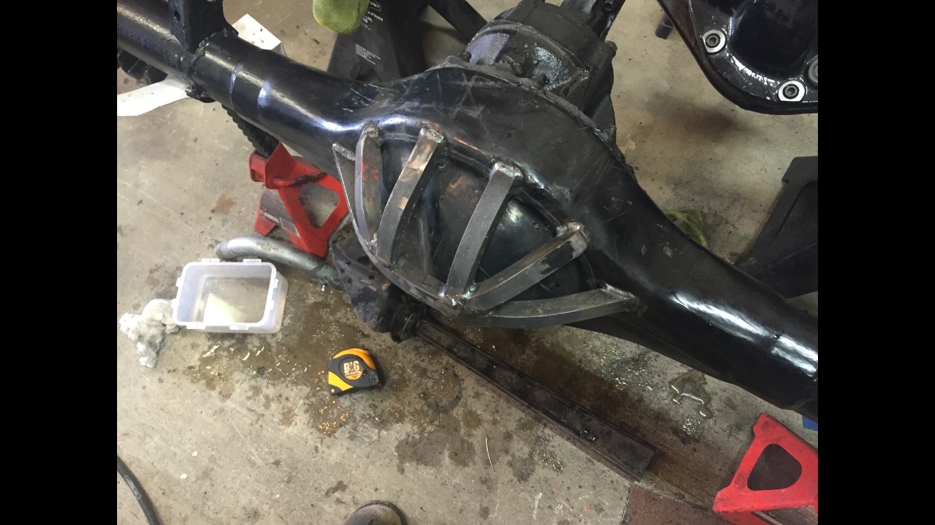

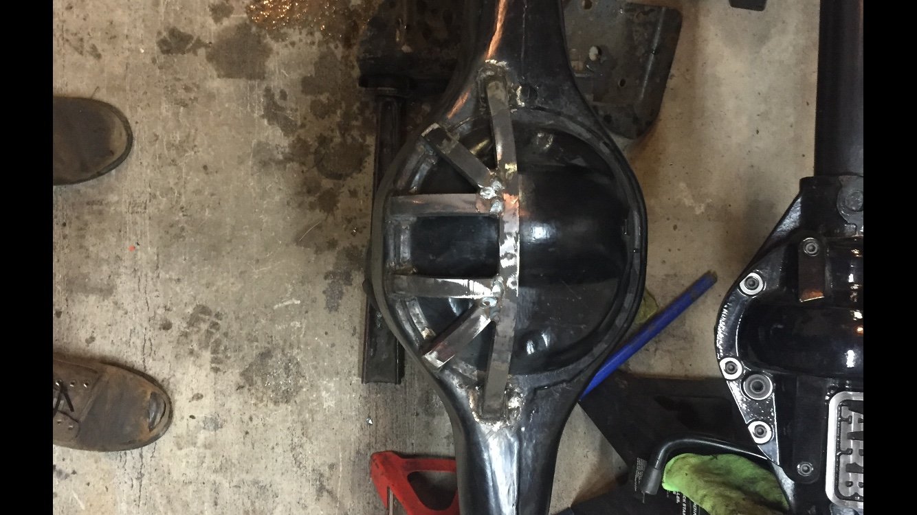

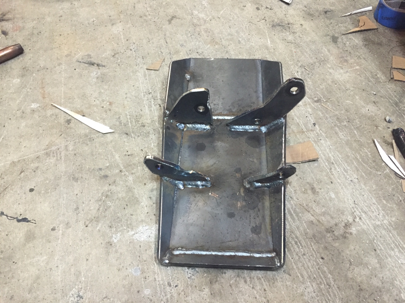

Decided to make a diff gaurd for the 9", might do a bolt on skid plate that goes along the bottom too.
Made it out of solid square stock I had laying around
