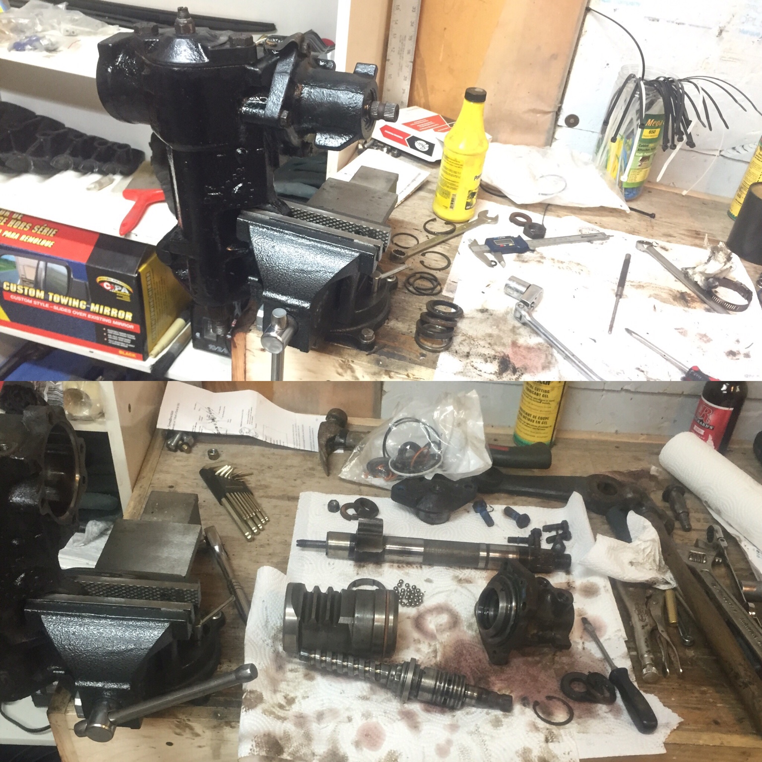

Rebuilt the bronco steering box

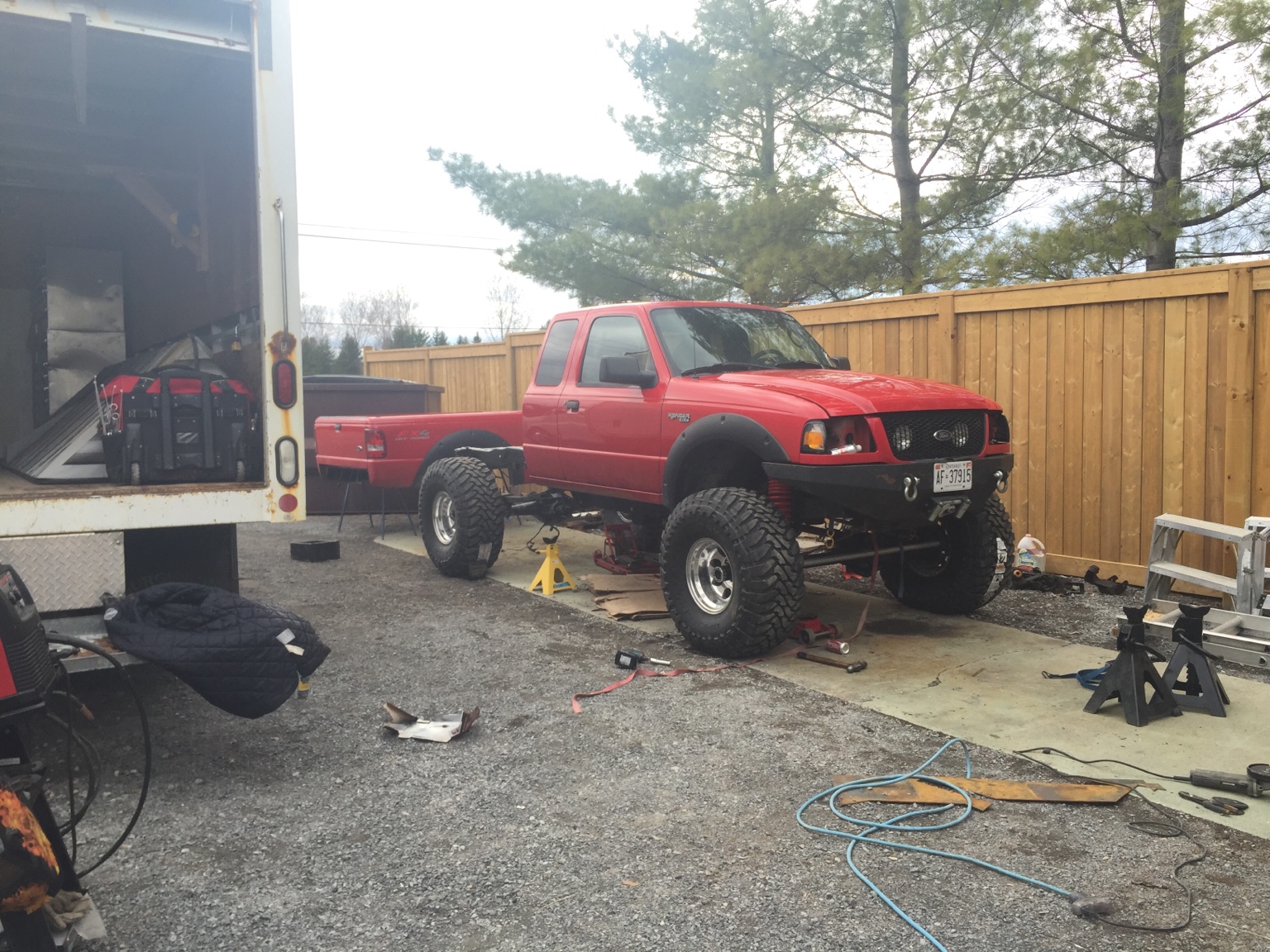

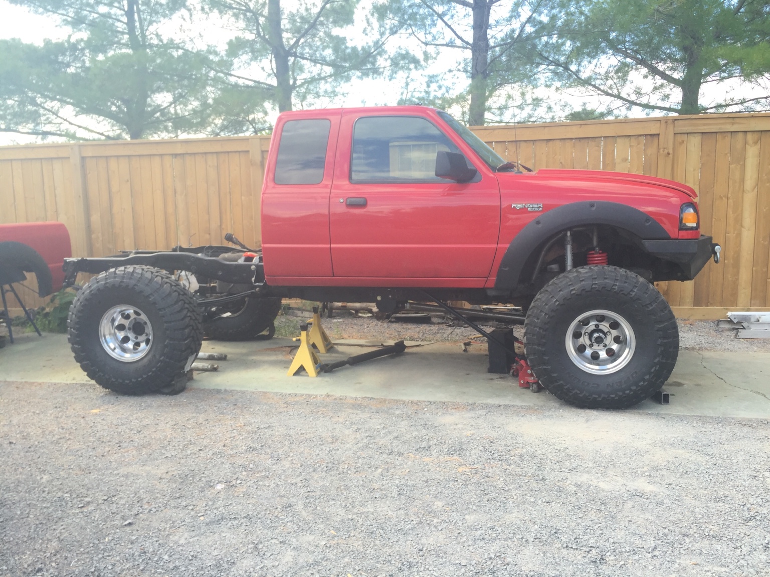

How much body lift are you running to be able to clear those 35s?
Since you live in an area that deals with Ontario's stupid etest regulations you can't actually swap a V8 into your truck anyways. Anything newer than 99 in our area is almost impossible to swap in a bigger motor, found out the hard way with my 03 Mustang.
There are ways, but it's not easy, and you have to do things a certain way. a real pain in the ass. And I've seen guys with v8 Rangers and There is a guy here that has a 4bt Cummins in his 08 ranger.
If I were to swap a different engine it would be a 4bt, but I don't see that happening.
It's just a 3" performance accessories body lift. I also have explorer leafs with add a leaf and lift shackles with stock block removed.
And 2" torsion bar crank.

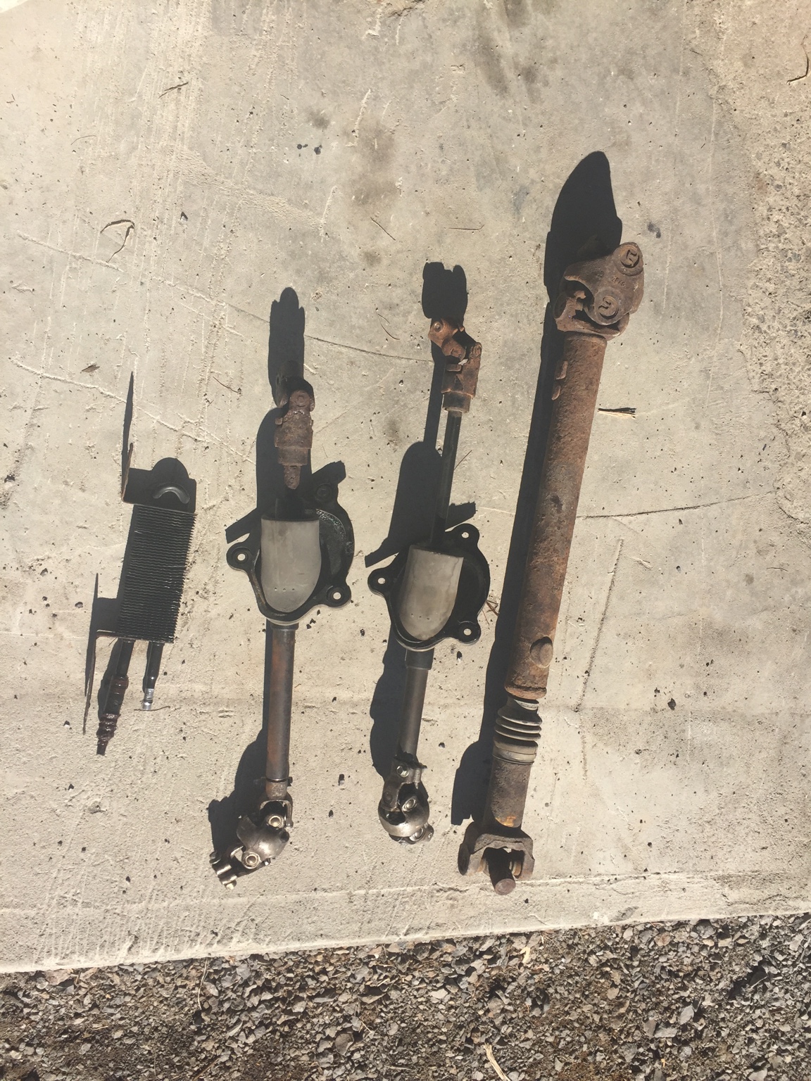

Power steering cooler, e250 steering shaft and a double cardon driveshaft from the wreck yard.

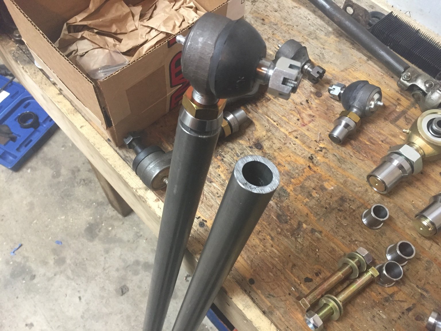

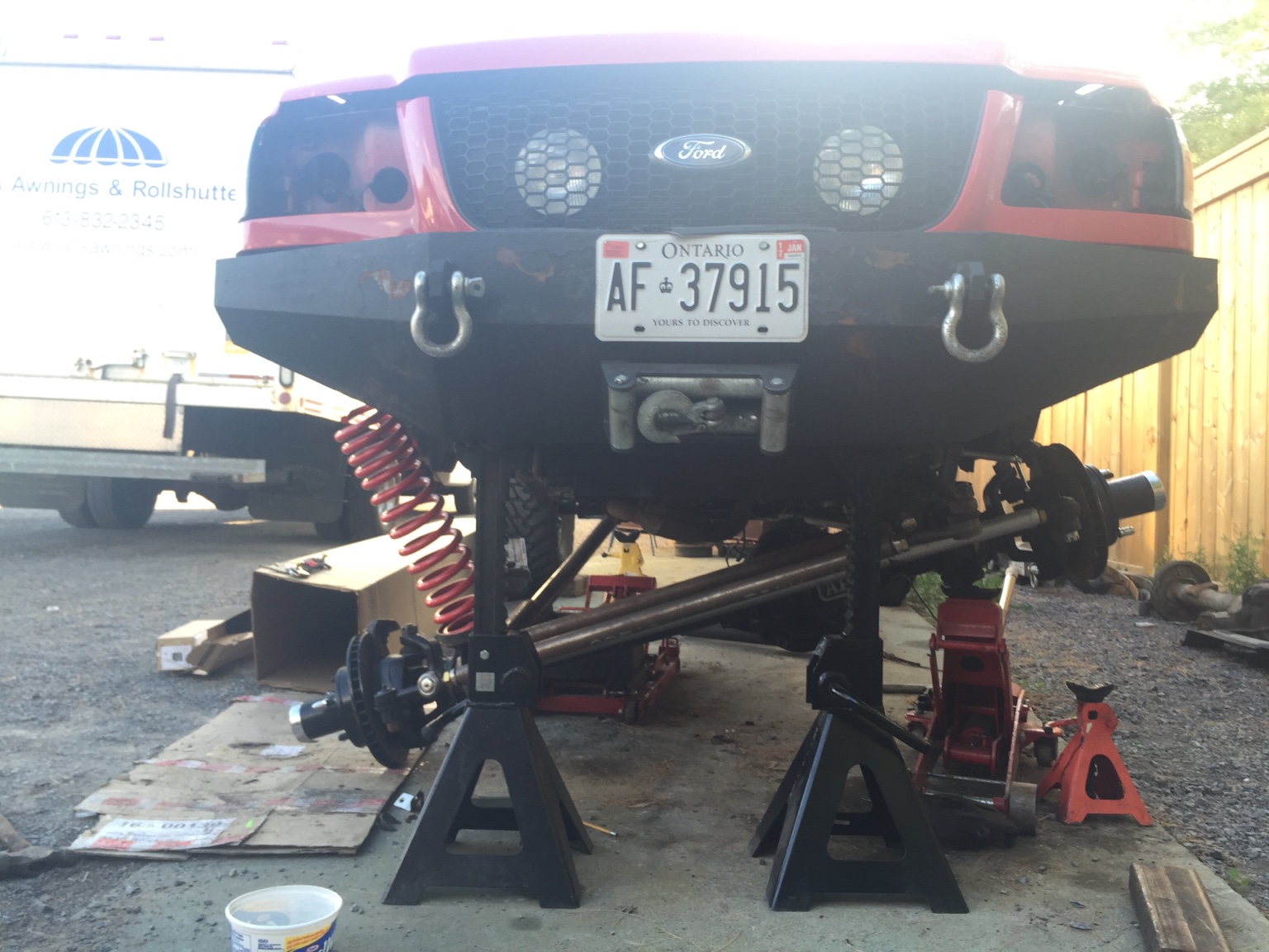

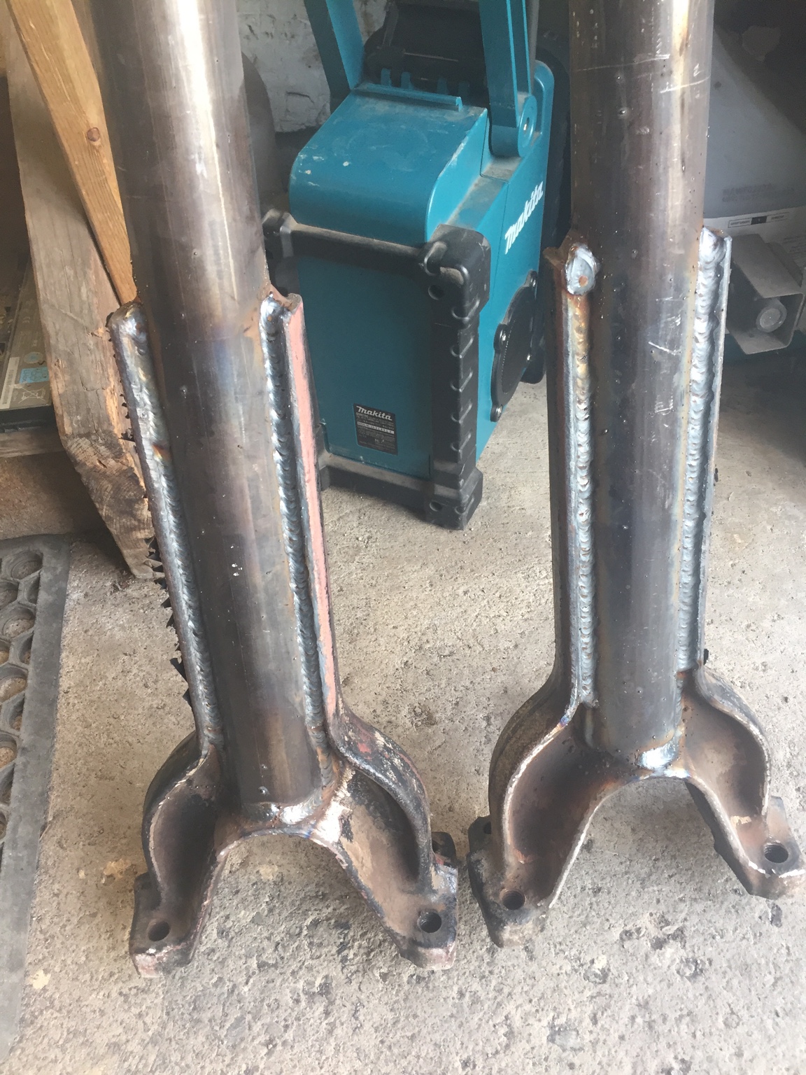

One ton tie rod ends with 1.5" .250 wall Dom tube for tie rods and drag Link, Johnny joints for radius arms

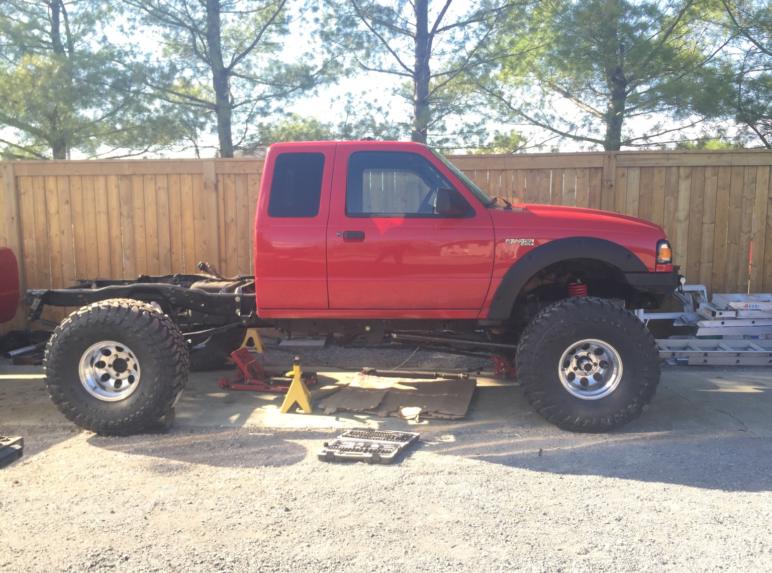

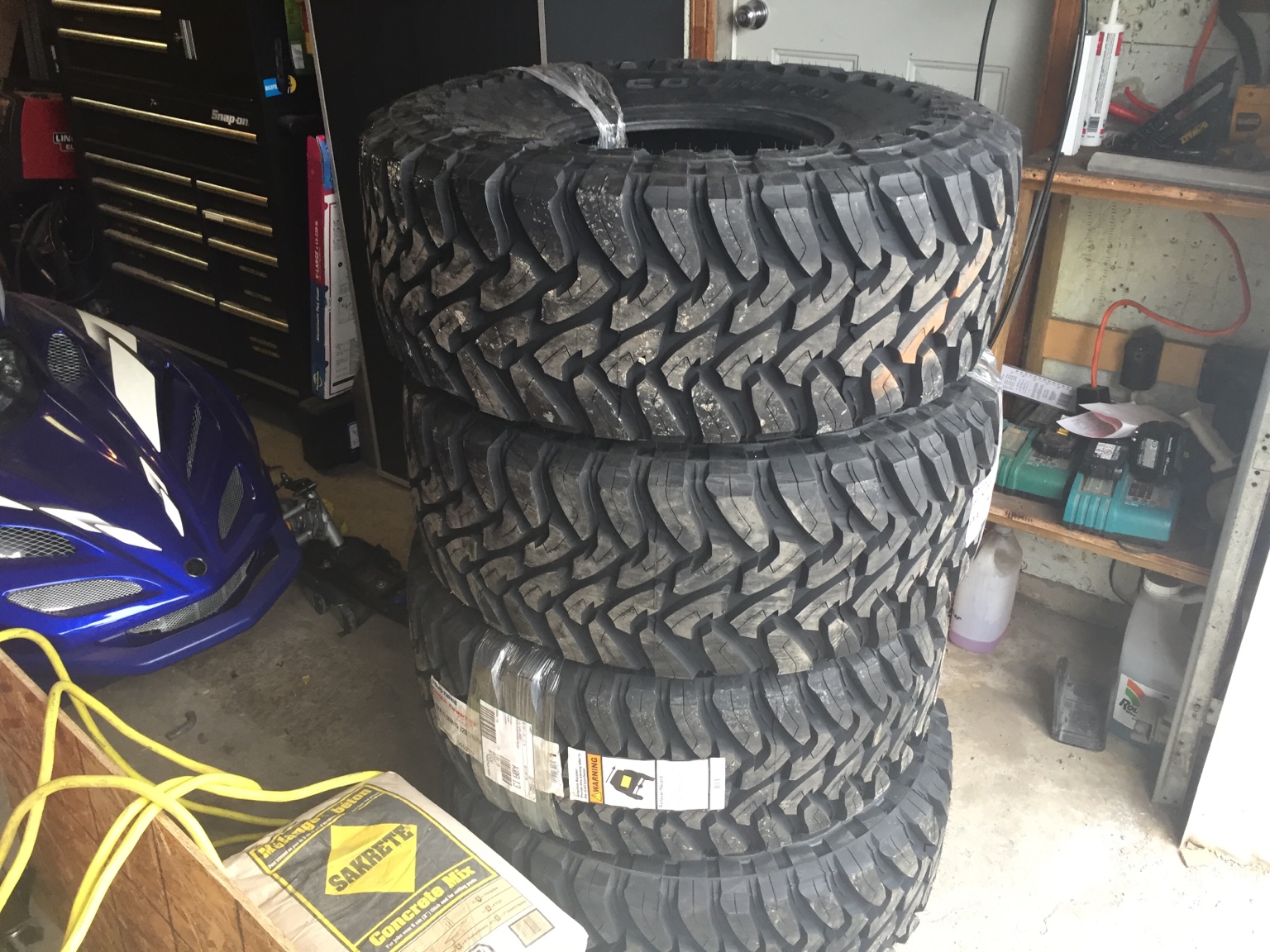

37s!
02 FX4 Twin stick Build
I run 33 inch tires with only a 1.5 inch tbar crank. It helps that the tires are only 10.5 inches wide.

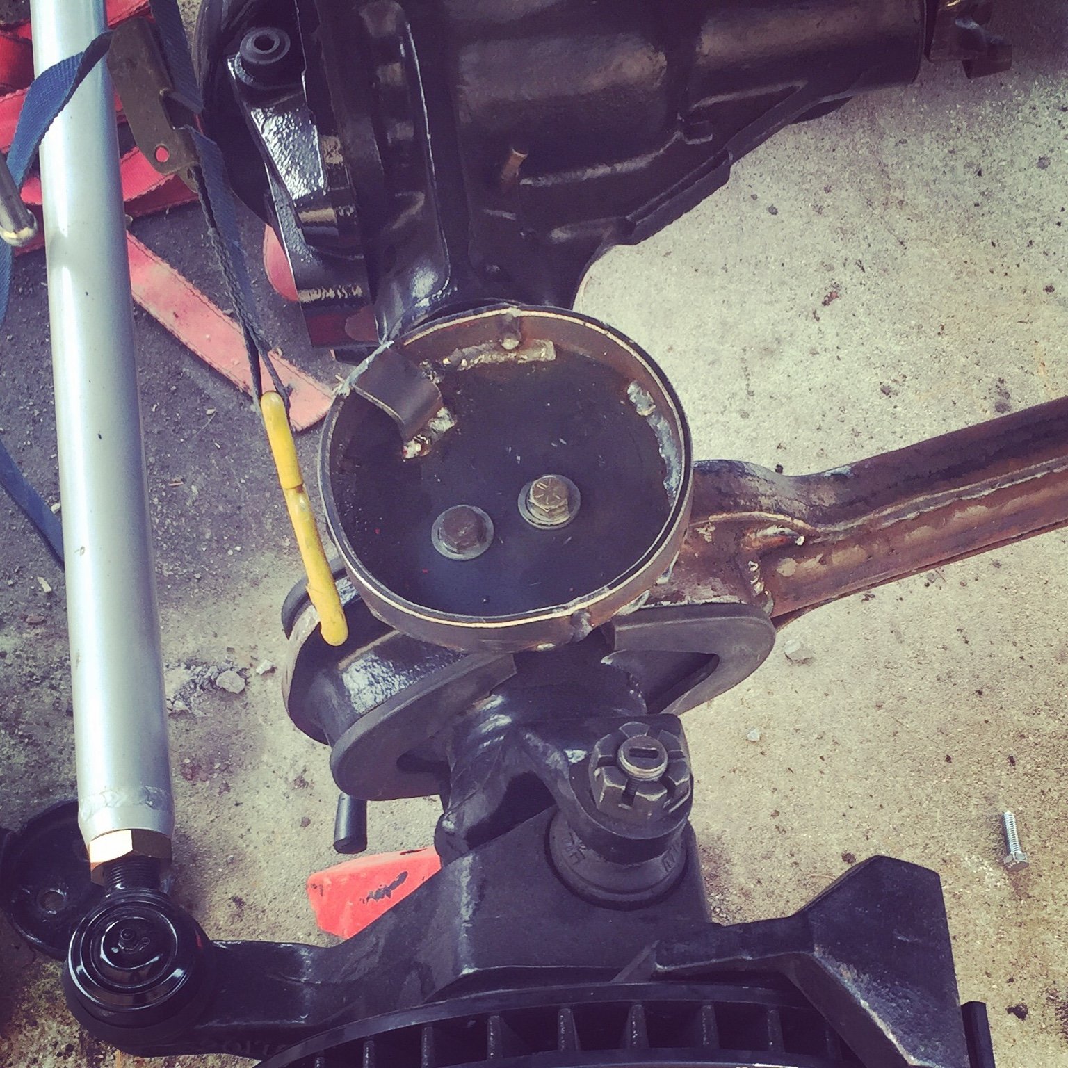

Welded the radius arms

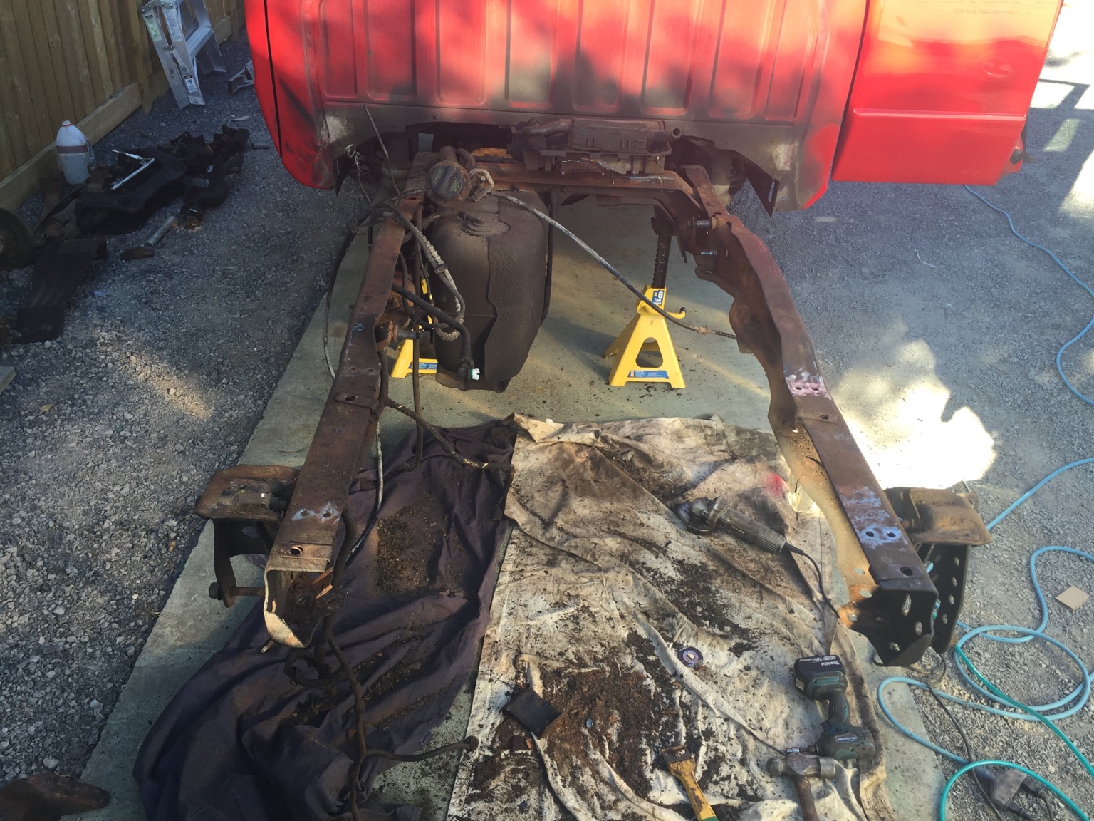

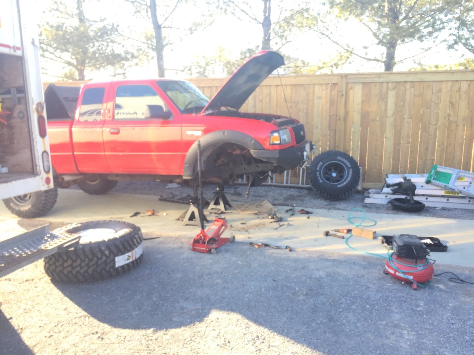

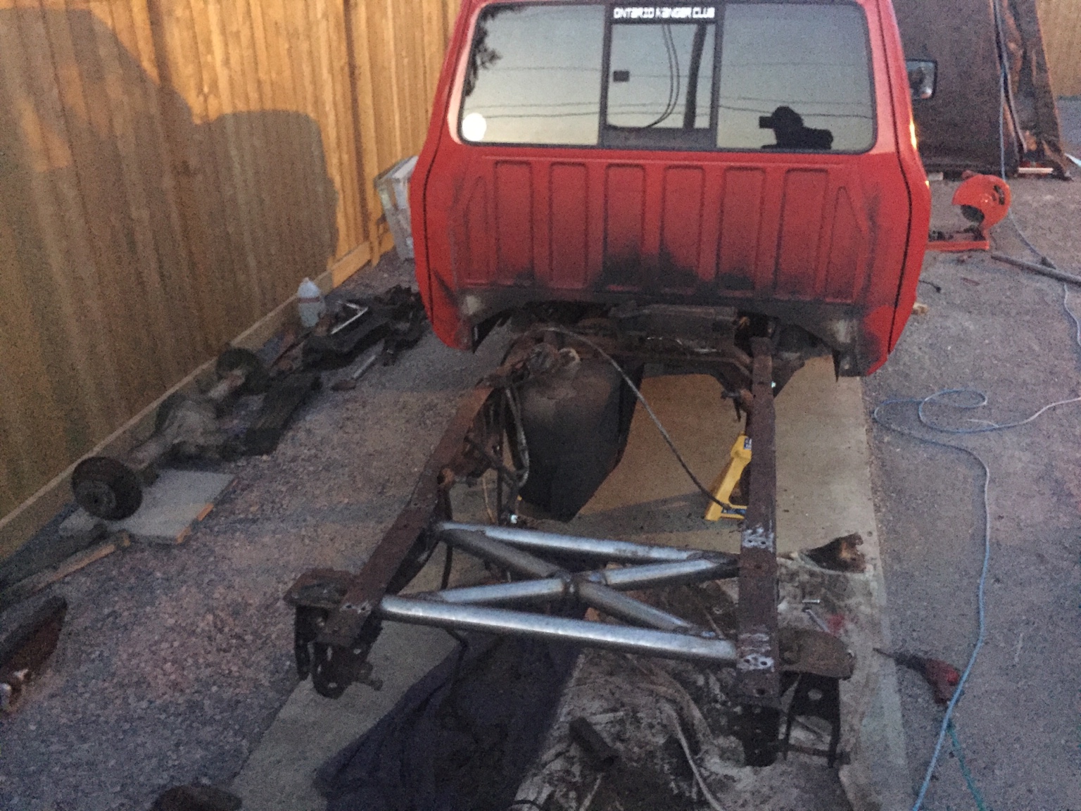

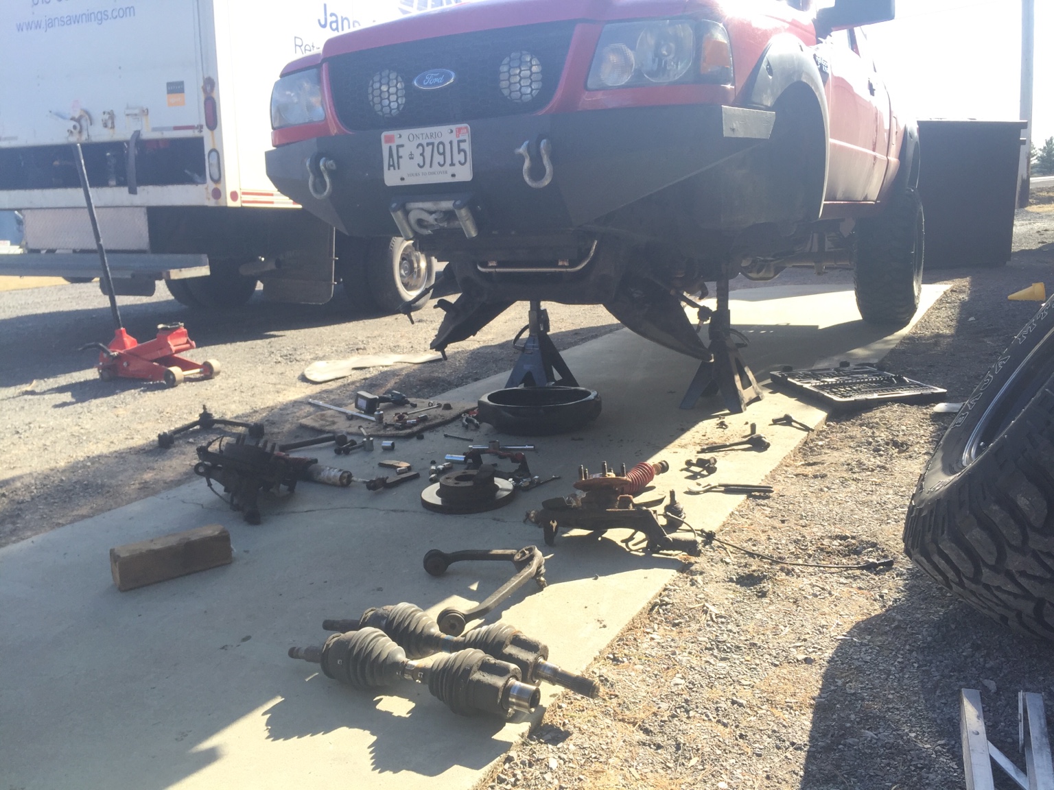

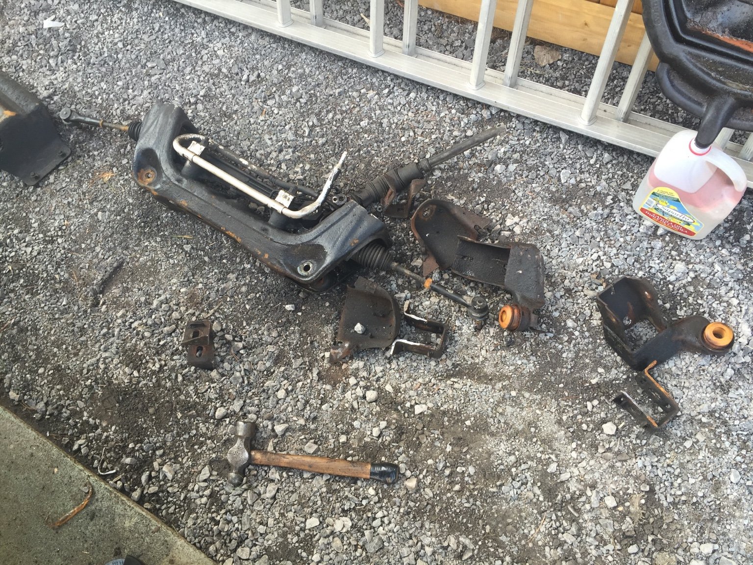

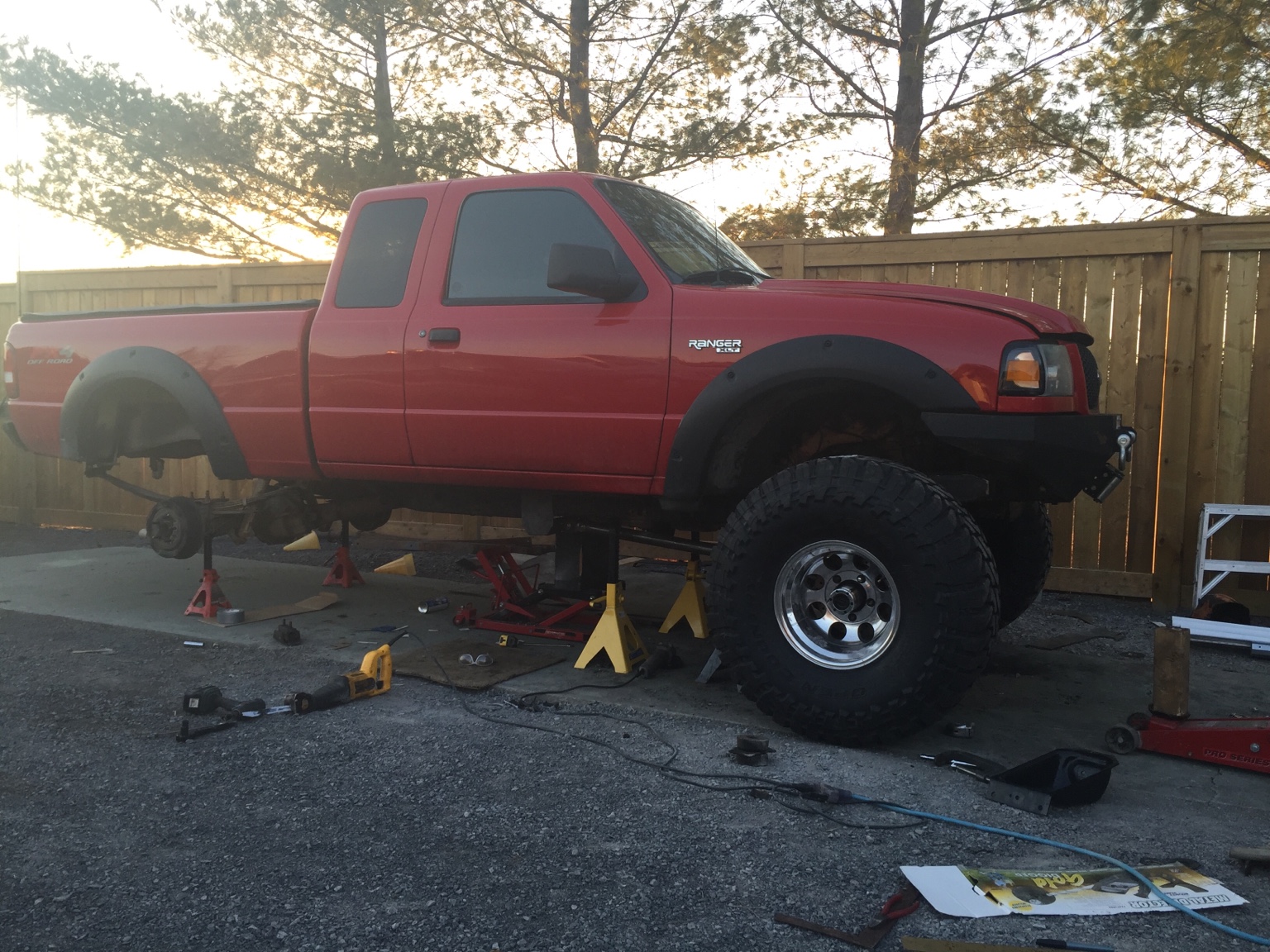

Unbolted all the ifs, now time to start cutting stuff off the frame

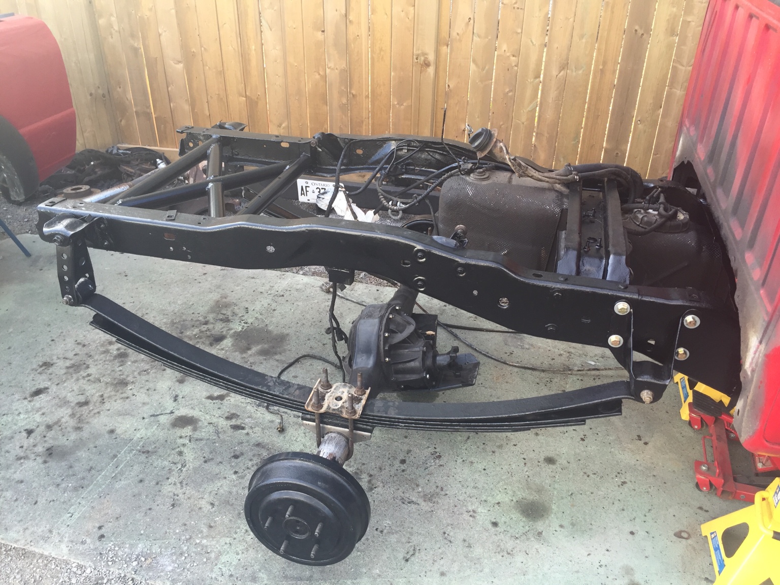

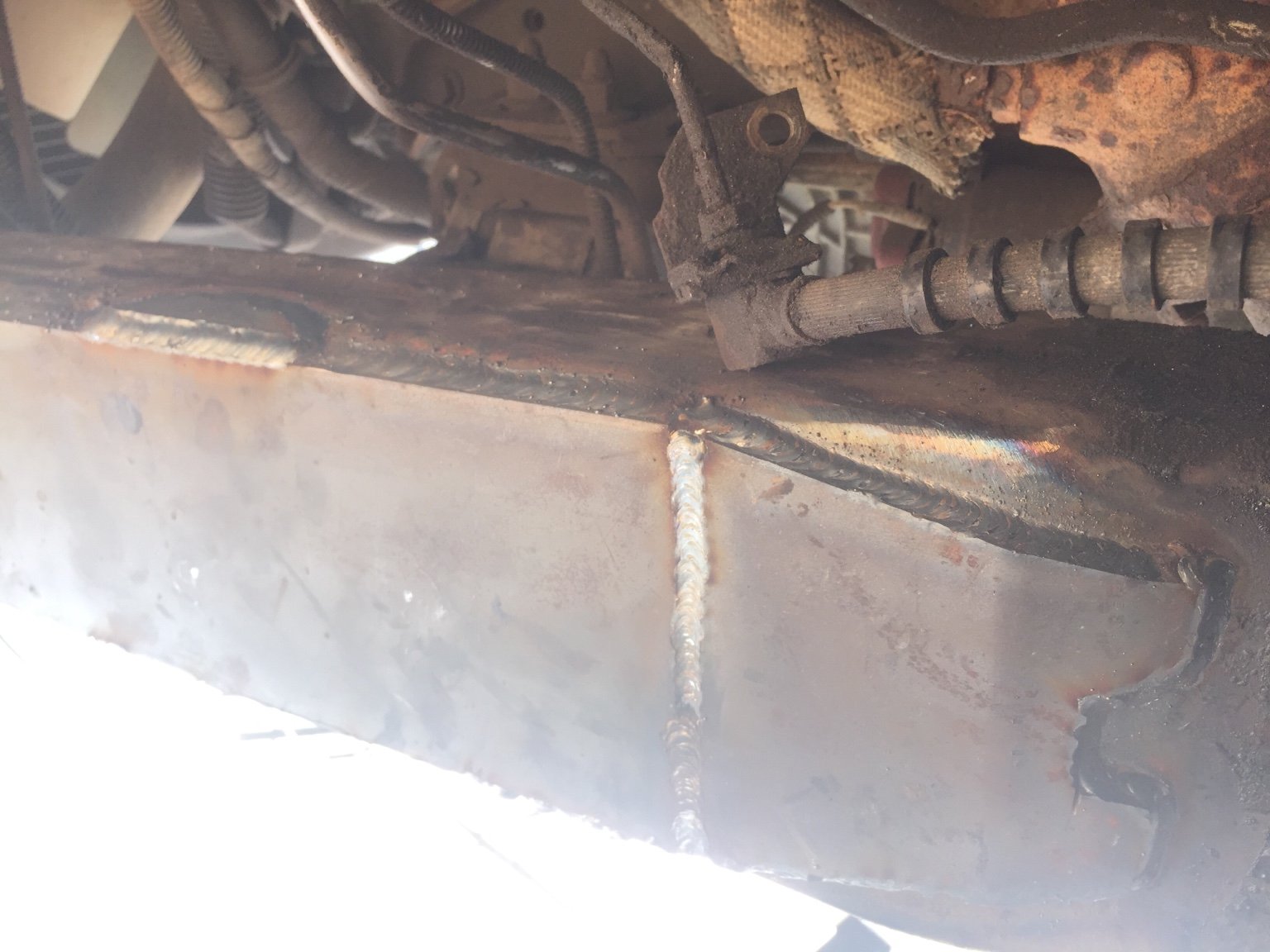

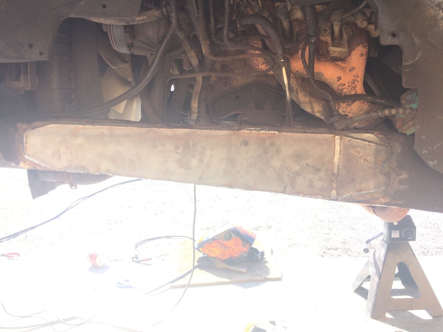

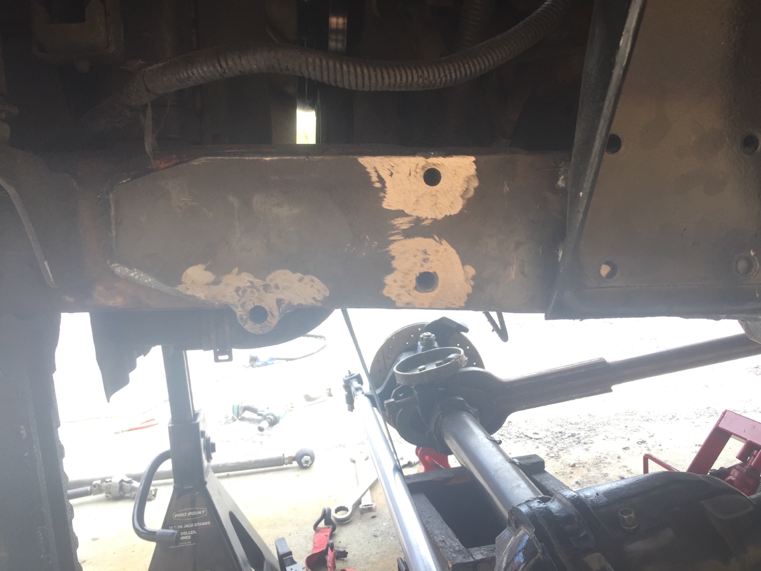

Installed the new transfer case, plated the frame, started building a crossmember for the radius arms, still have to add some gussets and finish welding it.

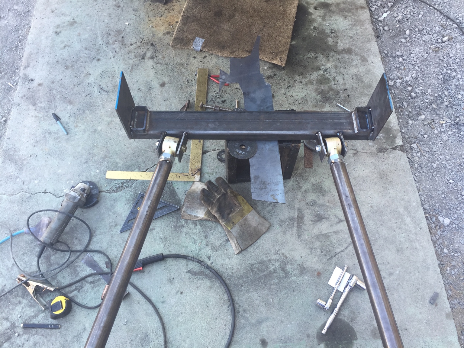

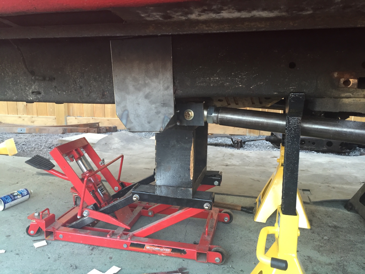

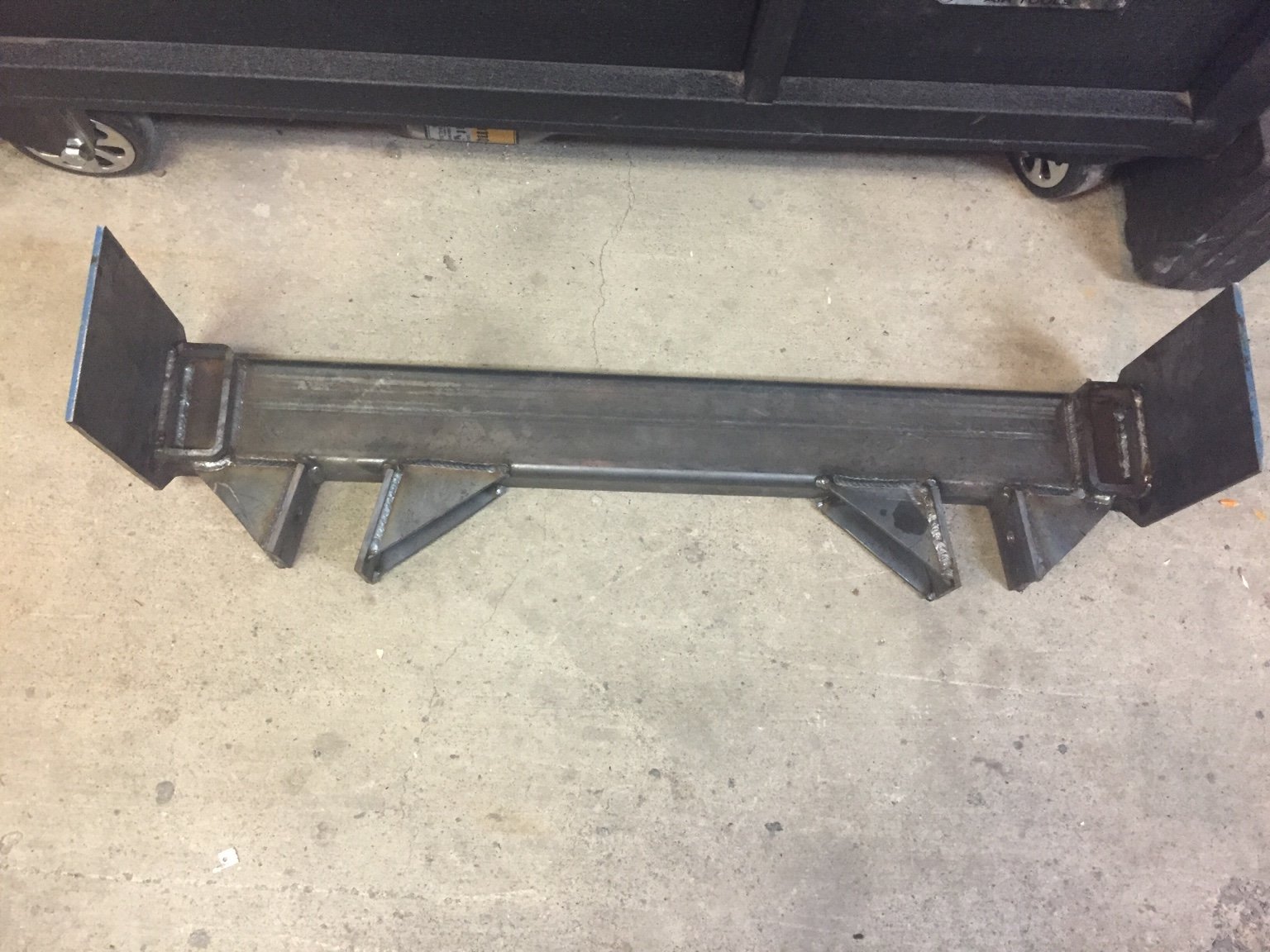

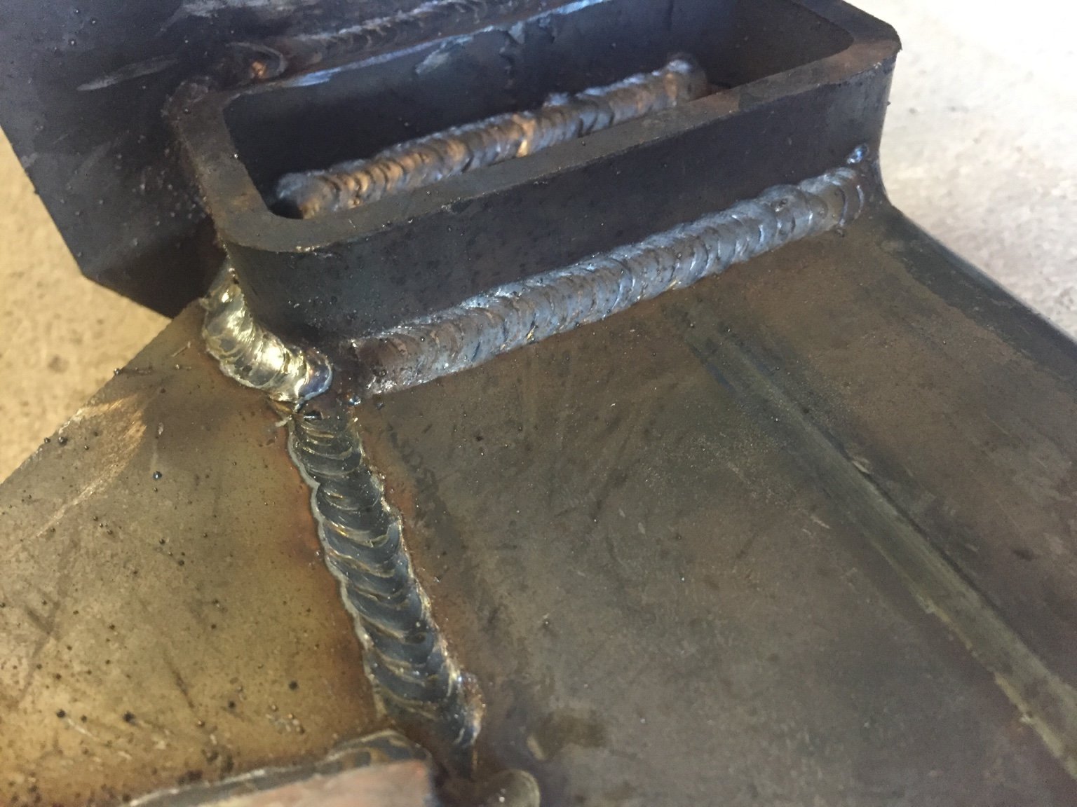

Finished the radius arm crossmember

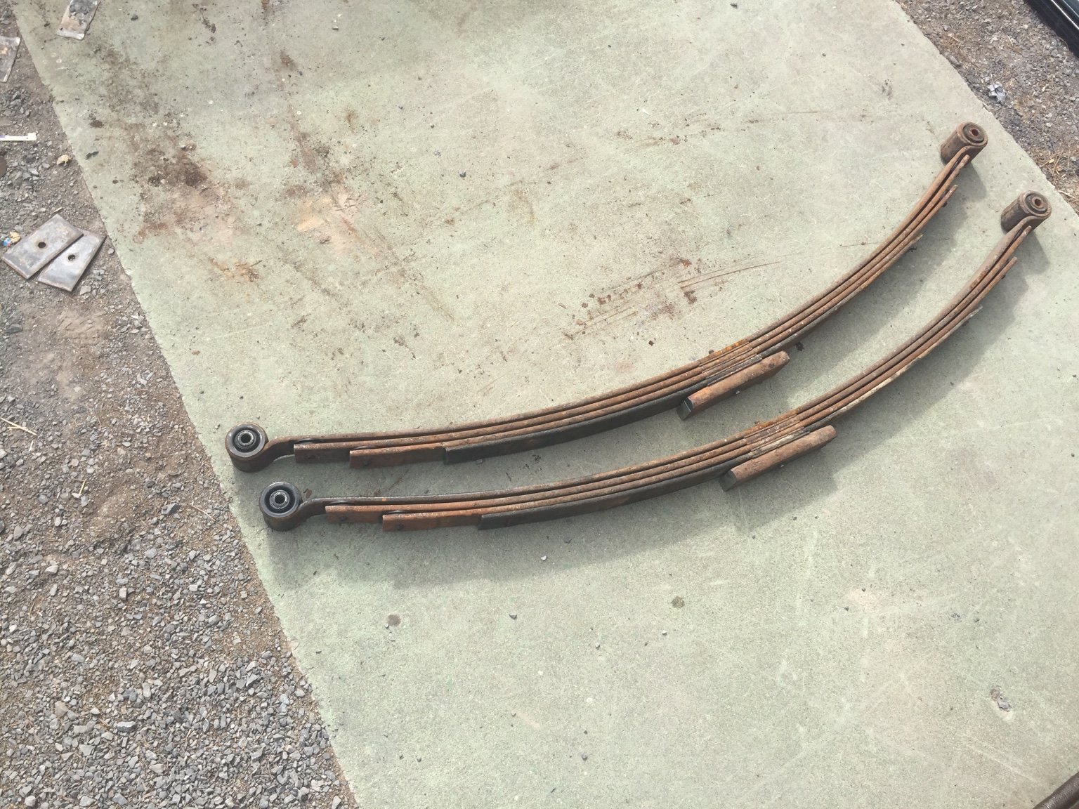

Chevy 64" leafs with new bushings, cut overload and one ranger leaf added.

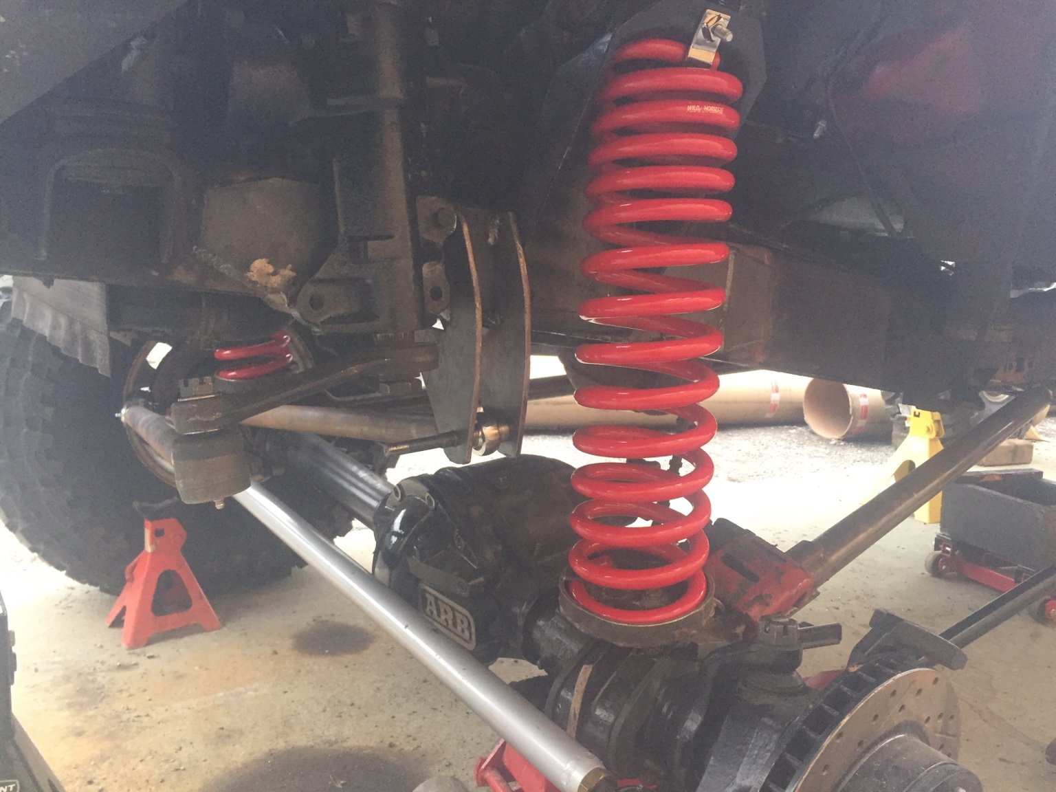

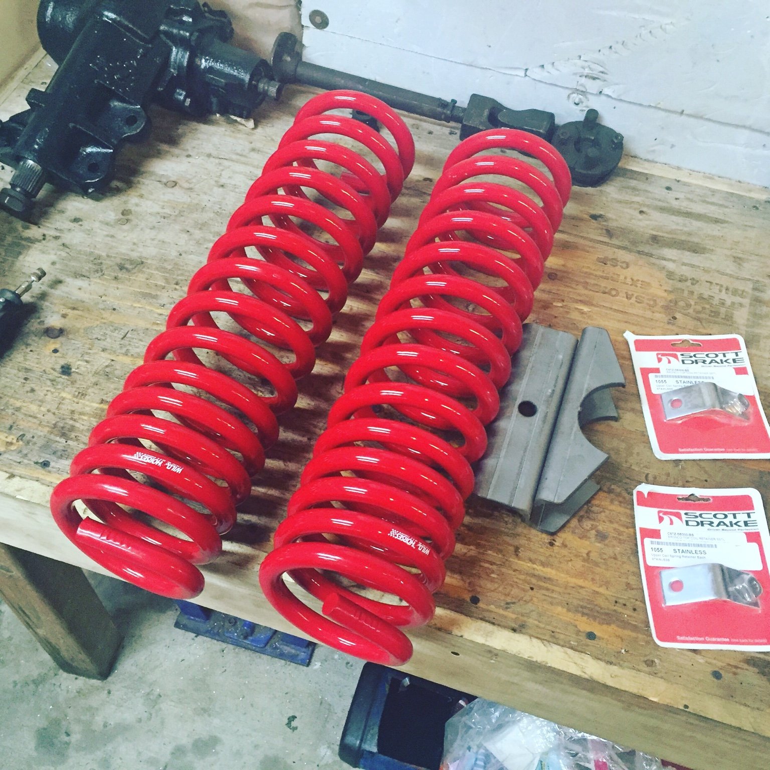

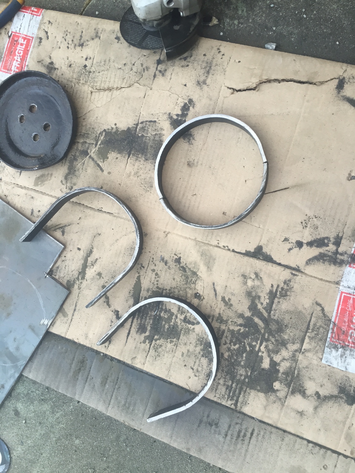

Made some heavy duty lower coil mounts, couldn't get the coils to sit how I wanted with the stock bronco ones

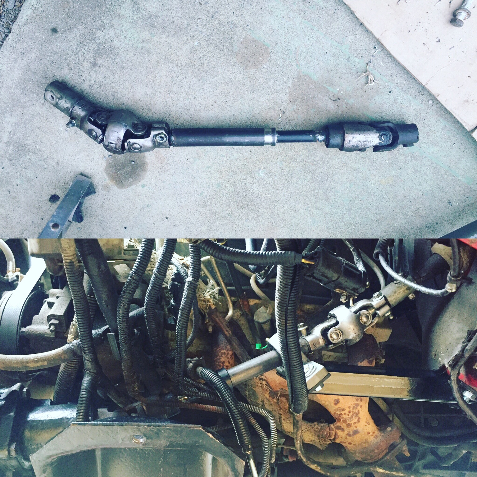

Shortened e250 steering shaft with a pillow block bearing attached to the firewall

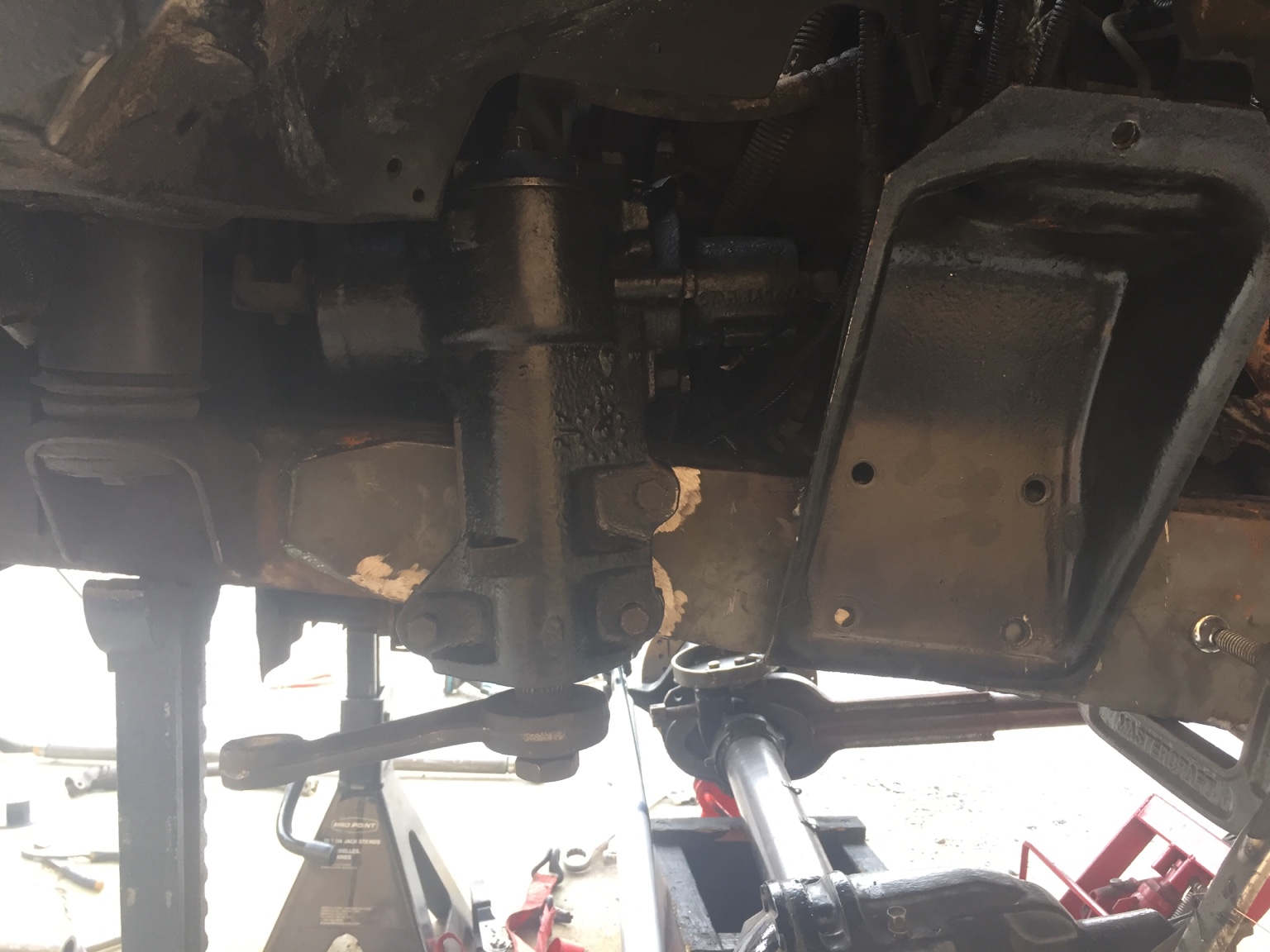

Dom tube through the frame for the steering box

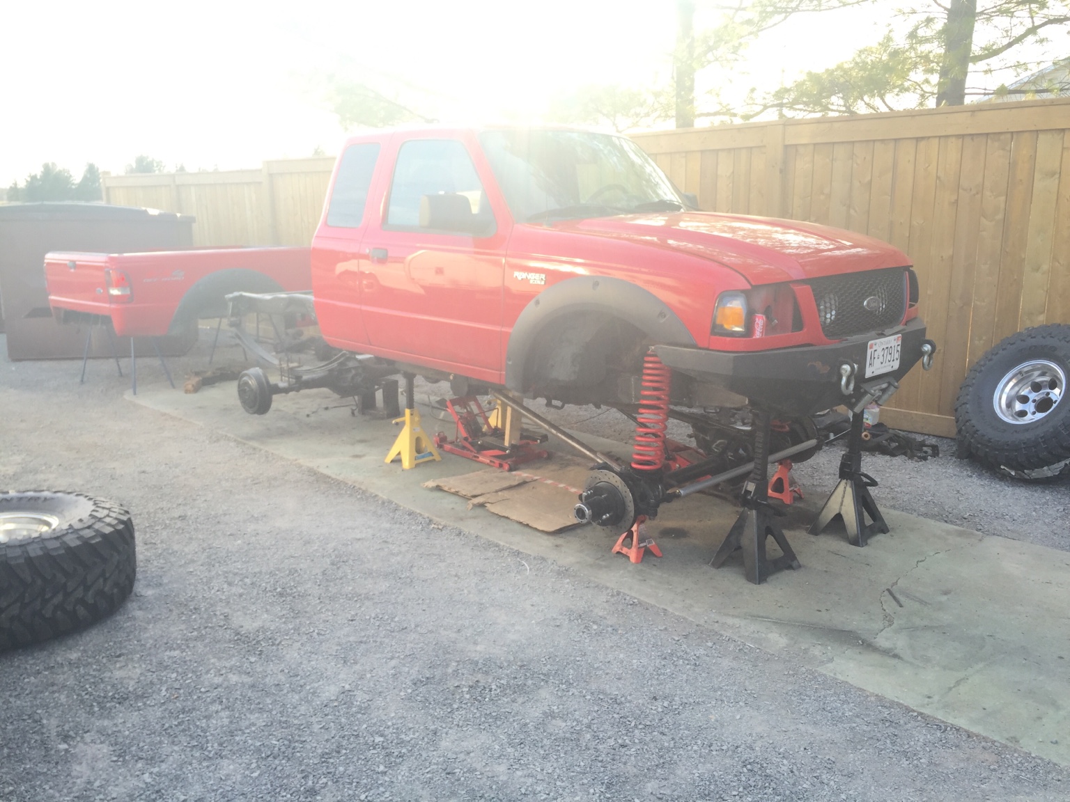

Front end is getting there,

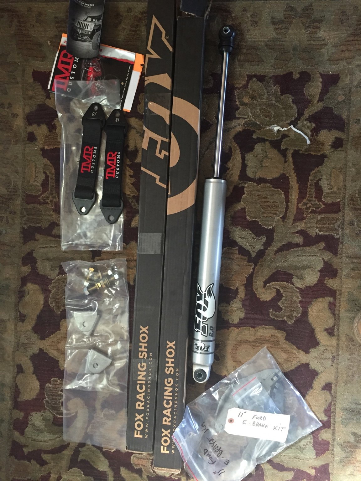

Fox 2.0 shocks and limit straps from TMR customs.
